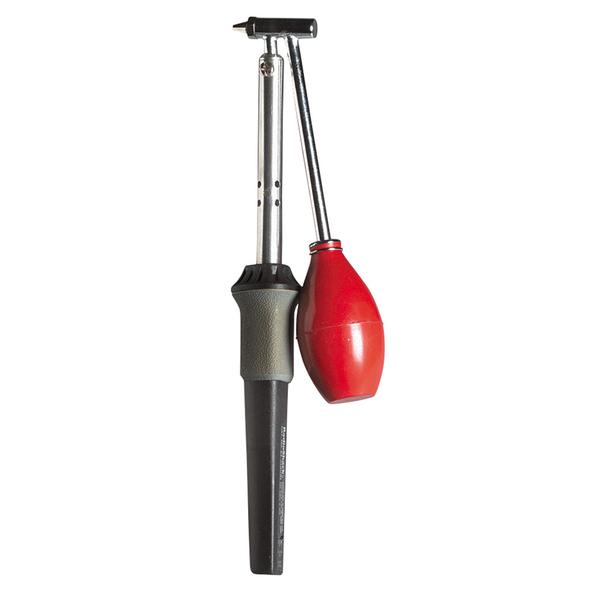

Even the cheapest "setup" is probably better than random pieces, but these things work OK:
- 06402060_00_600x600_crop_center.progressive.jpeg.jpg (12.07 KiB) Viewed 2542 times
