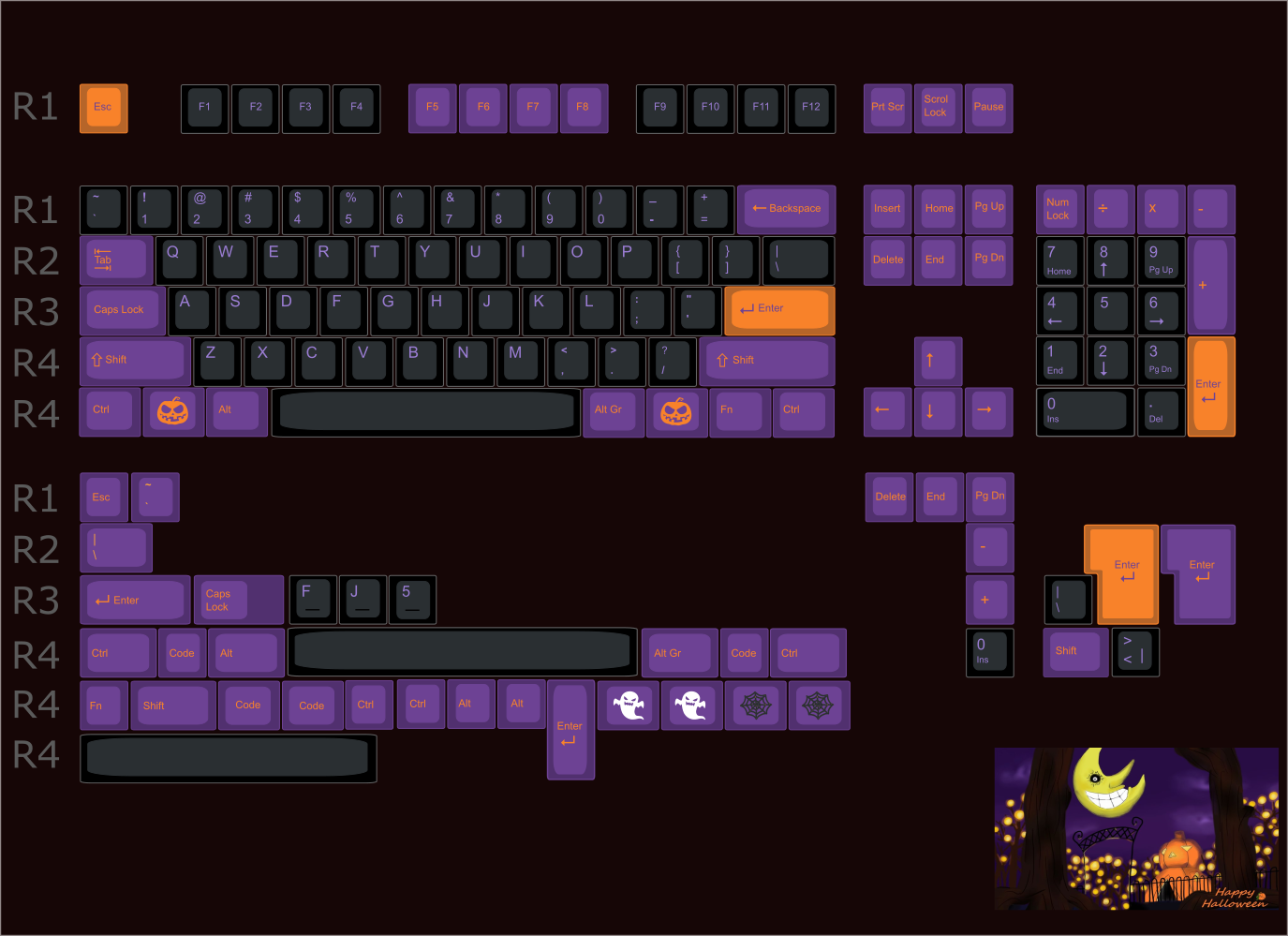

Ver. 1
alphas - base: CR, legend: PANTONE 263U
mods - base: DY / V2, legend: V2 / DY
Here's the 2D render

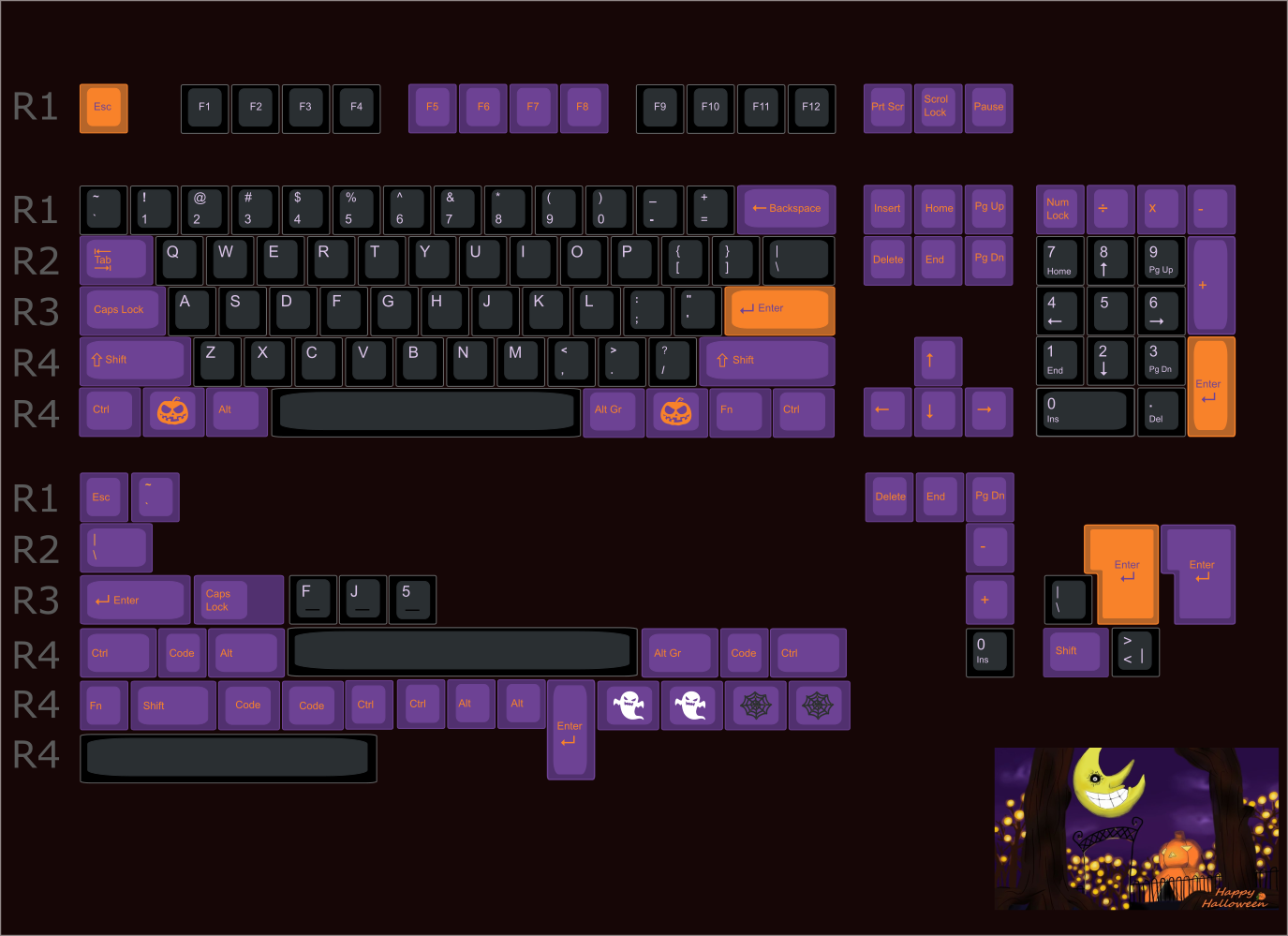

Ver. 2
alphas - base: CR, legend: PANTONE 2087C
mods - base: DY / V2, legend V2 / DY

Ok, so custom colours (well one), Novelties, Barred homing keys, minimal ISO support and a new unknown groupbuy runner?
Fasten your seat belts, it's gonna be a bumpy ride.
So custom colours are a price rise that can make it harder to reach GMKs MOQ of 150 (or is it still 250 for custom colours?). The fact that 263U is only used as a legend colour that looks kind of close to an off-white beige in your render and you could probably use any of (L9,T9,3K,2M,GR1,CP,WS1) as a close enough substitute makes this even worse.
There have also been some issues with GMK custom colours in the past, but they probably wouldn't be as noticable here, as you only do small text legends in a custom colour.
Novelties. Novelties generally further increase the price of a set. In case of a GMK set they increase the price quite a bit, because GMK custom legends are expensive. The three novelties you already have in your renders, you have a vote on up to six other novelties in your poll. This isn't gonna help you reaching MOQ.
Barred homing keys on GMK sets can be done, but they are less comon than the beloved scooped F & J w/ dotted 5 combo. You could probably remove the non homing F, J & 5 to lower the price a little, but that's up to you.
Your ISO support is pretty minimal and doesn't even cover proper ISO-UK. That's ok, but some ISO folks prefer to have at least ISO-UK support because it feels less like a few tacked on keys to an ANSI centric set. Most ANSI folks prefer this, or even no ISO support, because of the price.
The fact that this is your only post probably doesn't help people trust you with their money, especially this shortly after Ivan and berzerkfan. I can't really help you with that.
One last thing: Legend consistency. If you offer 1 Alt + 1 AltGr in 1.5u and 1.25u, why offer 2 Alt + 0 AltGr in 1u?
