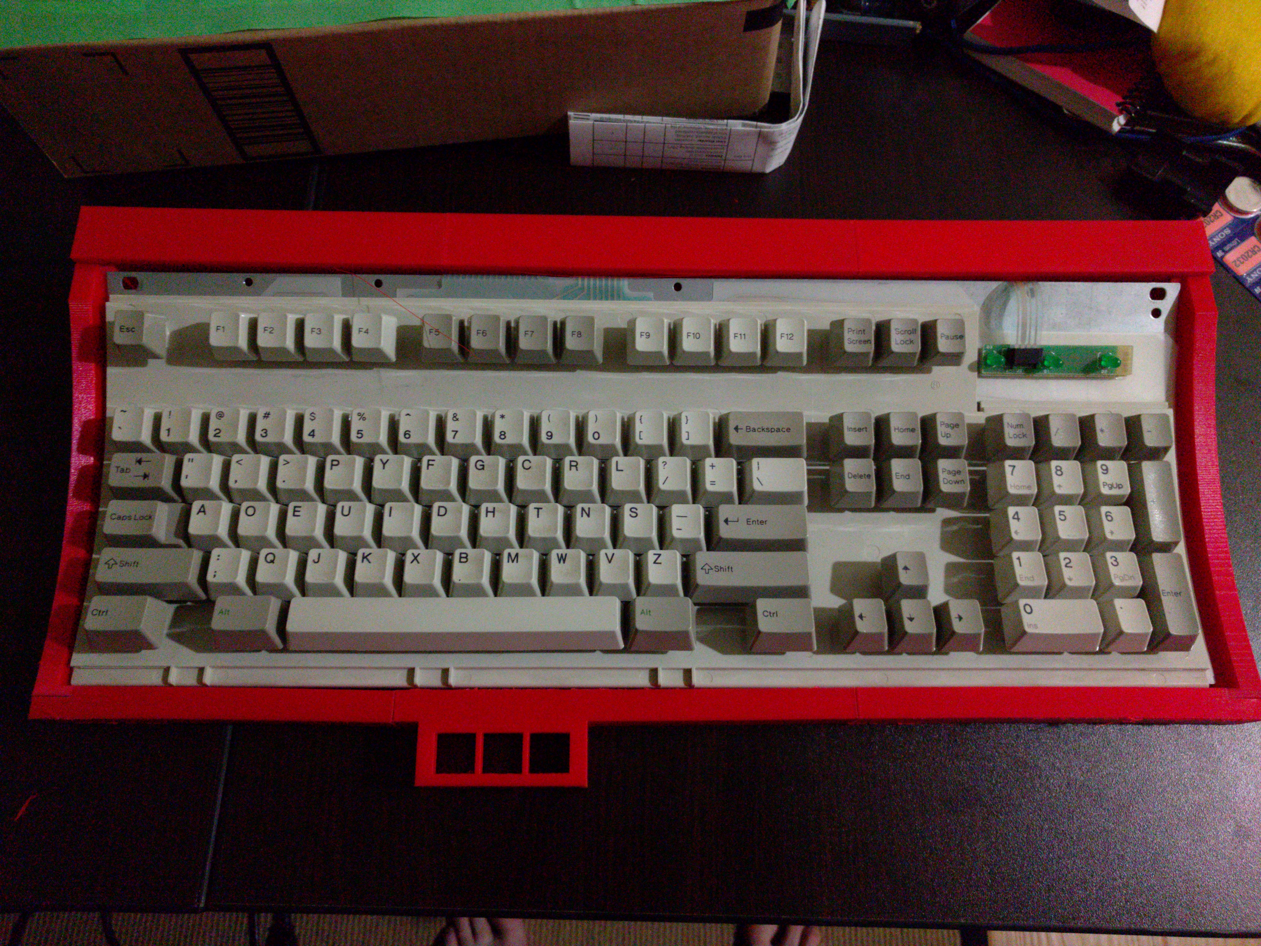

Well time to start on my next project. I bought a 3D printer because I wanted to do more prototyping work.
The goal of this project is:
Full replacement of everything except the buckling spring mechanism in the model M. I plan on rebuilding the frame for the model M out of PETG plastic. I also plan on 3D printing keycaps. I have salvaged a trackpoint from an IBM rubber membrane keyboard. I also plan to 3D print an underlay out of rubber.
This is going to be a trial and error process. The first prototype below is made from red PLA (final version will be blue PETG). One thing I noted was that the mouse buttons are going to work a lot better miniguru style side mounted.
Given the print area is not big enough for a full size beyboard I will also need to learn how to seamless join PETG and other plastic.

Firstly, can I just say that I love how much of this you plan to 3d print.
I worked on a project a couple of years back where I printed a case out of multiple sections in PLA.
I'm not sure if PETG has similar properties but PLA has a huge problem of not dissolving easily, so solvent bonds are near impossible, which might mean coming up with fastening points on each edge that could bolt together. Mine were just little mounds designed to fit M3 fasteners and they worked pretty well, except the positioning resulted in some unwanted bowing and flex.
I'm also not sure how much internal space you're working with, so it's possible that option just won't do.
As far as making it seamless, add some epoxy clay in the joins, sand it back, then do a few coats of primer and sand that. I guess that will only work if you want it painted though.
If you intend on showing off the blue PETG, maybe just a regular 5 minute epoxy could work. It'll be messier because the epoxy will have a similar consistency to honey but at least it will dry clear.
Anyway, best of luck. I can't wait to see how it all turns out

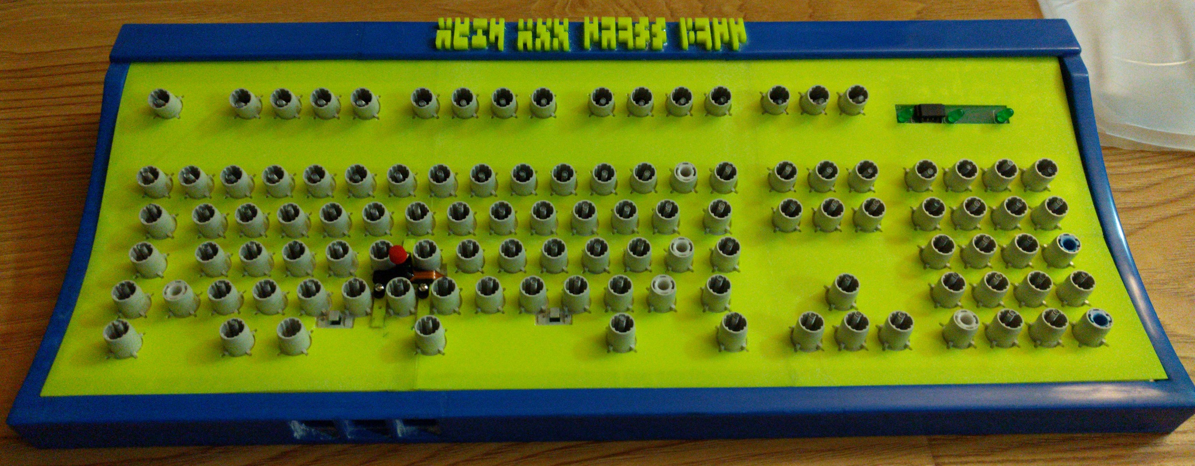

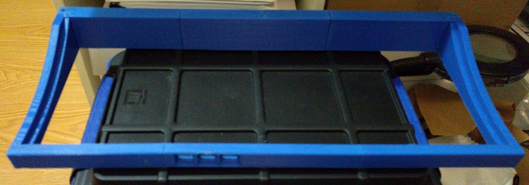

Well done some work lately and done some design tweaks and printed in PETG. I side mounted the mouse buttons but not sure of the alignment as they are slightly to the right of centre. I also developed a way to seamless weld PETG by using melted ABS and then epoxy coat it on top.

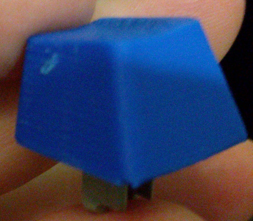

Also worked on the keycaps. The best way to do this is to ABS print the keycap covers and use the original stem.
One thing I need to get hold of is a 3d model of the plastic top plate so that I can 3D print a TPE underlay similar to Phosphor Glows underlay. Can anyone help me here?

Ok so progress has been made.
Based on the previous design I 3D printed the frame out of PETG. I used dowel joints to hold everything together and make it all interlocking. I used melted ABS to secure the joints and make the joints less visible. I then used XTC-3D to give the glossy appearance.
For the underlay I designed and measured the key positions and got it 98% accurate.
For the electronics the model M and the trackpoint are both ps2 so I will hide a ps2 to usb converter on the inside.
Next up, creating the keycaps. Here I am going to get creative. 3D printed ABS does not have the durability for the stem but it does for the keycap if I use XTC-3D.
