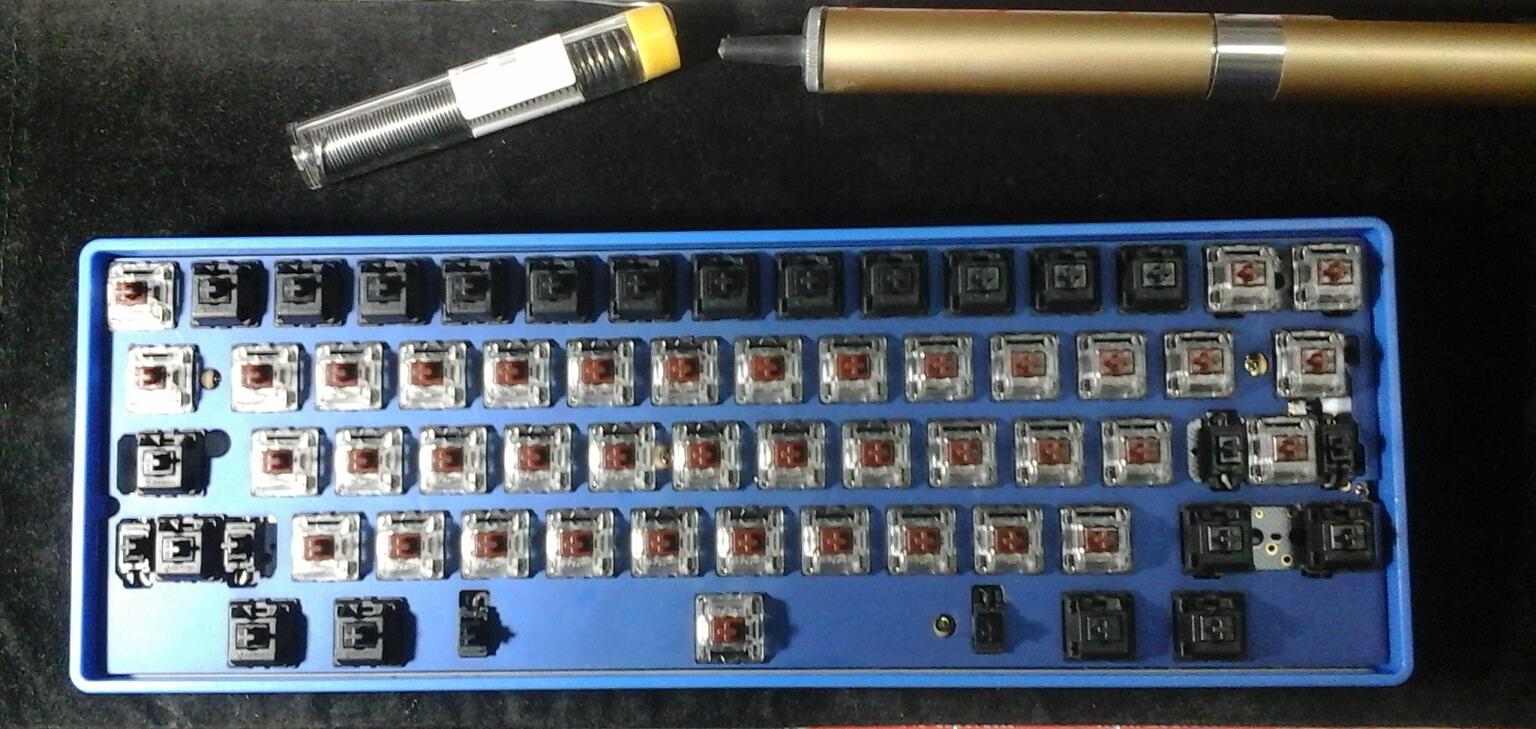

I managed to flash my Satan GH60 PCB, using the QMK firmware, on a physical layout that mimics exactly the HHKB layout (due to a HHKB-style cut metal plate - thanks, LeandreN!). You know, like this:

In general, any GH60-based project (or derivative) PCB would do, since these boards usually support a large number of layouts/arrangements (HHKB included) and there are a number of places from where you can buy such a PCB. I think the hardest to find is a plate in that HHKB layout. Normally LeandreN periodically runs groupbuys that include these type of plates. Right now it's a bad timing (his 5th GB just closed), unless you either persuade him to enter "late" or persuade somebody else to sell you such a plate.

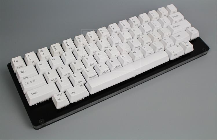

I got mine pre-assembled from eBay:
http://www.ebay.com/itm/HHKB-Mechanical ... 2242651210
I choose Gateron Yellow switches, which are the only Cherry mx or Cherry mx clone switches I have liked. Although I would much prefer Topre, IBM Model F, or blue Alps switches, I sometimes use the Sat60 HHKB keyboard, because my favorite form factor is 60% and my favorite layout is HHKB.
Although it was fun to have replica HHKB keycaps, I replaced them with another set that was more to my liking.
