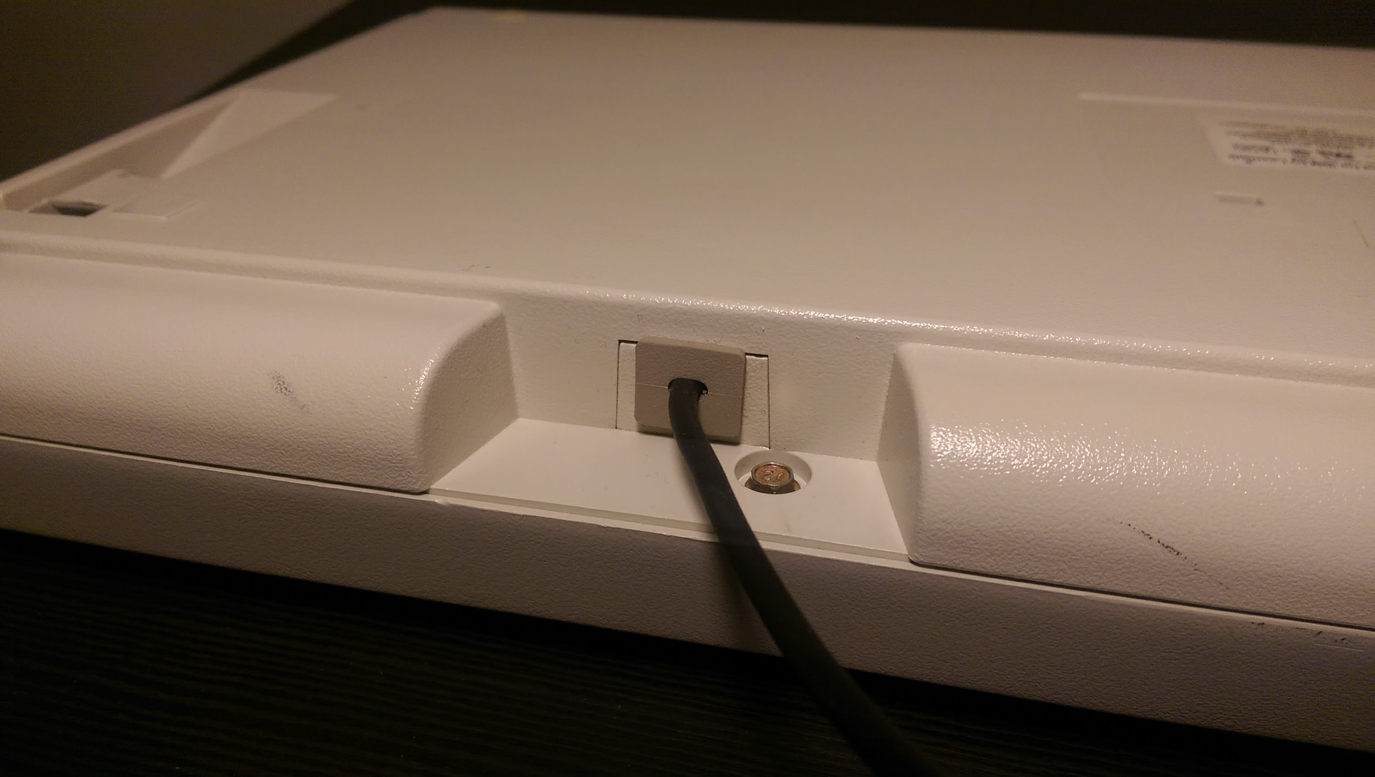

A few months ago, I did a USB conversion on a Model M keyboard for a friend. I flashed Soarer's Converter onto a Pro Micro board, hard-wired it to the board's existing controller, and attached a USB cable. This isn't new but it works.
What was new, was the way I secured the USB cable. This was a later model keyboard with a fixed cable instead of an SDL connector. I was able to, carefully, cut the cable exit grommet away from the existing cable, slice it open, and glue the new USB cable into it. Apart from the color being off it looks seamless.

Model M conversion to USB re-using existing cable exit grommet.

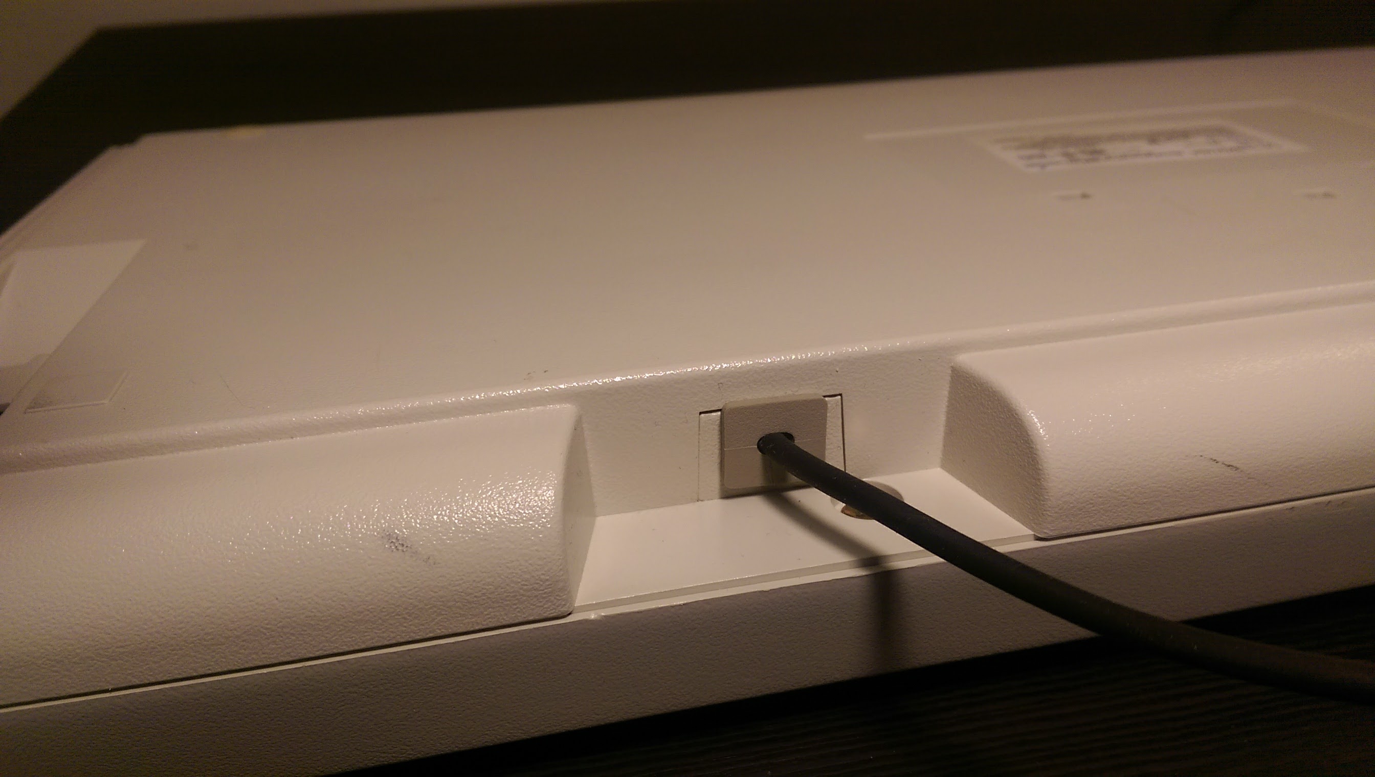

Cable Exit Mod - alternate view.

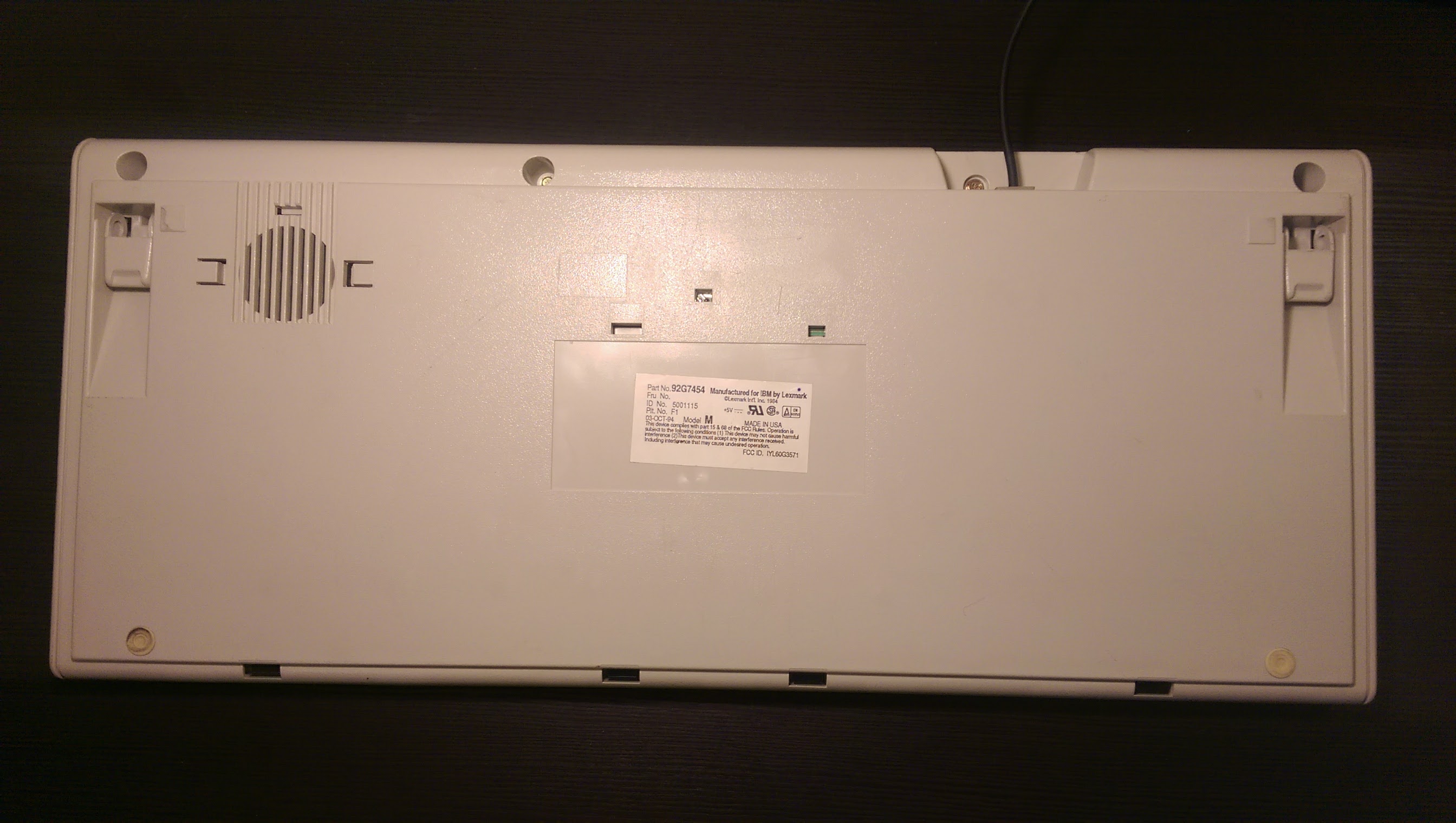

Keyboard rear view.
Keyboard rear view.

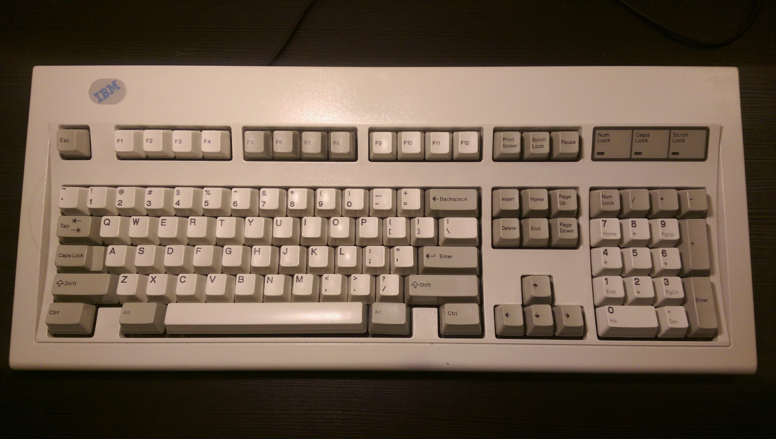

Keyboard front view.

The port cover is printed I'm assuming (knowing you)... It looks great, and would be interested to see the detail there. I know pics are hard to come by at this point, but if you could describe the grommet approach in more detail?

Nope, this re-uses the existing port cover that came with the keyboard.
If I ever do another I'll get more photos, but, what I did was to use a hobby knife to carefully split the existing grommet open down the middle, and liberate it from the existing cable. I then used super glue to attach it to the new cable, and to glue it together. It was a drop in fit.
