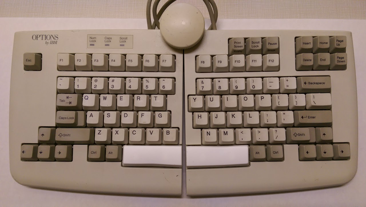

Finally, XMIT036 with the new, working replacement caps!

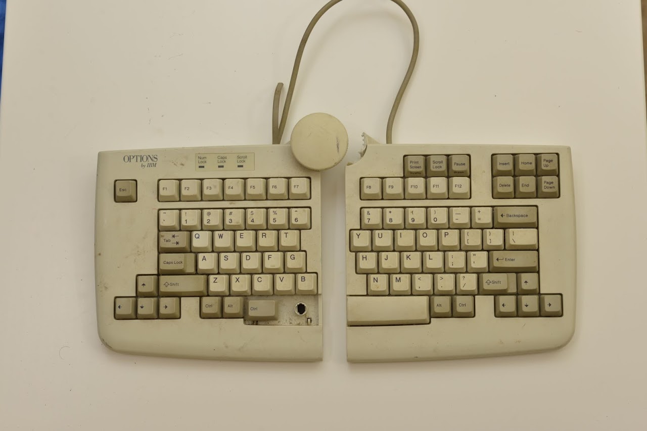

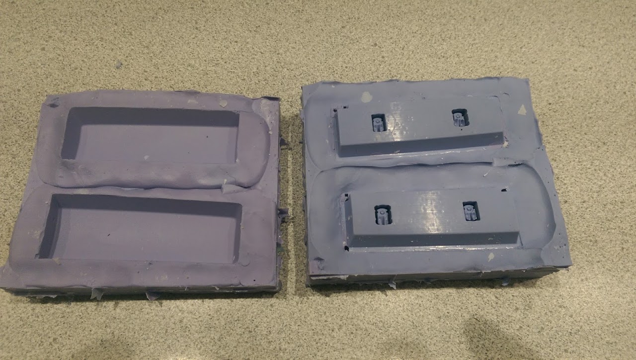

XMIT036 is one of my IBM Model M15 buckling spring ergonomic split boards. Here's how it looked before this project.
As you can tell, it is missing the left half of the Space bar. (In this photo the ball mount on the right half is also broken. I've since fixed this with 3M DP460 epoxy.)

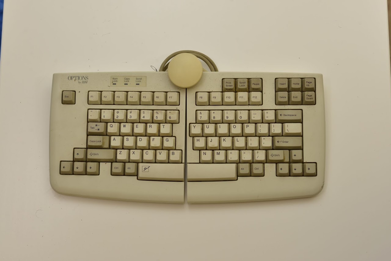

Fortunately, I also have XMIT035, which is a complete board.

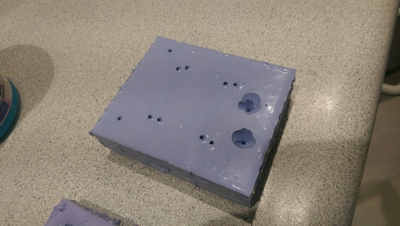

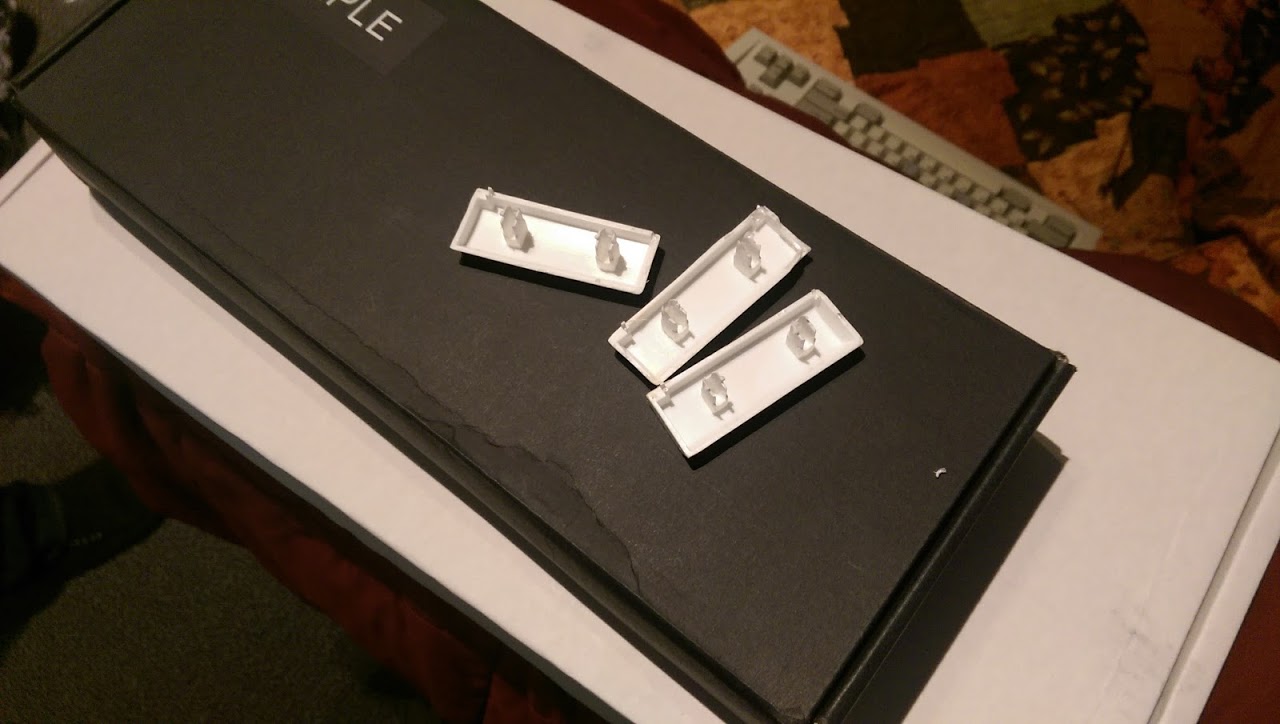

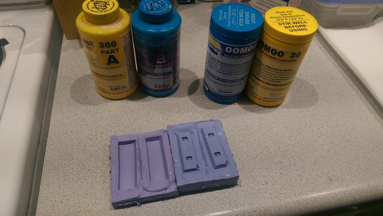

So, I thought, why not cast a new replacement Space bar set?
This project sat on the back burner until this week. I had a business trip. Through the geekbnb network on Geekhack :)) I connected with the incredibly awesome ImpendingxDoom who let me crash on his couch while I was in Chicago.
Now, I've had some experience with silicone mold casting, but Doom takes it to the next level. He's had almost two years of experience doing two sided molds, while I've barely done one single sided mold. We got some great results! These are not even the best ones...
If Doom gets a chance he'll run some black and red Space bars for me!
Does anyone know where I can find some 1.25mm stainless steel wire, to fabricate a better replacement stabilizer for the left Space bar? I managed to jury-rig something using an old paper clip (1.12mm) and some Kapton tape to increase wire diameter but I'd like to do better.

How do those keys feel in comparison to the rest of the 'board?

They're "good enough". Not a perfect fit but the right one (with the original stabilizer wire) is good enough to be a daily driver if I want it to be. The left one (with my own paperclip + Kapton tape stabilizer) works well enough, and works best in response to a centered press. I never use the left thumb when typing so this is not really a dealbreaker for me.
I know you have an M15. Anyone else? If we ask really really nicely Doom might be willing to make some more for us.
For me, this was a round two proof of concept for replacement ANSI Enter keys for Space Invaders boards. Engicoder and I were talking about making TKL boards with those switches using a new PCB.

I don't think I'd be interested in a silicone molded space bar. If it ever gets upgraded to a more precise mold, I might be in for a set in black or red.

I should amend that. The fit is really quite good. The space bars are only a little warped because a rubber band was used to keep the mold together. With a little tweaking we'll keep getting perfect parts!
