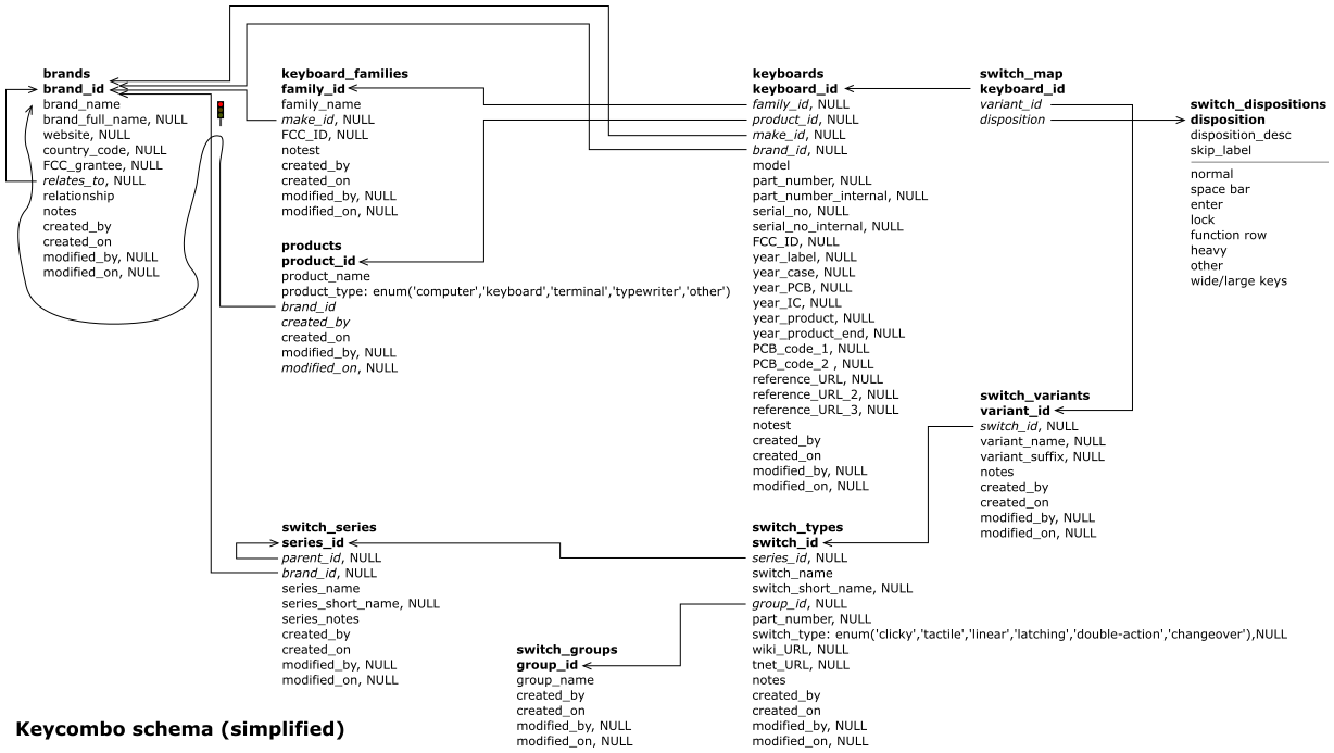

The choice of both back-end and front-end will be determined in no small part by the nature of the SQL schema required as well as the complexity of object creation during the data entry wizard: one entry may require simultaneous creation of a new brand, new OEM, new OEM keyboard family, new customer keyboard family, new switch manufacturer, new switch series and multiple new switch types in addition to the keyboard itself.
Switch series can be nested (SKCL/SKCM → SKCL + SKCM) and anonymous (maybe we only know of one unidentifiable switch from that entire brand), and keyboards can attach to the OEM by way of a series or directly. It gets worse when you realise that a keyboard model can have multiple OEMs and multiple customers. If manufacturer A makes model A:1 for brand Z, they may also sell that to brand Y, while brand Z might have manufacturer B brand a similar model under their name. For the situation of one brand, one model, two OEMs, I've used the products table—originally designed for computers, terminals, typewriters etc—to hold the keyboards with more than one OEM.
Switch groups are for Alps clones, Cherry MX clones etc.
User logins will of course be required so that it can be self-serve, with a revision process to accept and reject entries, as well as security groups (administrators, moderators, users)
4. SQL
Vet the SQL schema. This is the current schema, with all the data types removed as Inkscape is being particularly fussy and obstinate tonight:
Keycombo schema.png (199.82 KiB) Viewed 2047 times
