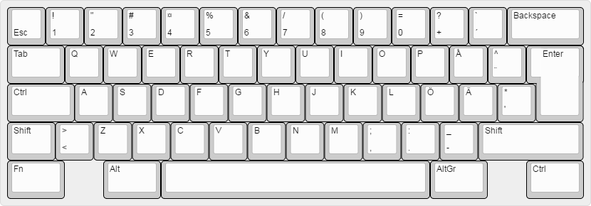

First, here is the layout:
Layout
Layout
A standard winkeyless 60% ISO-swedish/finnish layout. Nothing too special about that. The PCB will be Alps64. It should handle that layout just fine, shouldn't it?

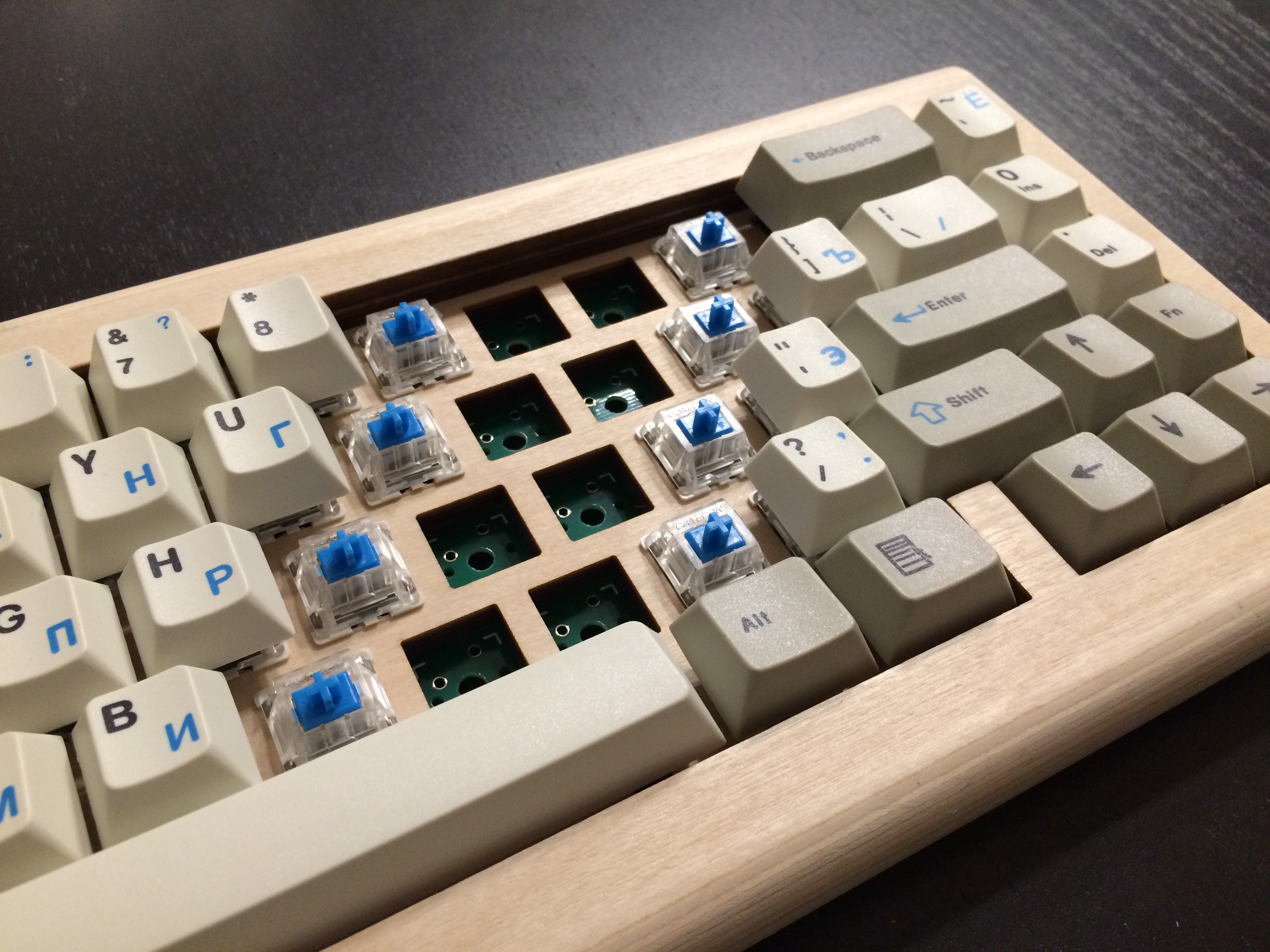

Slowly but surely progress is being made :)
  • I'm now waiting for the donorboard from elecplus in the EU GB
  • Yesterday the PCB arrived and it works
  • Today I picked up some material for the case. I decided to get one of each so I'll also be making a new case for my Ducky Mini. The mounting points should be the same so I can get started as soon as I find the time. The bigger of the two pieces is a little crooked so I will either buy time to use a local hobbyist shop or give it to a carpenter as I don't have a surface planing machine or what ever it's called (oikohöylä in finnish). The two pieces are actually great quality. They have enough surface without a single branch to make the cases. Best thing is that it only cost 5€ total.
  • Unfortunately I didn't win the auction for the Swedish Dolch so I need to source the caps elsewhere. I'll be updating my WTB in the marketplace later today. After that I just need to order the plate and stabs and put the whole thing together. I even found a 9mm head for my hot air gun in the garage for easier desoldering of the switches :D
Picture album: http://imgur.com/a/eLkp6
pansku
22 Apr 2017, 16:29
Minor progress update:
Case is now almost done. I just need to make the hole for USB, put some standoffs and treat it with oil.
The little marks inside it won't matter as they won't be seen nor will they interfere with the mounting.
Keycaps are aquired. They are from gogusrl's SGI Granite. Unfortunately they are not ISO SE/FI but they are close enough for now and I couldn't resist the temptation of PBT.
Donor board for the switches should be on it's way from andrewjoy's GB. After it arrives I'll desolder the switches and maybe put them in my brother's friend's ultrasonic cleaner along with the keycaps. After that just the final assembly is required :)
Ooh I'm so close to finish I can almost see the end product in my head :D

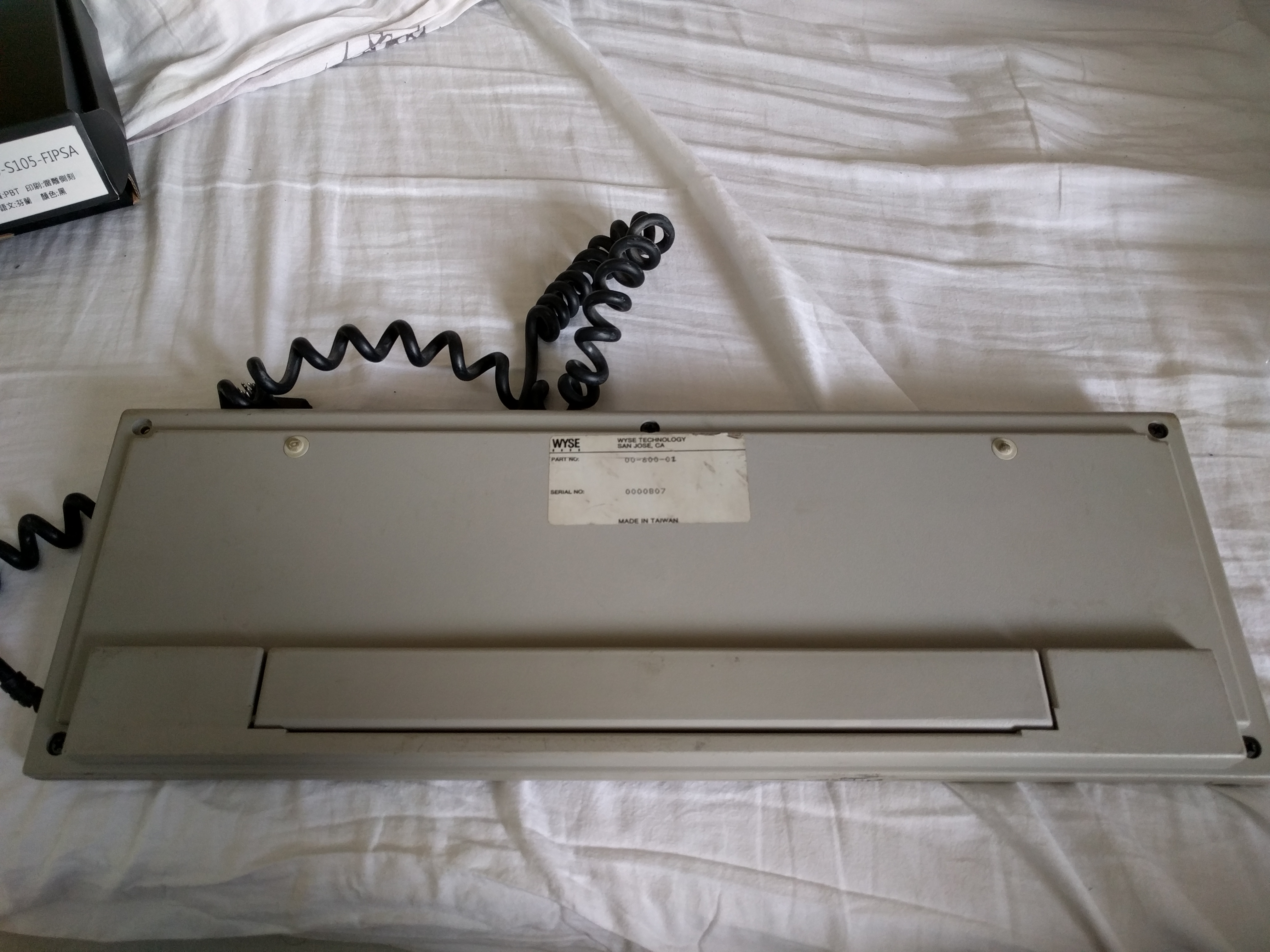

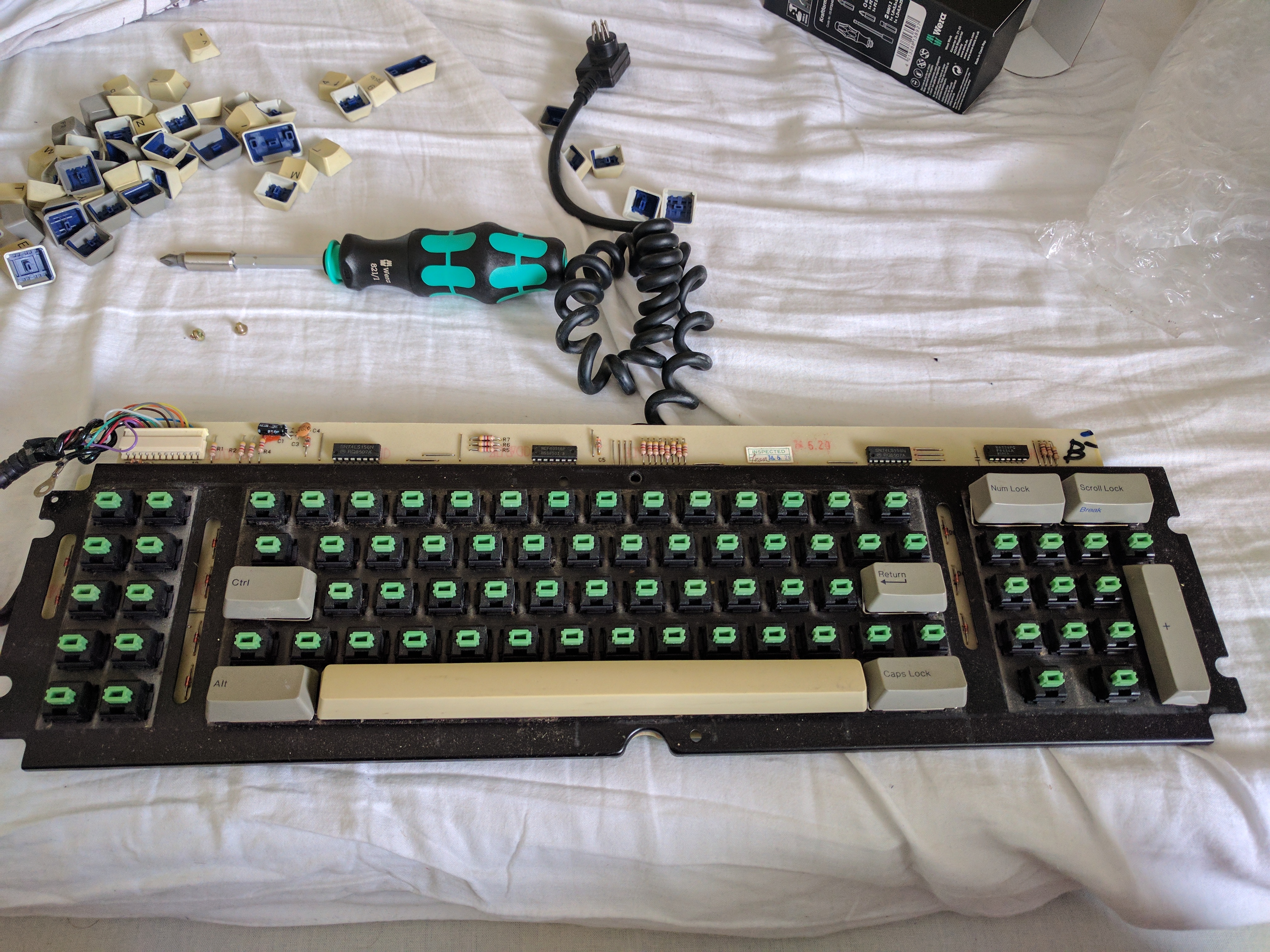

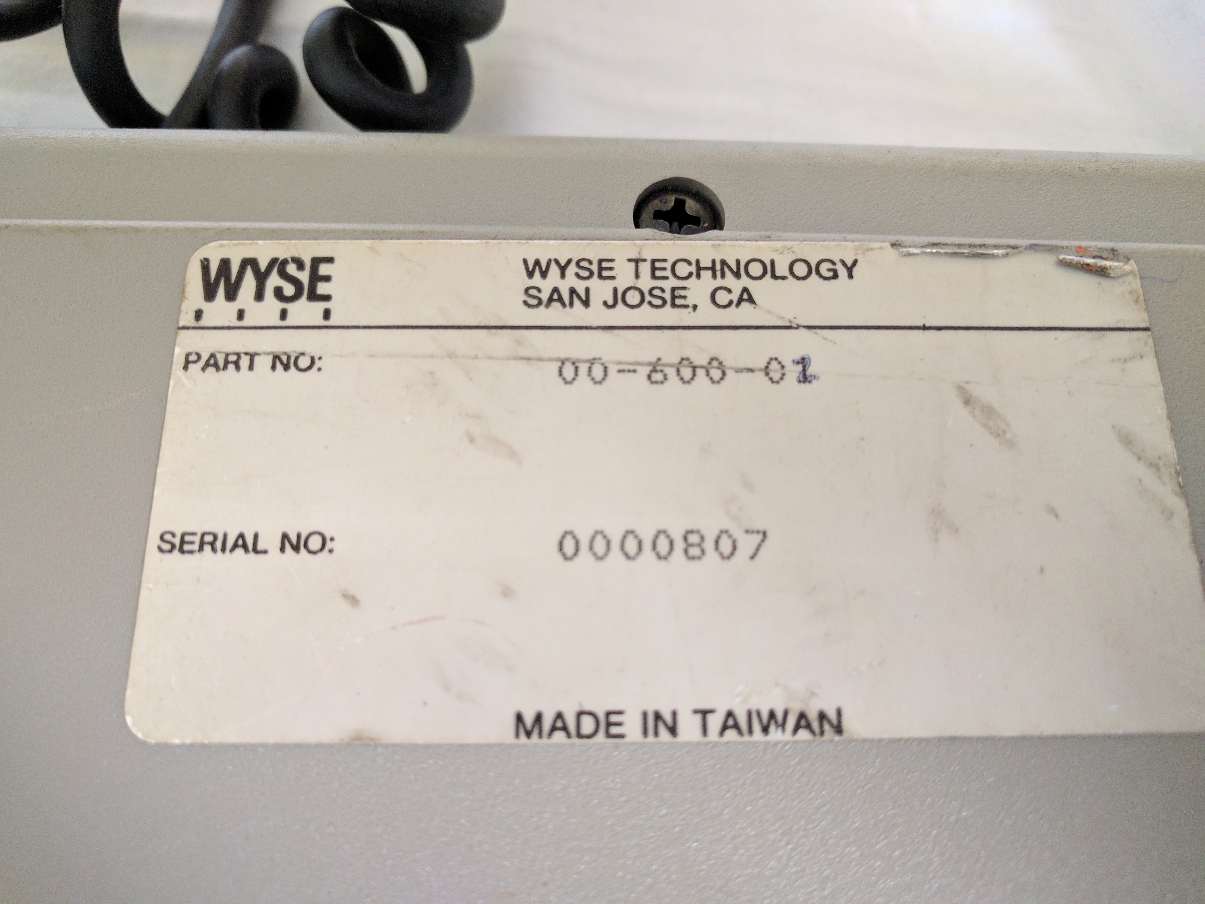

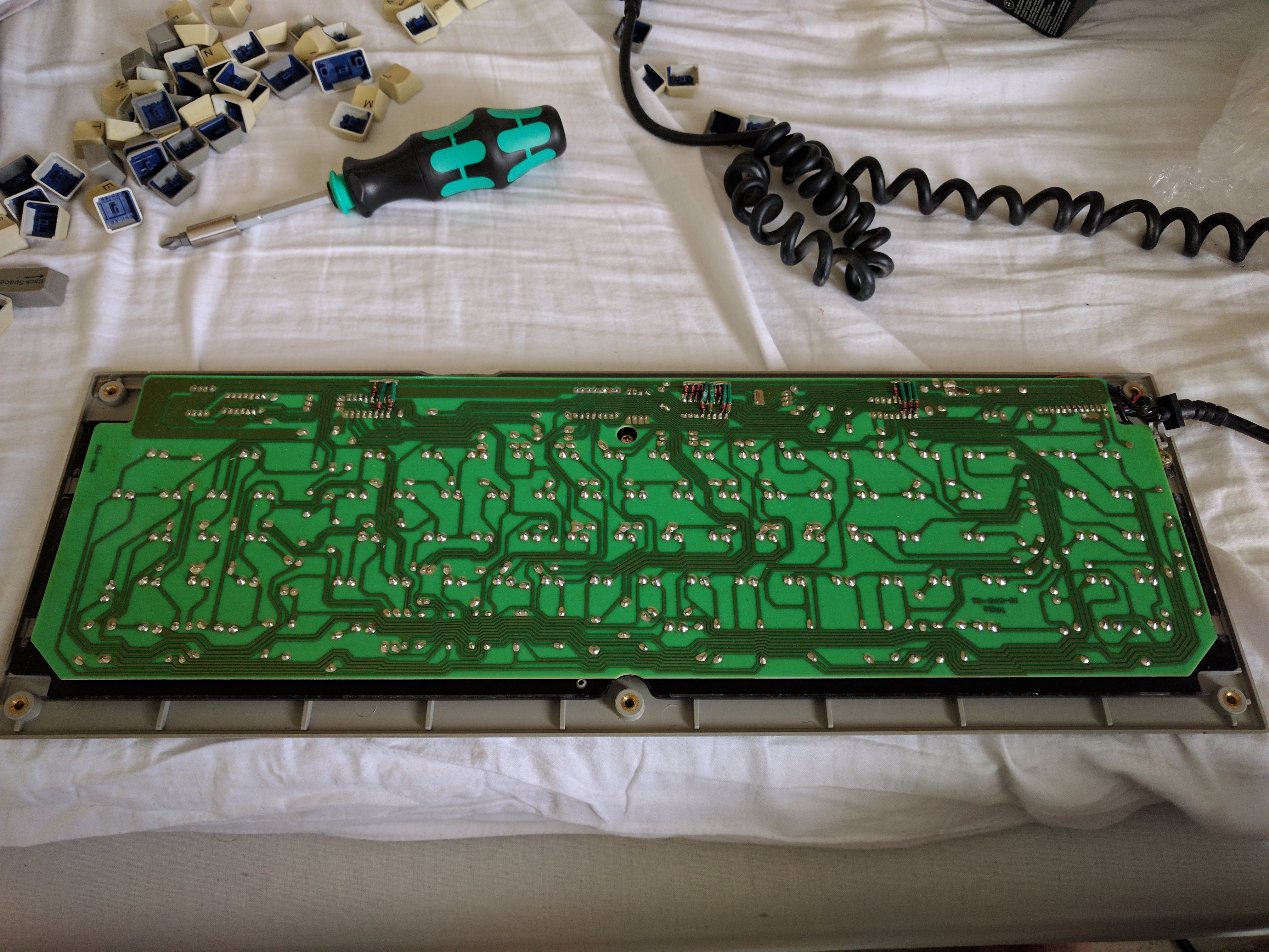

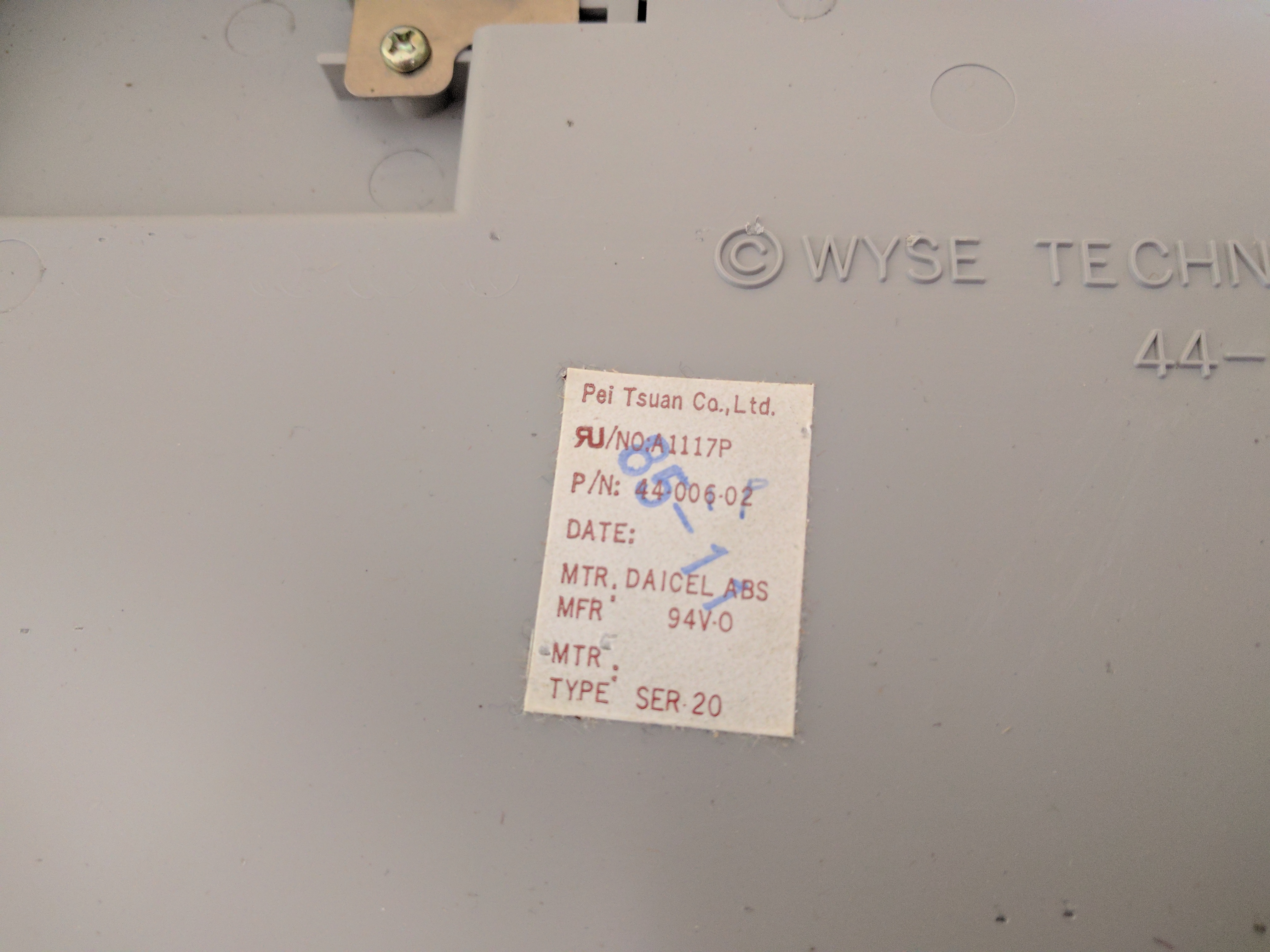

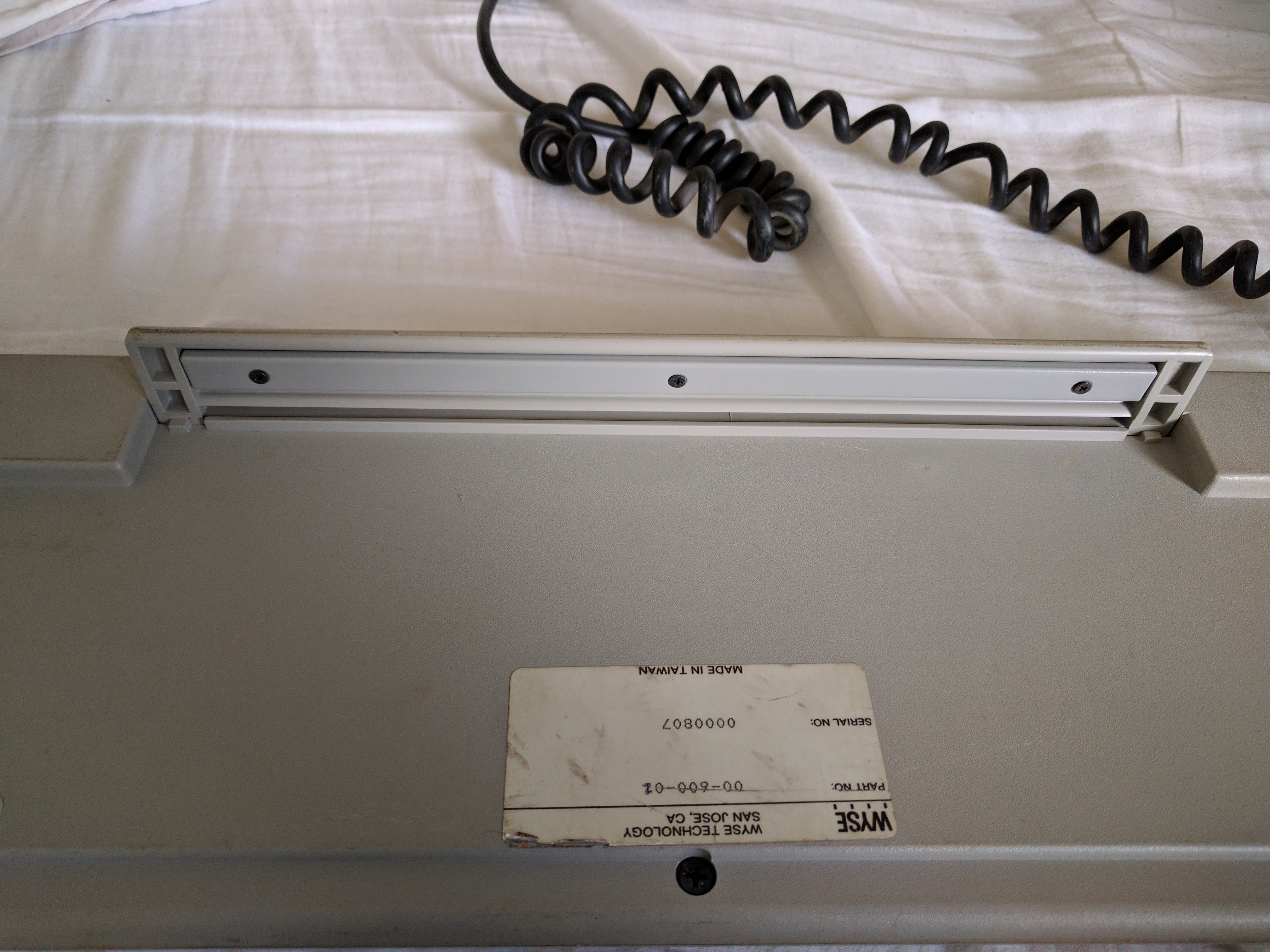

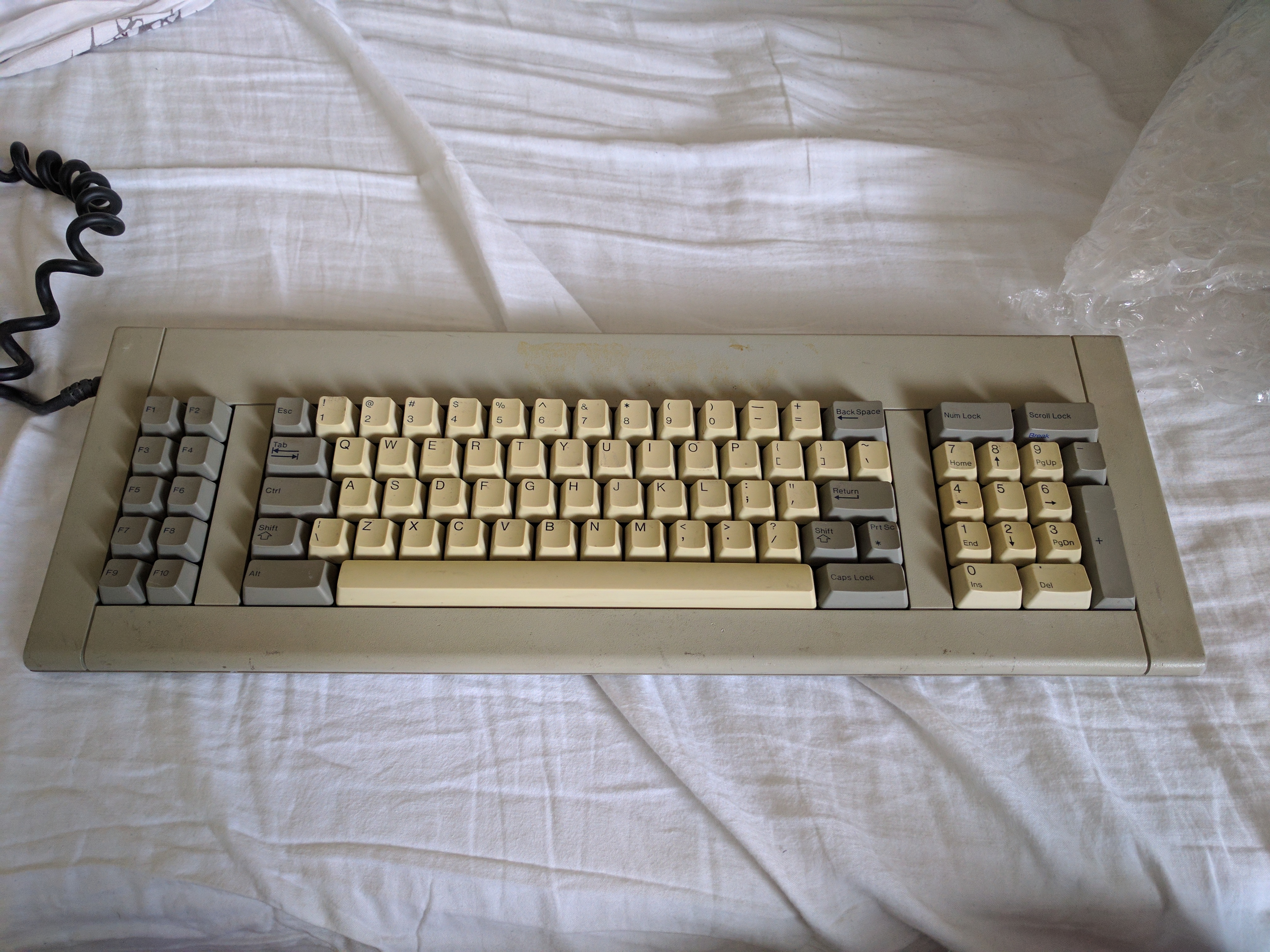

Oh boy oh boy today was like christmas. The green Alps board I have waited for nearly 2 months arrived today and it sure was worth the wait :mrgreen: I really like these switches as they are very smooth, have a tiny bit of tactility and they have great weighting. So now it's time for photos.
Feel free to add this information to wiki if my pictures and documentation are good enough
Backside of the PCB
Backside of the PCB

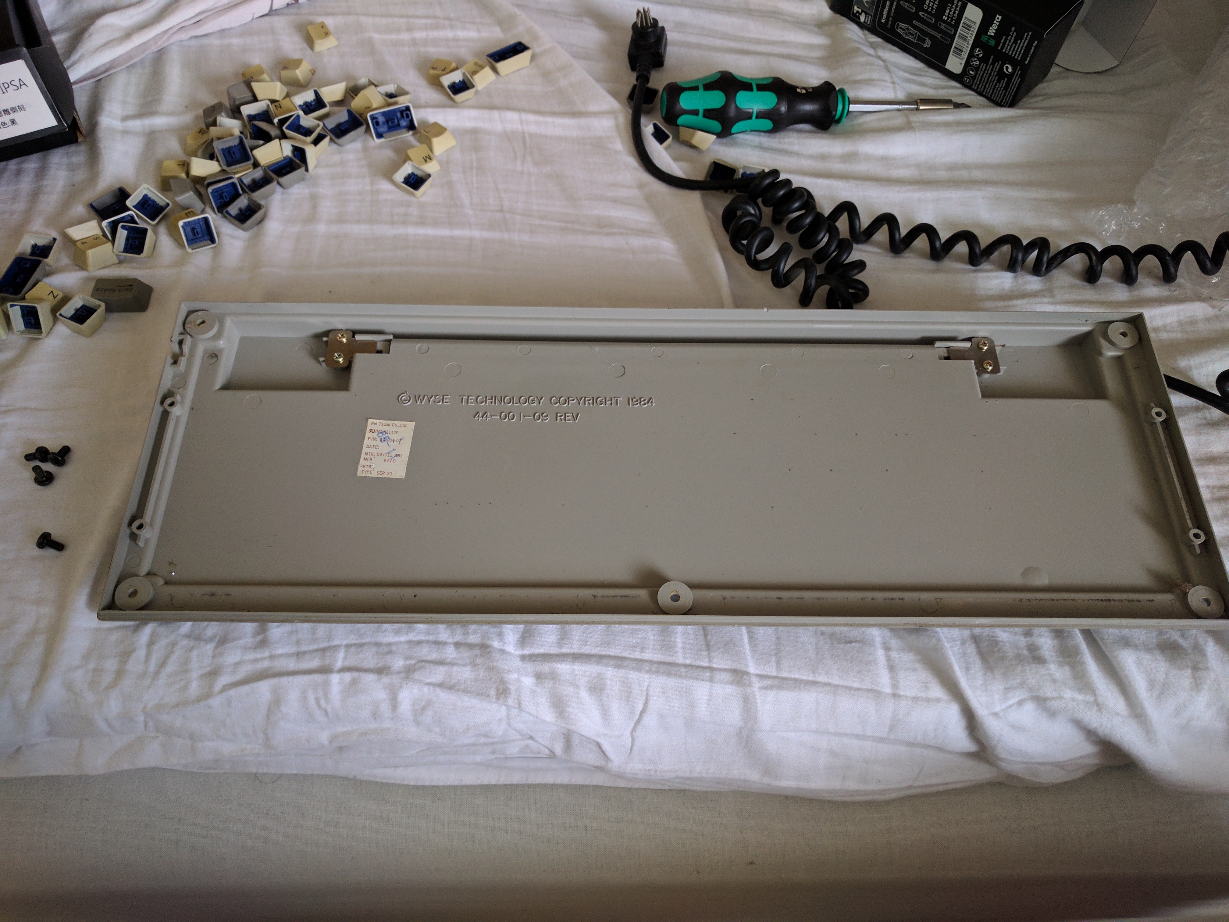

Overview of the other side of backpanel
Sticker inside the backpanel
Flipout foot
Flipout foot
Model sticker
Model sticker
Back
Back

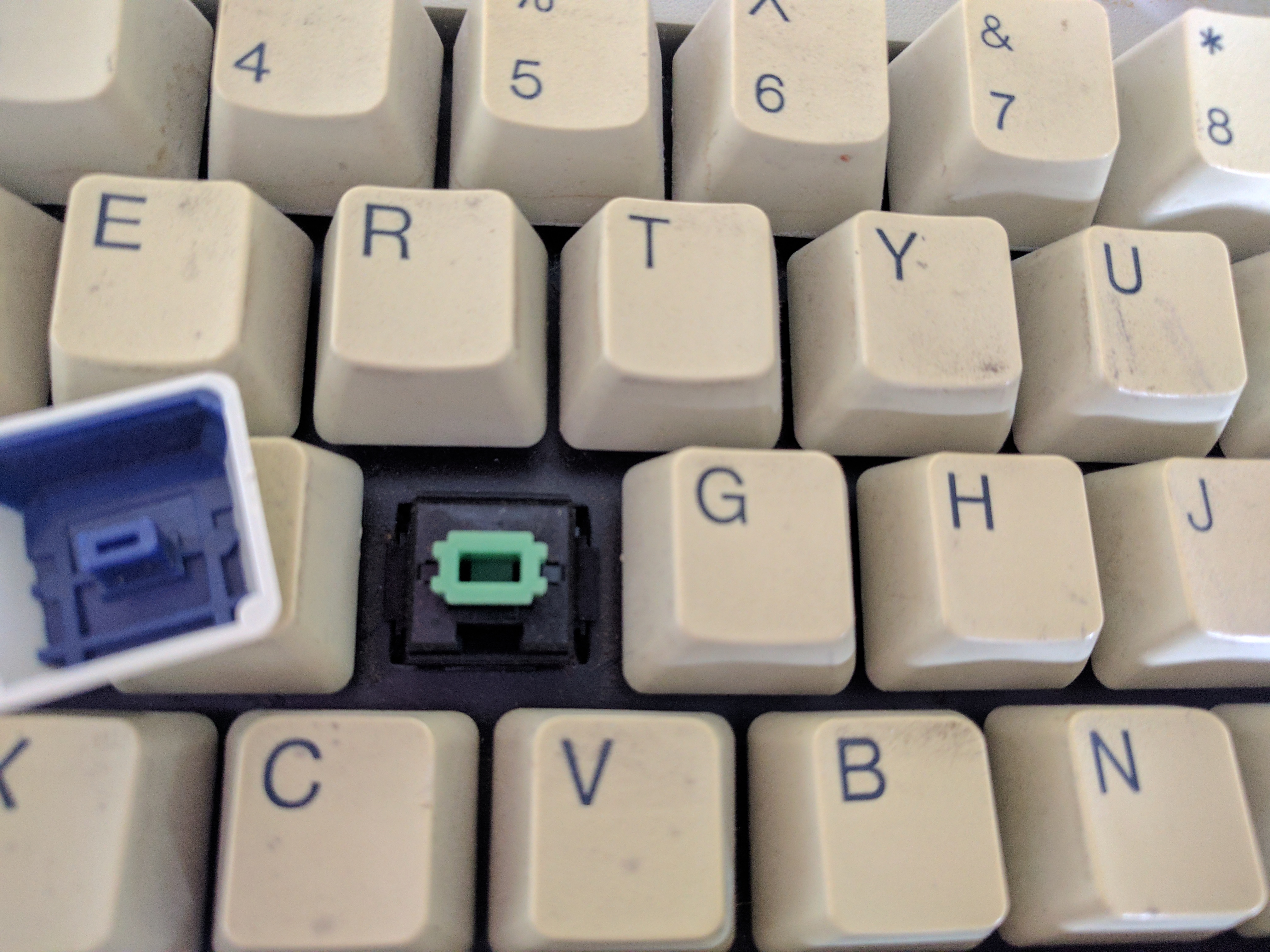

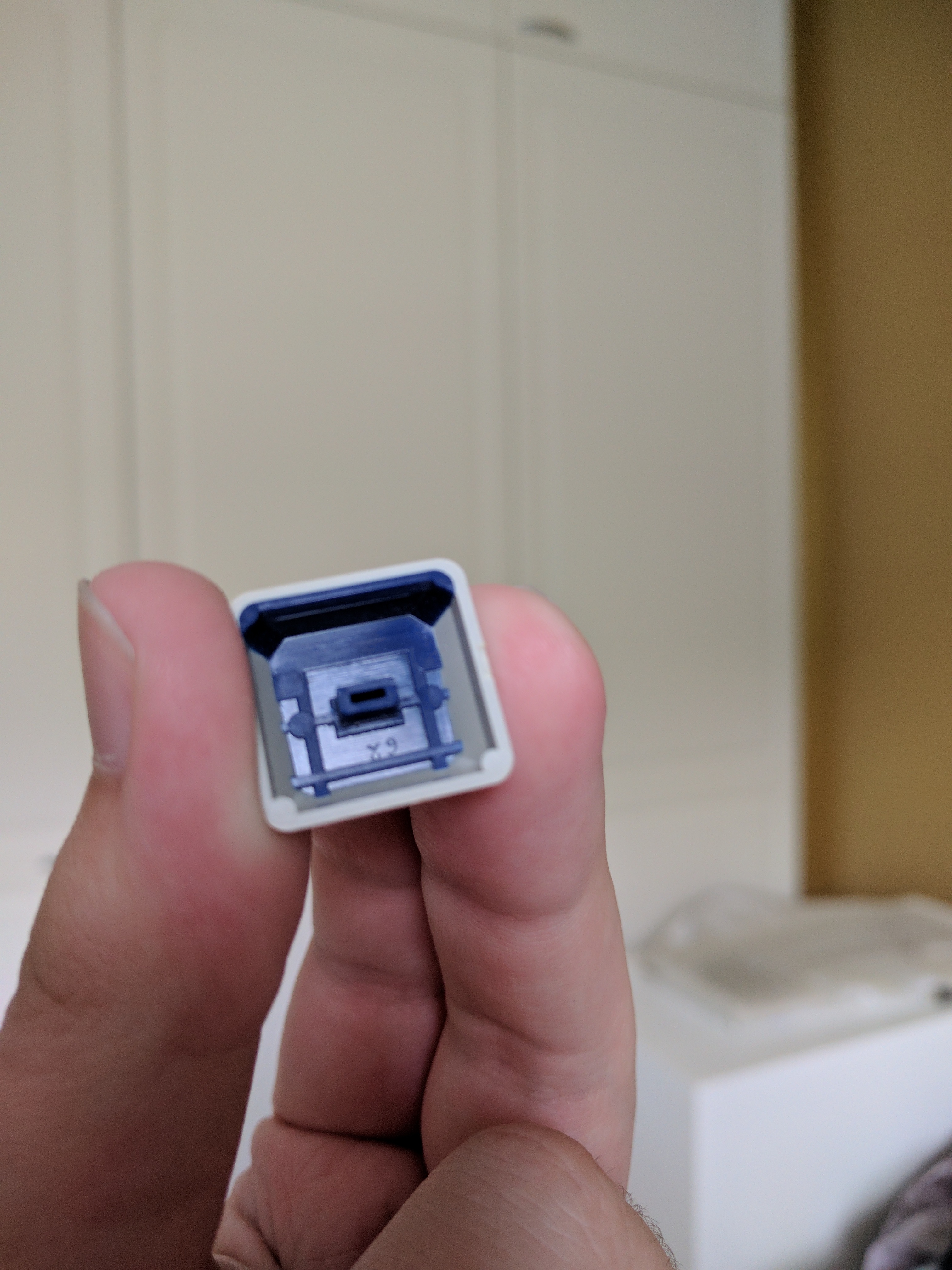

Doubleshot keycap
Doubleshot keycap
Alphas with keycap removed

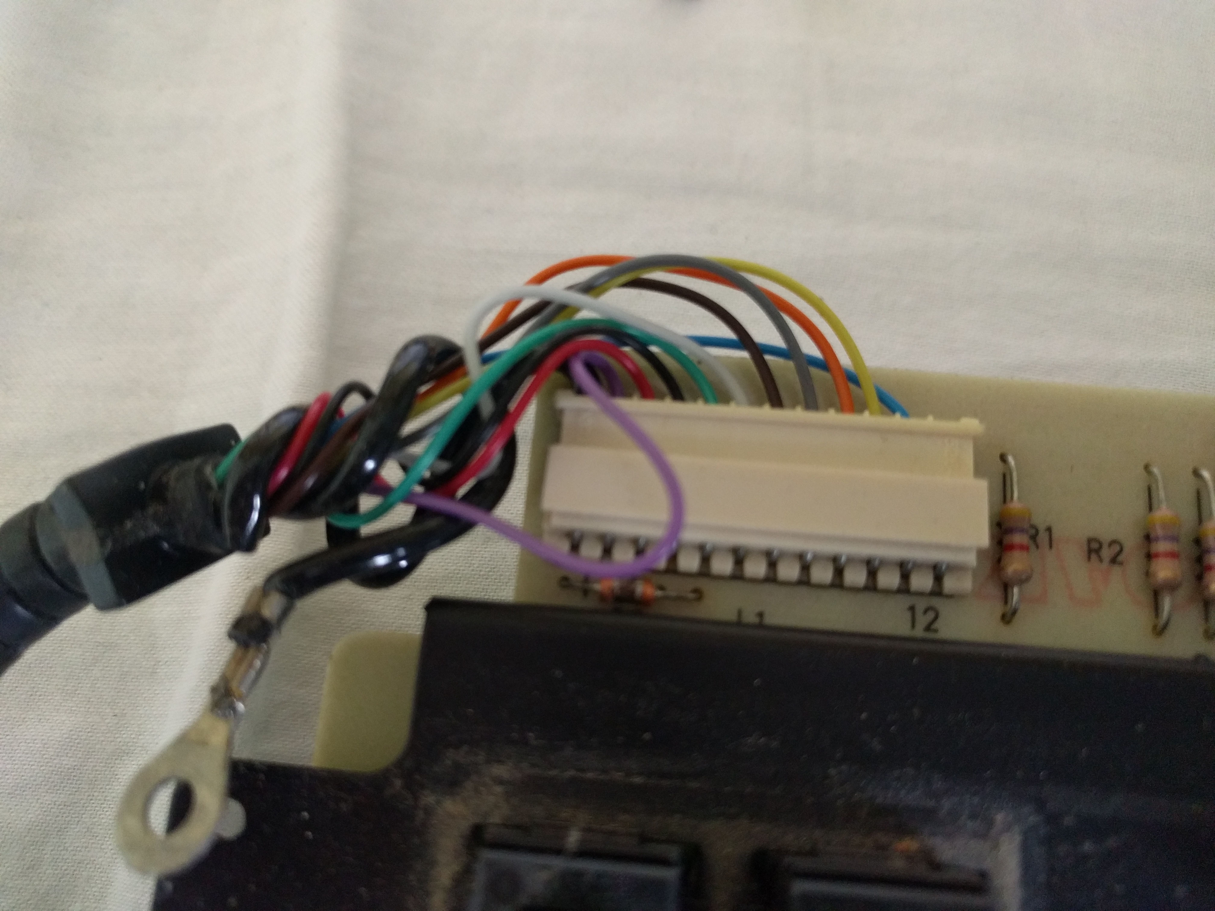

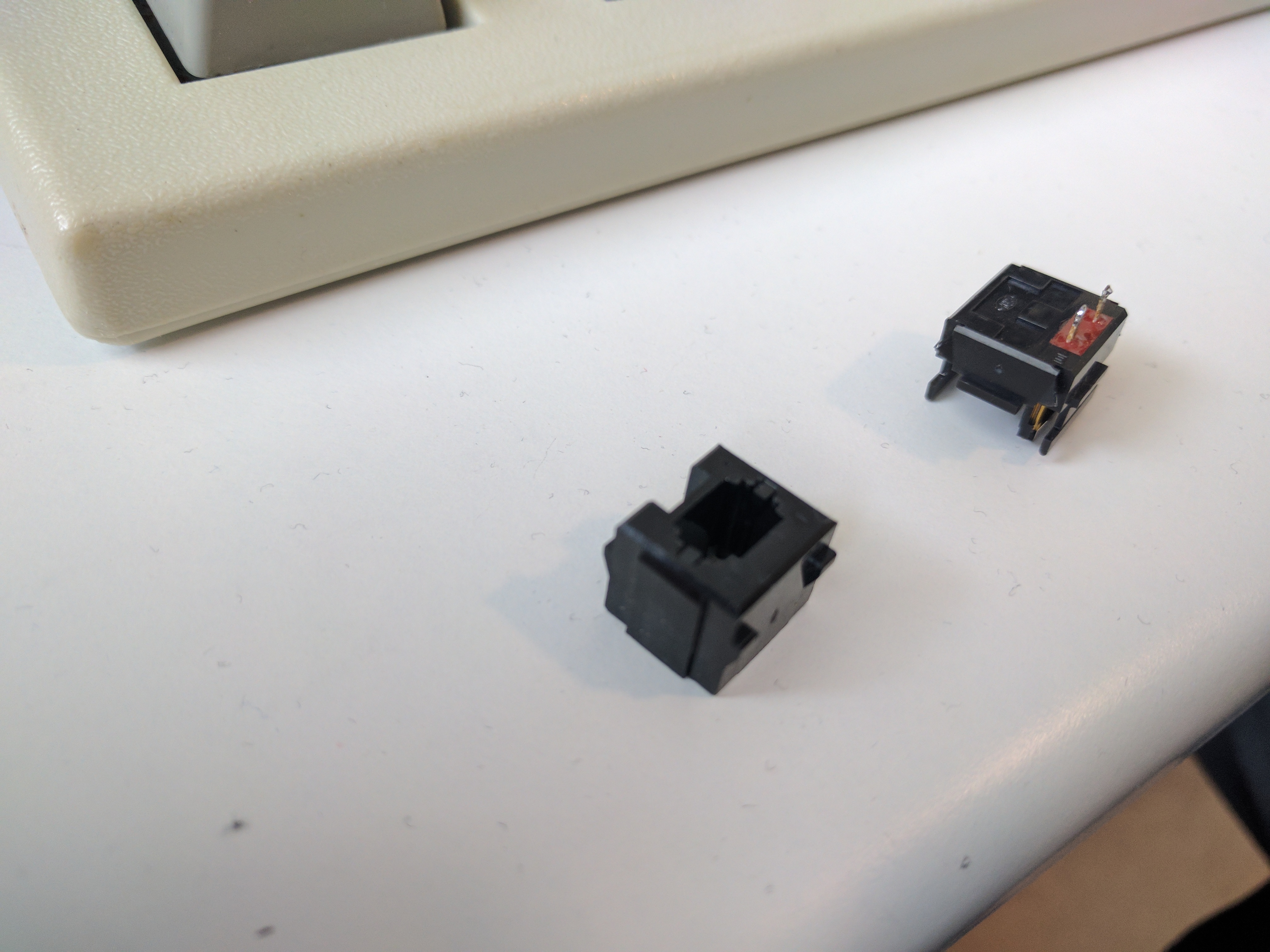

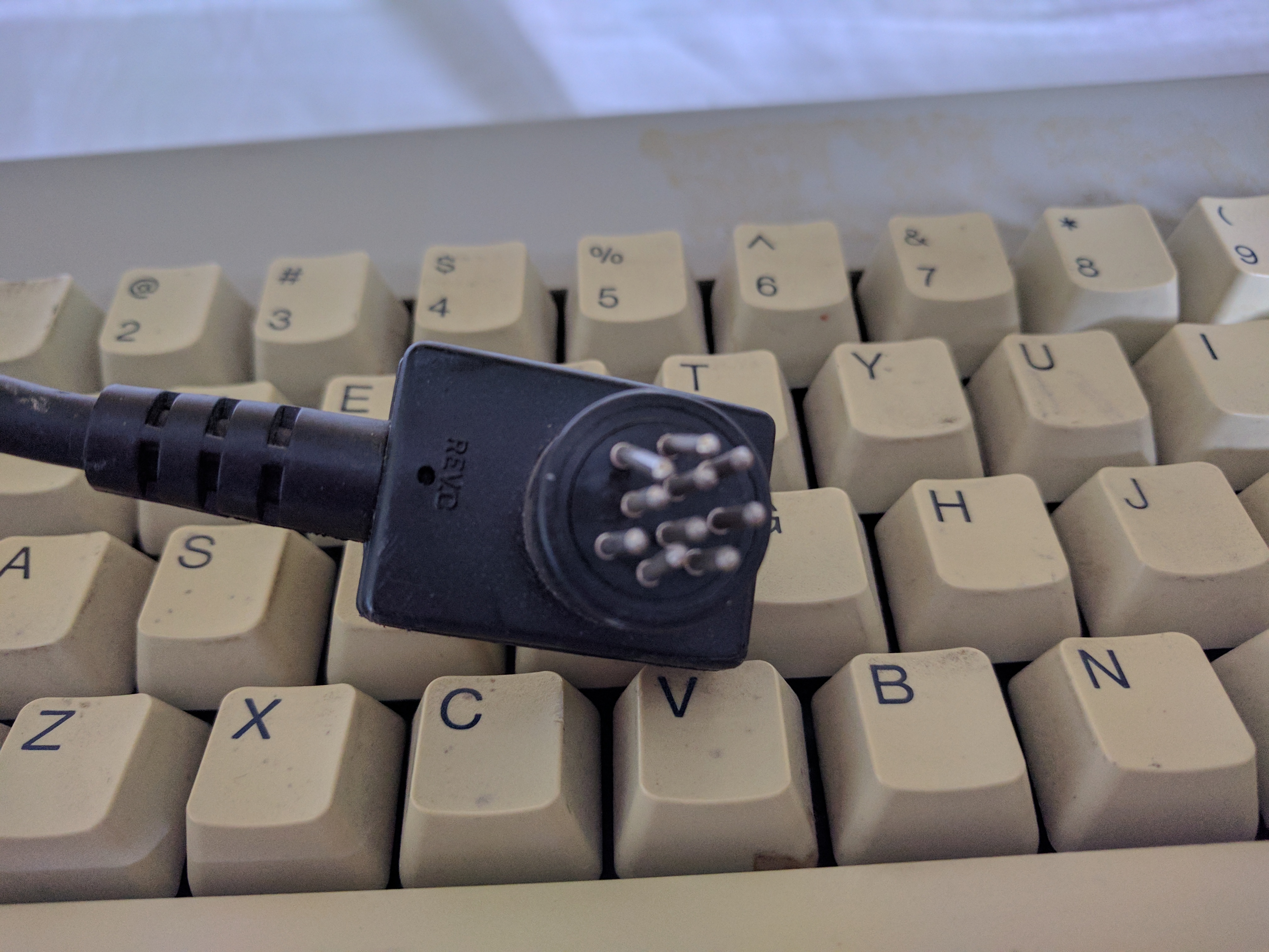

Connector
Connector
Overview
Overview
Some notes:
Keycaps are doubleshot blue on beige/grey
Some keycaps have mounts for stabilisers but no stabiliser installed
Model is Wyse 00-600-01 but the last number has written 2 on it as if it had a wrong label with the right one being 00-600-02
ICs are a mixed bag of 1984 and 1985
Seems to have diode matrix. I haven't finished desoldering yet
Switches appear to be in excellent condition
Despite the heavy yellowing there was very little dust and dirt inside
It has 10-pin connector so I have no clue about possible conversion with Matias switches as the layout isn't half bad
It has a metal weight in the monofoot and otherwise the casing is very light
More pictures to follow in the next post.

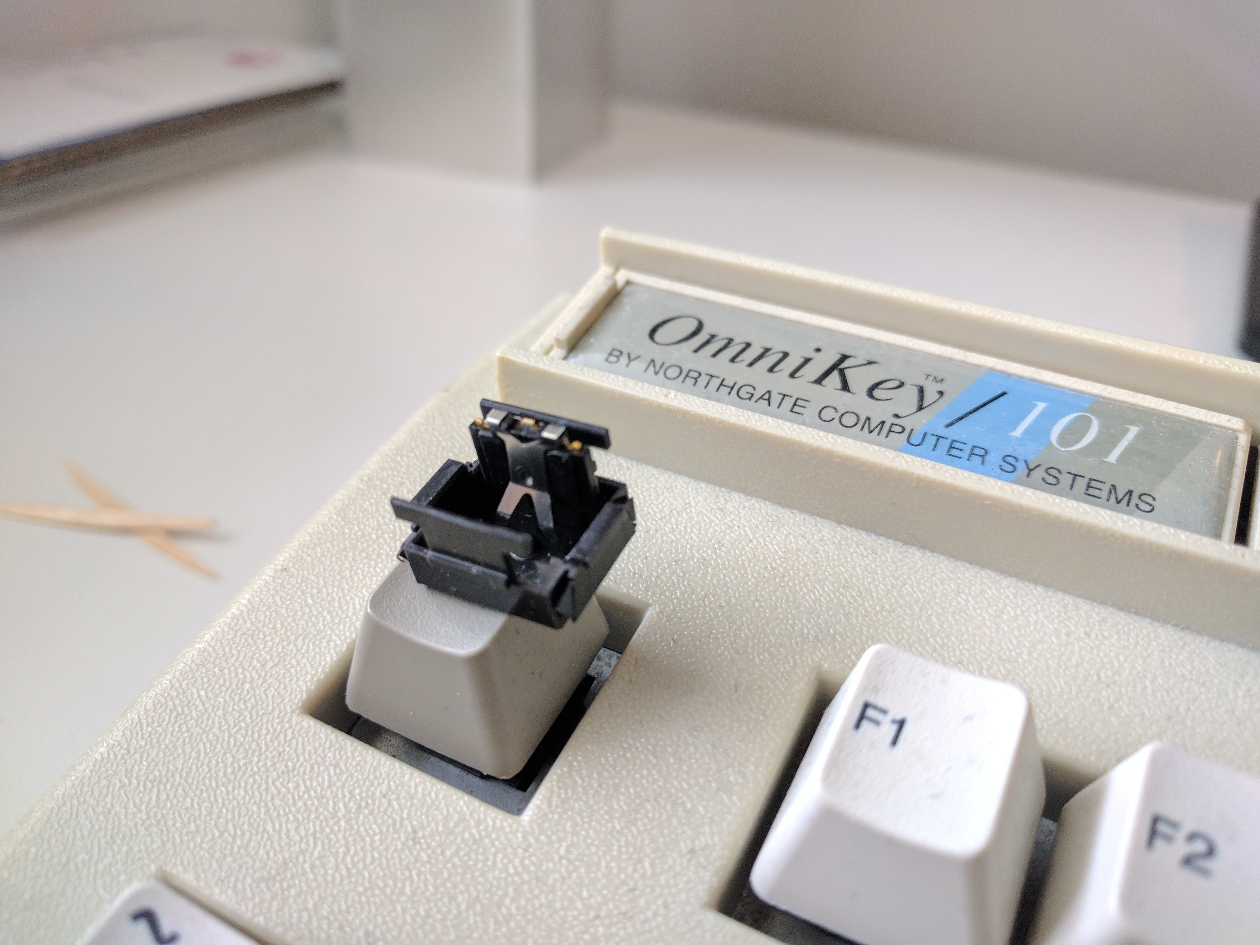

More pictures:

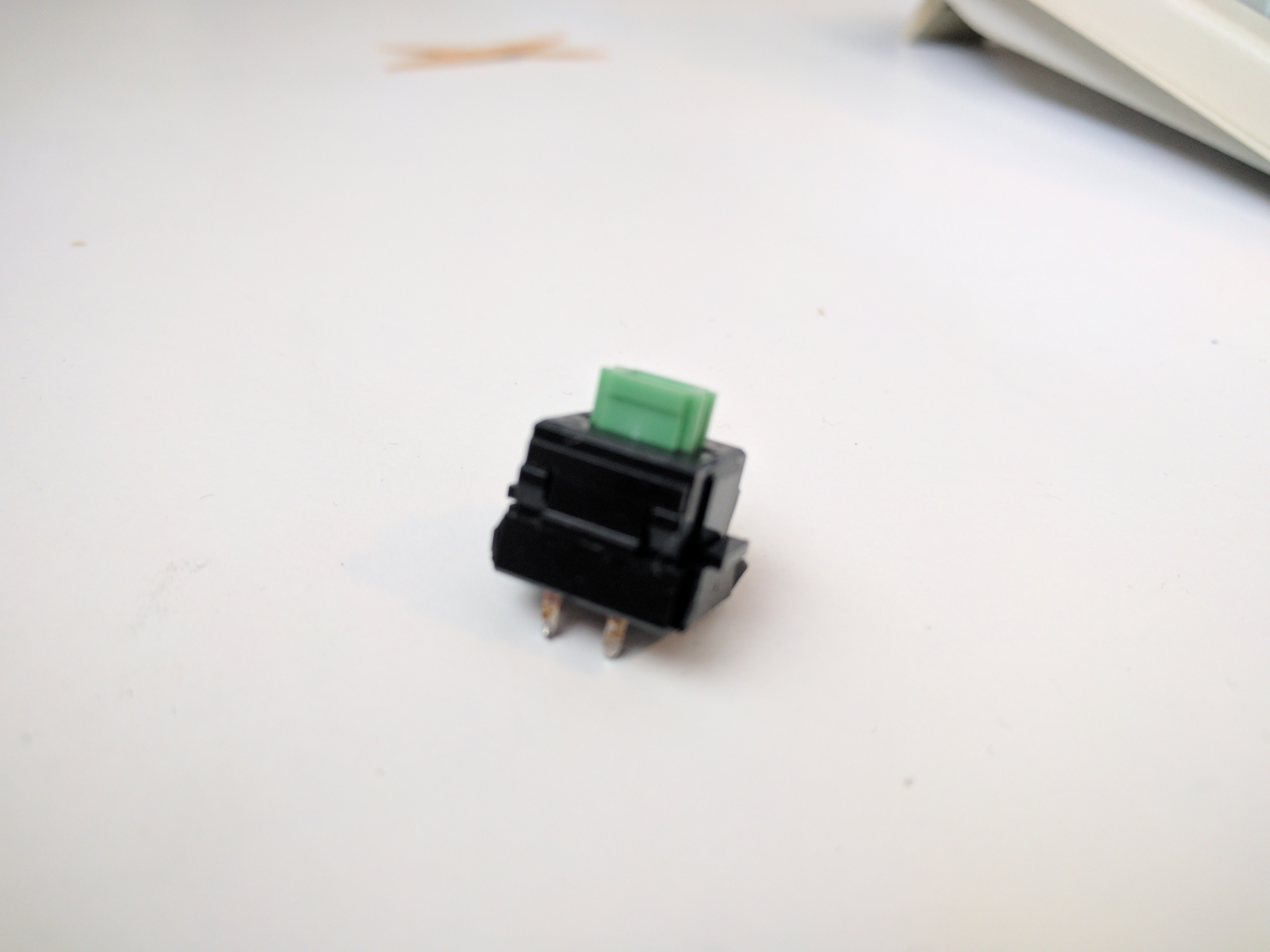

Assembled Alps SKCL Green

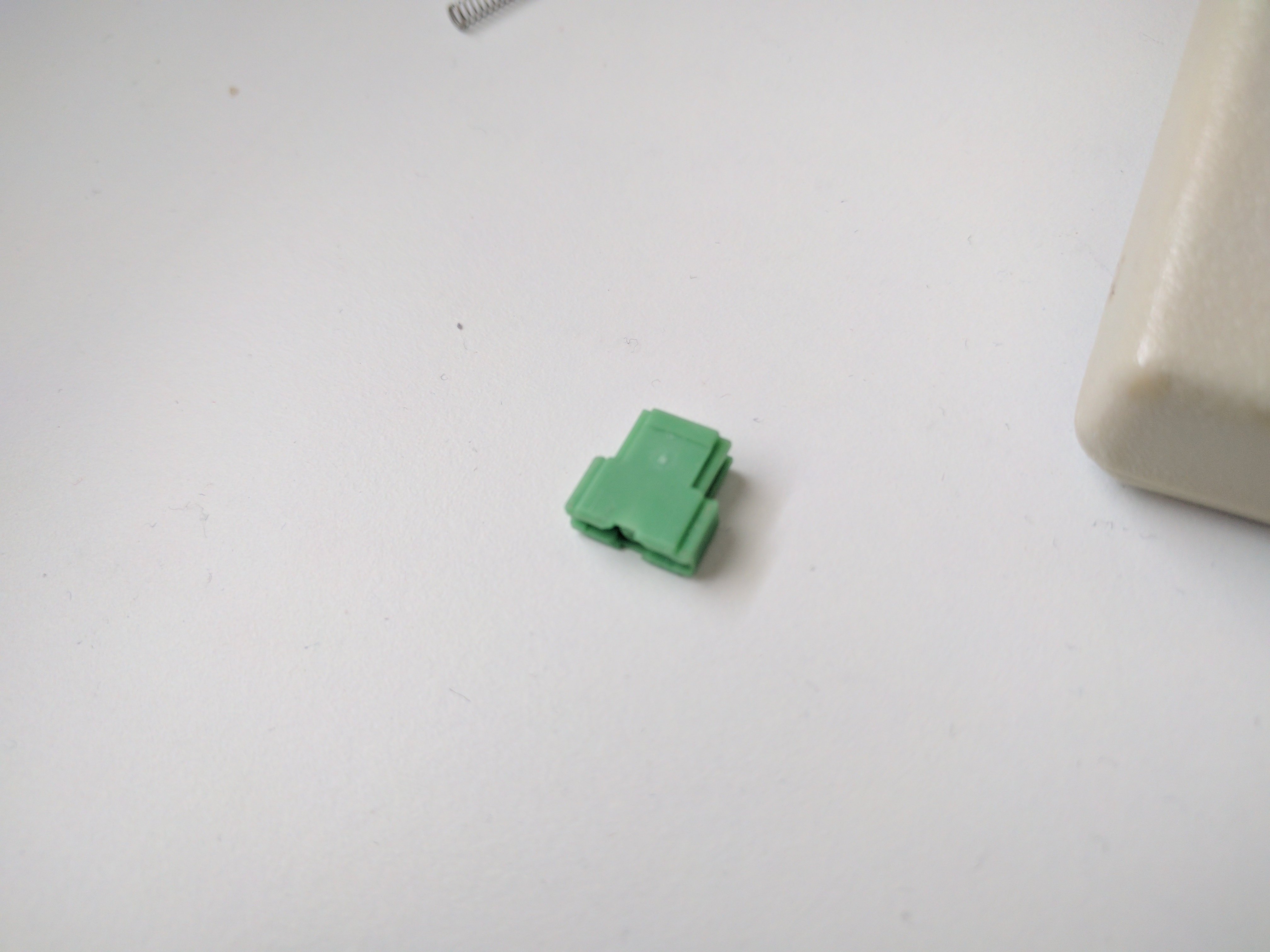

Slider
Slider
Top and bottom housing
Bottom housing with black switchplate
Didn't take out stabilised keys yet

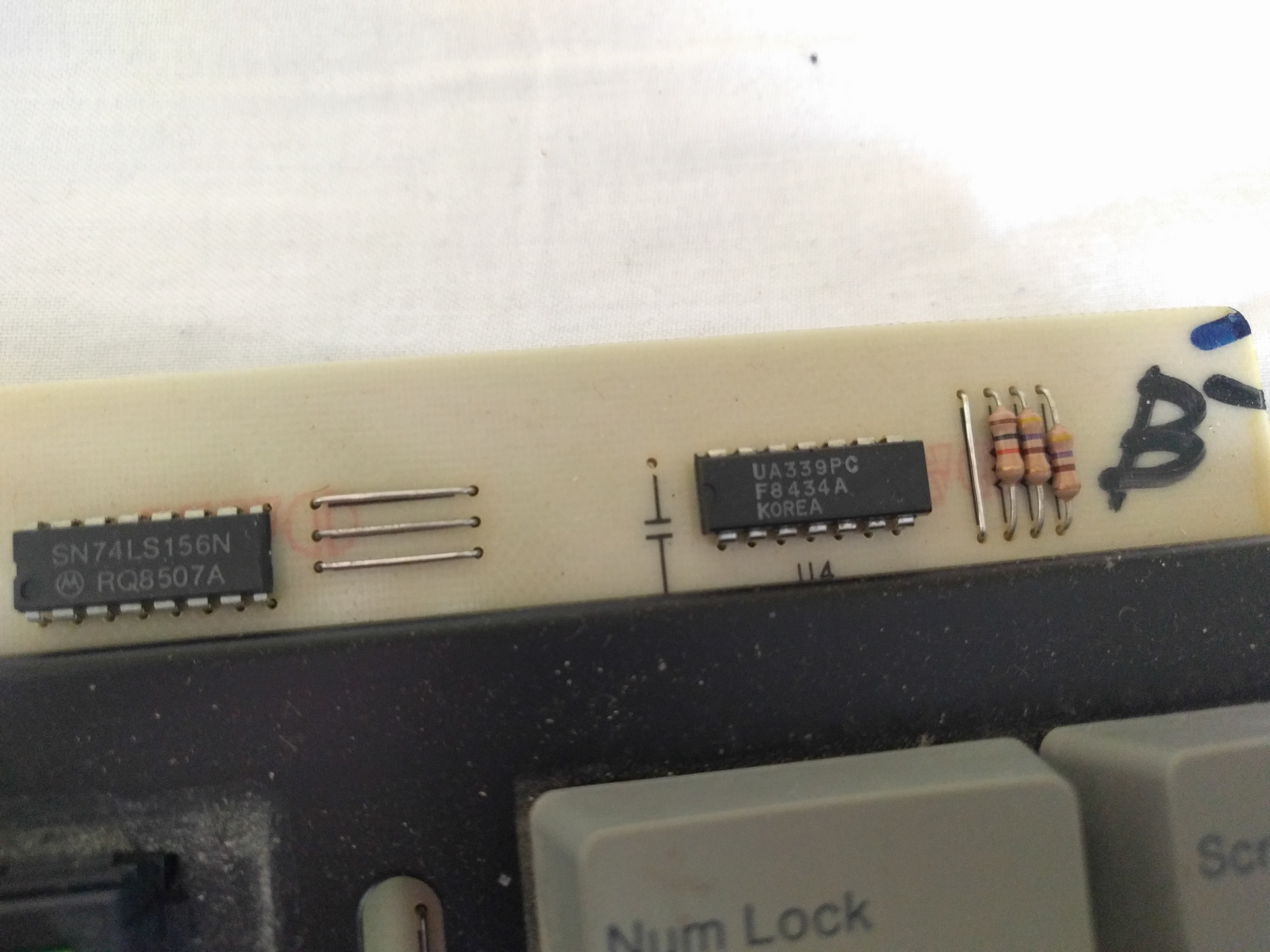

Some ICs
Some ICs
Connector at PCB side
I only managed to desolder the numpad at the time of writing this. Are there any tips to desoldering as with the solderwick it's going to take forever? Cheaping out and using my dads 80W non adjustible soldering iron is really taking a toll. After 30mins of use the front of the handle was uncomfortably hot. I really don't want to buy a new one yet as I got accepted to study electrical engineering at Aalto University and they have clubs and things like that where I should be able to use proper equipment. *Sigh*
I might put together the assembly monday and test it in the poker 2 case before I get the chance to finish the birch case. A really busy weekend coming and now that I have the parts I don't have the time :oops: Overall this project is finally getting near completion :D
02 Jun 2017, 13:41
A desoldering pump will help. You can also get a full desoldering gun that heats up like a soldering iron but they are expensive.
I wish you had said what you where doing i could have sucked them all out for you in 10 mins
