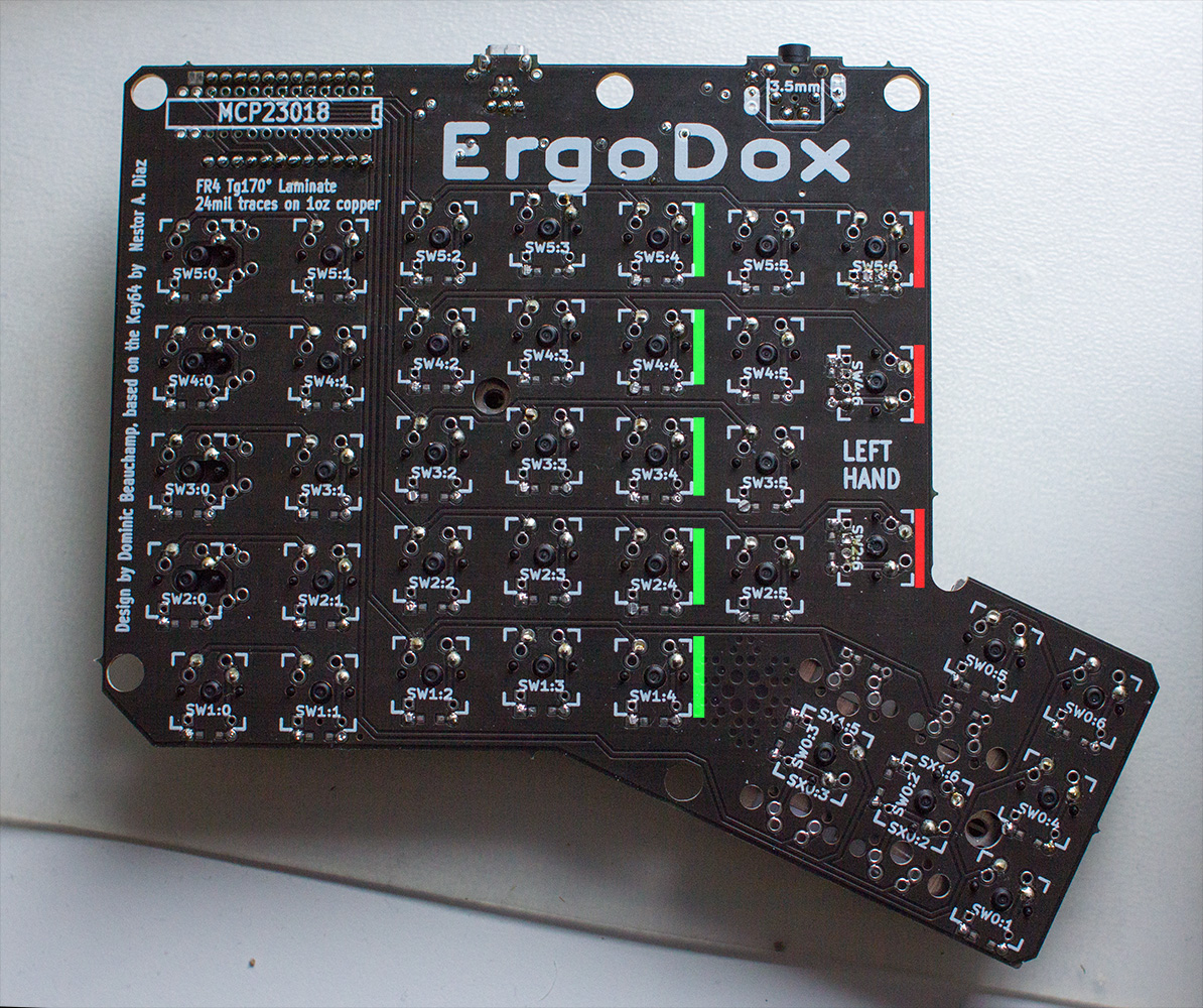

I unsoldered the LEDs from the red marked switches today. Since I'm finished with this the keys in the green marked column behave weird: If I press one of them, the key sends out his whole row. So for example if I press the M key, it sends out 0nm,./.
I already flashed some old firmware, to see if it has something to do with it, but it seems like a hardware problem. Looks like I broke something, but I don't know what and how.

Interesting. Do all the other keys work correctly?

Well, looks like you somehow managed to connect all column wires through a diode to your green column. Or maybe something else.
Maybe a picture of the other side of the PCB?

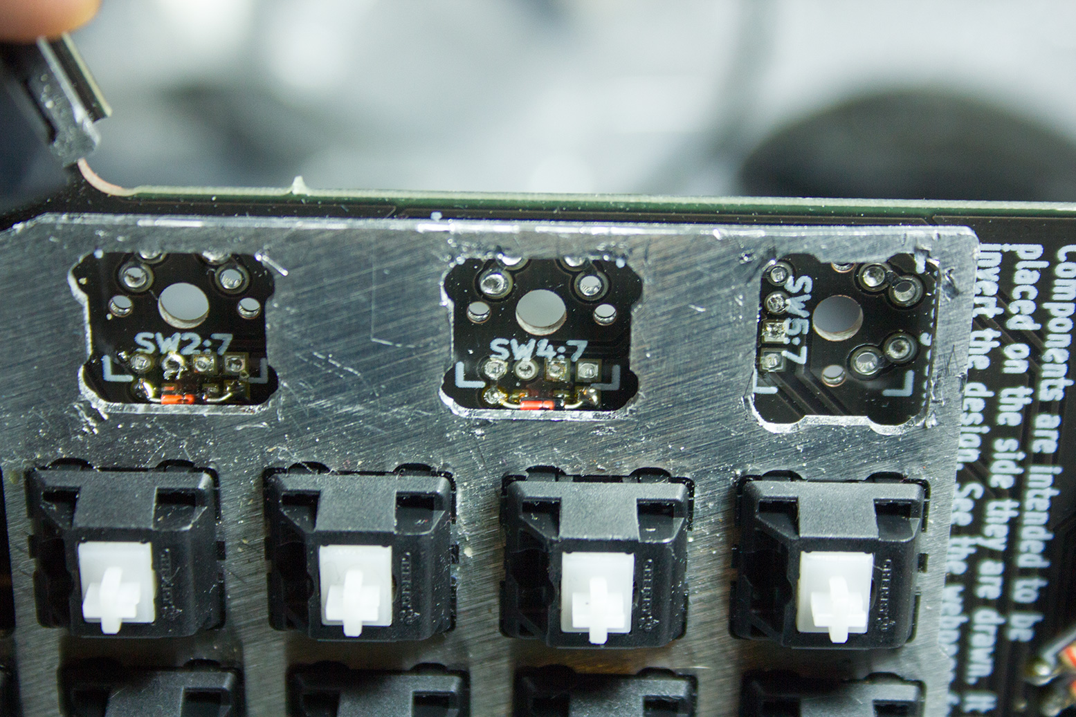

Maybe you can provide a better picture from the three switches you unsoldered the LEDs from? The red marked ones. The LED holes look somewhat dirty, maybe there is some solder left and causes a short.

Good call and the PCB IS dirty. It doesn't look pretty good what I've done to the solder points.
By the way the keys worked yesterday for about 20 minutes like they should do, so I guess it is just a tiny contact which was added/destroyed

I do not know the layout of the ergodox pcb. But for my handwired keyboards, a matrix scan works like this:
All pins connected to columns are configured as inputs with pull-up resistor activated. So input is read as high for now.
All pins connected to rows are configured as inputs with pull-ups deactivated.
When the matrix is scanned, the first row pin is configured as output and set to low (source sink). When a key in this row is pressed, the connected input pin of the column is pulled to low and is read as low now. All input states of all column input keys are checked. A low state for a column input pin indicates a pressed key for this row and column. Repeat for all other rows... Depending on the layout and firmware, rows and columns may be swapped.
There must be something that connects column 4 to all rows 1-5 when pressing one key in this column.
I wonder how this can happen by desoldering LEDs in column 6.

Thank you anorak. I guess this HAS to be the problem, but I can't find something which looks like this. There isn't something on the bottom side of the plate and I tried to see something by looking between plate and PCB, using a flashlight, but couldn't find something suspicious too.
I already removed the three switches in row 6, but even from the top side everything looks pretty ok.
So I guess the whole issue doesn't have a direct connection to this three switches in row, maybe something else happened, while unsoldering the LEDs in row 6.
