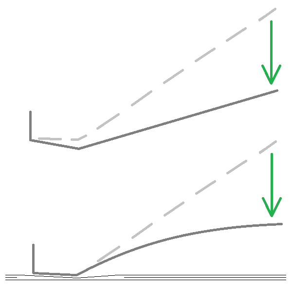

The coil spring size is irrelevant (and it's not length that matters but material, wire gauge and turn density). Longer springs are only "heavier" because they're fitted into the same space as a shorter spring; for y=mx+c, you're simply increasing c, while the alleged figures for MY had a lower c (preload) and greater m (weight).
I didn't remove either the coil spring or the leaf spring for the test: that would be pointless. What I wasn't testing was blocking the motion of the leaf spring. The feet of the switch are in fact the exact distance apart as the tail of my caliper, so I can use that as a makeshift membrane assembly.
The leaf spring contains two folds. The first fold is simply to create the retaining tab. The second fold creates the point where pressure is applied to the membrane: this fold delimits the short horizontal portion of the leaf. If you rest the actuator on its feet, the leaf spring is flexed entirely about the first fold, which with the helical spring gives you a linear switch with reasonable (Type 3) to excellent (Type 1) feel and the same weight as MX Black.
However, if that second fold is blocked in, then the horizontal portion of the spring can't move (in reality it will move less than a tenth of a millimetre), and thus the long tail of the leaf spring is bowed by the slider. This is when the switch gains its "dead octopus" feel, and indeed it does feel bad.
MY leaf spring.png (6.86 KiB) Viewed 1318 times
A head-to-head press with MX Black shows MX Black to be heavier at first, and then lighter, which is consistent with MY having a lower preload and heavier weight.
As for Type 1 vs 3, I would say that Type 1 is heavier and more spongy feeling: Type 3 has a lighter and cleaner feel, although it still feels terrible. This is curious as the consensus of opinion holds Type 1 to be superior. Type 1 is certainly smoother, and if I hold them to my ear and press them slowly, both MY types are virtually silent, with MX Black being distinctly louder, and MX Linear Grey being much louder with a clear scraping sound.
