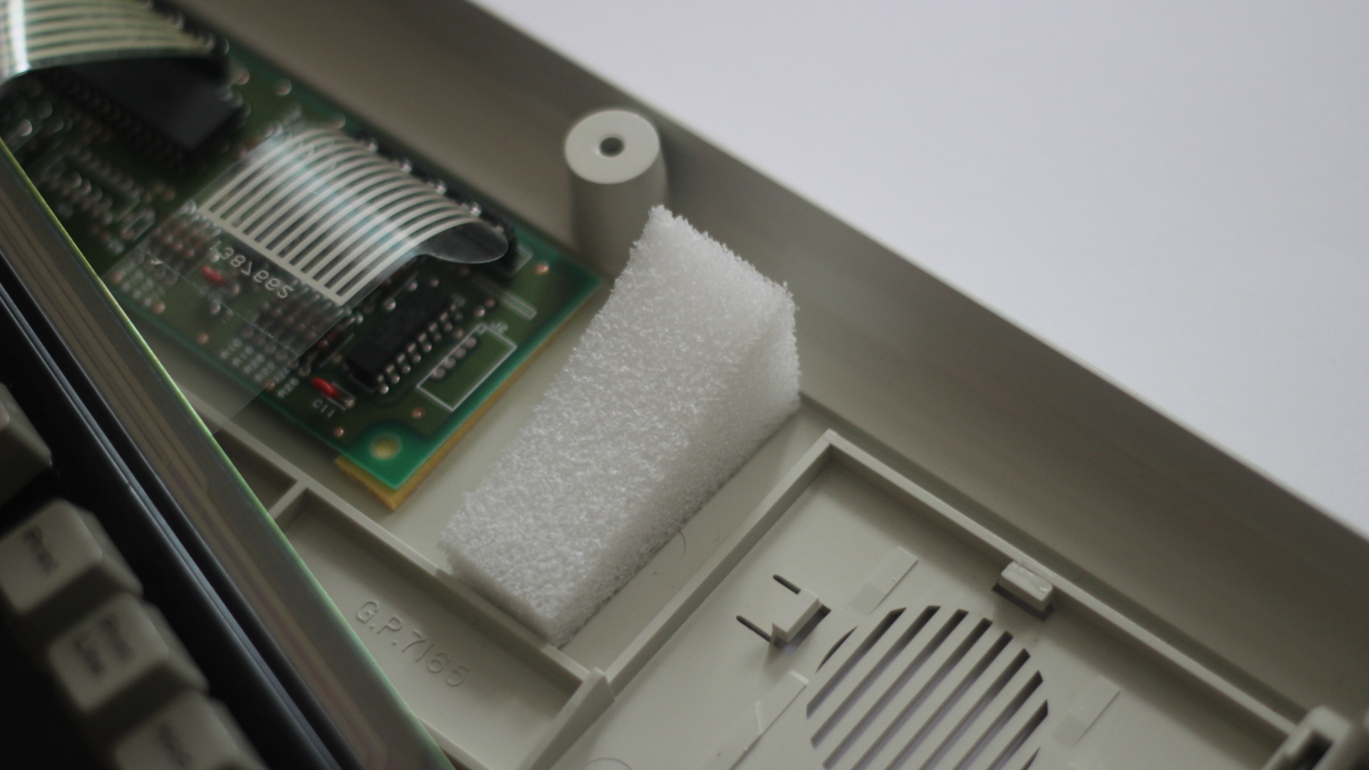

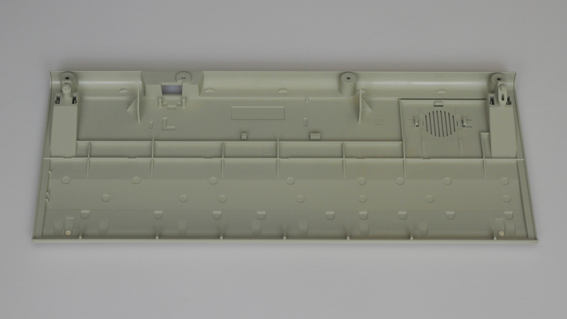

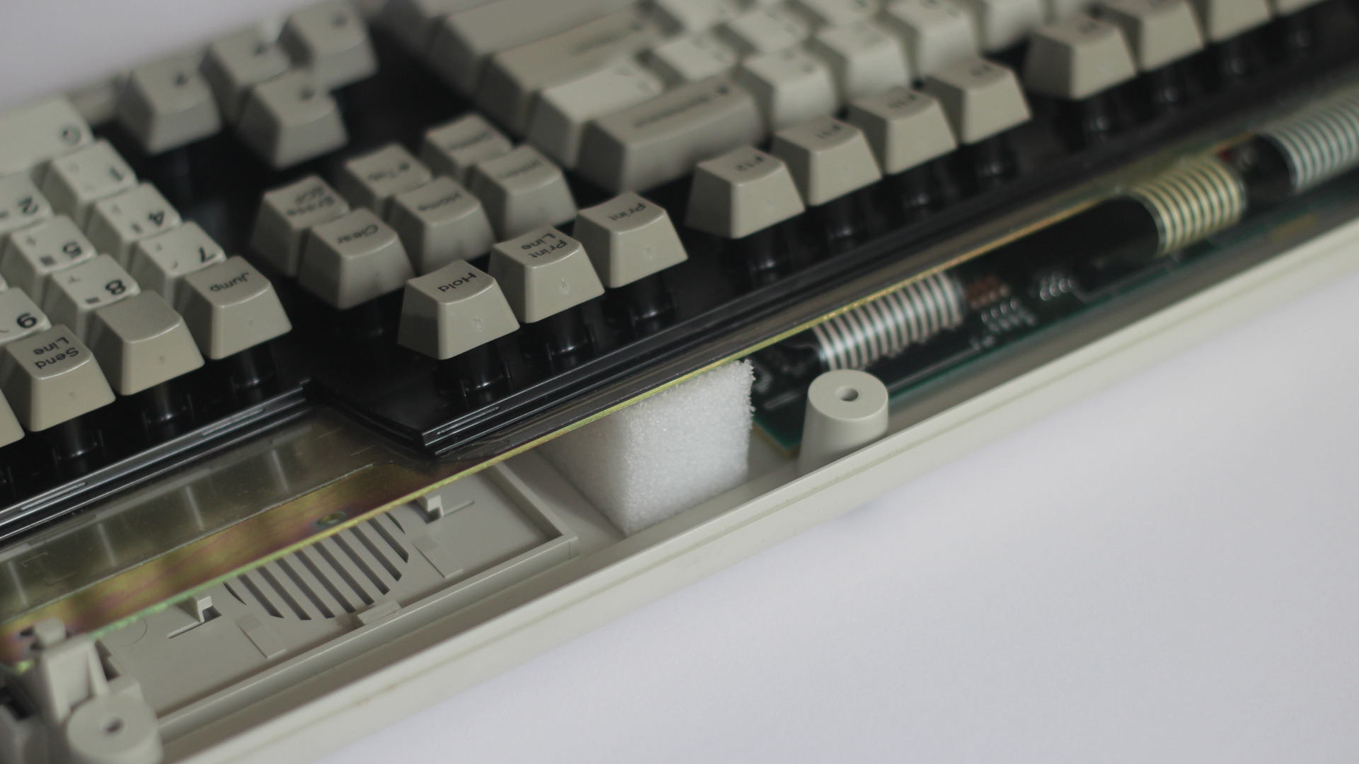

Lexmark was reuqired by contract to provide replacement parts. So this is probably a keyboard from 1996. The early Model M keyboards from 1985 and 1986 had a small styrofoam part under the metal plate. This was later replaced by a plastic pole reaching up from the bottom shell.
IBM Model M terminal 1386303 from 1985-06-13 with polyester support for keyboard assembly
IBM_Model_M_terminal_1386303_19850613_polyester_support_for_keyboard_assembly_1920x1080.jpg (270.03 KiB) Viewed 10477 times
IBM Model M terminal 1386303 from 1985-06-13 polyester part supporting keyboard assembly
IBM Model M terminal 1392595 from 1987-06-16 bottom shell with pole for keyboard support
Nevertheless very rare specimen.

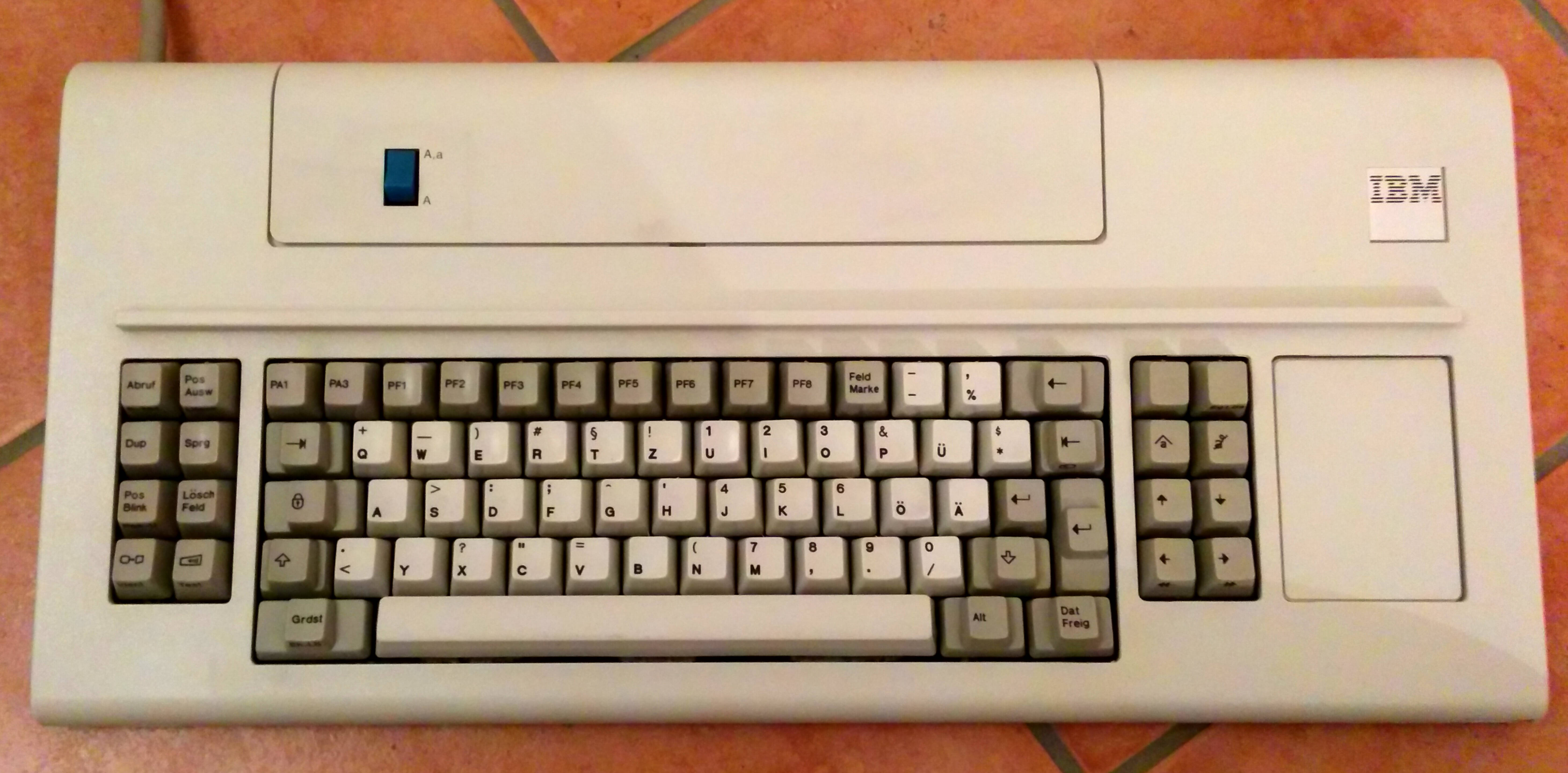

We are "chill"! :maverick: For some strange reason the cases on those 3178 are not as sturdy as most other F's especially the XT, you should be happy yours is undamaged. I never had a closer look at my 3178 like I did with my 3104 but the keycaps are nice with the lower case:
