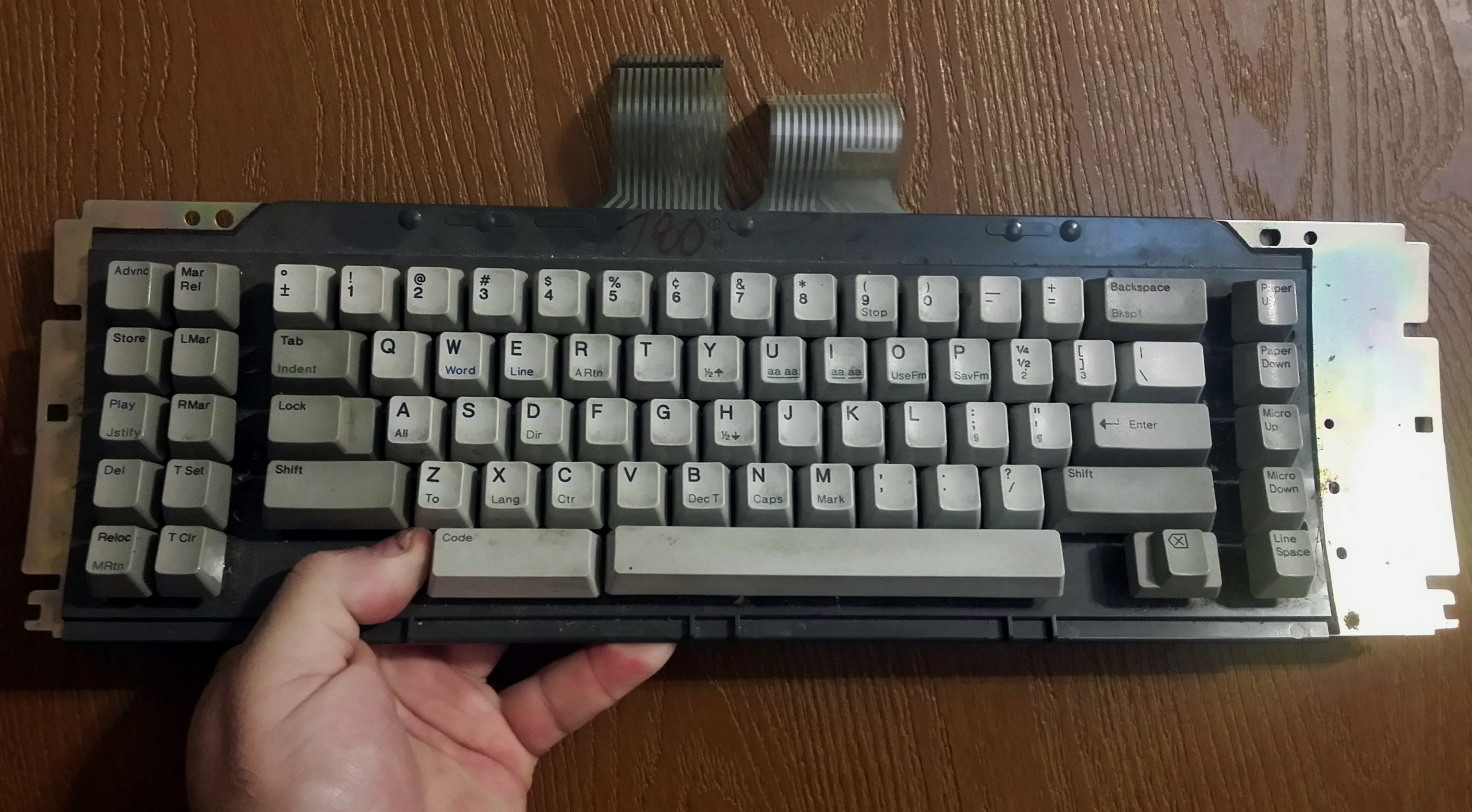

I have been in need of a new keyboard since moving into my new office and decided to dig through my collection in storage a couple of weeks ago. Nothing really got my attention except my Bulgarian IZOT/Pravetz board which is way to massive. So I decided to build a compact custom based on a Pravetz-82 I found online and have some extra switches on the way for that project.
Fast forward to this week and I was back sorting through some storage items and came across my old Wheelwriter2 and realized that the keyboard on it was fairly close to what I was looking for in layout and size. So I harvested the keyboard and now have a new project. I still plan on doing the Pravetz build,(I prefer linear switches) but this seems to be a more efficient means to an end for the time being. As an added bonus I now have a lot more shelf space with the WheelWriter gone.
I haven't decided on a controller yet but will make a few layout changes, I would like to use the left hand function keys for a navigation cluster, left hand enter, Esc, control, and alt keys. I will also put together a custom compact case as well.
- wheel writer.jpg (861.96 KiB) Viewed 8899 times

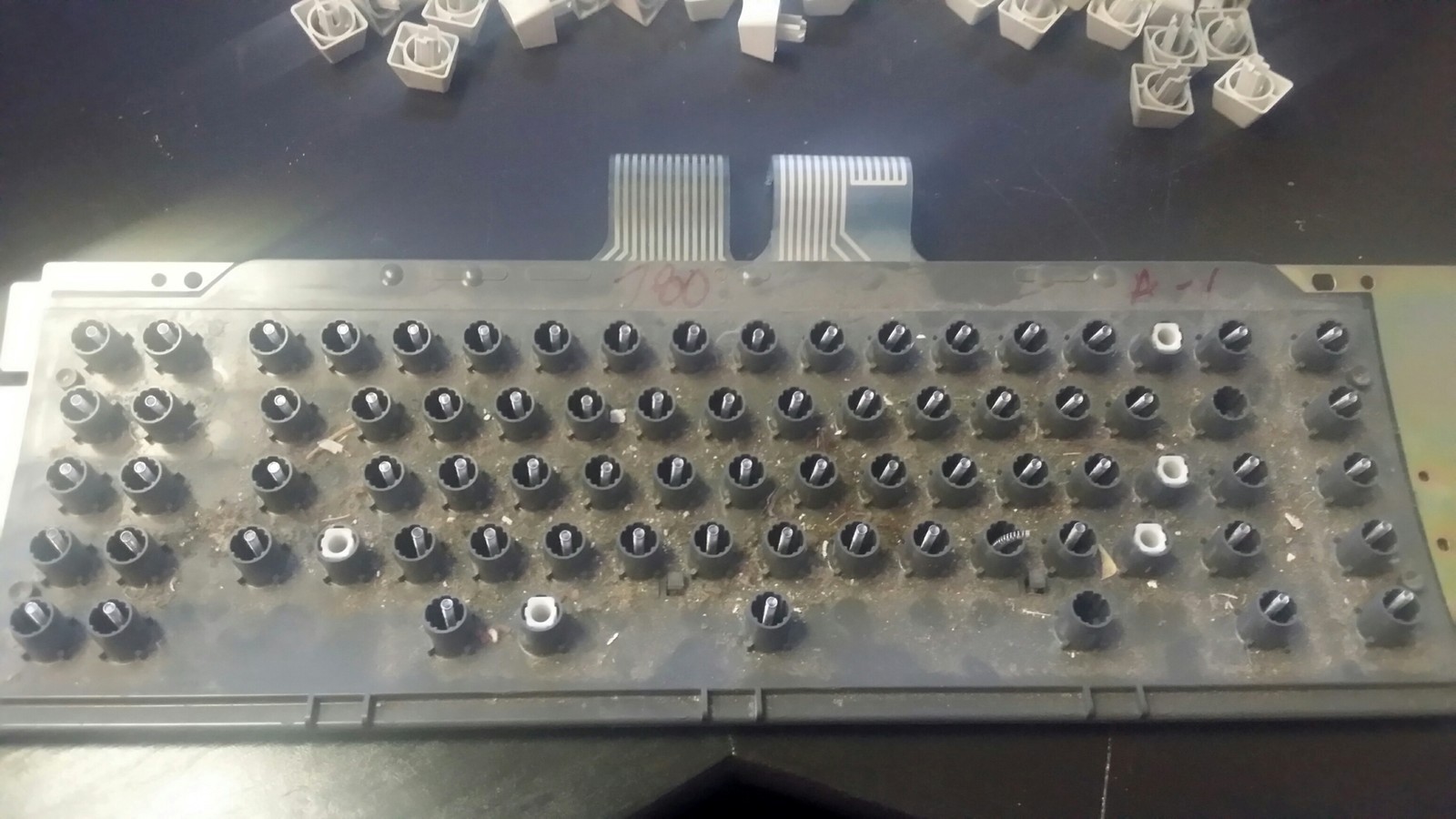

Found all this nastiness under the keycaps. There were even fingernail clippings stuck in there, yuck.
- dwdirty.jpg (236.66 KiB) Viewed 8577 times

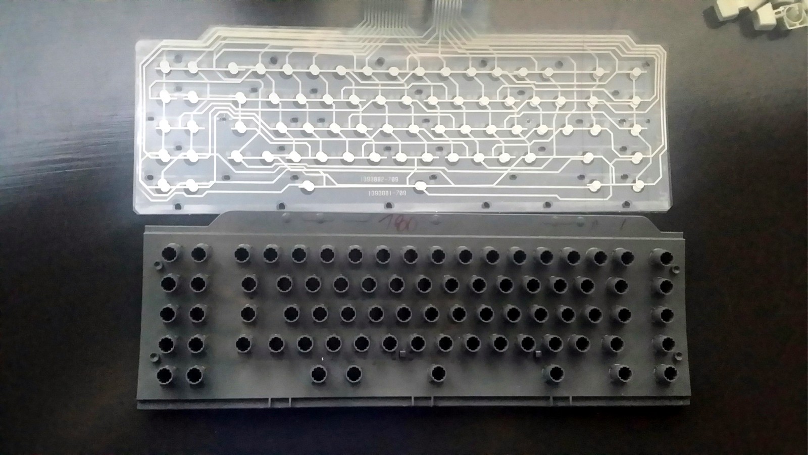

All cleaned up and taken apart. I found that there are missing contacts under the right shift and backspace keys which I was planning on splitting. After looking at it the traces cross in the proper locations and think it may possible to add contact pads to the membrane with some silver paint. If anyone has any experience with this approach I'd love to hear how it worked out.
- barmem.jpg (257.13 KiB) Viewed 8580 times

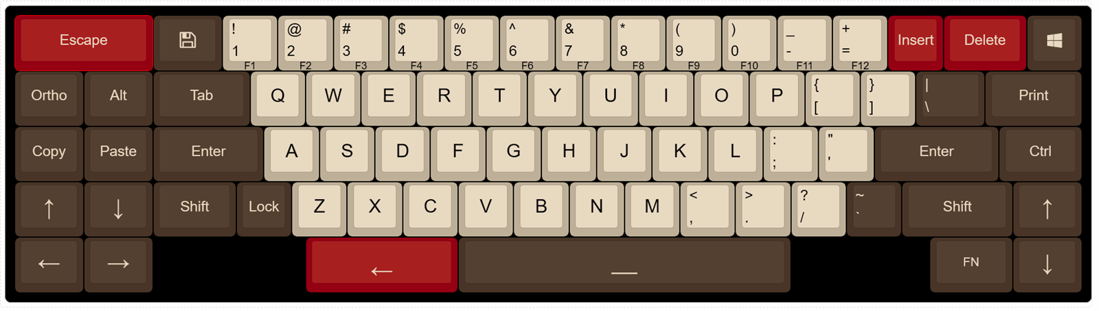

So here's the layout I'm considering for this project. It's a bit unorthodox but should fit my typical daily use pretty well.
- kbdww.jpg (63.76 KiB) Viewed 8543 times

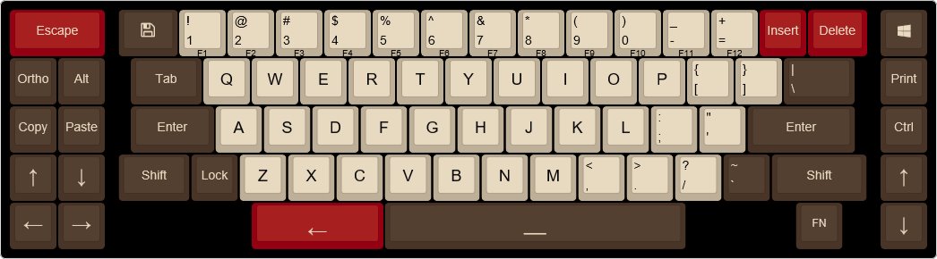

So here's a version with a few oversized caps to fill in the gaps and a 6u spacebar to bring some symmetry to the bottom row.
- wwtr3.PNG (167.78 KiB) Viewed 8462 times

I see you split the left shift, is it also possible to split the right enter? It looks like there is a pad under each the stabilizer barrel.

Right shift and backspace are a challenge because there are missing contact pads on the membrane. I plan on adding them myself since the traces are already in place.

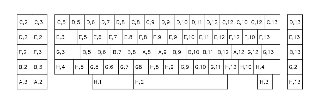

Needed a break from everything else I've got going on and pulled the Wheel Writer off the shelf this evening and mapped out the matrix. I still need to come up with a case for it but am kicking around the idea of trying to add another row to the function cluster on the left side of the board. It would be an interesting hack to do so but probably not worth the effort. For now I'm pleased with the progress made tonight. Rows are lettered, Columns are numbered.
- WHEELWRITER MAP.JPG (71.97 KiB) Viewed 8255 times

Another nice thing about the xwhatsit is that you don't technically need to do any mapping of the matrix beforehand as long as you know which are rows and which are columns for wiring purposes (with membranes it's usually obvious as rows are one membrane and columns the other.
When you are about to assign key mappings, just press the key you want and it will light up in the matrix, then pick from the drop down menu what you want the key to be

That's good to know. I haven't delved into the controller documentation yet. Mapping made for a relaxing evening nonetheless.orihalcon wrote: Another nice thing about the xwhatsit is that you don't technically need to do any mapping of the matrix beforehand as long as you know which are rows and which are columns for wiring purposes (with membranes it's usually obvious as rows are one membrane and columns the other.

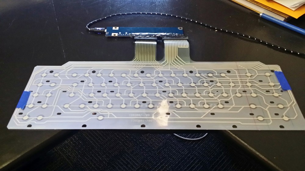

Got the membrane headers hacked off the original control board this evening, still have some cleanup to do on it. Now I need to decide how I am going to mount everything so I can start soldering the appropriate connections to the new controller.

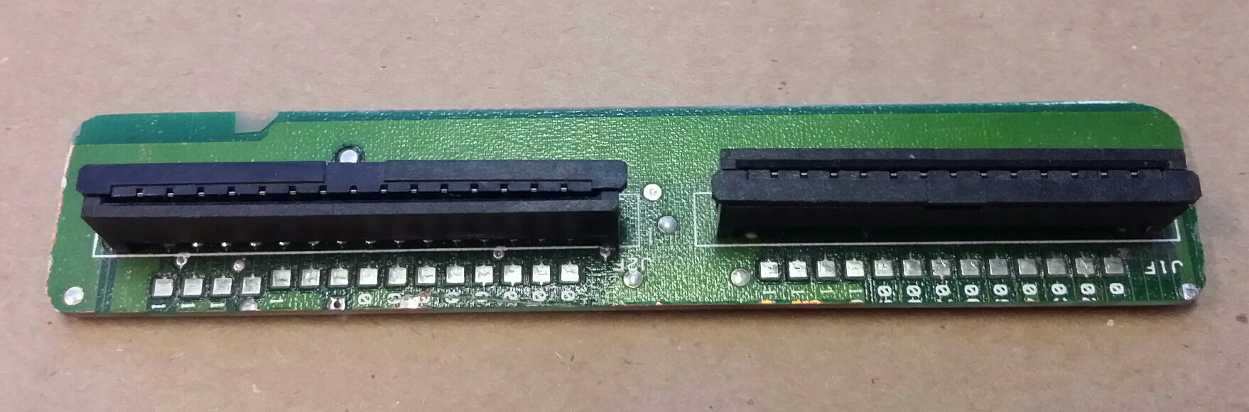

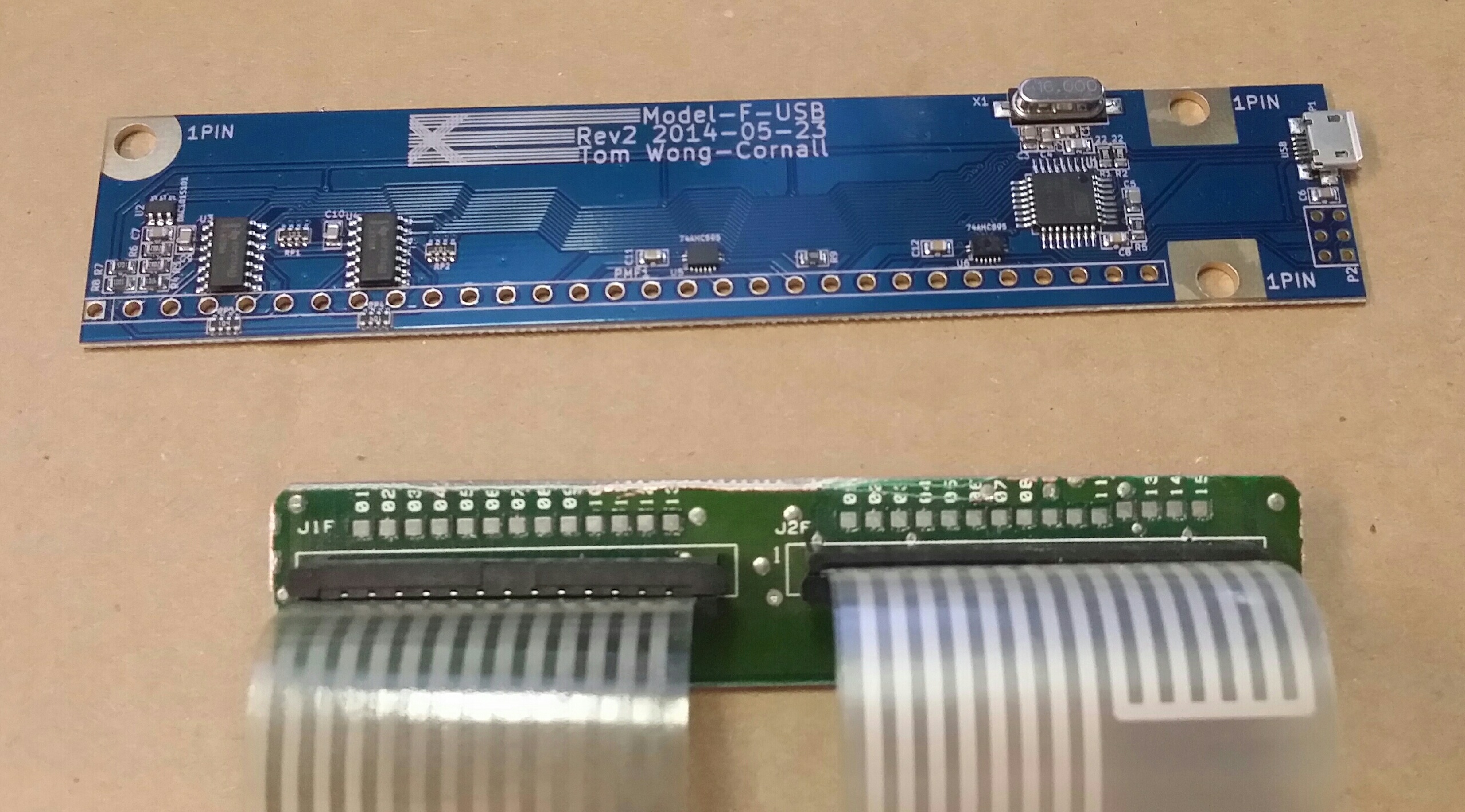

Here's the header all cleaned up and ready for wiring. I could use some help locating the pinout for the Xwhatsit if someone could point me in the right direction. My documentation is for the model F and isn't real clear and there are no numbers on the board itself indicating what is what.

wait, you're using xwhatsit on the membrane keyboard? Why not teensy or something other more convenient? There are normal electrical contacts, after all..
- rsbseb
- -Horned Rabbit-
- Location: In the heart of the Ozarks
- Main keyboard: Varies
- Main mouse: ProtoArc trackball
- Favorite switch: I dream of a silky smooth Izot
- DT Pro Member: 0112
Mainly because it's what I have on hand and I've already got my head around the configuration interface at this point. There may be some other more efficient options but I'm ready to just get this thing operational and ready for testing some SBS caps.

Pin outs are labeled in one of my pictures in the post here:
keyboards-f2/success-displaywriter-beam ... playwriter
Hope that helps!
Hope that helps!

I've used silver paint for Model M membrane repair before, not new pads, but it has worked great. I prepped the surface with isopropyl alcohol, applied the silver paste (use extremely sparingly, a little goes a long way), and let it try either overnight or however long the package said to let it dry.rsbseb wrote: All cleaned up and taken apart. I found that there are missing contacts under the right shift and backspace keys which I was planning on splitting. After looking at it the traces cross in the proper locations and think it may possible to add contact pads to the membrane with some silver paint. If anyone has any experience with this approach I'd love to hear how it worked out.
- rsbseb
- -Horned Rabbit-
It lives !!! Thanks for the help guys, the controller fired right up and I have most of the keys programmed. I altered my connection plan and will follow up with some more pictures and details later on. I still have a lot to do but it lives and I'm ready to go forward with making a case and adding the contact pads or the missing keys.
