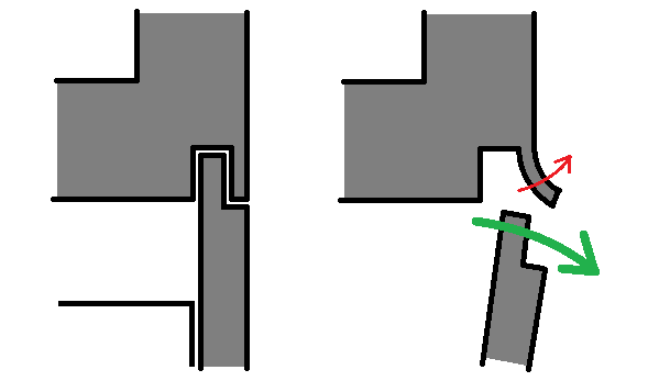

Your latching switch is broken.
I tried to get both of my illuminated switches apart, and in both cases I just ended up forcing out the retaining wall for the slide block. It's too hard to explain in words, but this should explain it:
Slide block retainer.png (3.51 KiB) Viewed 1409 times
What you show in the video is a damaged switch, where the slide block isn't held properly. It should slide laterally within that space, which yours isn't doing:
