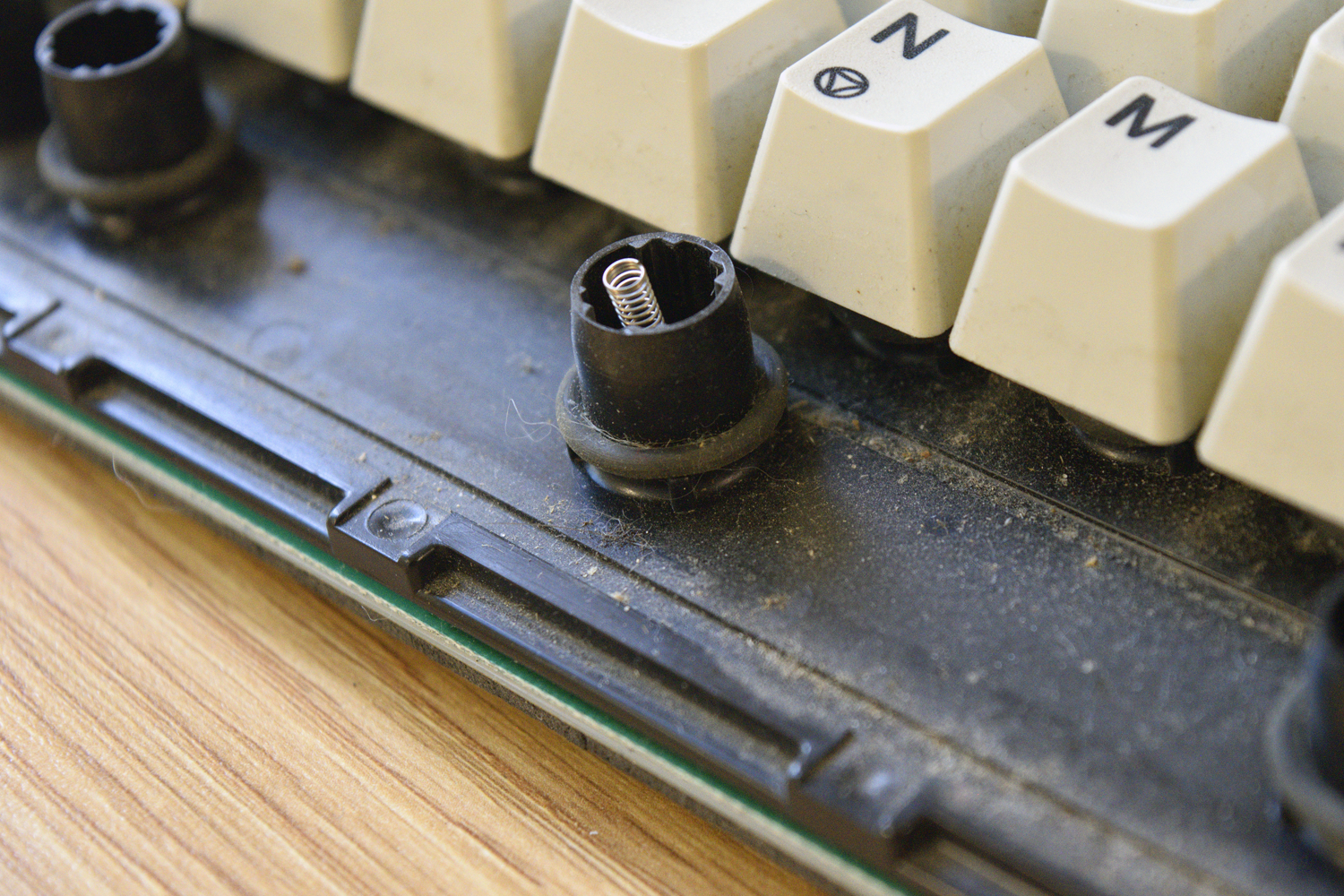

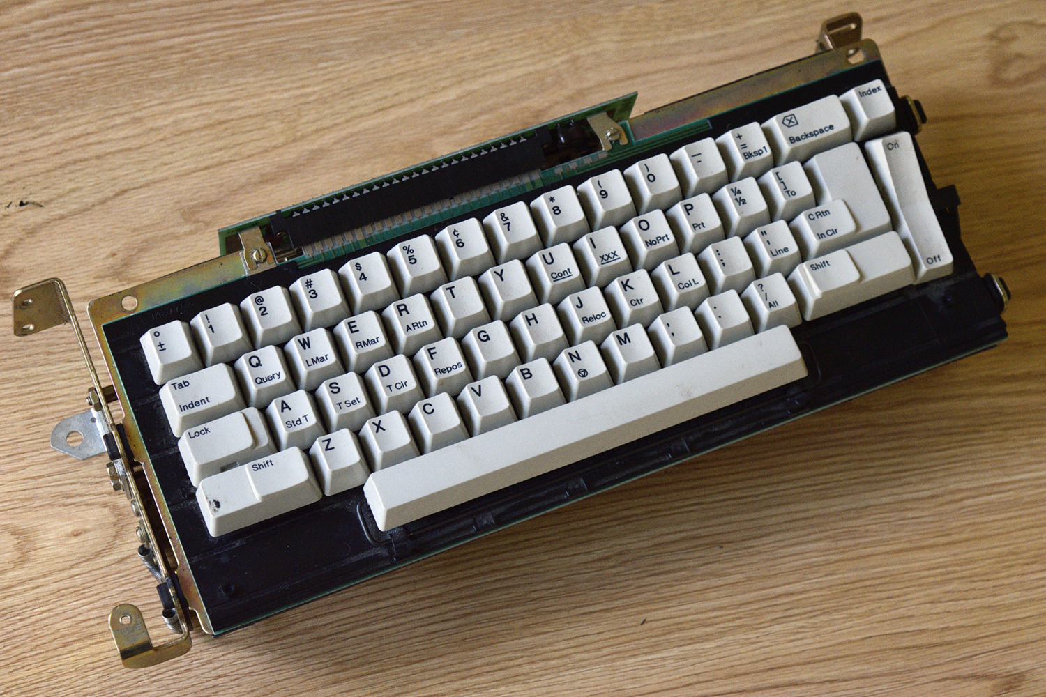

Thanks to ohaimark, I recently learned about the IBM Electronic Typewriter line, an obscure typewriter that sat between the Selectric and Wheelwriter typewriter lines and was a hybrid of both, with electronic internals and a Selectric element ball. The only reference I could find to them on DT was in the opening paragraph of the wiki entry on the Model F.
According this site, the later 65/85/95 models were introduced in 1982 (although I believe this is from 1983 or later, see the photos of the typewriter controller below). After watching a video of a disassembly of one, I had a hunch they had capacitive buckling springs; after some eBay snooping I was able to land a Model 95 keyboard assembly for a reasonable price:
I was happy to see it was definitely a Model F! I hope I can get it converted. Some interesting features of the keyboard:
  • Plastic barrel frame with melted rivets, predating the Model M!

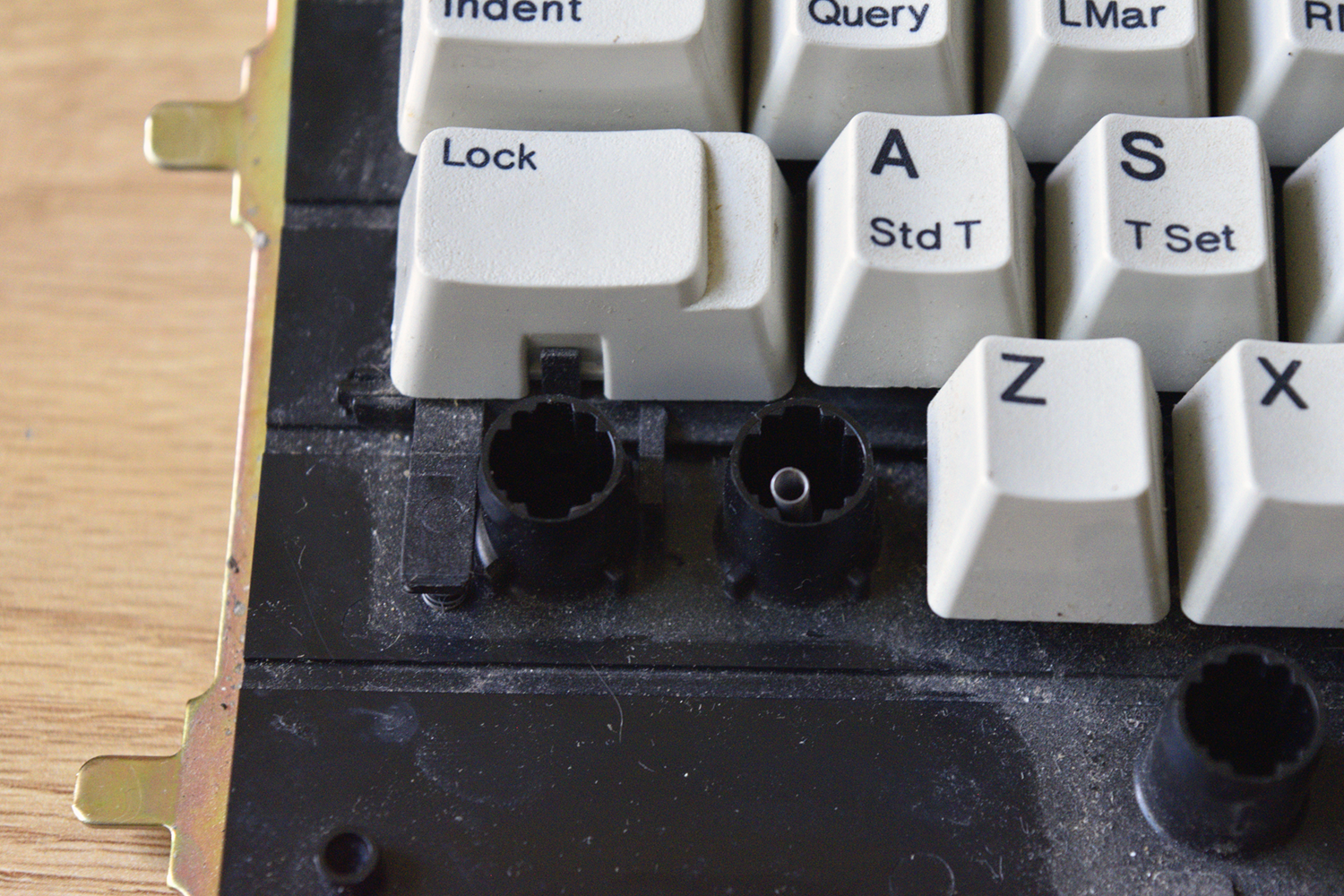

  • Latching Caps Lock
  • Slip-on controller
  • Rubber O-Rings on most barrels, like some Wheelwriters
  • Stepped, unstabilized wide keys
Keyboard:

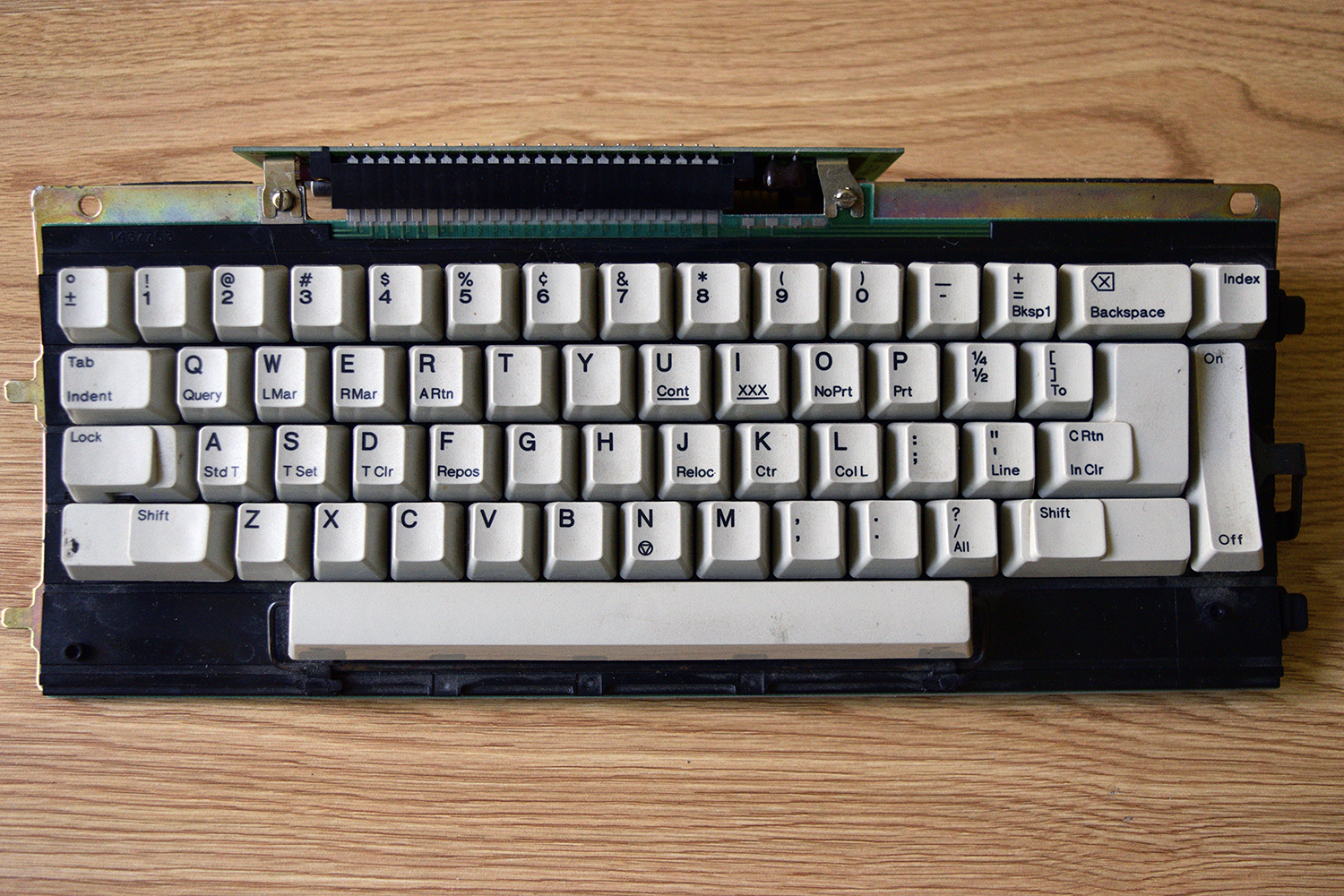

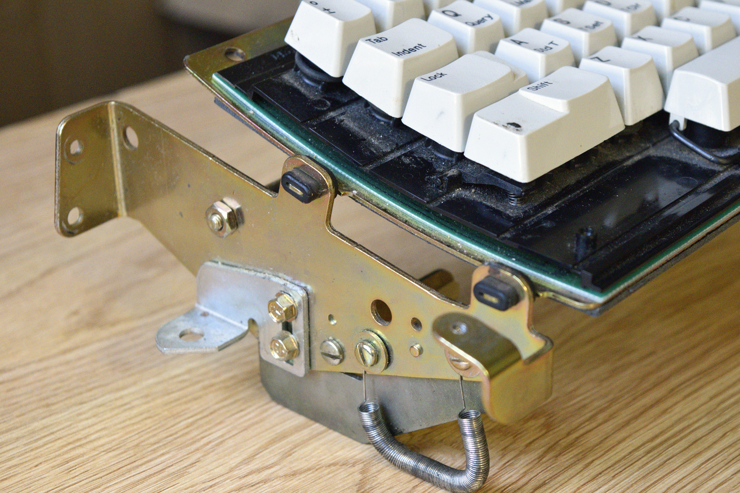

IBM 95 -- Keyboard w/ chassis
IBM 95 -- Chassis close-up
IBM 95 -- Assembly sandwich

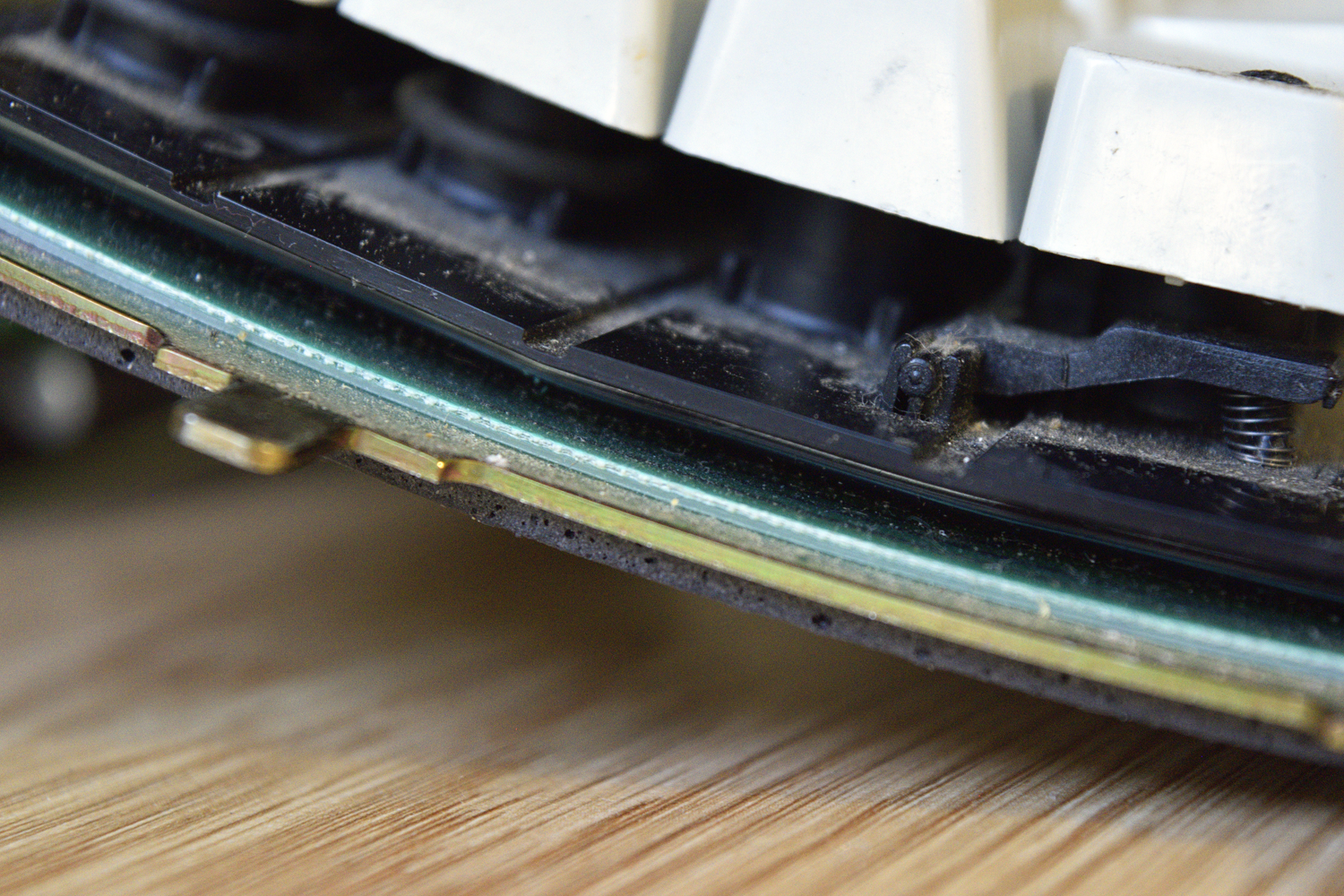

IBM 95 -- Keyboard w/ chassis removed

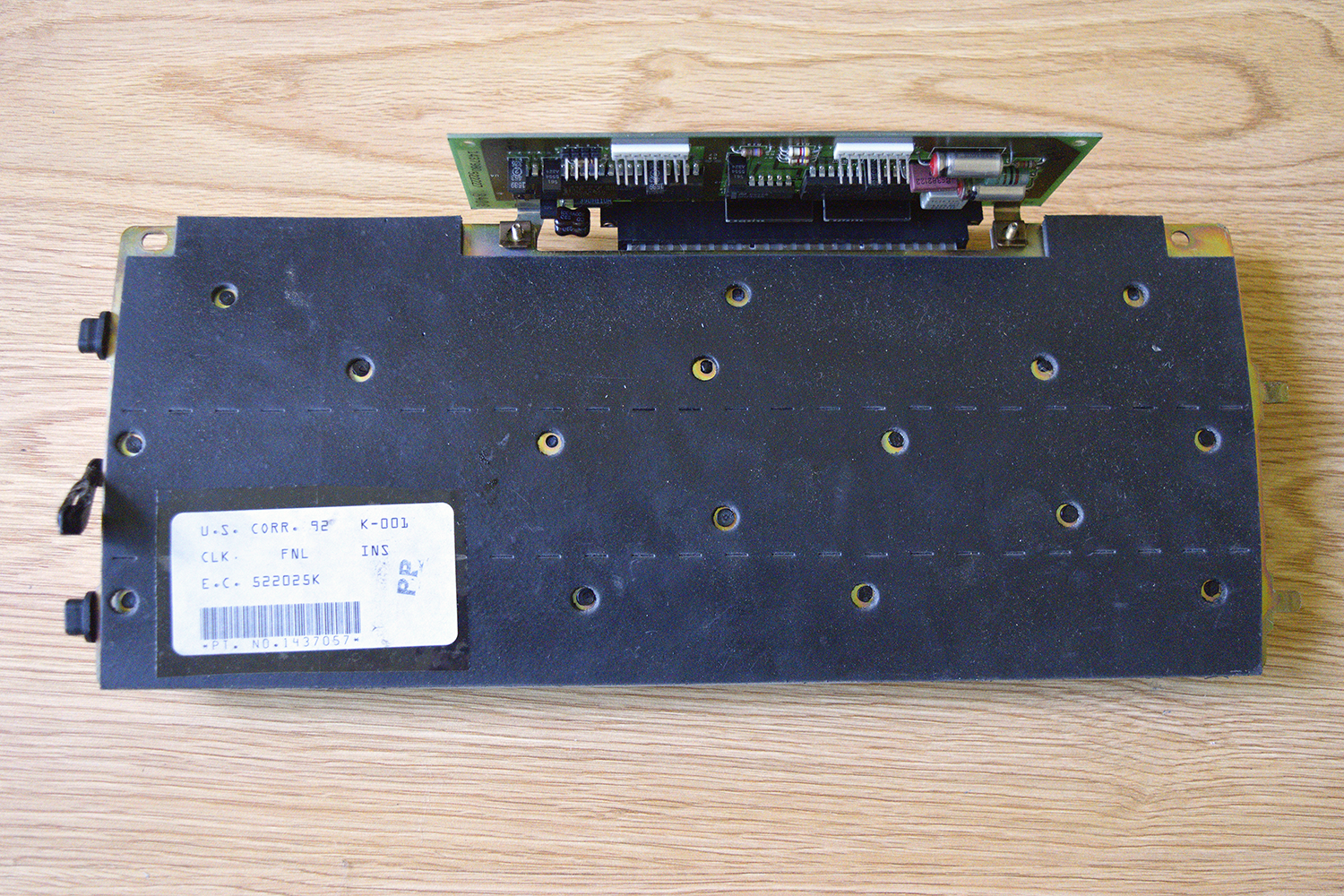

IBM 95 -- Keyboard bottom w/ thick rubber mat over backplate

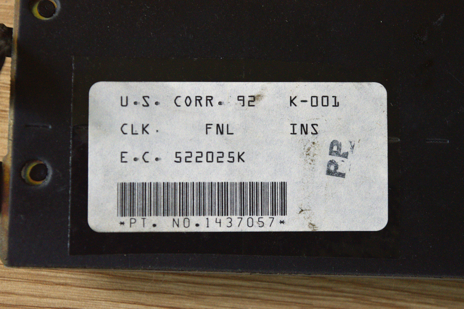

IBM 95 -- Label
IBM 95 -- Label

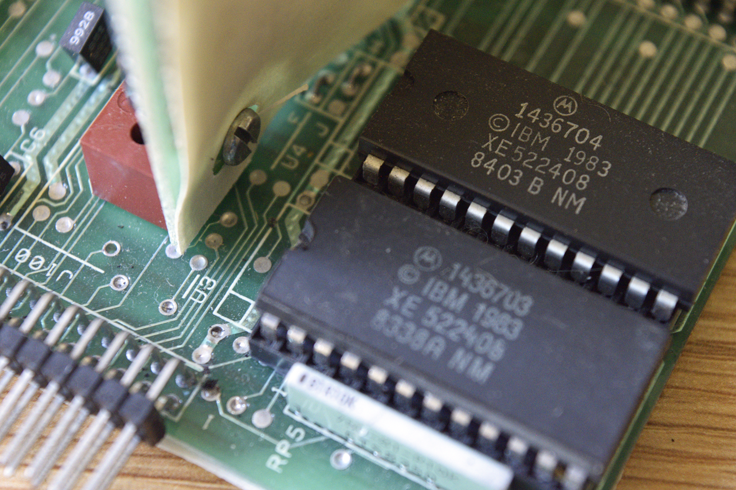

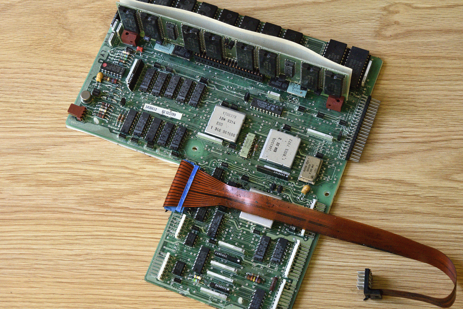

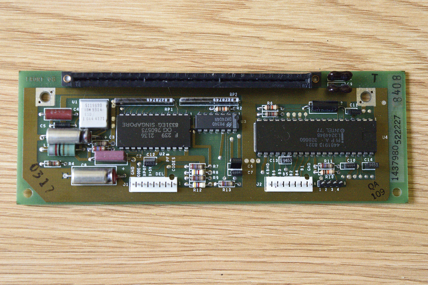

Keyboard Controller:

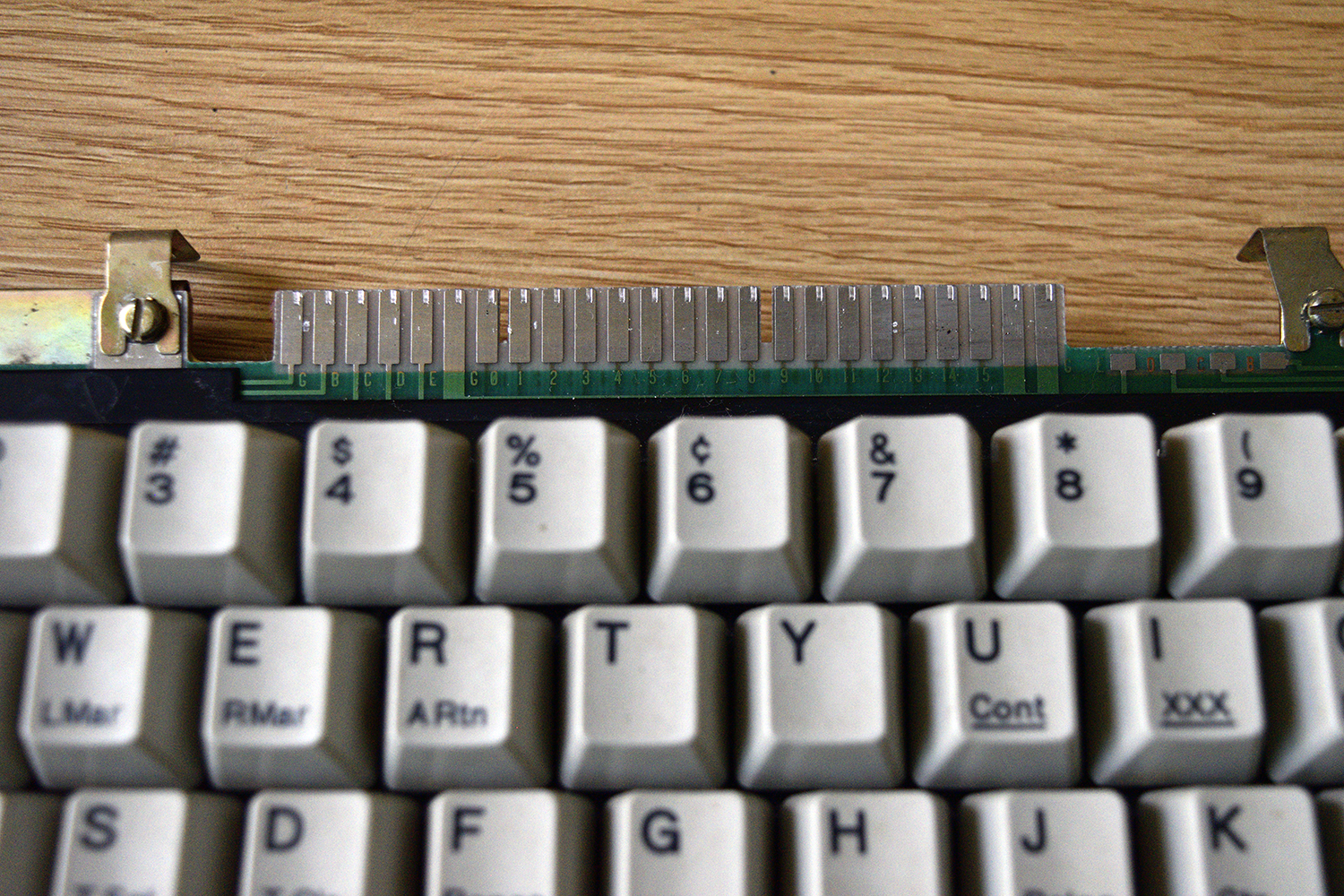

IBM 95 -- PCB Pinout, 24 pins, 16x4 matrix

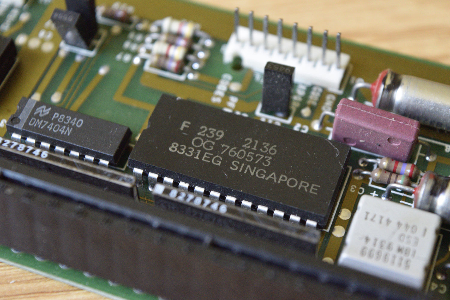

IBM 95 -- Keyboard controller
IBM 95 -- Keyboard controller close-up

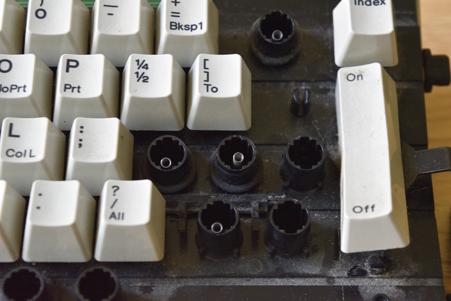

Keys:

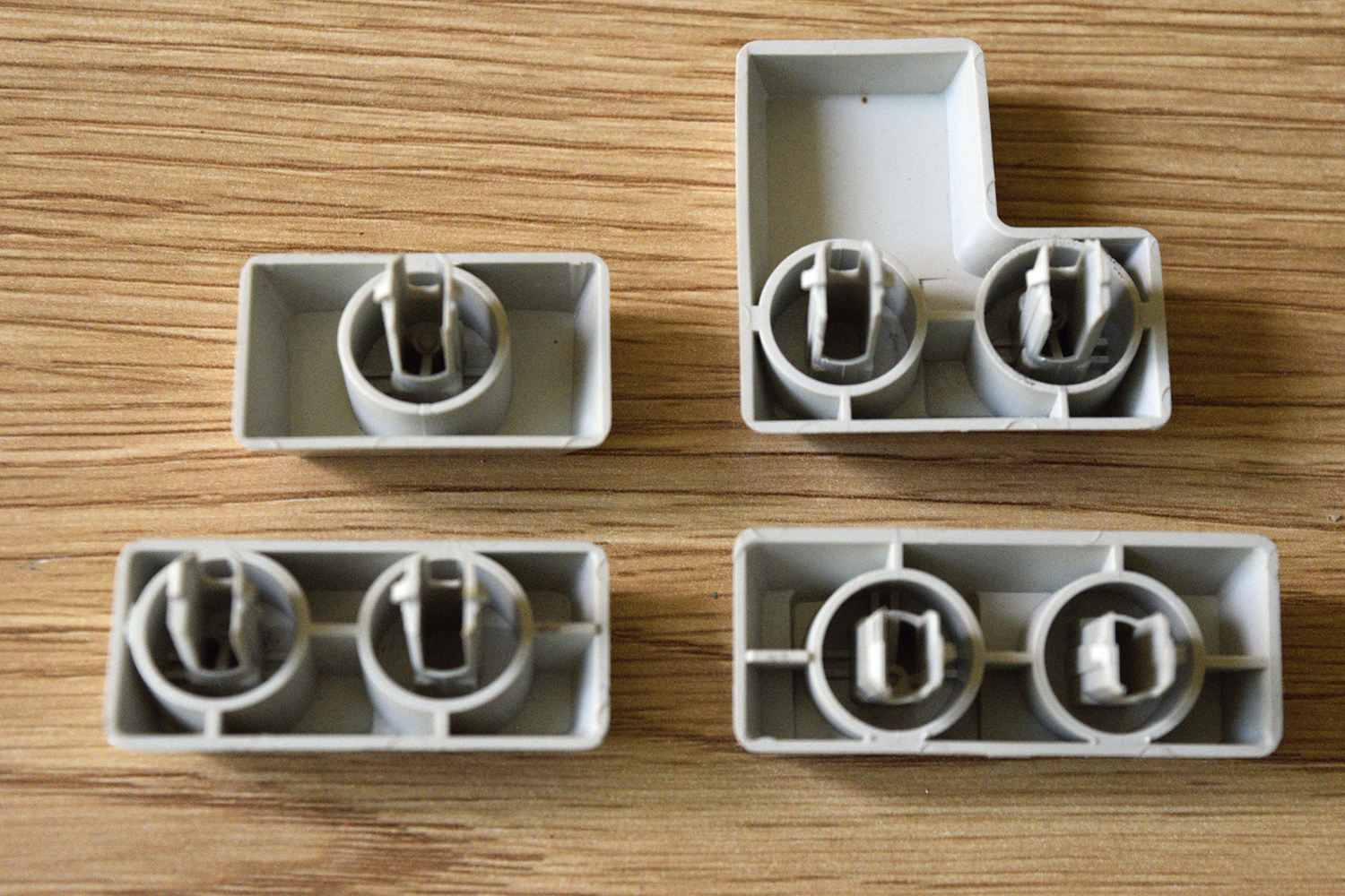

IBM 95 -- Wide keys
IBM 95 -- Wide keys
IBM 95 -- Wide key barrels
IBM 95 -- Latching Caps Lock key

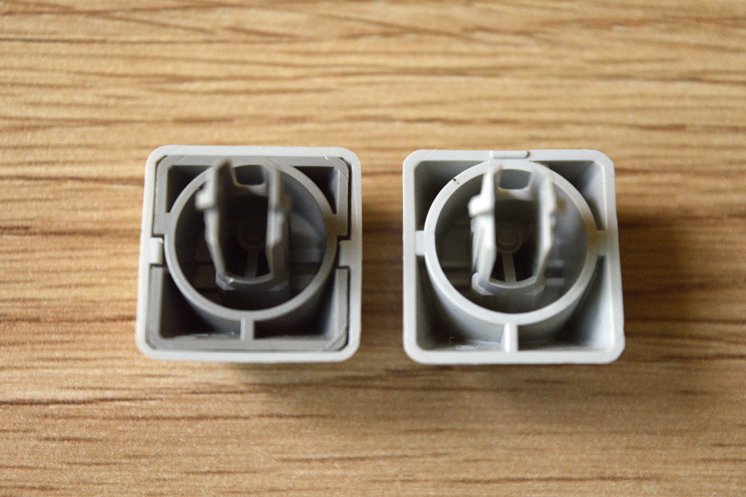

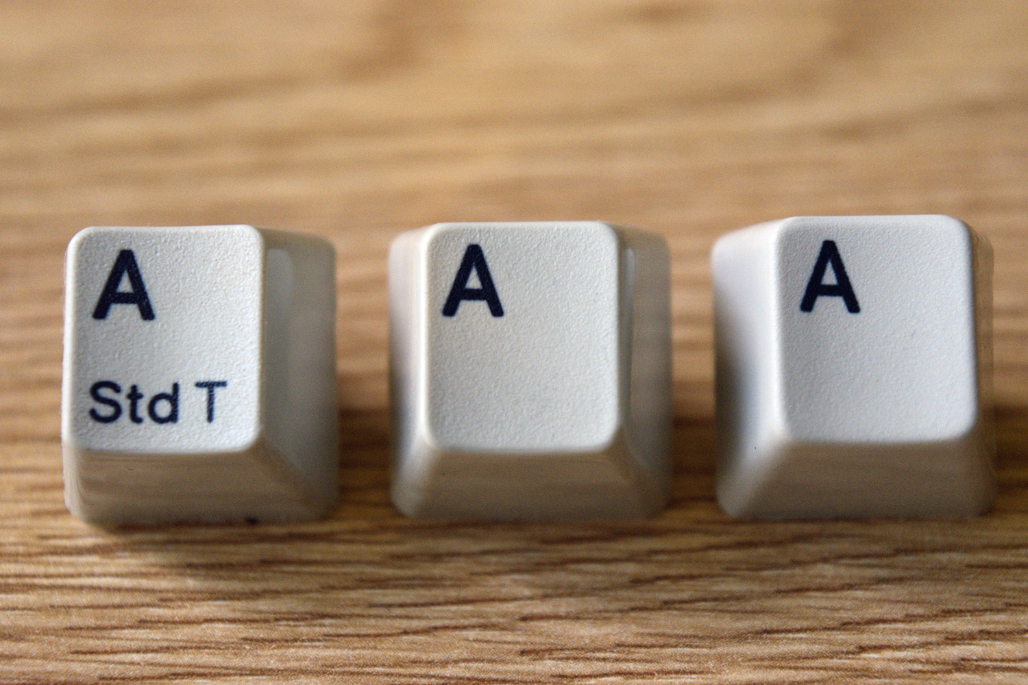

IBM 95 -- Comparison of A key (left to right): IBM 95, IBM Model M 1390120, Custom Unicomp SSK keyset

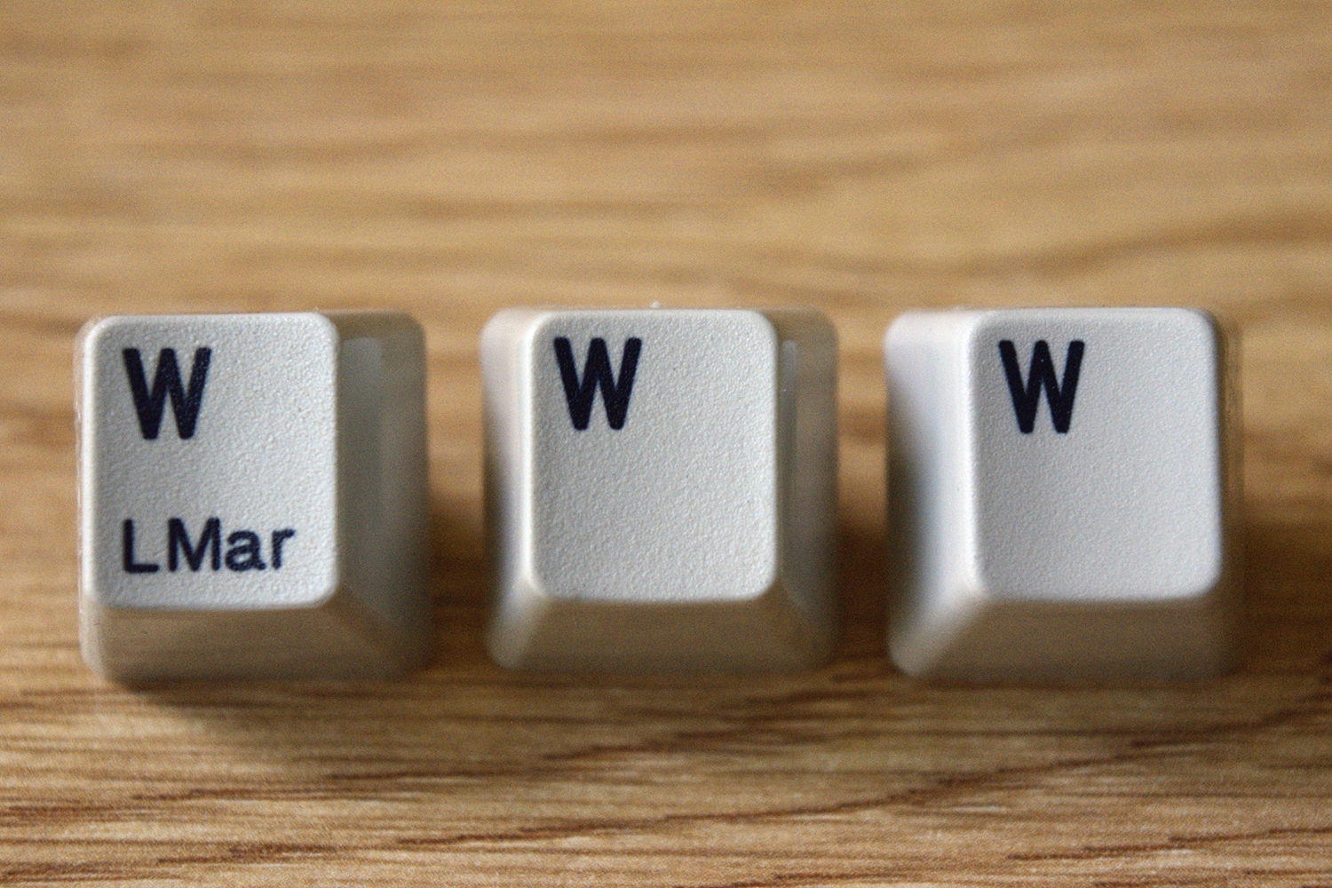

IBM 95 -- Comparison of W key (left to right): IBM 95, IBM Model M 1390120, Custom Unicomp SSK keyset
IBM 95 -- Comparison of key bottoms (Left to right): IBM Model M 1390120, IBM 95.  The sprue for the 95's keycaps is underneath the cap and not on the back.
IBM 95 -- O-Ring
IBM 95 -- O-Ring

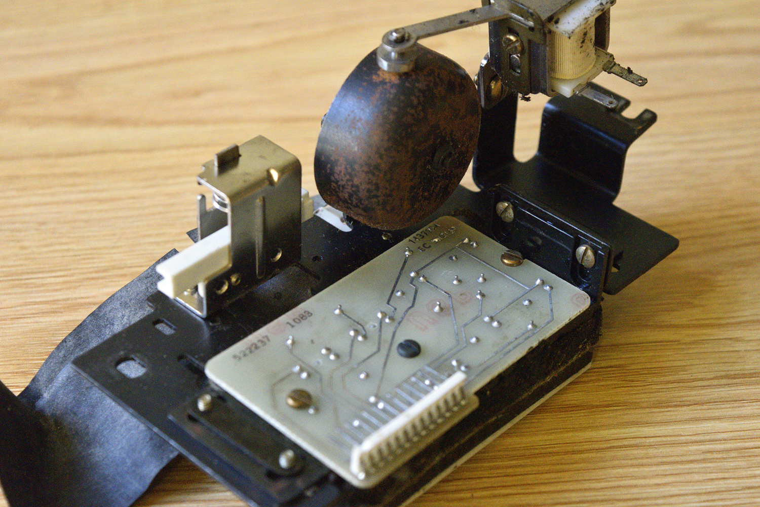

Misc:

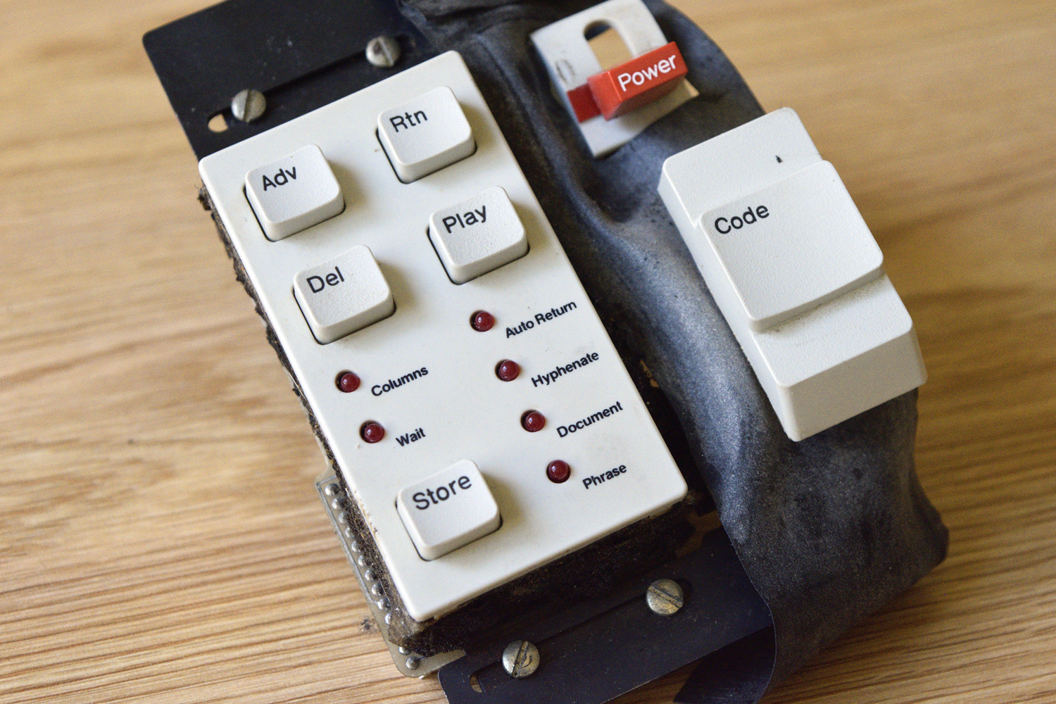

IBM 95 -- Typewriter button panel
IBM 95 -- Typewriter button panel bottom

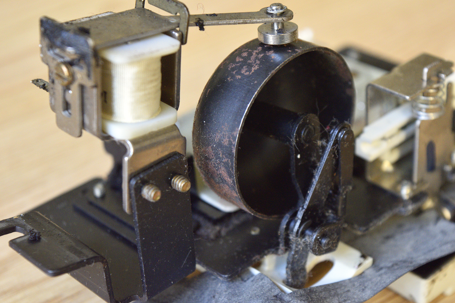

IBM 95 -- Typewriter button panel bell and solenoid?

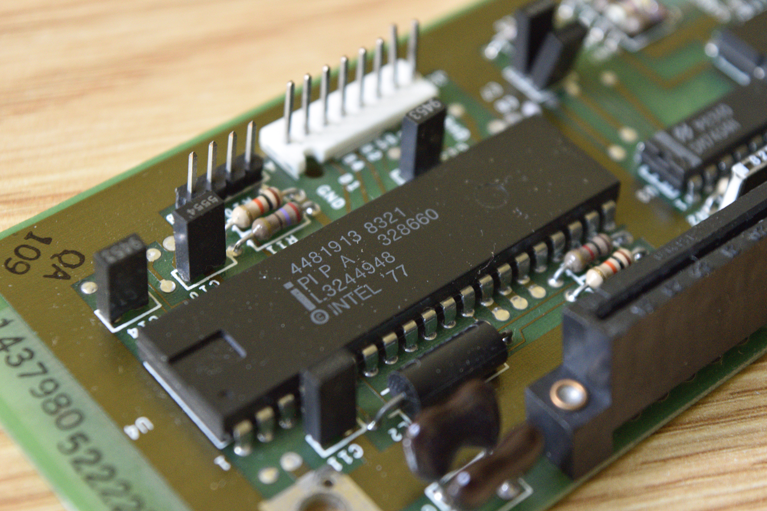

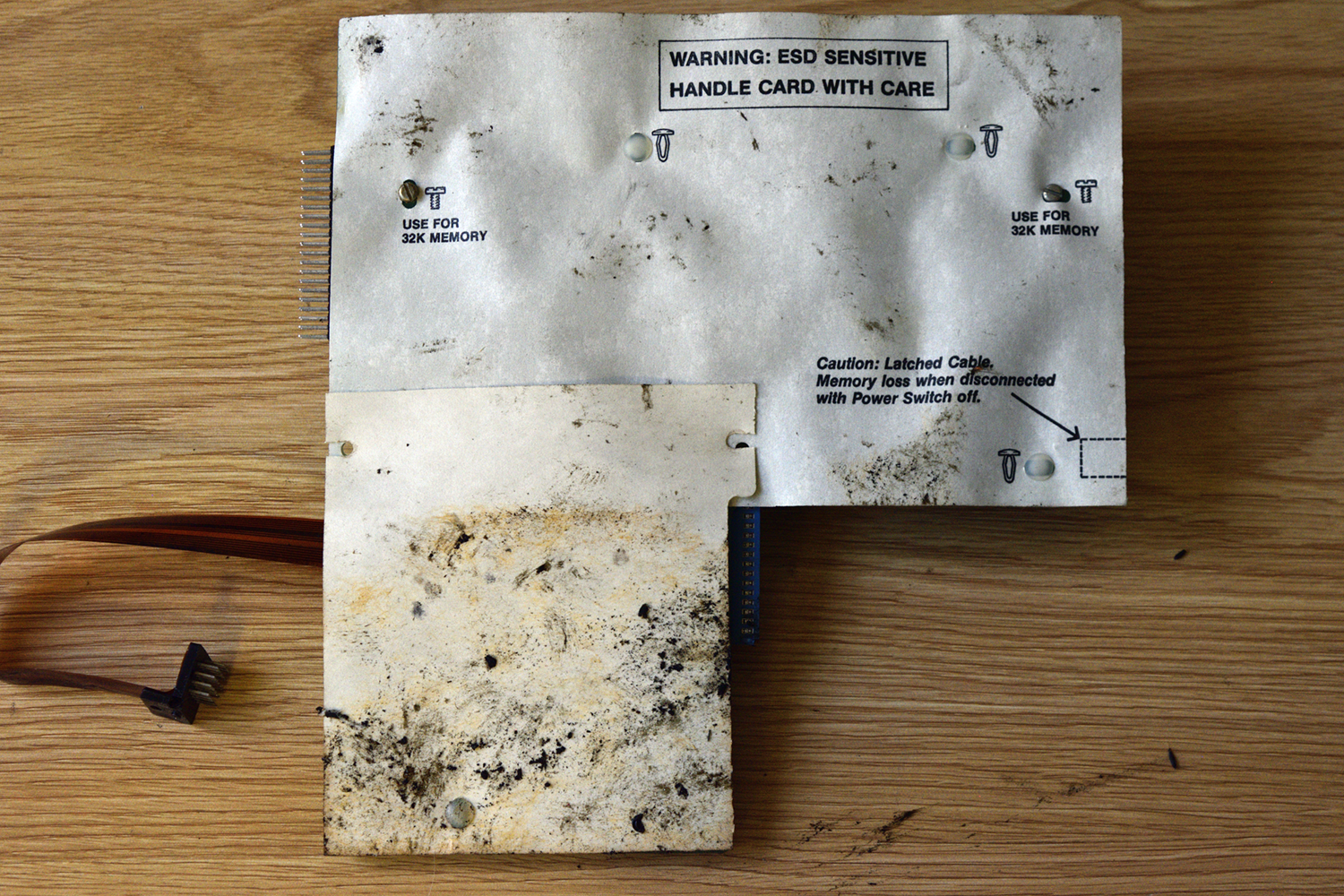

IBM 95 -- Typewriter controller
IBM 95 -- Typewriter controller close-up
IBM 95 -- Typewriter controller bottom

Thanks for the pictures, very interesting post and awesome find. #DTA7
//gainsborough
ALPSの日常
03 Jun 2017, 10:04
This thing is really neat - it would be very cool if you could convert it somehow!
You should do a typing demo =)

Nice one! How does the latching caps lock work? Is the long on/off button a buckling spring toggle key of some kind?

Another buckling mini layout keyboard! Thanks for the photos.

@Nuum, the Caps Lock works like one on a manual typewriter, after toggling it, it's released by pressing either Shift key.

Hmm... What was the reason that IBM did not choose to use the latching mechanism for the IBM PC?
Are the Shift keys harder to press when the Caps Lock key is down?
Only slightly, the spring holding the lever up is very light.

What's the reasoning behind o-rings and why have they disappeared since?
ohaimark
Kingpin
06 Jun 2017, 13:50
Probably to prevent bottom out (though I can't say for sure). I've noticed that AT keycap stems will deform at the base if bottomed out heavily on a regular basis. That can result in them catching on springs.

Only the second time I have seen a Model M / F with orings around the barrels. One of these days I'll get around to adding some to my boards to check for sound affect.
0100010
27 Sep 2017, 20:09
Darkshado wrote: What's the reasoning behind o-rings and why have they disappeared since?
I don't think the orings do anything with bottoming out, only area you can place something that will effect that would be on the top of the barrel. I think they are only for changing the buckling sound response.
Edit : adding image
alh84001
v.001
27 Sep 2017, 20:22
Yeah, sound is definitely different. Less ping reverb or something similar. It's maybe a little less loud as well, but still quite loud though. Note that this is an F PCB in M assembly, and probably only louder BS board I have heard is i$'s FSSK, which is in a league of its own.
2ter
28 Sep 2017, 00:00
Edit : adding image
this gif omits the little reinforcements on which the o-rings sit. i think o-rings do soften the bottom out. they don't really influence the sound, at least on a model m. only the floss mod, dry lube and similar mods on the spring and/or the inside of the barrels can get rid of the ping and ringing.
