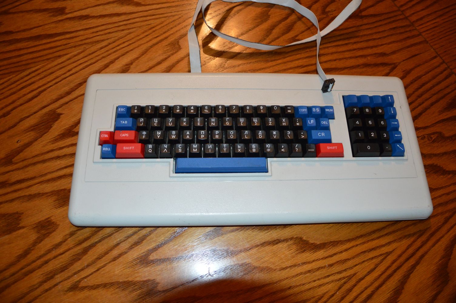

Some time ago I bought zbrojovka brno 263.2 keyboard like this one https://youtu.be/Qef2QGLkHMk.
Zbrojovka Brno 263.2 keyboard
After some digging I found few good resources:
* https://sites.google.com/site/computerr ... icany-fk-1
* http://home.zcu.cz/~dudacek/Simicos/SIMICOS.htm
Basically keyboard runs on 5V (USB) and uses 8 pins for data, and one pin as a clock (strobe signal).
Because of that keyboard can register only single key at one time (1-KRO), and typing experience is horrible because of it.

Correct strobe and 8 data pin can be be easily checked out by tracking the traces on pcb with multimeter or by eye.
As far as I can say interface is very similar to as other "Gerkonic" keyboard like Consul, Zbrojovka Brno, Tesla 259 https://youtu.be/TNsyTSEFvrU, but pin ribbon cable is different (still it uses the 9 pins for communication, or opt for serial communication instead).

As for other weird thing in this keyboard ROLL key (responsible for STROBE pin control), after it is pressed (and released) it repeats its last value until roll is pressed again (it was probably used for quickly moving cursor with direction keys)... Yes holding any key down does nothing, key presses are only registered on a down stroke - so compute was not even aware how long key was hold down... (When key is pressed strobe value is set to 1 for 1ms after data 0-7 channels are set to hex value of pressed key. Data channels value stays the same until the next key press is registered, there is no value change on data 0-7 when key is released).
Here is a full hex code table for every key on this keyboard recognized by computer.
