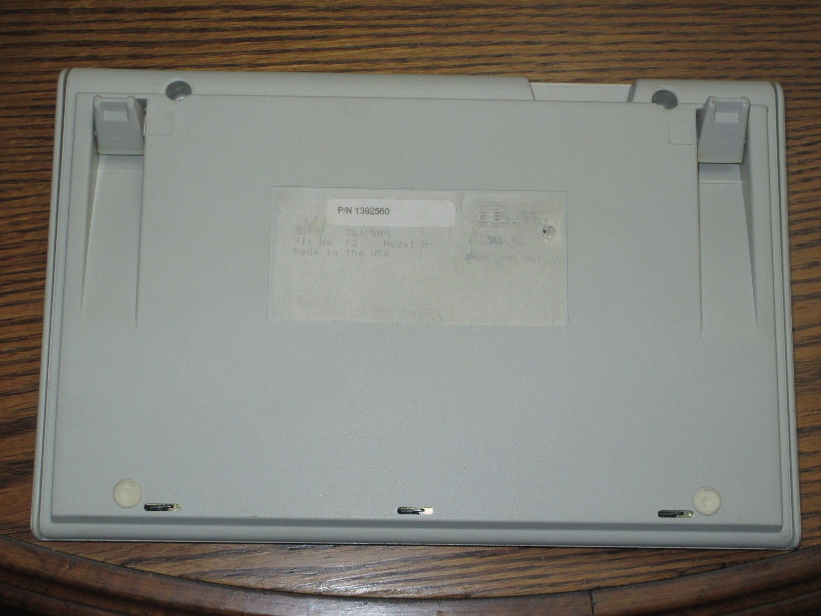

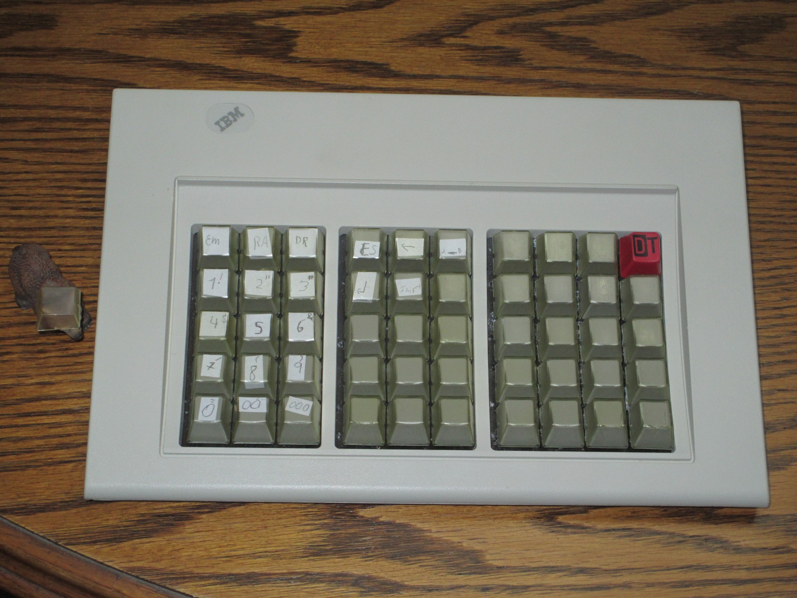

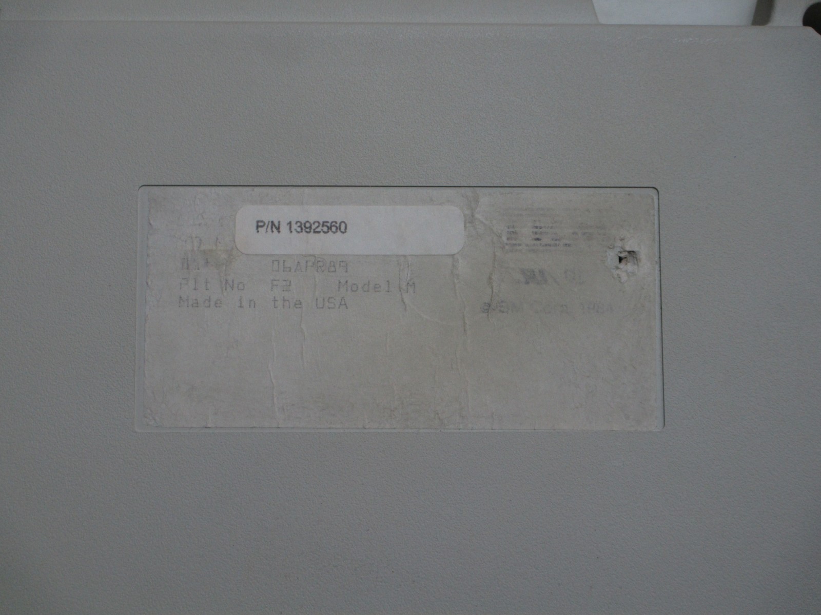

This is supposed to be the M version of the IBM 4704 Model 100 keypad. It sports the gray IBM oval logo, has a plastic backside and M's flip-out feet, and even sports an SDL plug.
IBM Modem M 4704-Model-100-like, frontside.
IBM Modem M 4704-Model-100-like, backside.
IBM Modem M 4704-Model-100-like, label (tampered with, but what the heck).

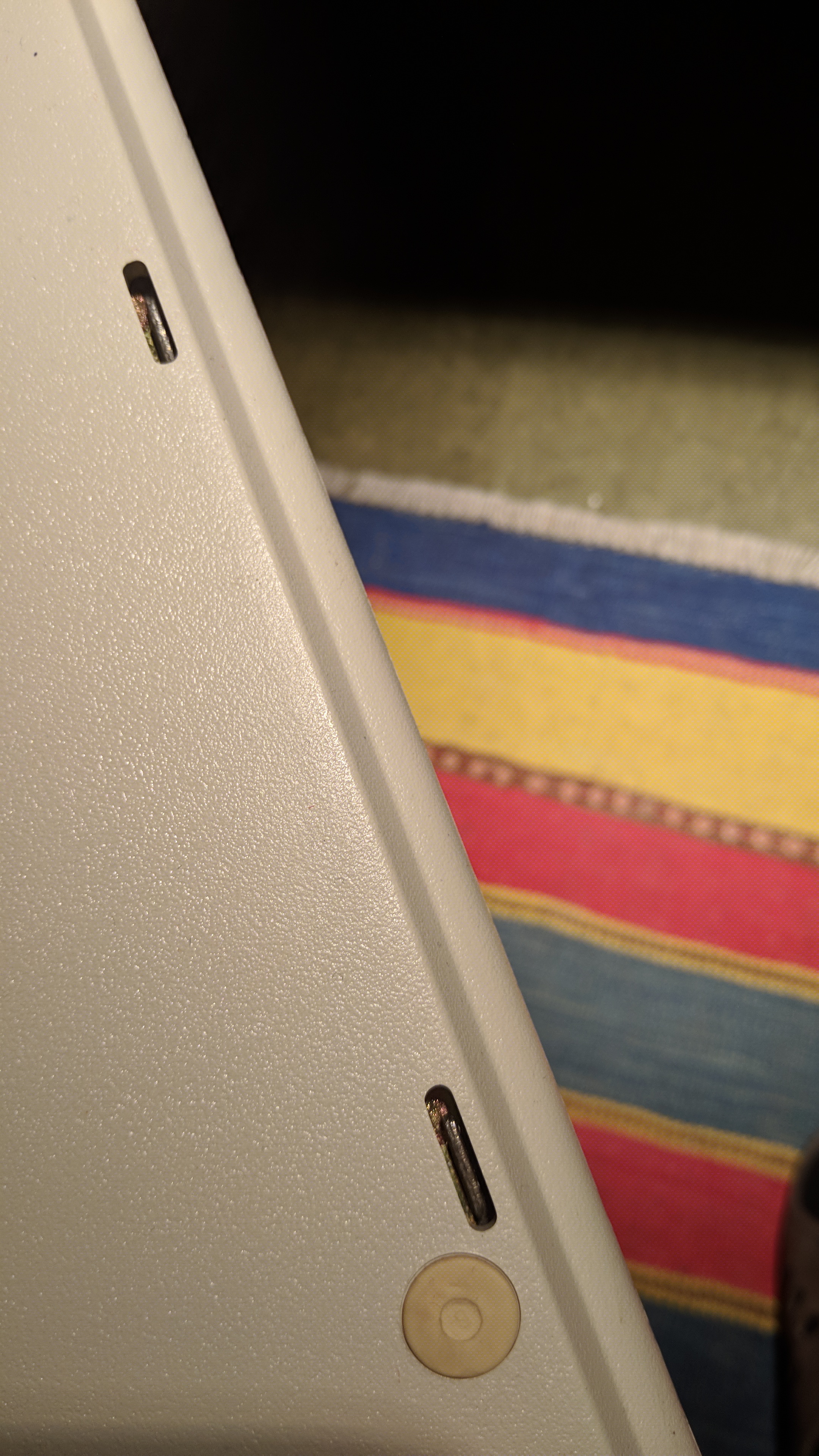

Yet... typing on it feels quite closer to typing on a Model F than on a Model M.
Why?
IBM Modem M 4704-Model-100-like, are those regular flippers or not?.

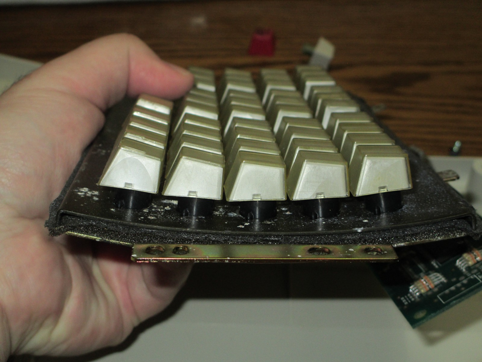

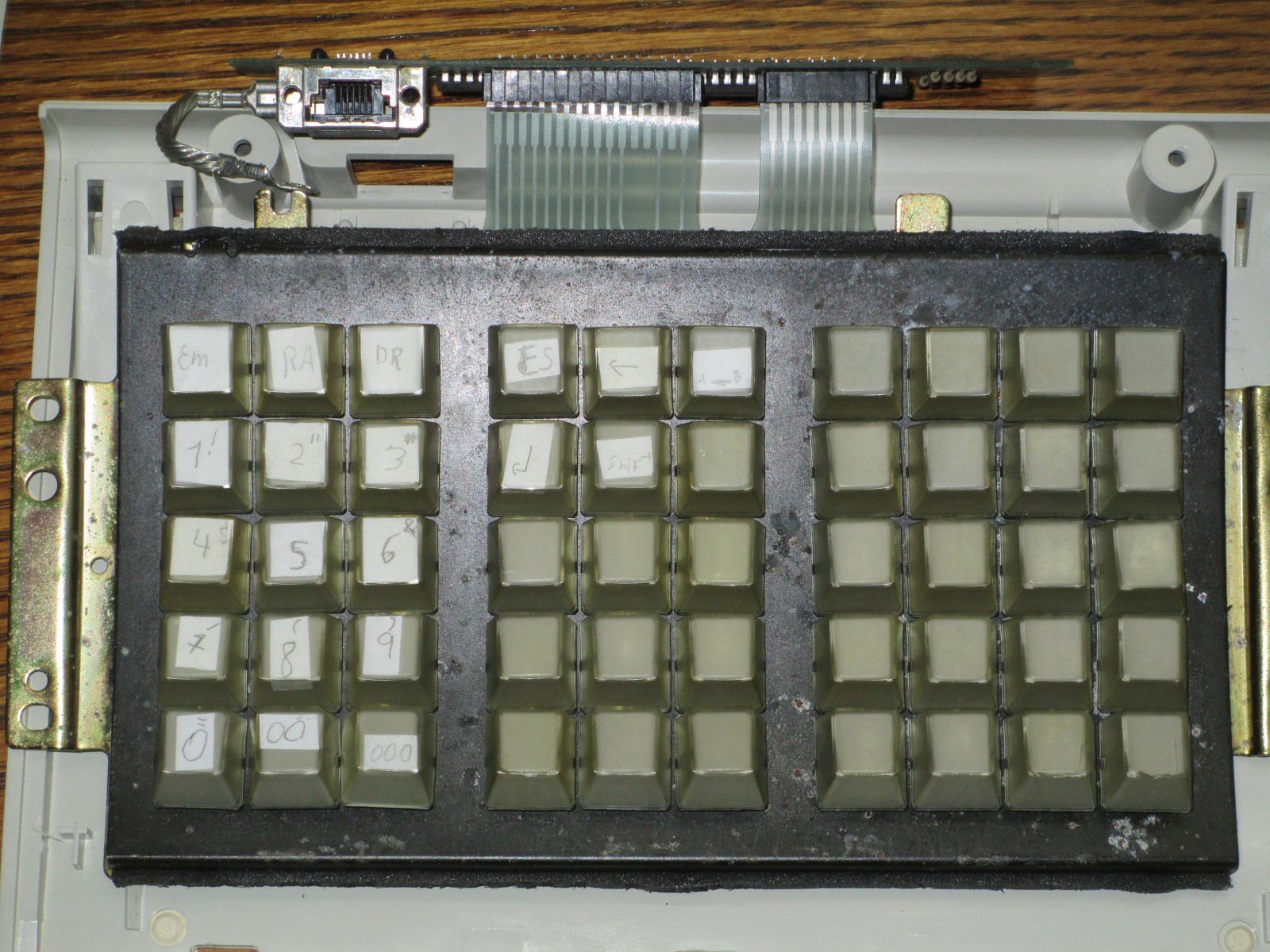

A quick topside look at the springs doesn't yield much, so... let's open it.
IBM Modem M 4704-Model-100-like, internal plate front view.
Frontside doesn't tell us much.

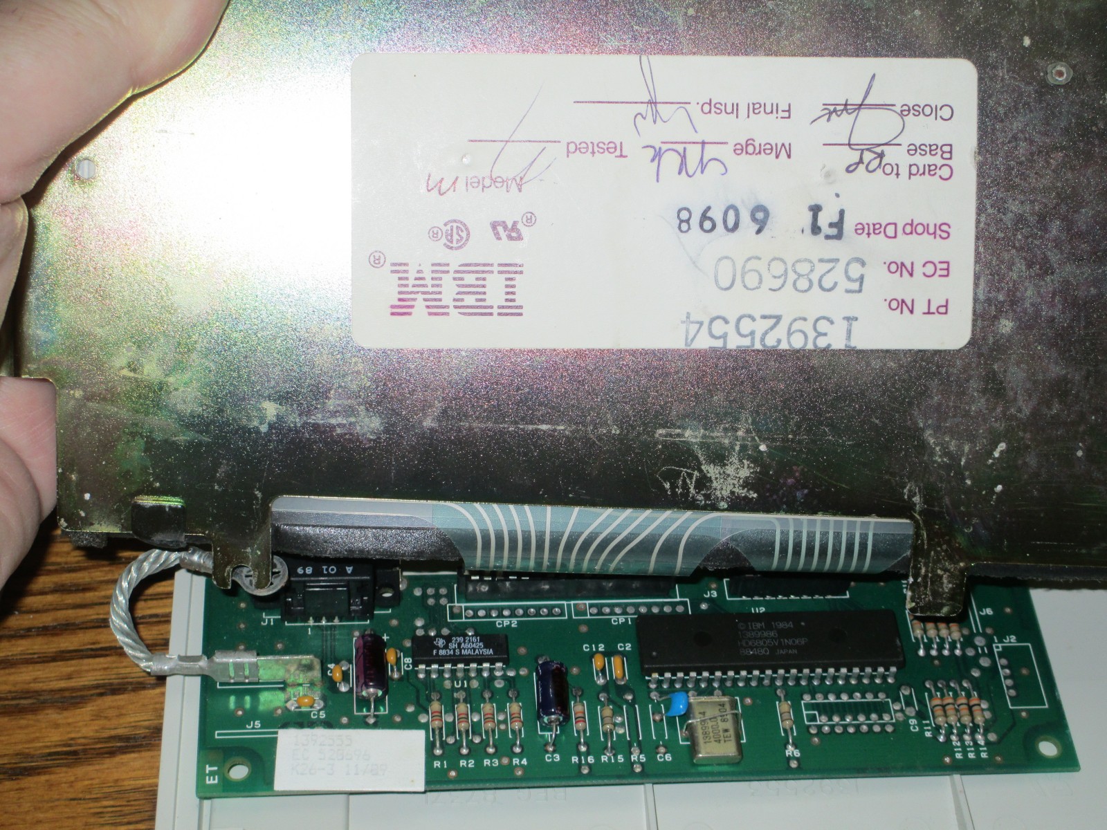

IBM Modem M 4704-Model-100-like, panel's backside. Oh, moderately shiny!

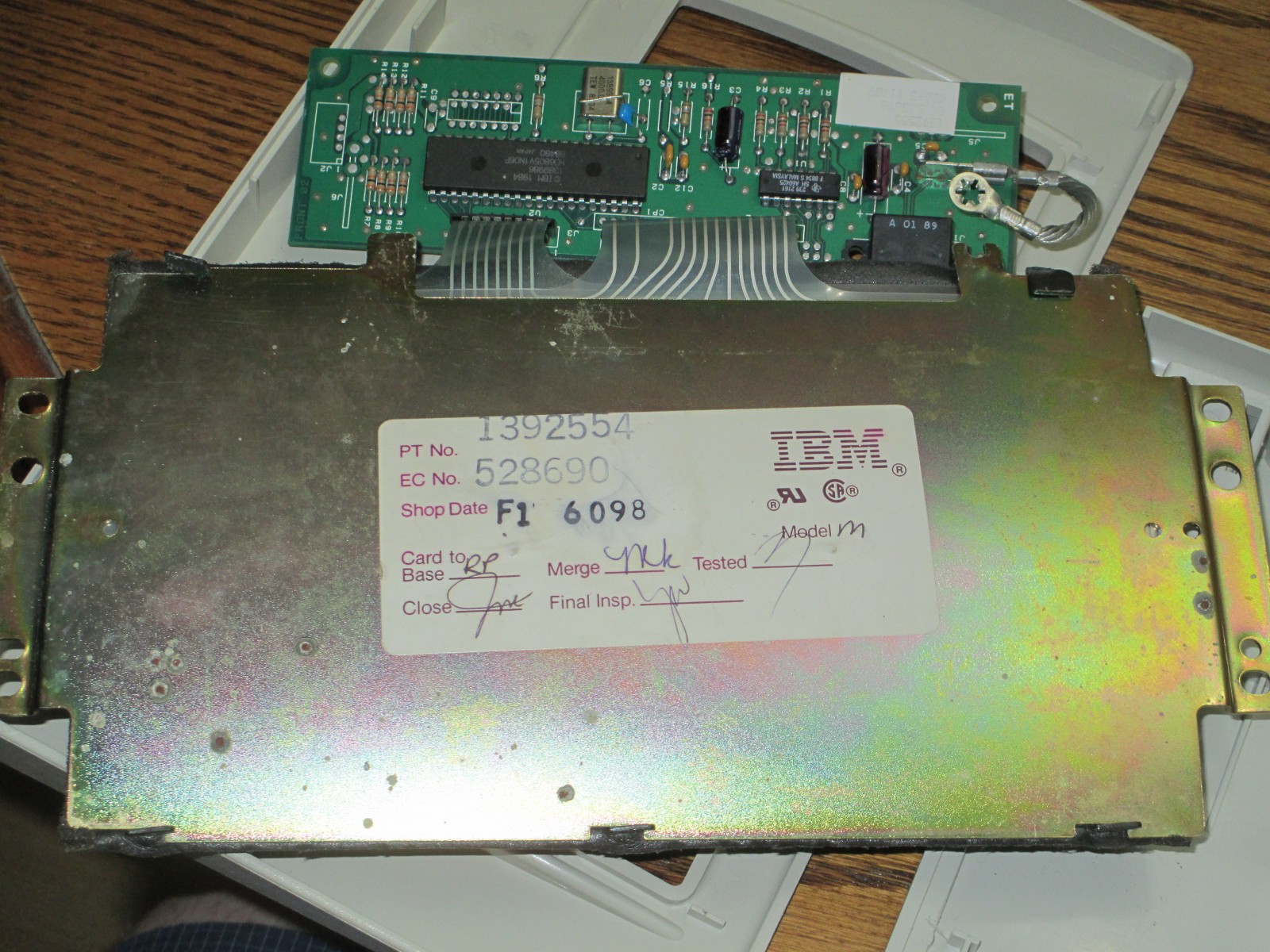

Is this a SHINY backplate? Like Model F units had?
IBM Modem M 4704-Model-100-like, panel's backside with a better view of the controller.
The controller looks like an M-era model...
IBM Modem M 4704-Model-100-like, plate sandwich.
... the sandwiched foam, on the other hand, screams of Fness.
And with that, I stop. If I open this up, I'll surely won't be able to put it back together.
I bought this keypad as a fun toy, to use as a side pad or a sophisticated game pad of sorts; I did not expect it to bring this pleasant surprise. What a fun... hybrid? intermediate evolutionary step? keypad.

By the way, feet are different from those of regular model M as I remember.
Darkshado
01 Dec 2017, 05:43
Hard to tell with the flash, black flippers would point towards an F, white are a pretty surefire sign of an M.
139* part numbers are associated with model M.
The controller photos clearly show two superposed membranes; it should be possible to lift the foam slightly and see the PCB on an F as well.

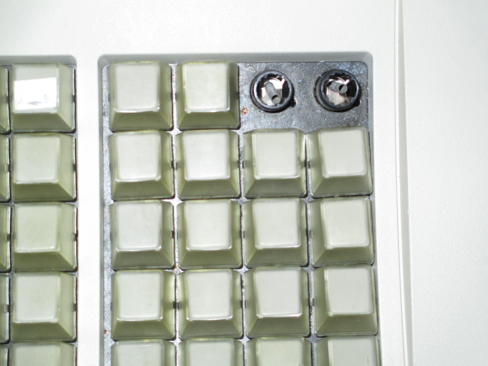

Individual barrels on an M are peculiar, are there other known examples?
We did see that plastic barrel plate style F typewriter assembly not long ago, so there is some overlap in the techniques on both models.

It's definitely a Model M, I've got one and opened it up before and it's membrane is exactly like an M. If anyone could design a PCB I'll love to test turning this into a full F.

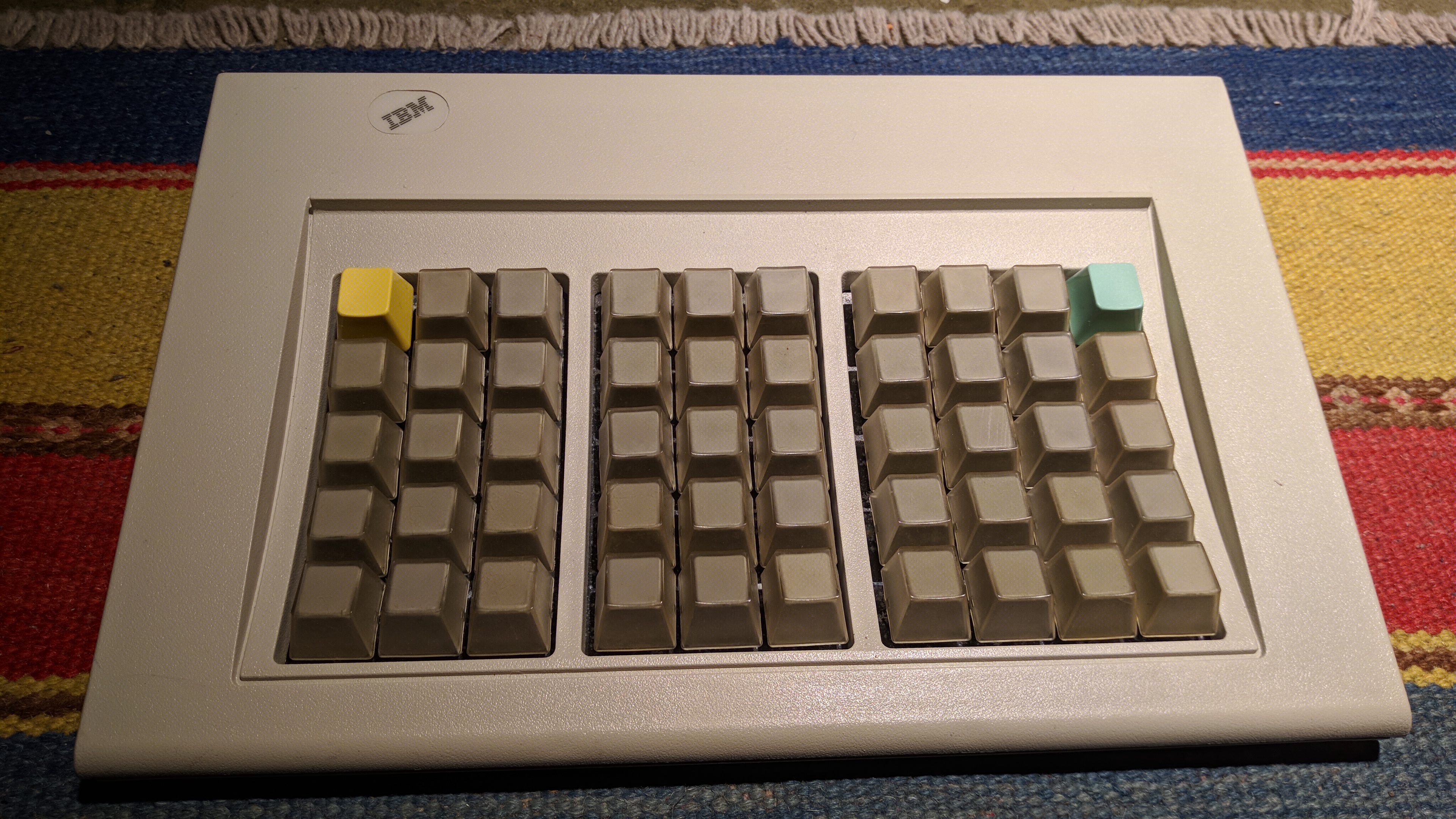

Great find! Those keypads have a really distinctive feel. Maybe is not the same, but mine (that we talked about months ago)
has a strong bottom feeling like short travel switches (for example the short travel futabas), accompanied by a TAP sound. Anyway, would be interesting see it working. Do you checket his compatibility?

Sorry for reviving this, but I just noticed today that mine is a M/F too. You can easily notice that by the swinging of the barrels. I did not expect that of a blue label, but it's awesome anyway.
