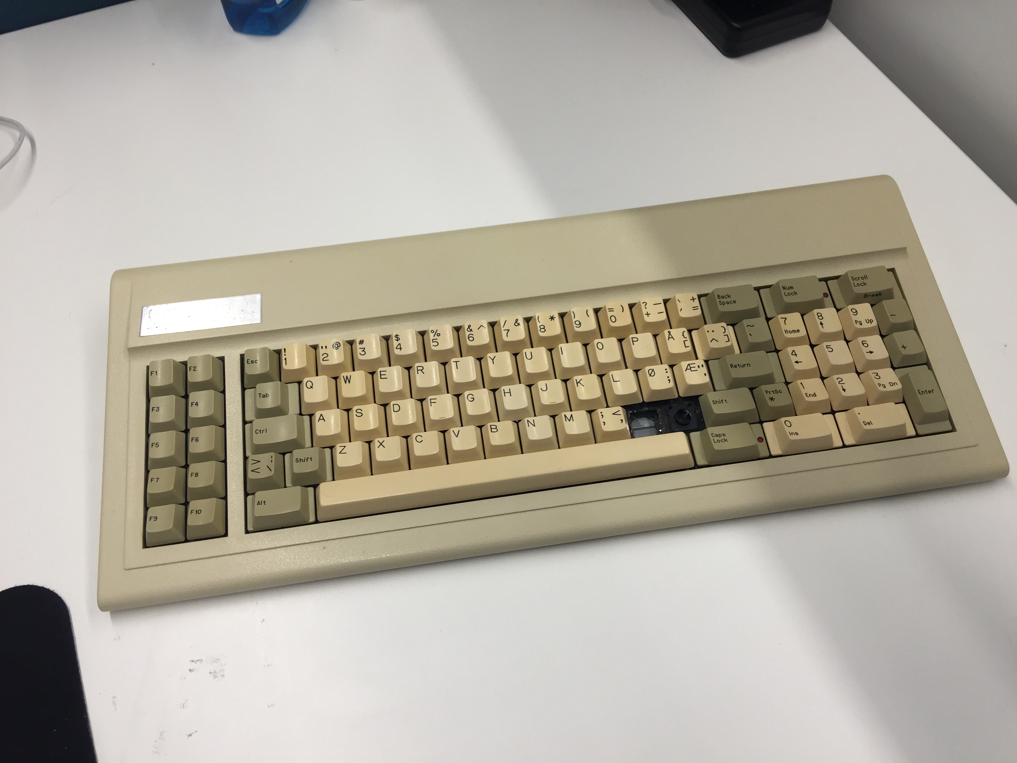

The board
The board

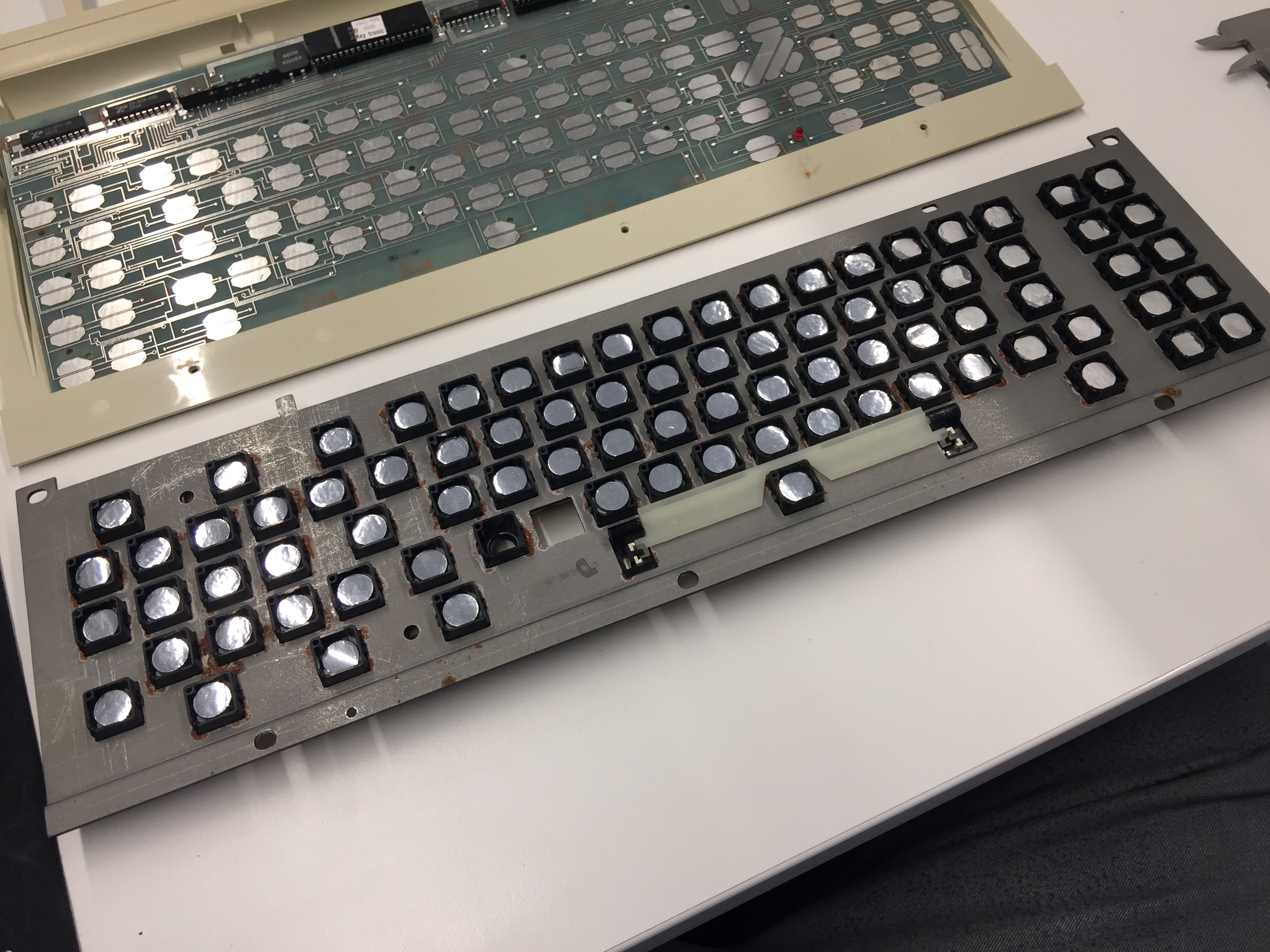

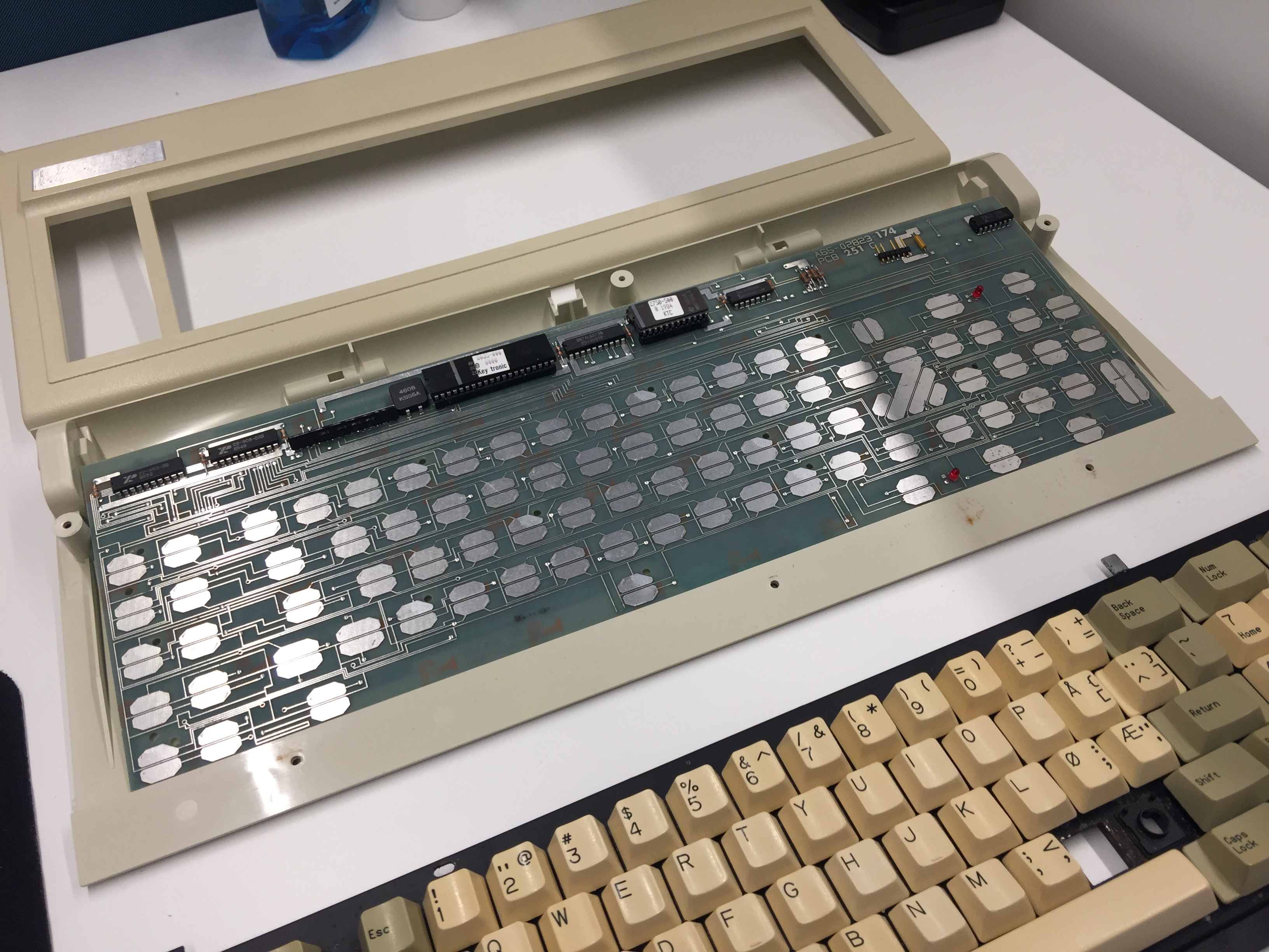

PCB
PCB

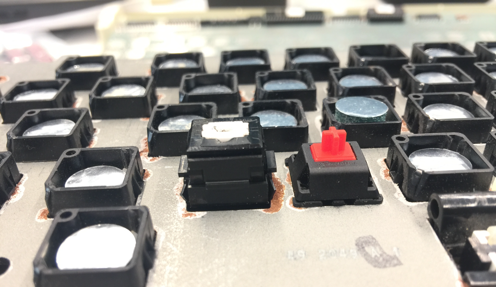

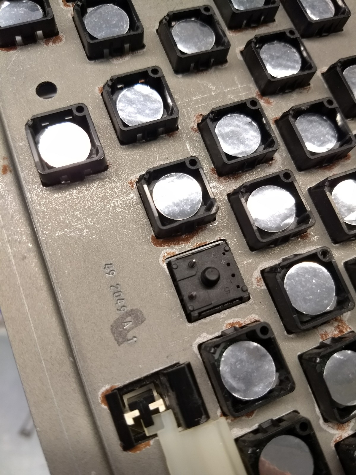

Back of the plate with some switches either partly or completely removed.

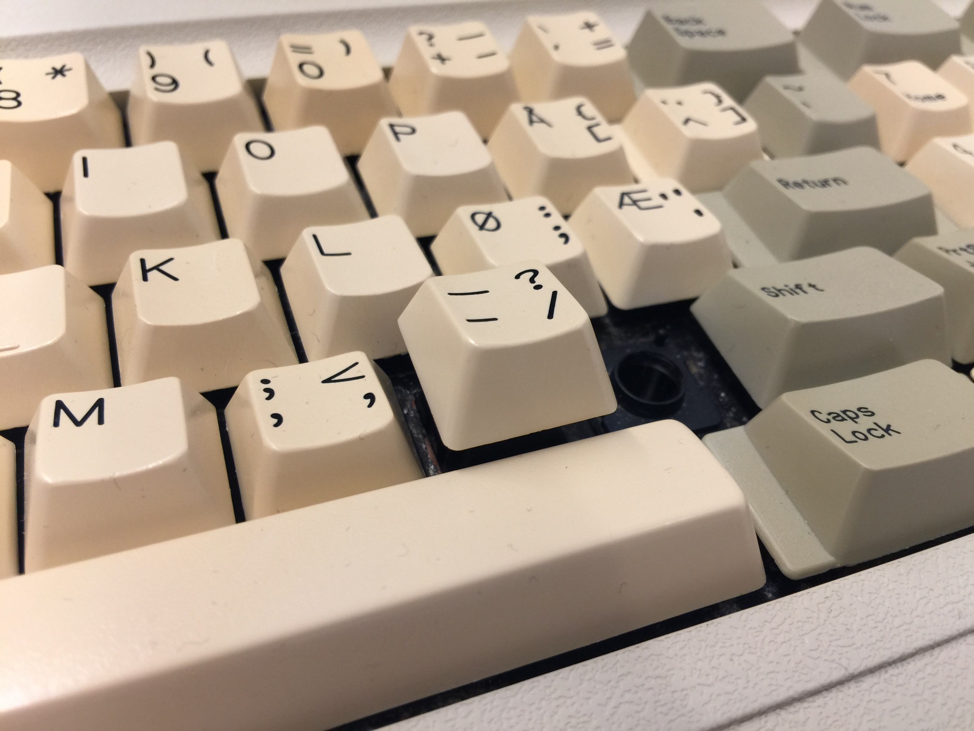

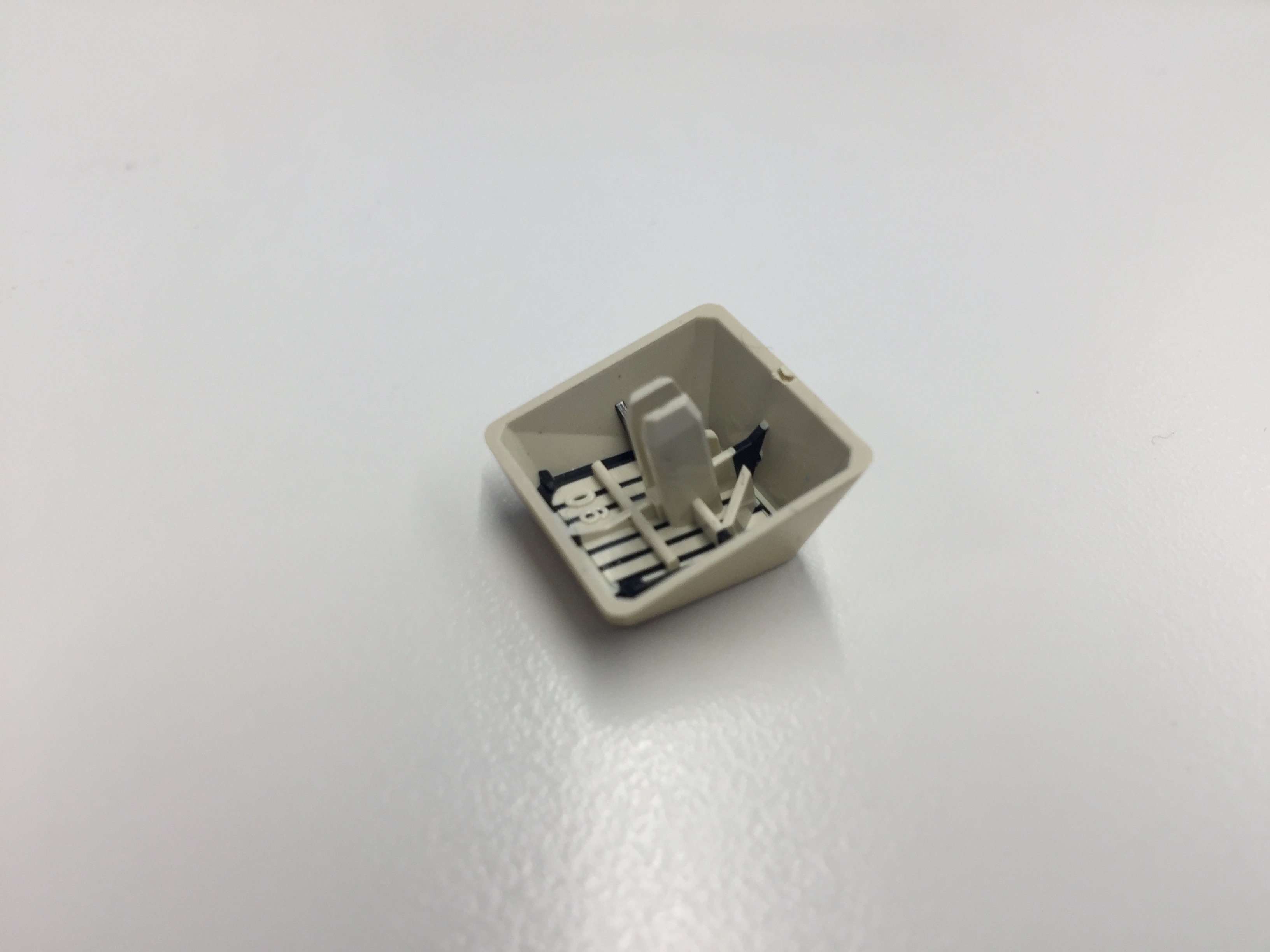

Keycap and slider. Note how tall the stem inside the cap is.
Kailh brown switch test fitted. Note the narrow slit. I'm hoping this is only b/c of some bent retainers on the switch itself..
Keycap closeup. If this was to be converted to say MX I'm guessing that the stem inside has to be trimmed down.

Replacing the switches could work as long as the switches themselves were hot glued into the plate, however then you would need to manually handwire the matrix. As for the keycaps, making some adapters could be possible, however you would need to first find someone to design the adapters for you , then find a good enough printer to print them at the tolerance you would need. Then there is an other problem of the extra height of the end result once you make the adapters the keycaps will sit higher then on the original board and so will probably end up outside the case anyway and will also probably wobble more because of the extra height. My best suggestion would be to leave the keyboard in it's present state for now or if you are really wanting it to work, then the traces can be mapped and then converted for USB, however there is little that could be done to improve the switches as they are aside from replacing the foam that has probably disintegrated by now. Sorry if the above seems so negative, it is just that it is going to be hard to achieve what you want to do by using such an old layout and with non standard sized/stemmed caps. If you really want to try converting/ handwiring etc even building a custom keyboard from scratch those are great goals and should be appreciated that you want to learn these things as you can then build a keyboard in whatever layout you want with keycaps wherever you want. I have recently handwired my own custom board so i can help if you were to go down that route.

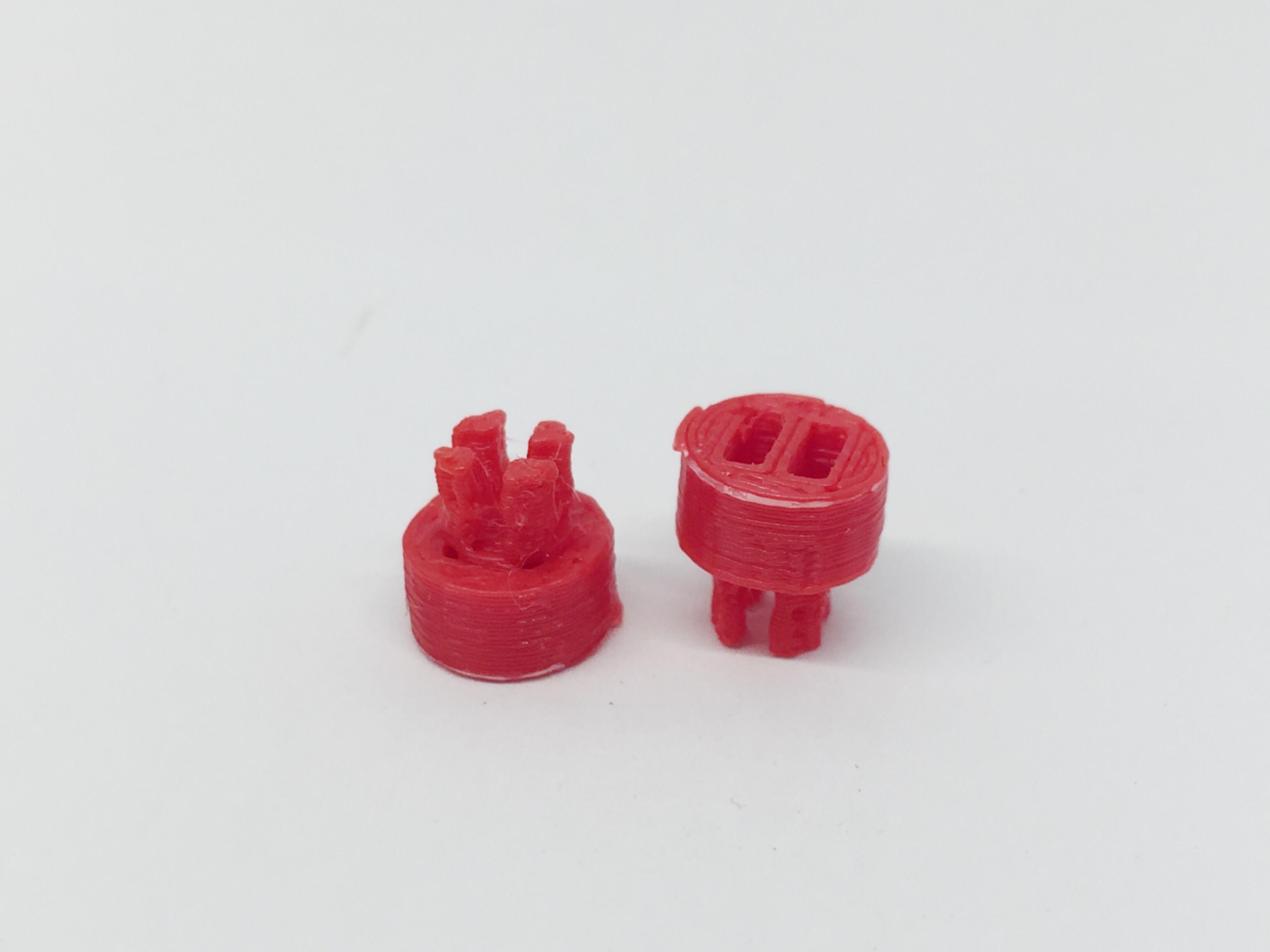

Thanks for replying Anakey. I've been working in Fusion 360 and tried to print some prototypes on the 3D-printer I have access to via work. My findings are in accordance to what you've been saying:

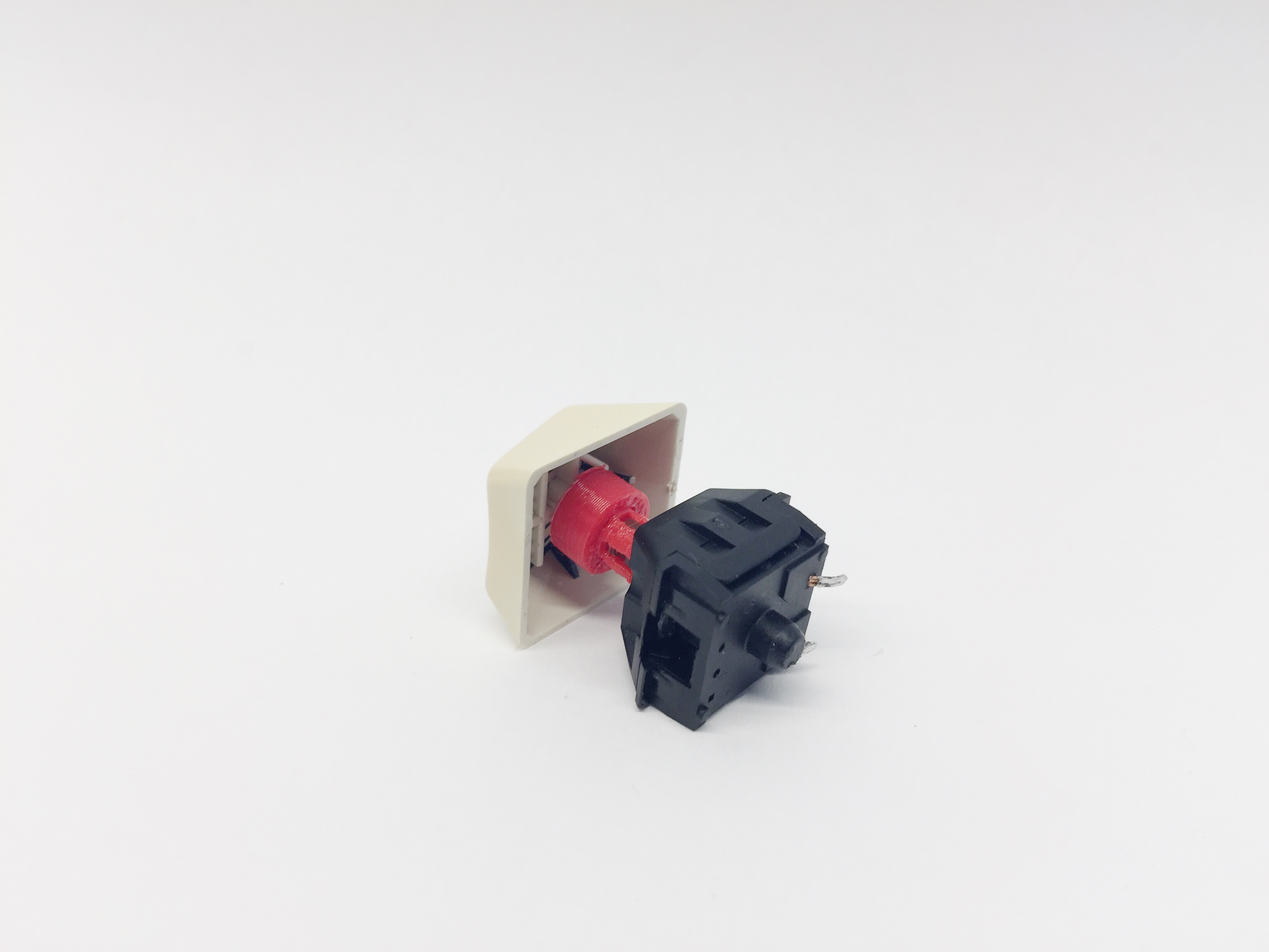

Adapter, top and bottom. Total height is about 8mm, which corresponds to the barrel of the original slider inside the old switches.

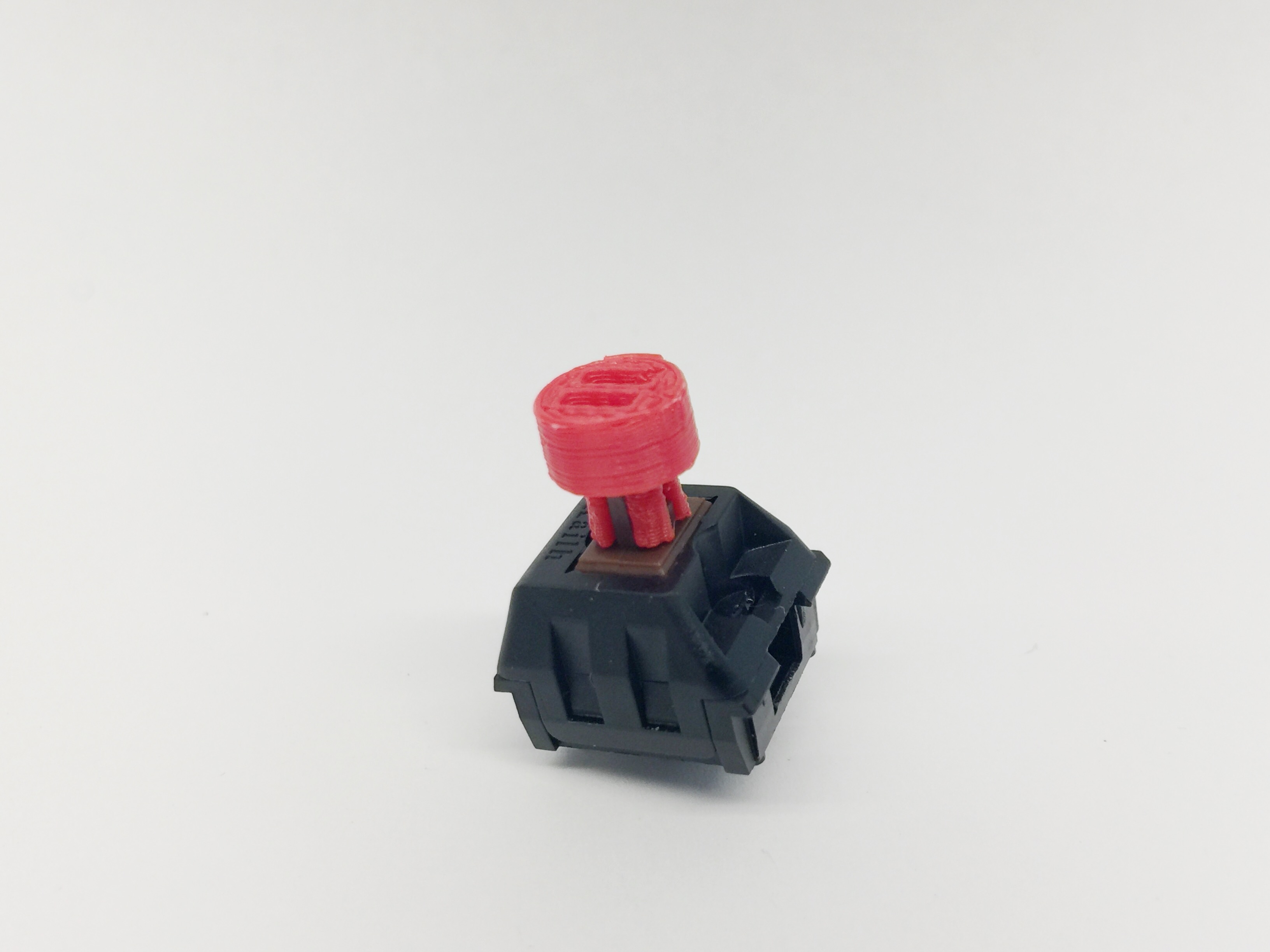

Adapter test-fitted on a Kailh brown-switch. The print result wasn't the best, so the adapter is quite fragile, but it does the job as proof of concept.

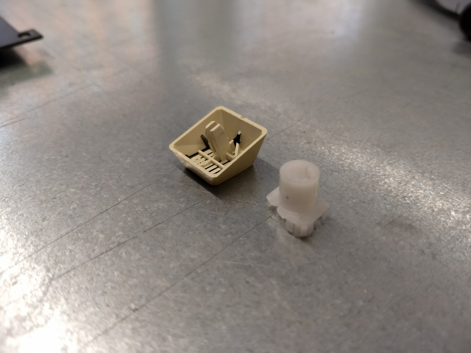

In order to try to reduce the height of the switch + adapter + keycap I decided to file down the original stem inside the keycap(s). For all I know I need to file away even more, but this is a start.

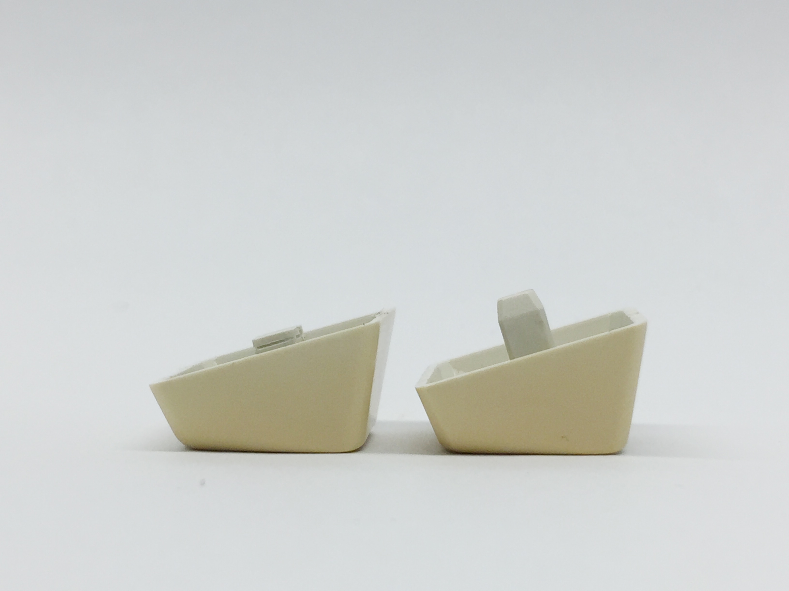

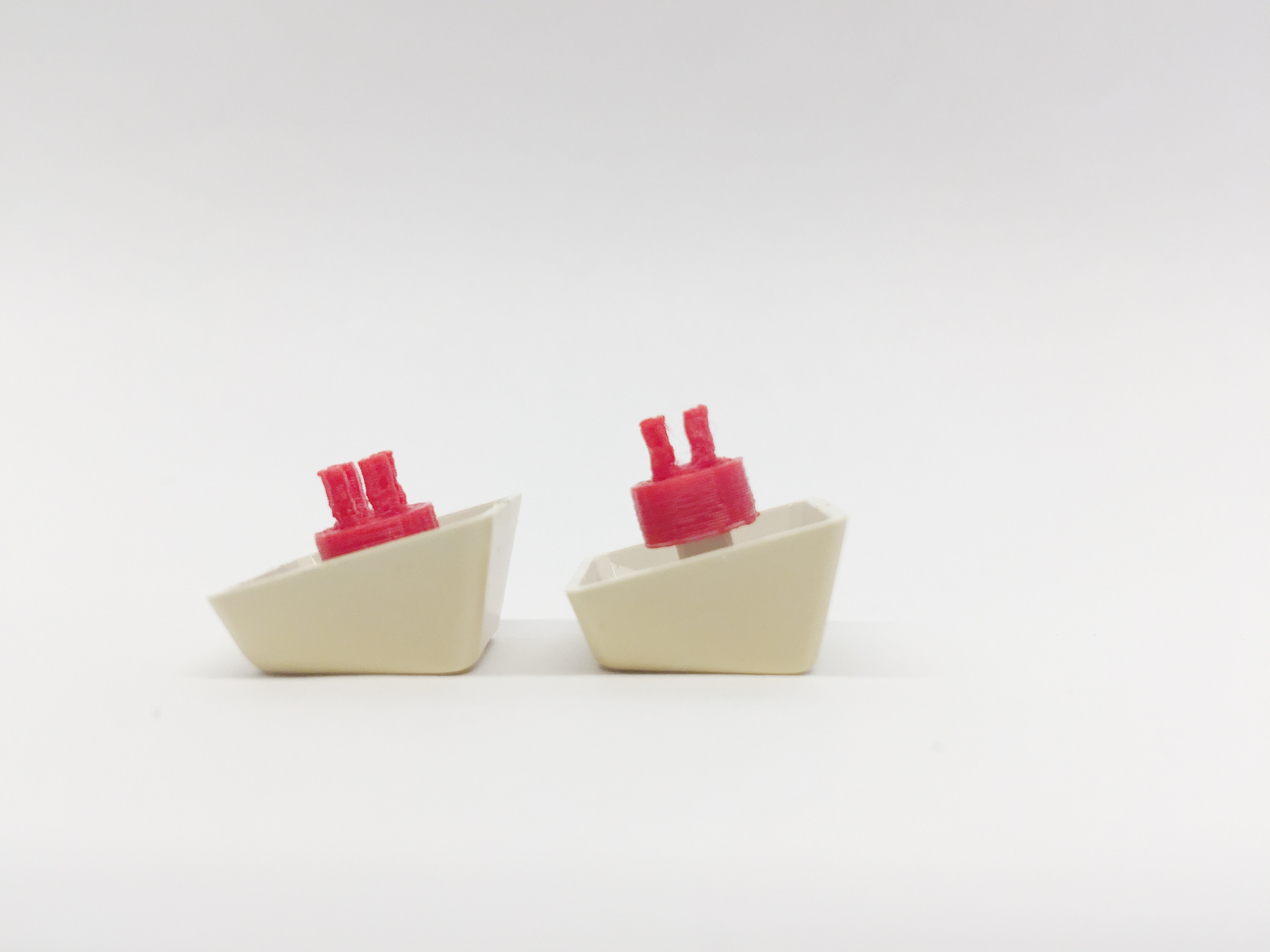

Keycaps with adapters. Notice the difference in height.
Switch + adapter + keycap. It's massive.
Height difference of the "new setup" compared to the original height. I can't have it be this tall.

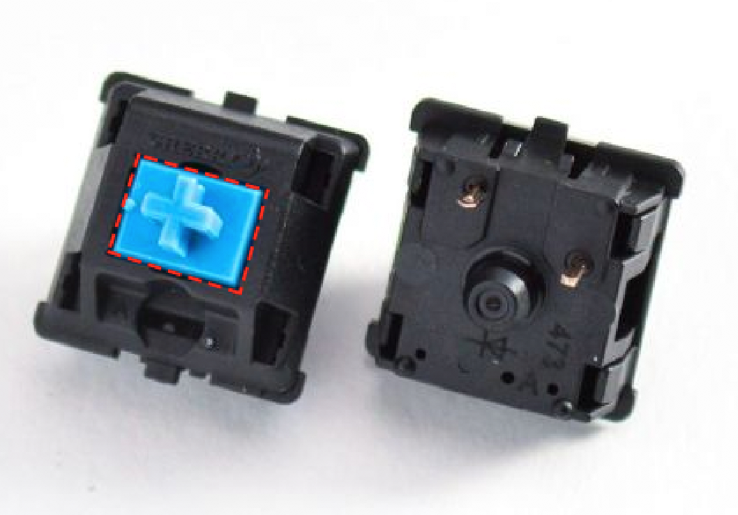

(Bothced) Alps switch vs. Cherry test fitted in the old plate of the board.
Screen Shot 2018-04-06 at 08.45.45.png (2.66 MiB) Viewed 3311 times
I mainly picked Cherry since it's more easily available (I have a board already in the process of de-soldering), and so the total cost of the board then will be lower. Some quick measurements also tells me that the … "outer border", in lack of a better description, is ever so slightly larger on MX vs. Alps, so I don't know if it matters, but instinctively this tells me there's more "headroom" for a possible adapter to slide in and out of the housing.
Screen Shot 2018-04-06 at 08.32.08.png (614.33 KiB) Viewed 3311 times
