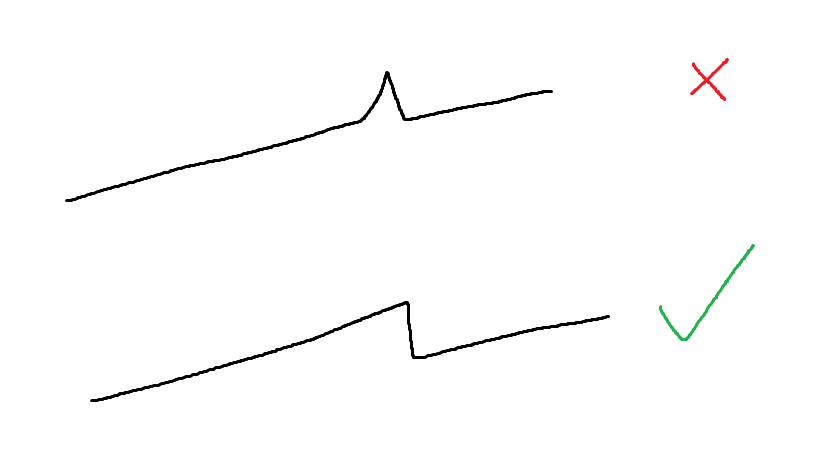

I prefer switches that don't "stop" just before the click (most noticeable with MX Blue or Box Navy), but rather gradually increase in force before dropping (like Alps, Kailh Bronze, buckling spring). To me the ideal force curve is something like the beam spring (https://plot.ly/~haata/454/ibm-beamspri ... ngled-nib/), although I've never actually tried one. Since my words don't do a great job of explaining, here's a 5 second MS Paint job to illustrate.
(on that note, any tactile switches with a force curve like that? They all seem to have "round" rather than sharp tactile points)
