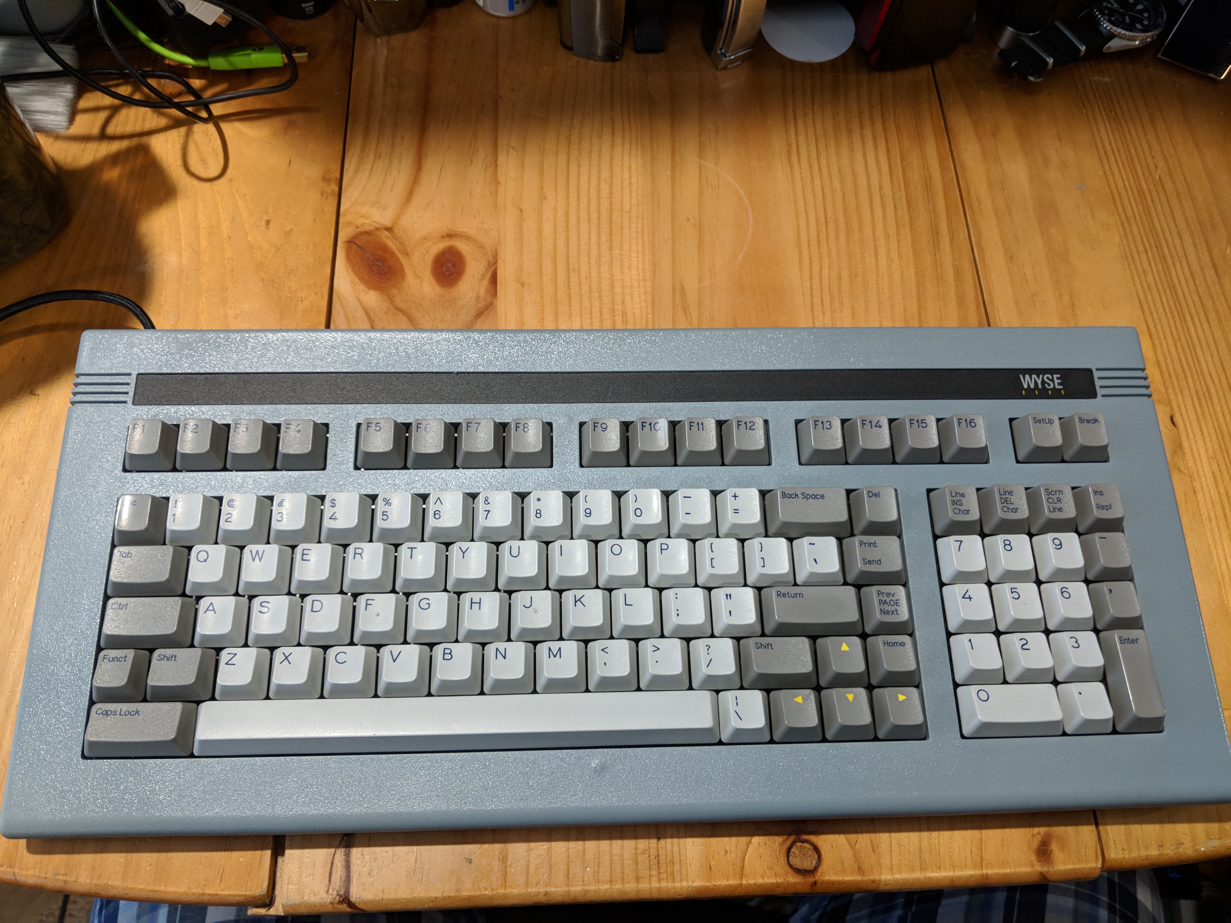

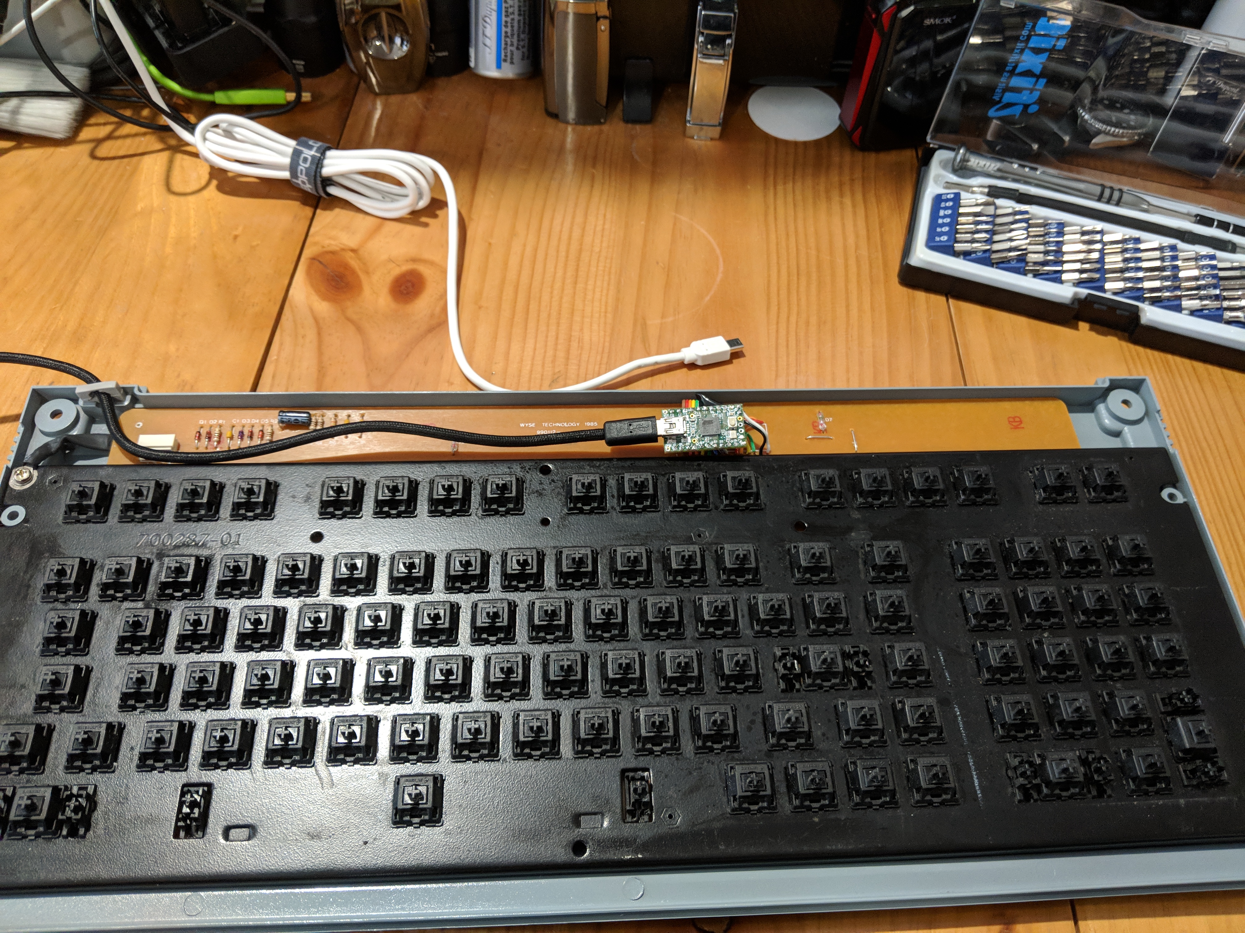

As this keyboard I have didn't work with Soarer's WYSE Converter for unknown reason, no id received by the converter and every single pin from the controller was giving 0.5v~5.0v. I've confirmed pinouts with continuity check and colour coding seems to match other people's picture I decided to replace the controller.
Thank to this excellent post by ScottPaladin I was able to do most of the work in two afternoon:
workshop-f7/wyse-ascii-restoration-and- ... 18829.html
The mega download is the json file for TMK I've made, enjoy!
https://mega.nz/#!qRN03YLZ!0bnenWDiAz8c ... vpProL9Hw0
- IMG_20180625_171737.jpg (4.45 MiB) Viewed 4179 times
- IMG_20180625_174626.jpg (4.04 MiB) Viewed 4179 times

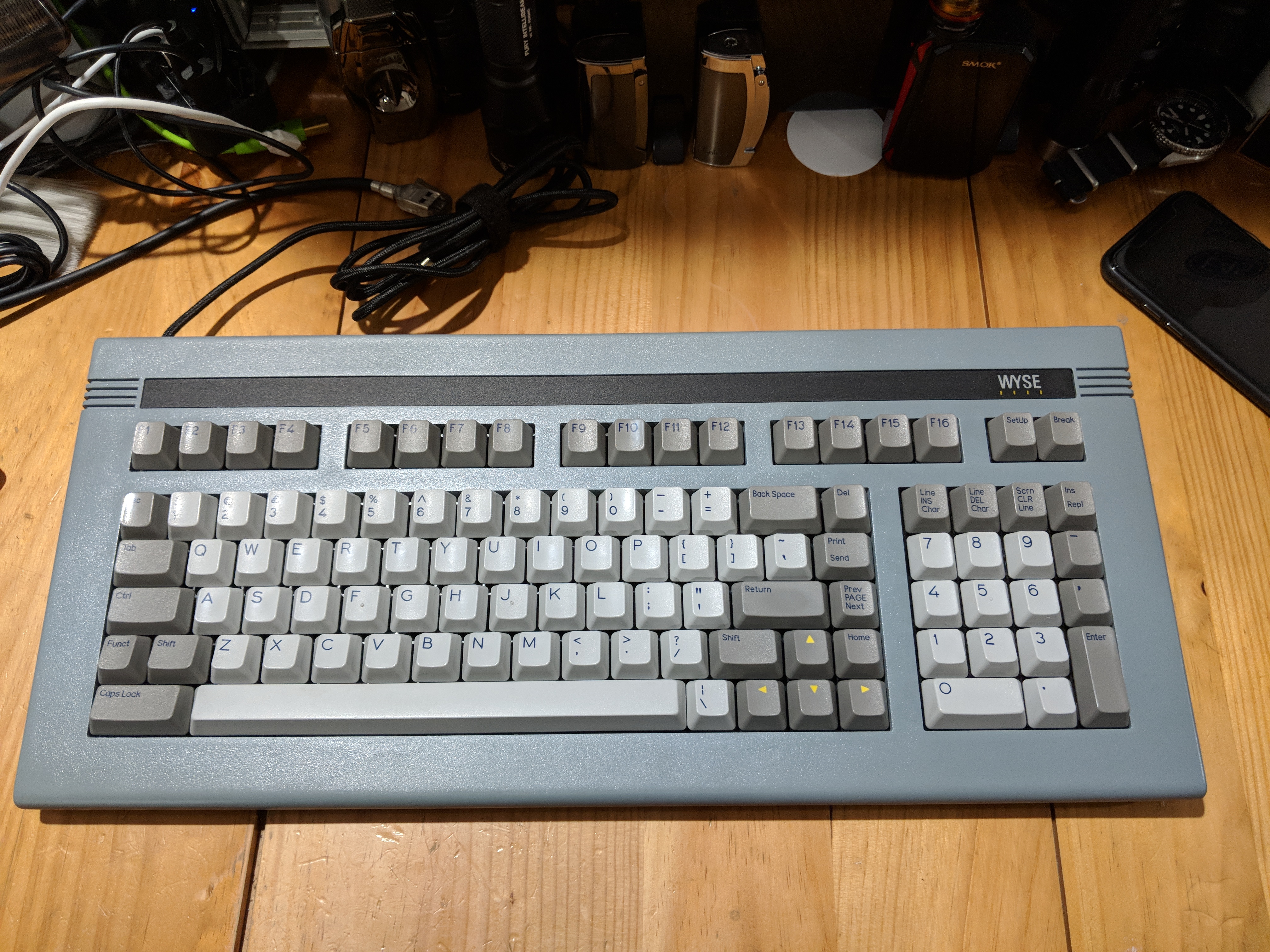

I was quite into scale models so fixing the case was not much a problem, mine had a big dent and very unevenly yellowed I fixed it with super glue+baby powder than painted
Then I put wrong size screw and caused two bumps on the case, re-sanded and painted
