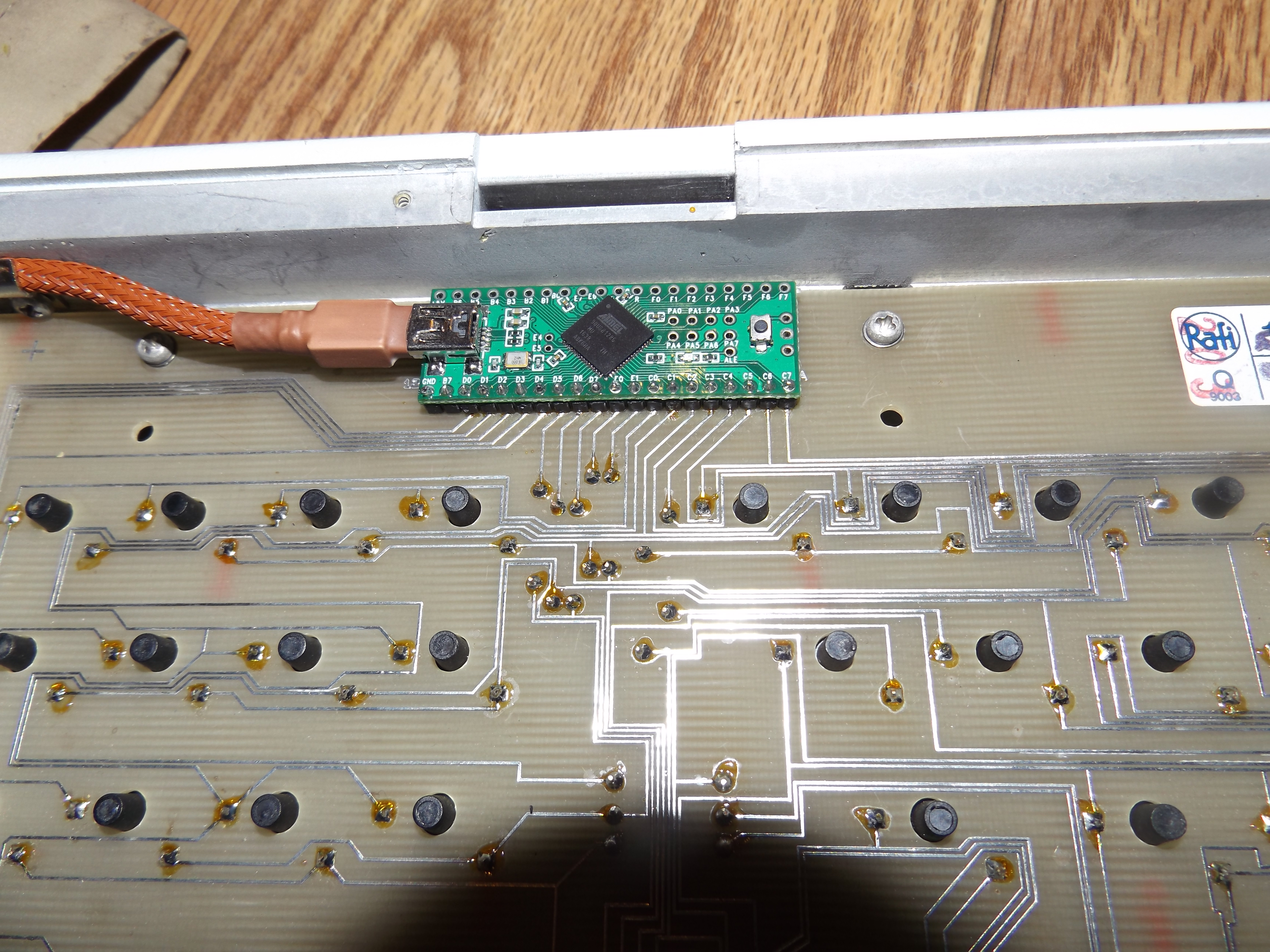

just an update to say the board is now converted to USB
25 Aug 2018, 23:30
Beautiful to see a Teensy go onto it so cleanly. There was no onboard controller? The matrix just fed straight out that big cable?
Anakey
26 Aug 2018, 00:09
yep just straight out to whatever terminal it was for through the 19 pin lemo connector luckily the spacing was perfect for the Teensy. Working out the matrix was a bit tedious with a multimeter but doable and luckily there is an online tool usually used for handwireing that was able to generate the layout file from the matrix.
