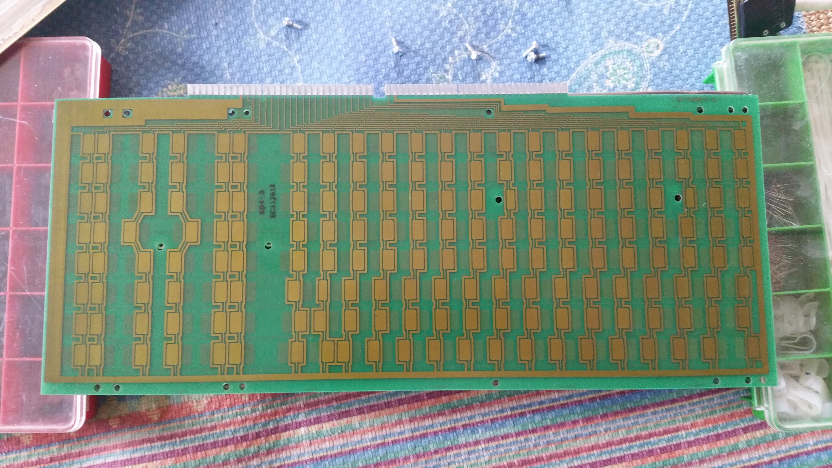

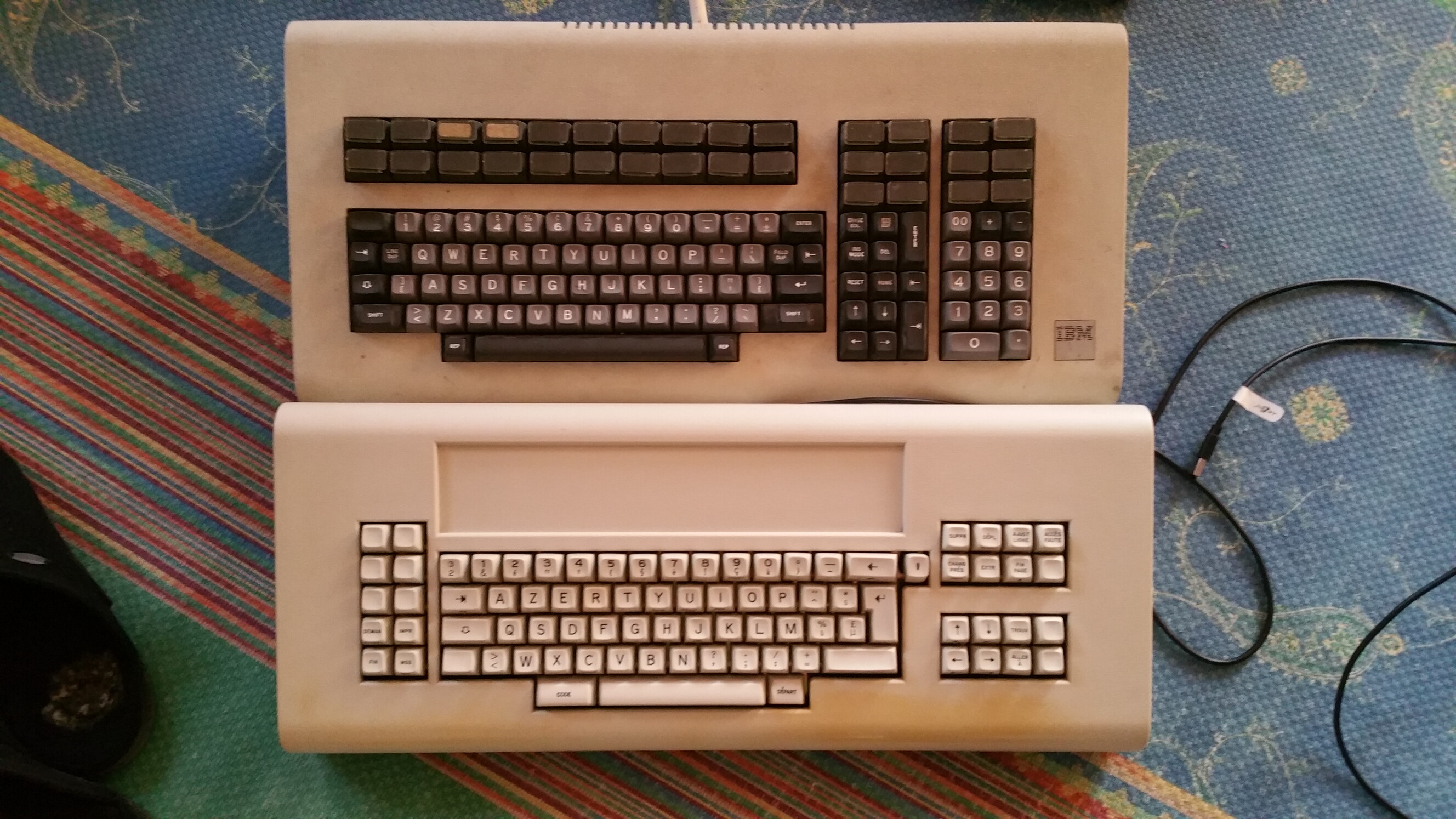

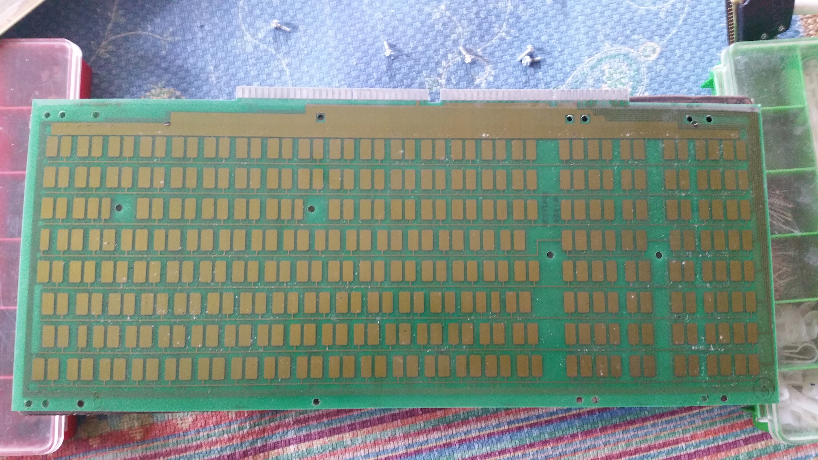

I recently purchased a working IBM Series/1 system with a 4978 Display Terminal. Due to greater familiarity, the first thing I want to do is to restore the keyboard and convert it to USB in an easily reversible manner, so that I can continue to use it for its original purpose. When I opened the keyboard I was surprised by its plate and pcb, which has a LOT of vacant positions left. The matrix seems to have 22 columns and 8 rows if I counted correctly, which makes it bigger than the usual 16x8 matrix for model F and 23x4 of most other beamsprings. As far as I understand, the CommonSense firmware with the CY8CKIT-059 prototyping kit supports a maximum of 24 rows and 8 columns, so conversion shouldn't be too difficult. Does anyone here know where to get fitting card edge connectors?
I will update this thread as I make progress, so stay tuned!
width vs displaywriter
height vs displaywriter

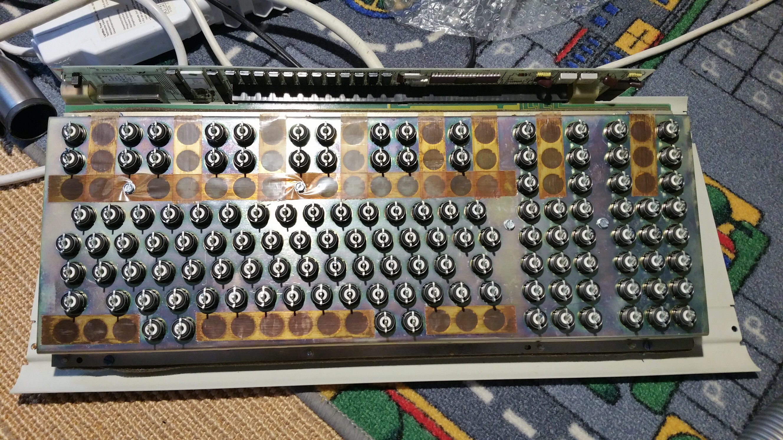

top case and keycaps removed
contamination shield removed

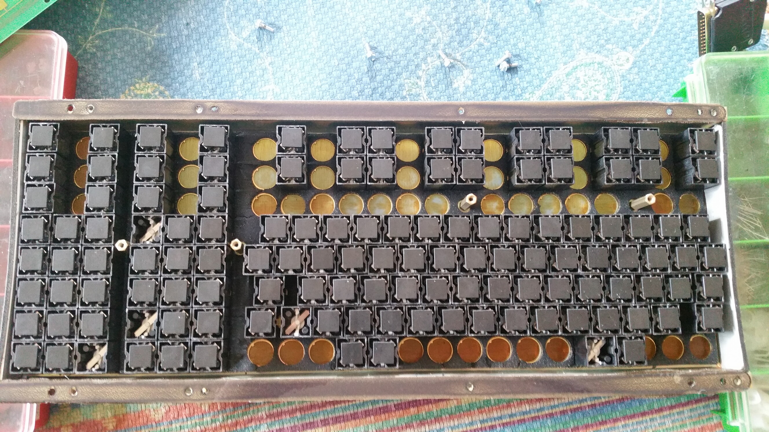

bottom of the switches
pcb front
pcb front
pcb back
pcb back

That PCB looks absolutely stunning, so many capsense pads! And the fact that it seems none of those stems have any rust.

Would be the extra pads functional? :?
14 Jul 2018, 21:18
Oh, they BETTER BE!
As I mentioned elsewhere, I'd never suggest to drill holes into this unit's case, BUT... if the keyboard were to be used caseless (or with a purpose-built case) and enough replacement switches be procured, this ginormous PCB could be put to full use and get oh so many extra functionality from it. As some of us say, more keys is more goodness. :mrgreen:

that's fucking beautiful. how big is it in comparison to a regular Battleship?
15 Jul 2018, 09:24
mark201200 wrote: that's fucking beautiful. how big is it in comparison to a regular Battleship?
I'm also very interested in this.

The extra capsense pads are wired into the matrix, so they would be functional with a modern controller, but I'm sure that the original controller ignores them as those without a switch above them would be read as "pressed" constantly.
Since I'm a fan of the Xwhatsit controller myself, after spending a ridiculous amount of money on one of these, I probably wouldn't hesitate to commission a modern PCB redesign with a 16x8 layout for only the capsense pads that are actually being used, though with your wanting to have dual use with the original system, that option is kind of out, though it really wouldn't be that much more work to swap the capsense PCB depending on how often you'll do that.
As far as edge connectors, that's the easy part to find. This will work: https://www.ebay.com/itm/140887820549, but you will have to do a little cutting on the sides to have two of them to have enough space to plug in right next to each other. The other alternative would be to use original edge connectors from other original beamspring controllers that I'm sure other users have no use for once they've converted theirs to USB.
I never realized there were all of those extra capsense pads there AND the holes in the barrel plate for additional switches. Would be really easy to split the spacebar any number of ways, or turn all the 1.5 width keys at the top into single keys for like 30 FN keys in that top left block alone, all without any modifications to the case. I also like how the double width vertical keys each have two stems with capsense pads below each, meaning that you can move those wherever you want. It's too bad it's not ANSI convertible with those extra TWO keys on most rows in the main block. However, I think it is the ONLY beamspring that has a double wide horizontal ANSI style return key. If I were to eventually find one, I probably wouldn't mod the layout at all, but knowing the customization potential is there is just pain awesome.

22x8 won't fly. Max 128 keys. Internally, scancodes are single byte, and the high bit is "pressed/released".
Not that it's hard to fix - just that nobody needed a keyboard with more than 128 keys yet.
DMA
20 Jul 2018, 05:45
Correction: CommonSense now supports up to 255 keys. Max matrix size is 8x24 though - which makes it 192 keys.
Can make 16 rows - but this will require custom hardware because there's not enough pins in QFN case (read "on prototype kit").

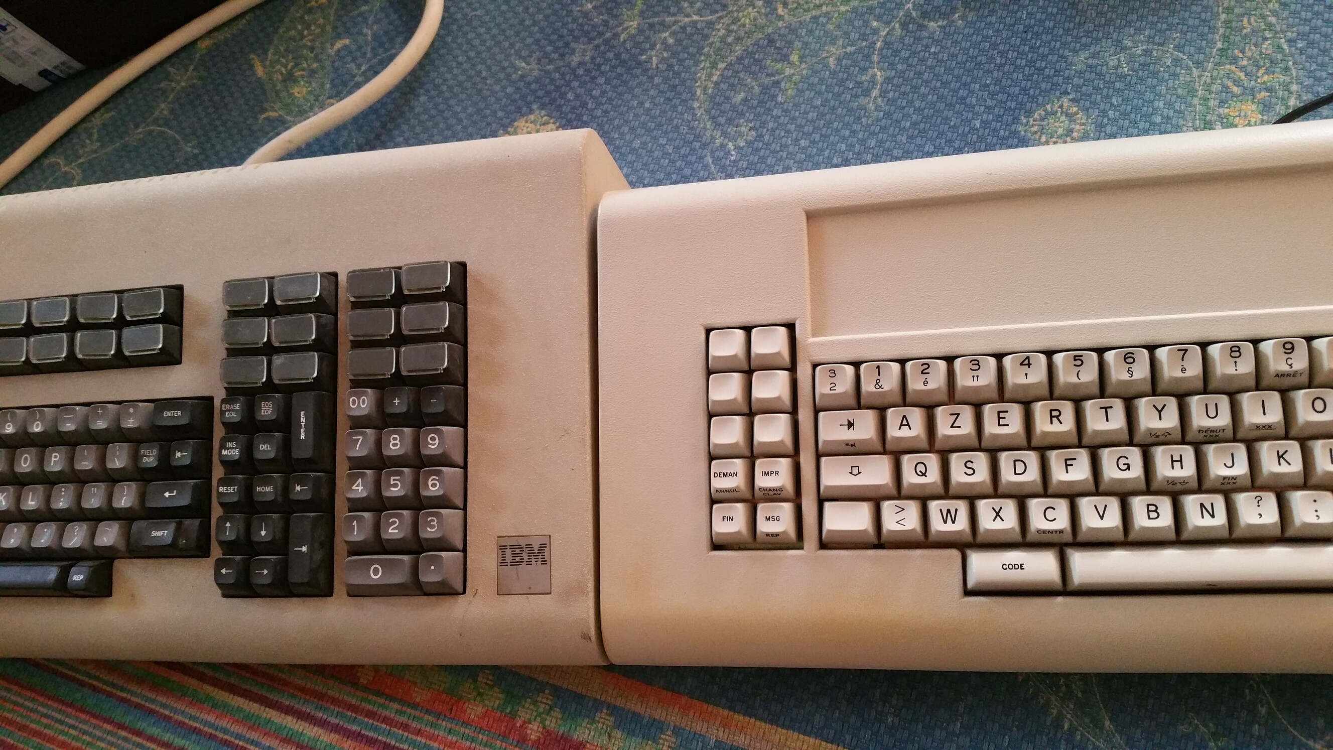

It's slightly less wide and slightly deeper, the key density is pretty good for beamspring standards:

Oh wow. I didn't think it would be as wide as it is. It really IS battleship-sized! Oo

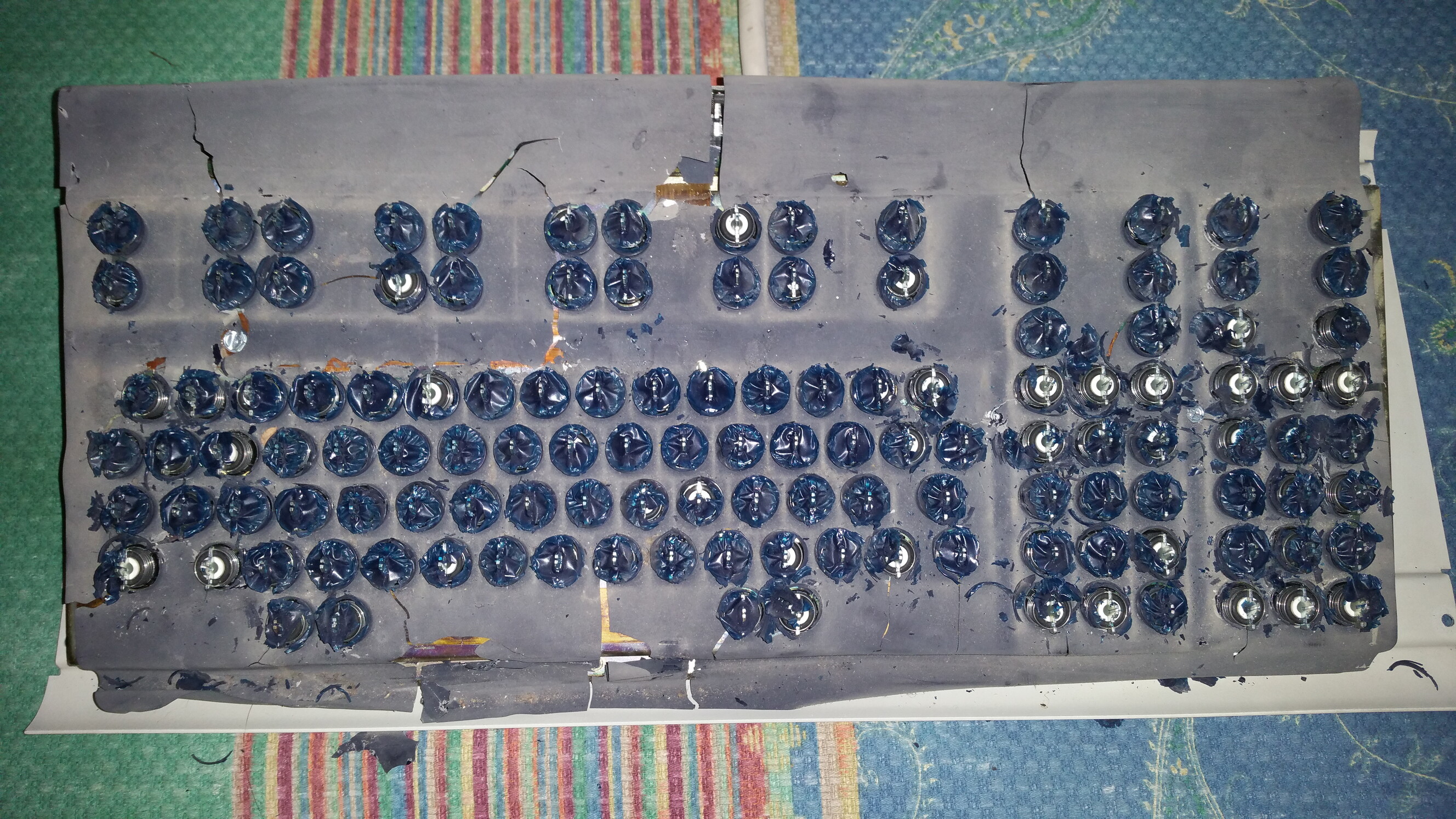

Quick update on the state of the restoration; case and keycaps are fully cleaned, metal stem inserts are pulled from the switches (luckily without any breakage!) and they were fully disassembled. Today the 2nd batch of housings is being ultrasonically cleaned, unfortunaly the foam is in worse condition than I thought initially, so that will need replacing too.

I haven't actually soldered up the controller or worked on this further besides physical restoration, and no, the top keys aren't illuminated, just relegendable. Hopefully I will find some motivation and time over easter to finally finish this project.
DMA
13 Apr 2019, 21:15
I see. You may have to tape small pieces of foil over the unused key pads. Beamspring keys lay on the pads at rest, so empty ones can appear always pressed (if empty pads read zero). For new designs it's less of a problem, you just need to make a 3x3mm square pads on unused matrix cells - row on one PCB side, column on another - to make a capacitor.
But for existing PCB - you'll need to put something conductive over the pad.
