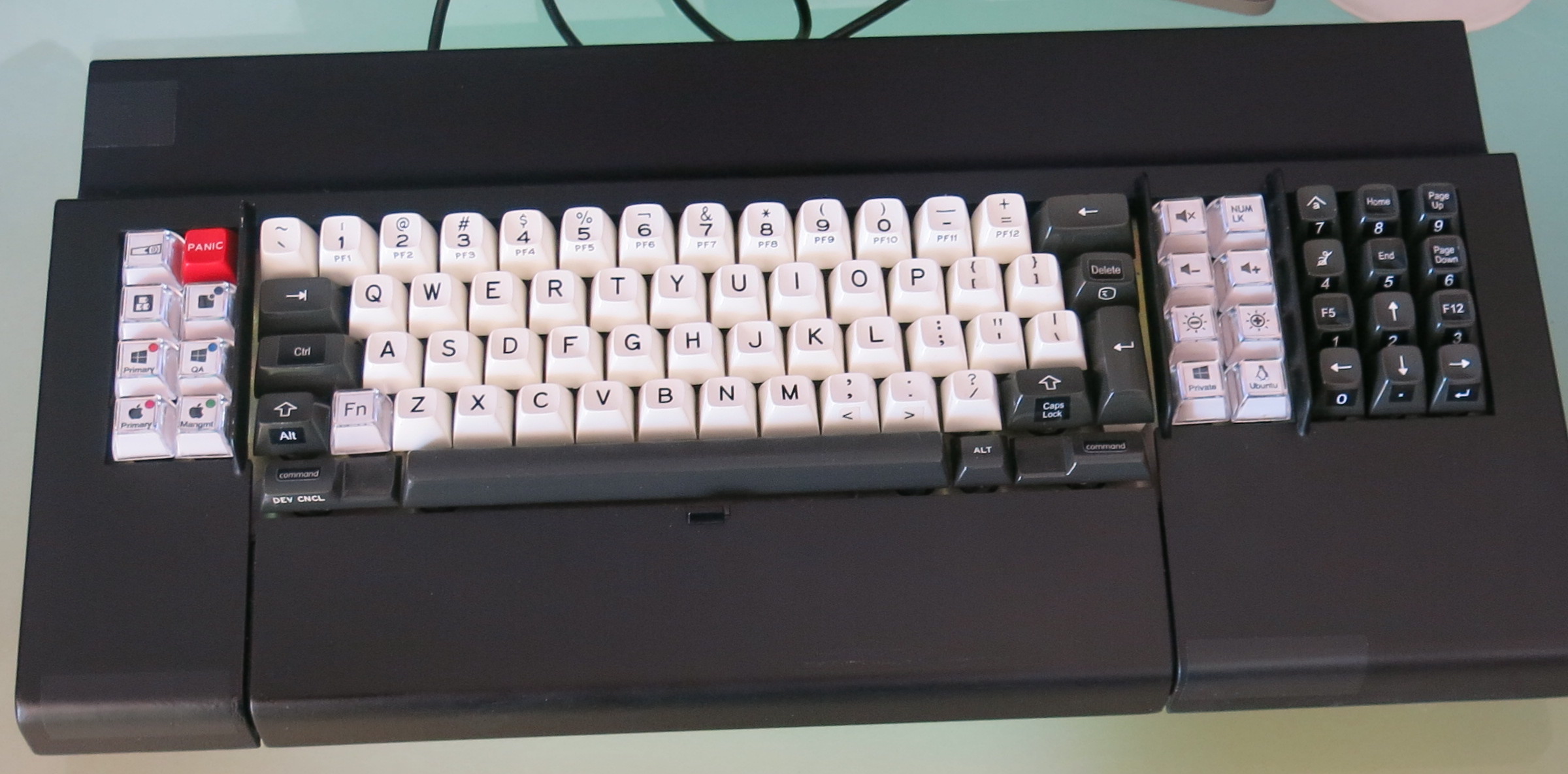

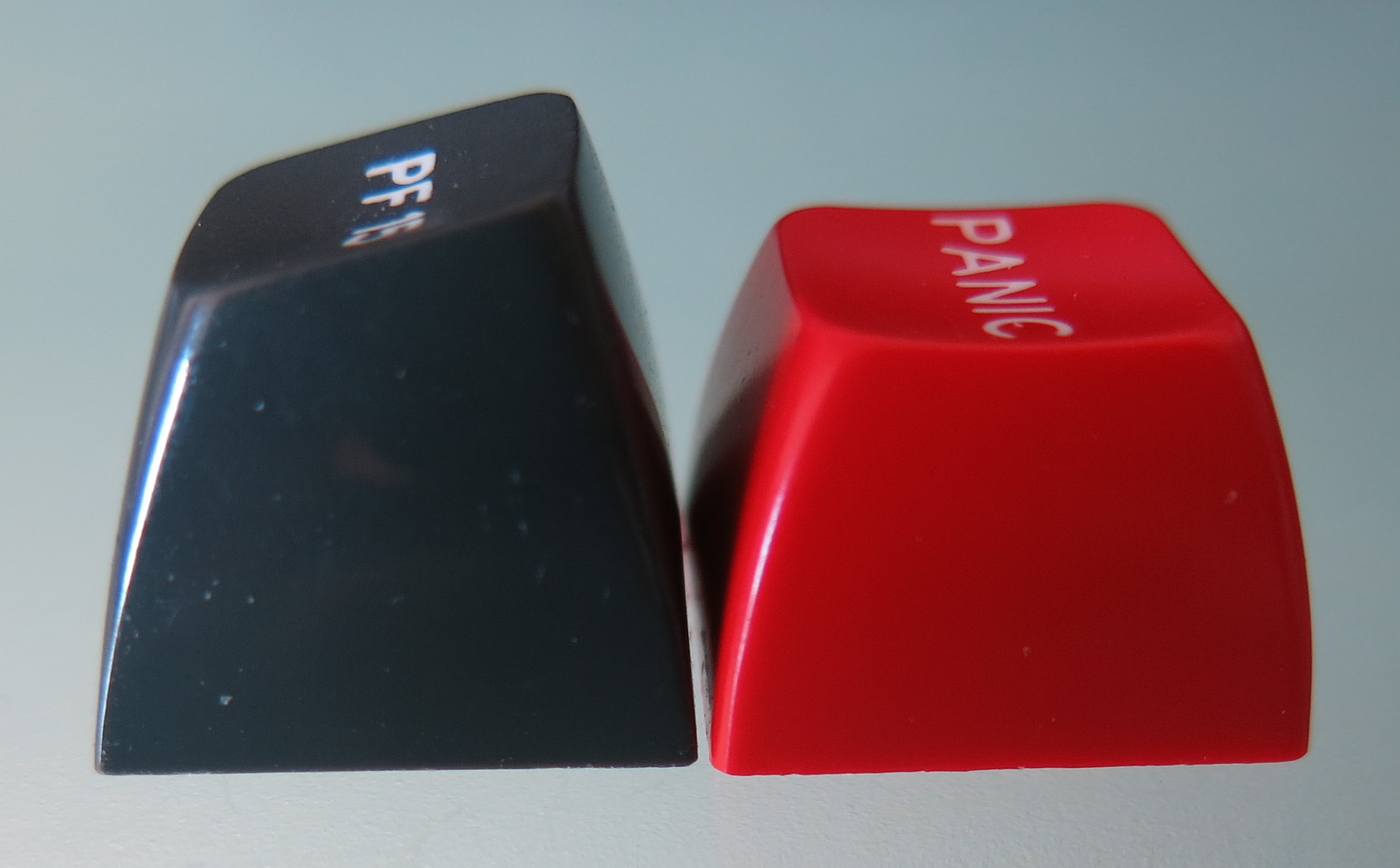

I tried multiple variants of keycaps. Below you can see pictures of a signature plastic keycap in SA R3 form factor and MX mount. It is not only the mount that doesn't properly fit, it is also the keycap shape which doesn't fit (I would need the SA R2).
The other options are very limited to be honest. Due to the limited demand, I can't see any company is doing any molds for the beam springs. I wonder how many Beam Springs are still out there in the wild? How big is the market? Just looking into the 1U keys, there are already 4 molds required to get different rows done.

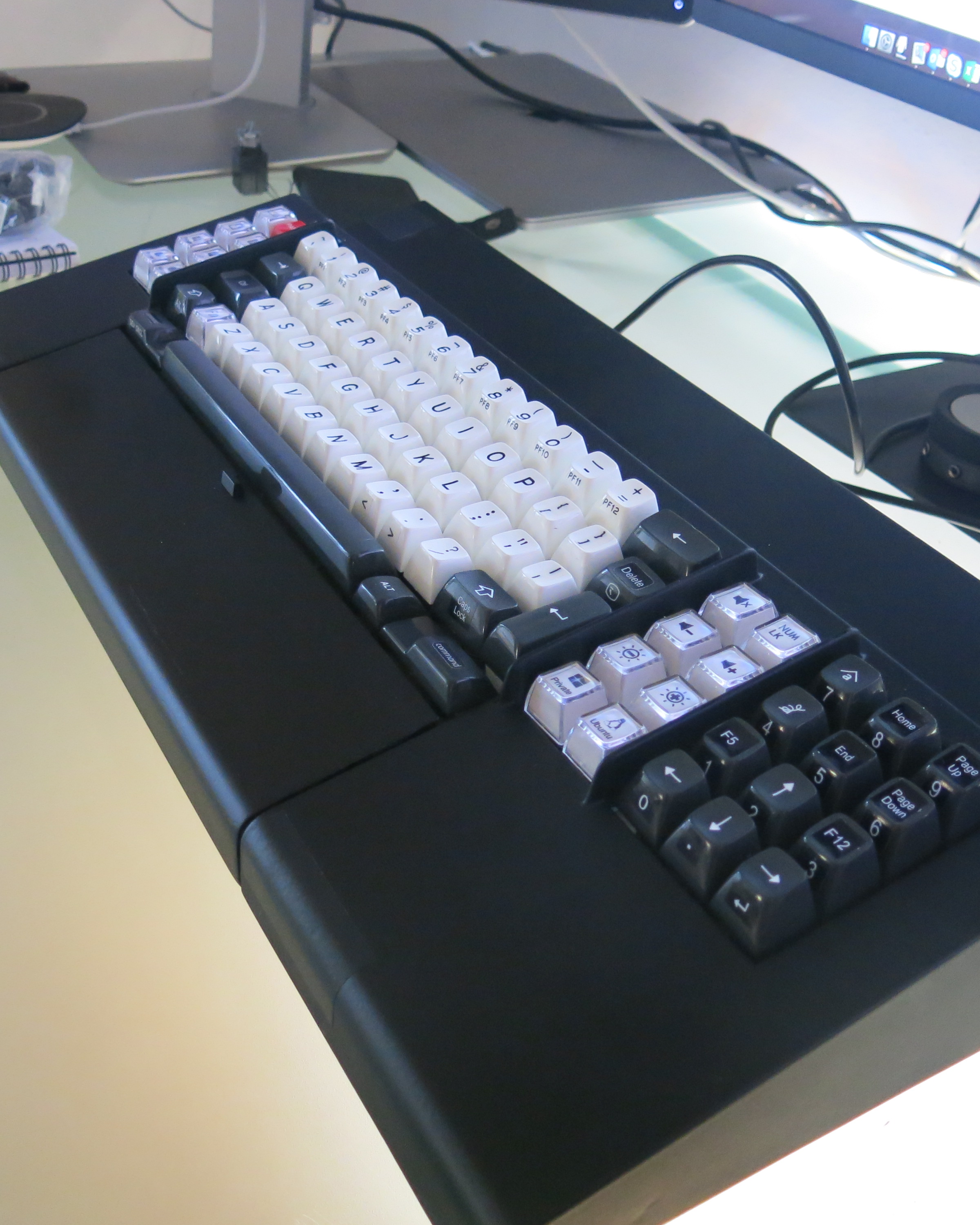

Below is a demo of the keys (MX mount Signature Plastic) put on the beam spring switches. Giving you an idea how they look. I also played with labels on original keycaps.

The labels look pretty classy!
Wondering why you chose to go with R3 rather than R1 SA keycaps for the numpad and PF clusters, since the original beamspring keycaps in these parts of the board are also R1.

I had to go for R1 as the relegendable keys are only available in this format. In all fairness, I have a hard time getting proper SA keysets in any row format. They are super rare, even with MX mount.
BTW: the ones from Signature Plastics have a strong enough MX mount and, when slightly heated with a hair dryer, will fit nicely on a Beam Spring mount. The original IBM keycaps are obviously in a complete different league.
