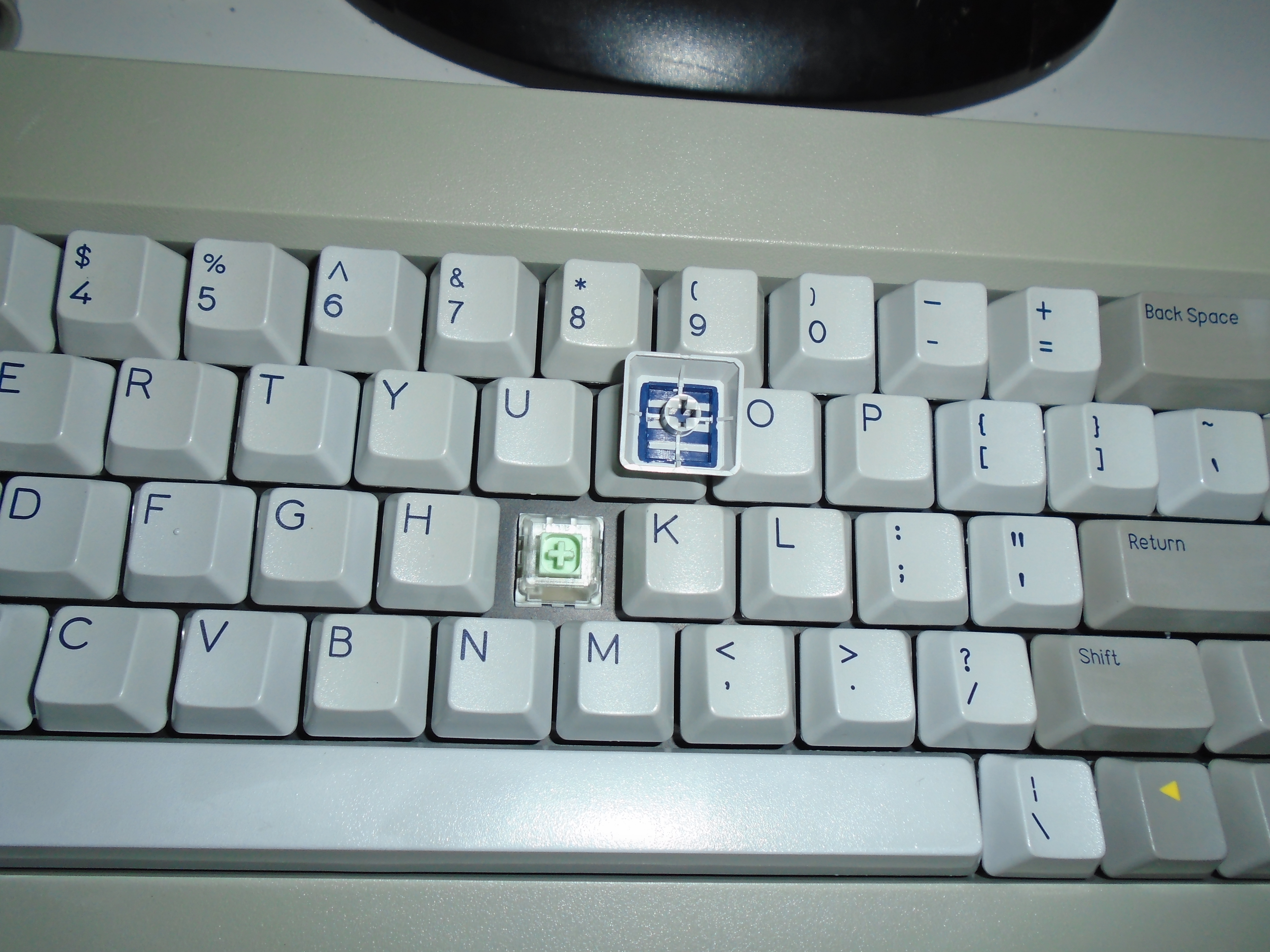

Sorry for forgetting to update this, I am now completely sure the Wyse's caps were likely ruined by the retrobriting, not the switches (the plastic on the cap itself cracks very easily on this set that I have since got rid of)
abrahamstechnology
03 Oct 2018, 22:36

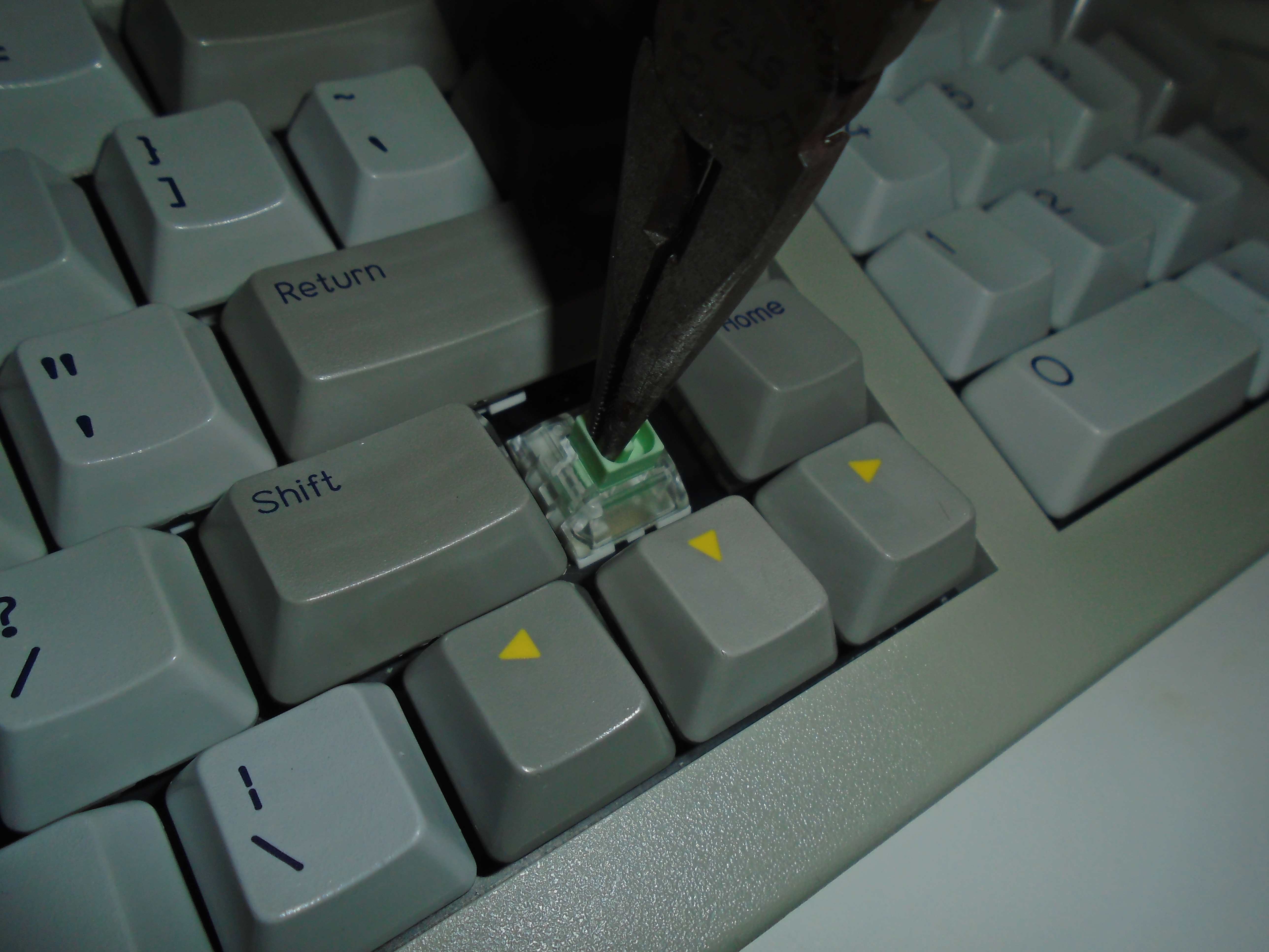

An update: I am able to remove the nubs with some pliers. It's a temporary solution for now but the keycaps still look very skewed.
snacksthecat
03 Oct 2018, 22:48
What a bummer man. I'm interested to hear if anyone else has given them a shot yet.
abrahamstechnology
04 Oct 2018, 00:49

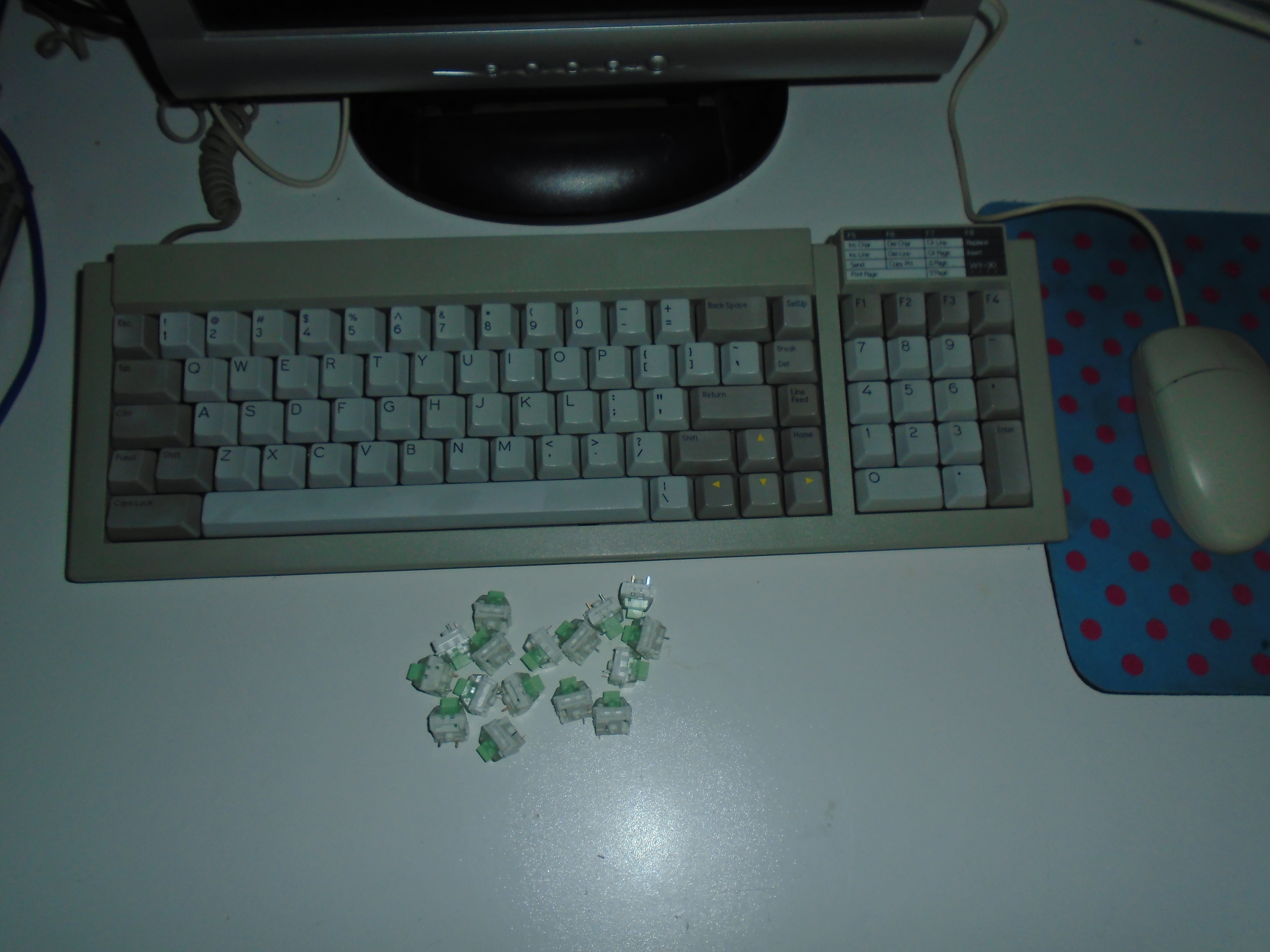

Another update: After careful shaving I have finished the board and made the keys much less skewed. It's not perfect but it's workable.

How did you shave them? I'm looking at a stockpile of 550 jades I need to fix somehow.
abrahamstechnology
05 Oct 2018, 00:20
Techno Trousers wrote: How did you shave them? I'm looking at a stockpile of 550 jades I need to fix somehow.
Using my pair of pliers, I squeezed gently on the nub and pulled the pliers up while still squeezing, then repeat for the other nub (see above photo). Doing this once seems to remove the nub, but doing it more than once may make them too loose. Make sure to have spare switches so you can find the way that works best for you.

Thanks for the recommendation. I'll give that a try. Fortunately, I have some extra box pale blues that I don't really care for, so a few of them will be sacrifices for the greater good.

Update: Many of the keycaps are heavily damaged, much worse than I first thought. I don't know if some of them are salvageable.
My caps were likely ruined by the retrobriting, not the switches (the plastic on the cap itself cracks very easily on this set that I have since got rid of)
