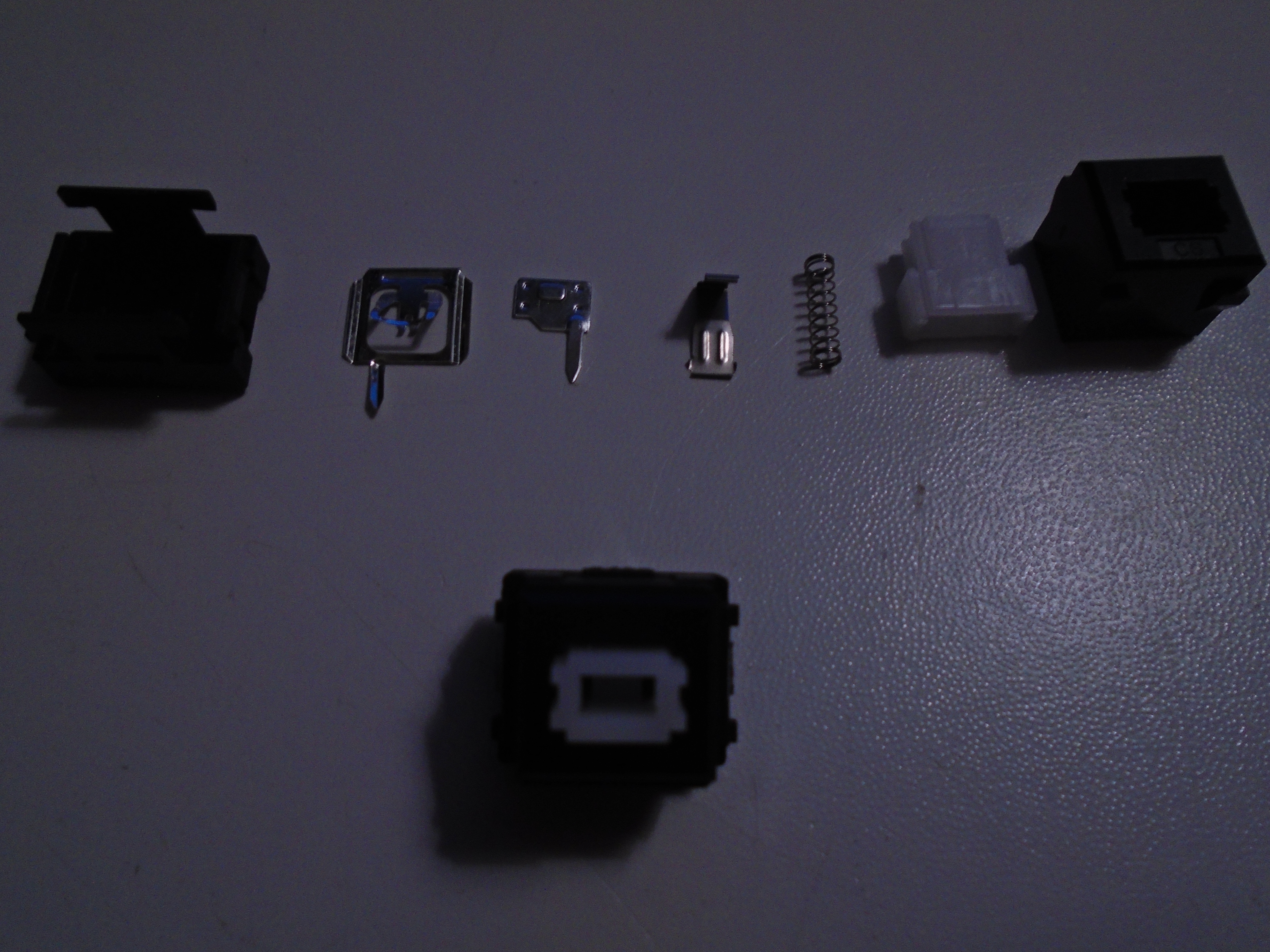

Here is a (bad) picture of the original clone switch. They can't be used as-is because the bases are slightly too big for use in an Alps plate.
See the crazy click leaf?
Also I'd like to point out the white slider is much more stable in SKCM Black bamboo housings then the original black sliders, and since these feel not that good anyway, still somewhat available, and wear out very easily, they are a prime candidate for this mod.
