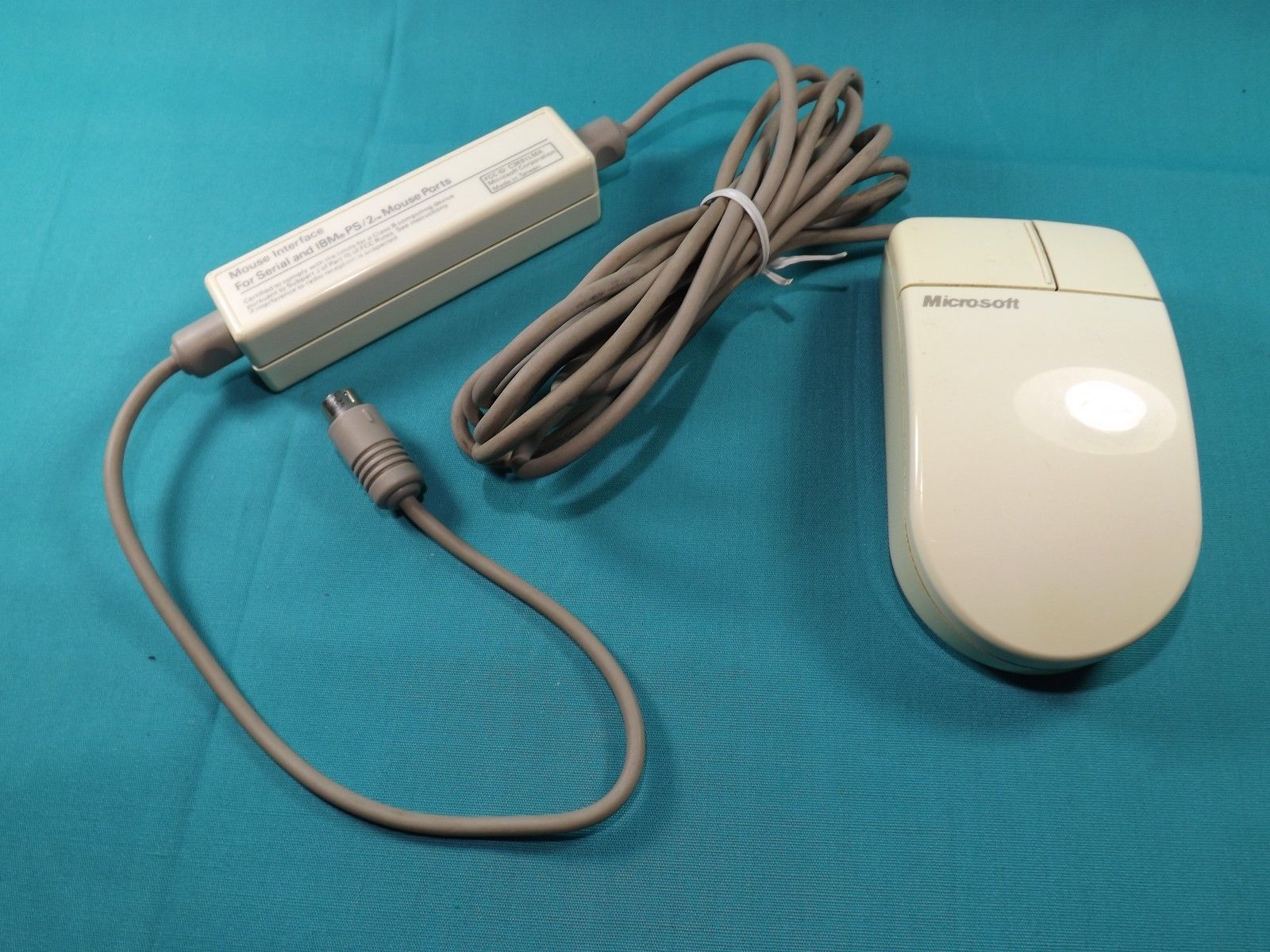

Yes, sure. Easiest way, technically, is to find MS adapter: instant compatibility with PS/2 (and serial) port. But if you can use soldering iron, you can just find an old PS/2 ball mouse and use it as a converter - either in the form of stand-alone "dongle", or by putting its controller & PS/2 cable inside your mouse.
10 Dec 2018, 16:29
Archie wrote: But if you can use soldering iron, you can just find an old PS/2 ball mouse and use it as a converter - either in the form of stand-alone "dongle", or by putting its controller & PS/2 cable inside your mouse.
Hey, that first idea is pretty clever!
A transplant of its guts would require that the parts have about the same shape... which is not always likely. But you might be lucky. Mods of old mice to USB or from ball to optical have been made that way.
BTW, if that is your Microsoft "Dove Bar" mouse in the image, please consider adding to the Wiki article on it ;)I
Archie
10 Dec 2018, 16:43
No, I've just uploaded this image to show "what's BusMouse to PS/2 adapter looks like". I don't use mice at all, but modded some of my trackballs using described method. :)
