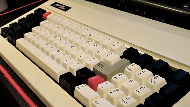

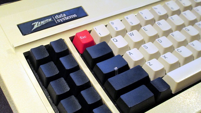

In spite of myself, I like the form factor of the Zenith Z-150 series, and the 100-1886 model sports the visually appealing black label. However, the modified XT layout leaves something to be desired, and I prefer USB protocol with a detachable cable. I also dislike the gray modifiers found on the Zenith and many other keyboards from this era -- to me, they always look dirty, even after giving them an ultrasonic bath. Some folks like SKCL green Alps (ping and all), but I enjoy more tactility and a bit of a click that doesn't emanate from the Zenith's chirping speaker.
With these things in mind, I made a few changes to my Z-150:
+ Modded the switches with tops and sliders from SKCM White Alps.
+ Installed an internal Orihalcon-Soarer converter.

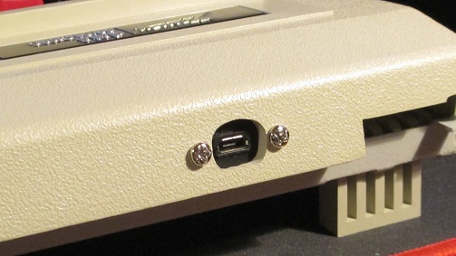

+ Installed a micro-USB connector for a detachable cable.
+ Lined the case with "art foam".
+ Remapped keys to a HHKB-style layout.
+ Replaced modifier caps with blank blacks from Matias.
+ Used red Tai Hao caps for my Esc and Fn keys.
I like the look and feel of the transformed board. It sounda great as well. When I can find the time, I will try to make some audio recordings and post them.

That looks amazing! I wonder if you can find a half-big-ass Return key replacement in red or black.

Wow!! You’ve outdone yourself, my man! This looks absolutely stellar! Very nice work.

madrobby wrote: That looks amazing! I wonder if you can find a half-big-ass Return key replacement in red or black.
Thanks! You noticed the gray Return key! ;-)
In a way, I sort of like the oddball Return. In any event, I doubt I could find one ready-made in red or black that would fit.

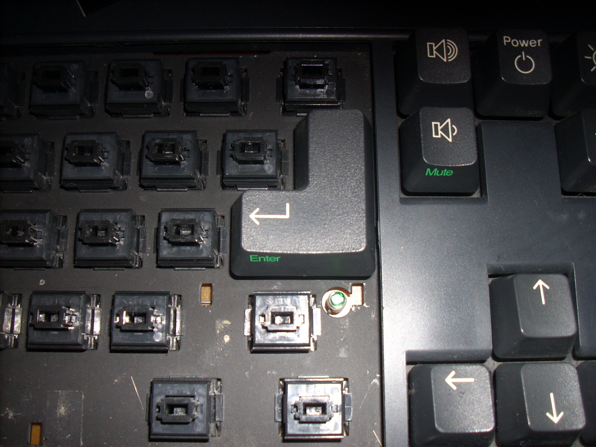

Polecat
02 Dec 2018, 20:46
What about NeXT? Not saying it will fit, but possibly?

DON'T change anything, what you have there, is pure PERFECTION in an XT format.
Sometimes the very difference that you might not like in the beginning will grow on you, until it becomes vital to your layout and style.
See nothing wrong at all having a different coloured Enter key, it means you haven't gone all 'gestapo' with trying to separate differing colours, into a single entity.
Keeping them a little different is what makes everything so wonderful and exciting.
Polecat
03 Dec 2018, 00:30
Dangling the hook!
Polecat wrote: What about NeXT? Not saying it will fit, but possibly?

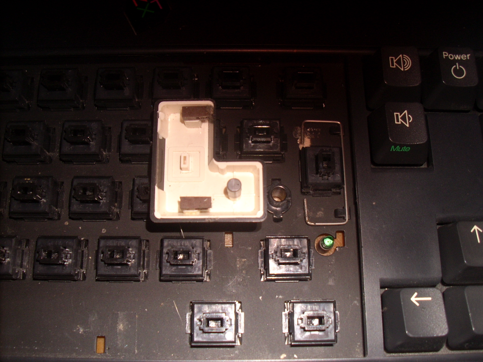

@Polecat: Thanks for your suggestion to try a reverse-L enter keycap from a NeXT keyboard. It so happens I have one of those boards. Unfortunately, the NeXT cap does not fit the Zenith board. The main issue seems to be the stabilizer post on the horizonal section of the cap.I could remove the post, but this would destabilze the key. I might be able to drill new holes and move the stabilizer receptacle, but this might damage the PCB and I don't want to try detaching the PCB from the plate. In addition, the color doesn't match. The Matias caps are black and the NeXT cap is charcoal gray.
