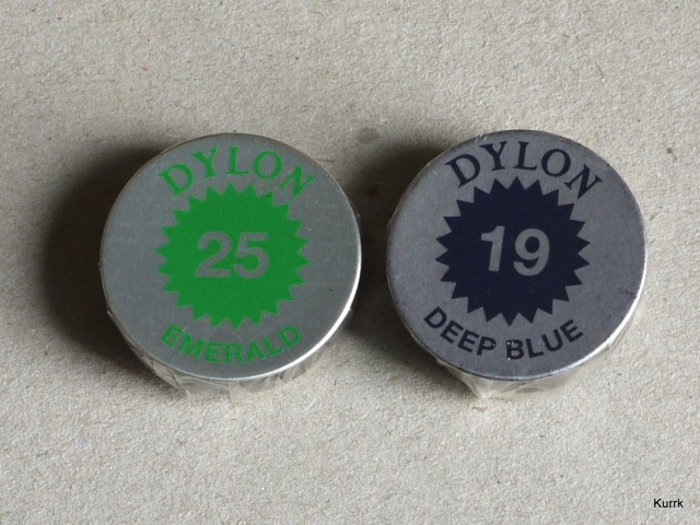

With all that Rit-dyeing going on and no easy source for that stuff in Europe I went to look for alternatives. Dylon universal dye or multi-purpose dye as it is also called, seemed to be ok for key caps as it is suitable for dyeing nylon, lycra and buttons. And it's generally available where I live (The Netherlands) but also in the UK and Germany and probably in more countries.
It comes in various package sizes and I found a few mini tins of 4.5 g each at a local craftshop.
4.5 g tins of Dylon multip-purpose dye. The blue truly is deep.

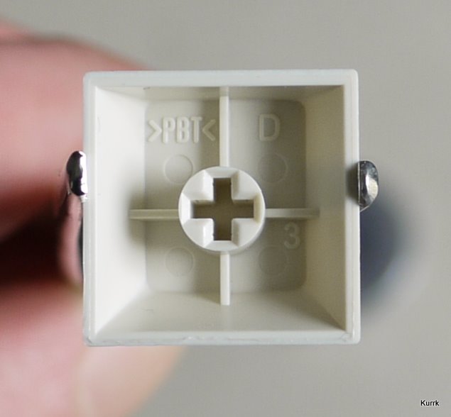

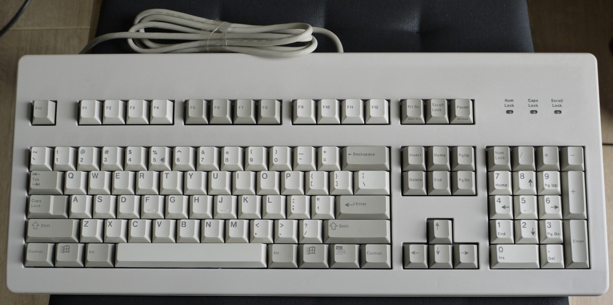

A set of PBT caps (nearly-white and light grey) of a Cherry MY board (G81-3504LAAEU) was picked as victim along with a few caps of an IBM model M.
The main subject of this experiment.
A nearly-white Cherry PBT cap in its original state.

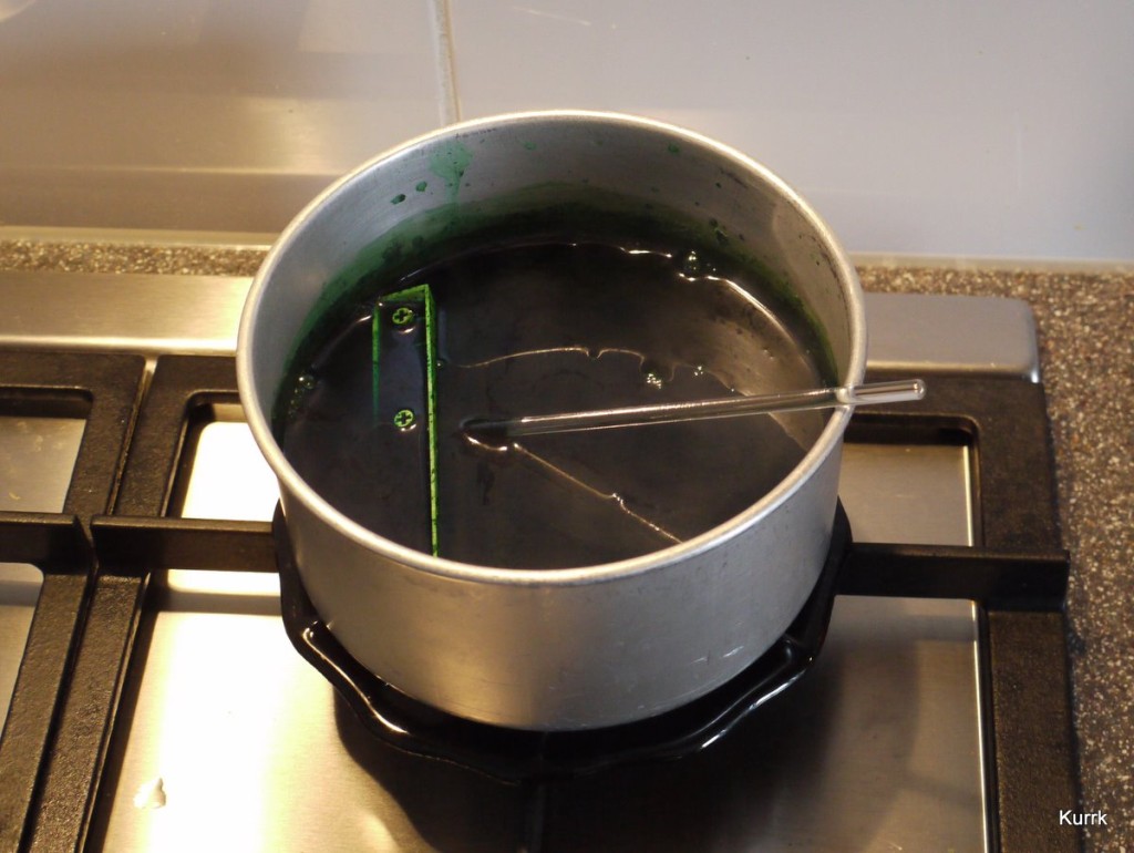

I found an old aluminum camping pan to perform this experiment in. Note: aluminium pans are not the best choice, see conclusions & recommendations.
The general procedure was as follows:
*The dye (4.5 g) was dissolved in 700 mL of boiling tap water
*The heat source was removed and 30 g of table salt was added whilst stirring until completely dissolved
*The pan was put on a simmering plate and the keycaps were added
*The mixture was gently stirred for the indicated time while the temperature was kept between 60 - 80 °C (estimated)
*After the dyeing process, the caps were washed with warm tap water and soap
1st round:
Dylon No 25: Emerald
An oily film appeared on the surface of the dyeing mixture. Probably some traces of instant-noodles. I should've cleaned the pan more thoroughly :( Some of the film stuck to the caps causing some uneven coloring. In the end (after 30-35 min) the key caps came out OK but the space bar clearly shows some darker regions.
The result is caps with quite a light green color on the near-white caps and a forest, almost military green on the grey caps. Scroll down for pictures of the result.
Green disaster. Look at all that gunk on the space bar.

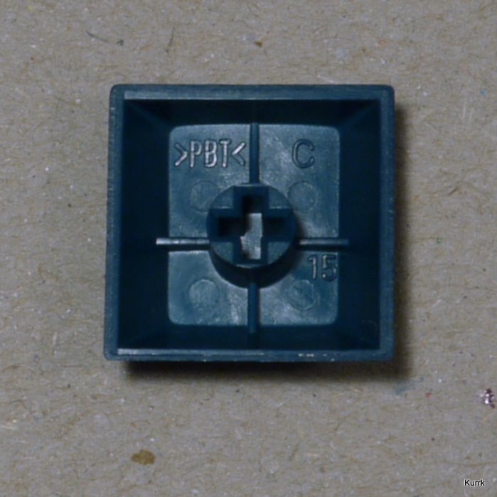

Blue surprised me: The caps nearly went otaku within 10 min, that's how well they absorbed the dye. The near-white and the light grey caps came out looking nearly the same.
A previously nearly white Cherry PBT cap. Now it's deeeeep blue.

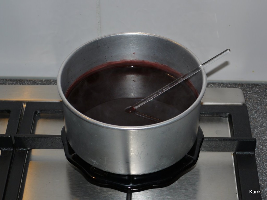

Dylon No 10: Cherry Flame (couldn't resist)
Pan cleaned with oven-cleaner, this stuff also removed dye residues. Caps rinsed with iPrOH.
This dye bath became a bit flaky over time but the dyeing process went really well. After 40 min of simmering I had some nice, red caps. They darkened a bit on drying.
The red dying solution looked much better than the green one.

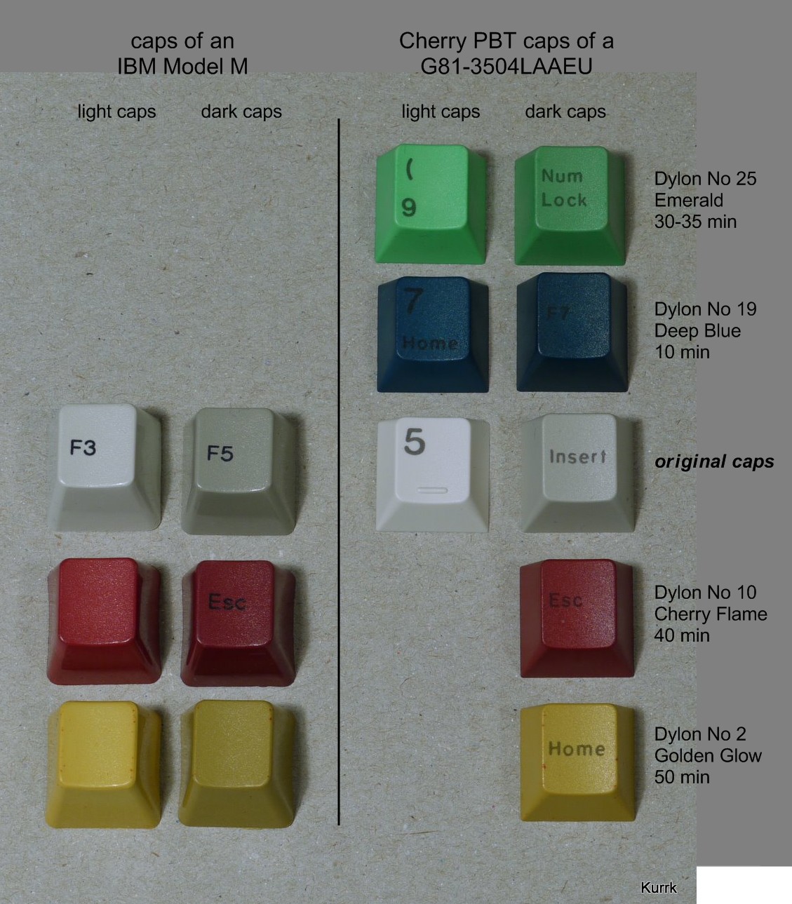

Results:

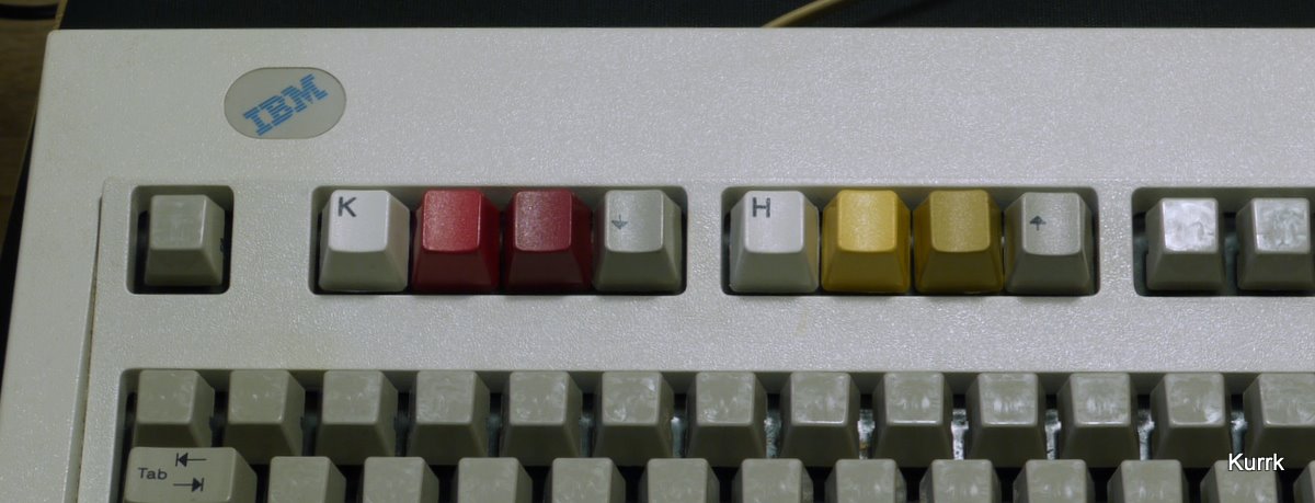

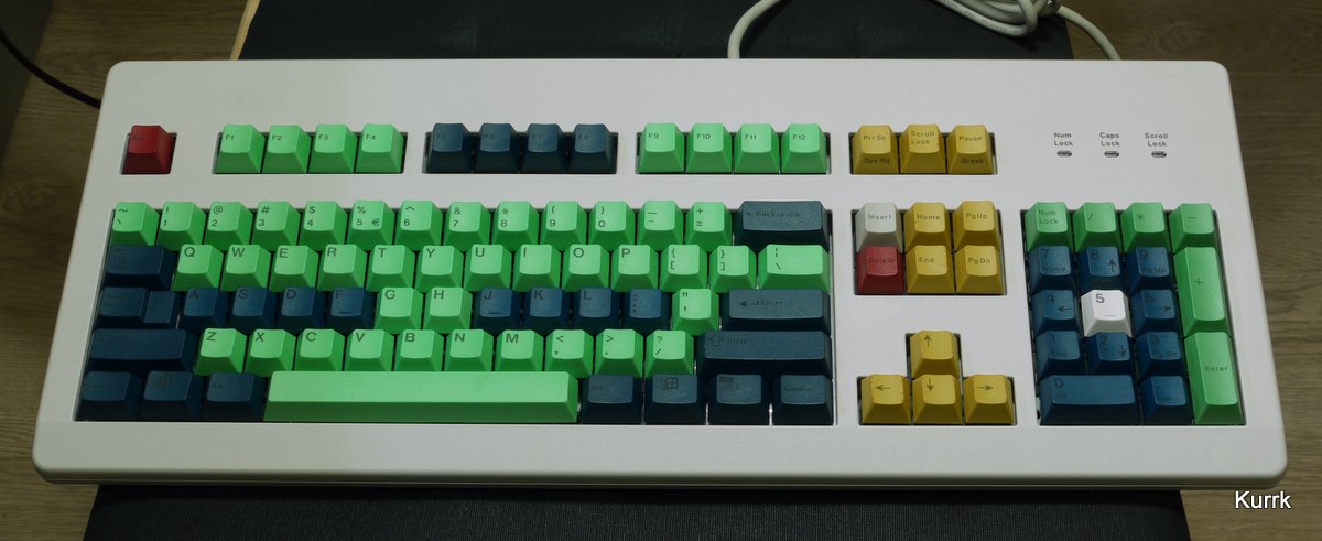

Look at all these funky colors on top of some squishy MY switches! and those 4 model M caps! I'm rather pleased in general, only the failed yellows are a pity.
The new looks of the Cherry board. The insert and Num5 keys were left untouched.
The Model M caps after dying.
Here's the most important picture, a key matrix ;)
An overview of the various caps before and after dying.

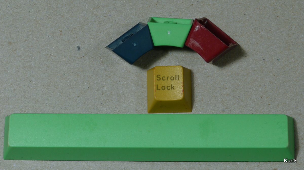

Some problem zones: The dye is rather sensitive for irregularities in the plastic. The injection points of the caps take up the dye worse than other parts. One of the IBM caps has some smears of lighter color on it. I don't know if this is caused by the plastic structure or if this cap was a bit dirty.
The sides of the IBM caps were sligthly warped but they still fit very well on their stems. Only tighter than before.
The problem zones.
The problem zones.
Conclusions & recommendations:
*Dyeing PBT caps with Dylon universal / multi-purpose dye works.
*The color doesn't rub off. No blue fingers so far.
*The Cherry caps keep their shape while the IBM M caps are slightly bent inwards. Don't be alarmed, they still fit on their stems very well.
*Some dyes obviously are absorbed better than others.
*Clean and degrease your pan! And your caps!!
*Dissolve the dye completely before adding the caps.
*Aluminium pans are generally a bad choice as this metal corrodes in acid or basic aqueous solutions.
*Quite some dye stuck to my pan due to its rough surface which made cleaning very difficult. I suggest using a smooth stainless steel pan or even better an enamel pan or a large glass beaker.
*I'm still not sure if the salt is necessary for dyeing key caps but it won't hurt to add it. BTW, it is absolutely necessary when dyeing textiles.

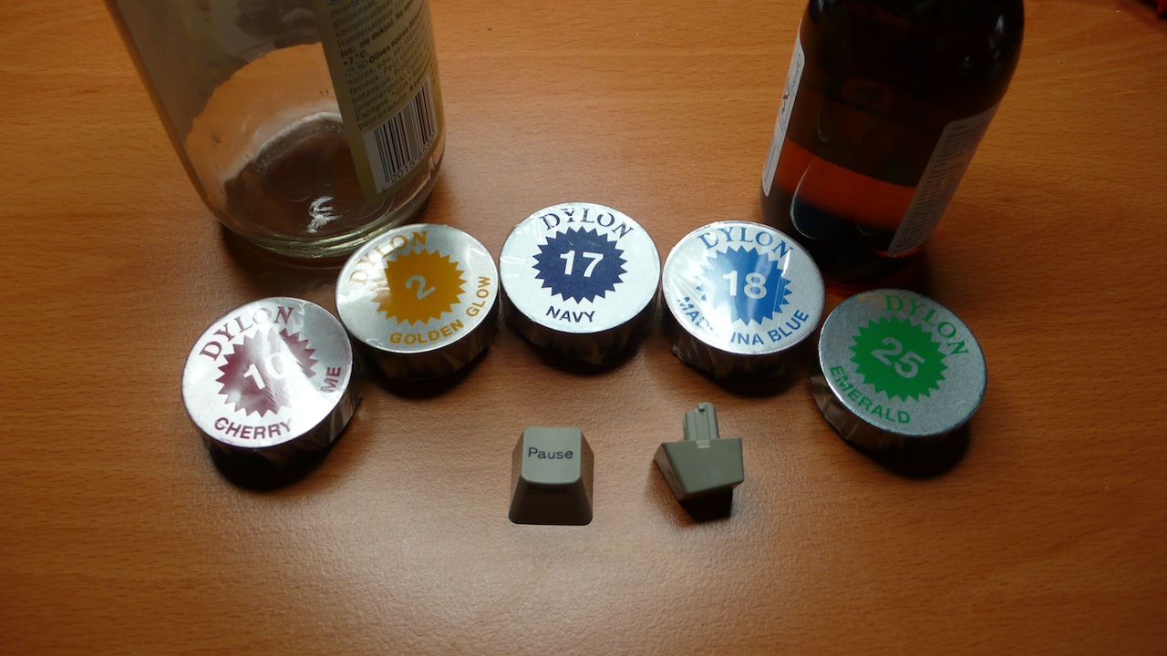

Well,
I just established you can't just throw PBT caps inside room temperature dyed water plus some acetone and wait for something to happen. It won't.
Now adding another variable : temperature. Wonder what that will do in my setup. ( Although my wife started to look confused when I said I was going to 'boil some caps' )
After that : salt.
Regards.
