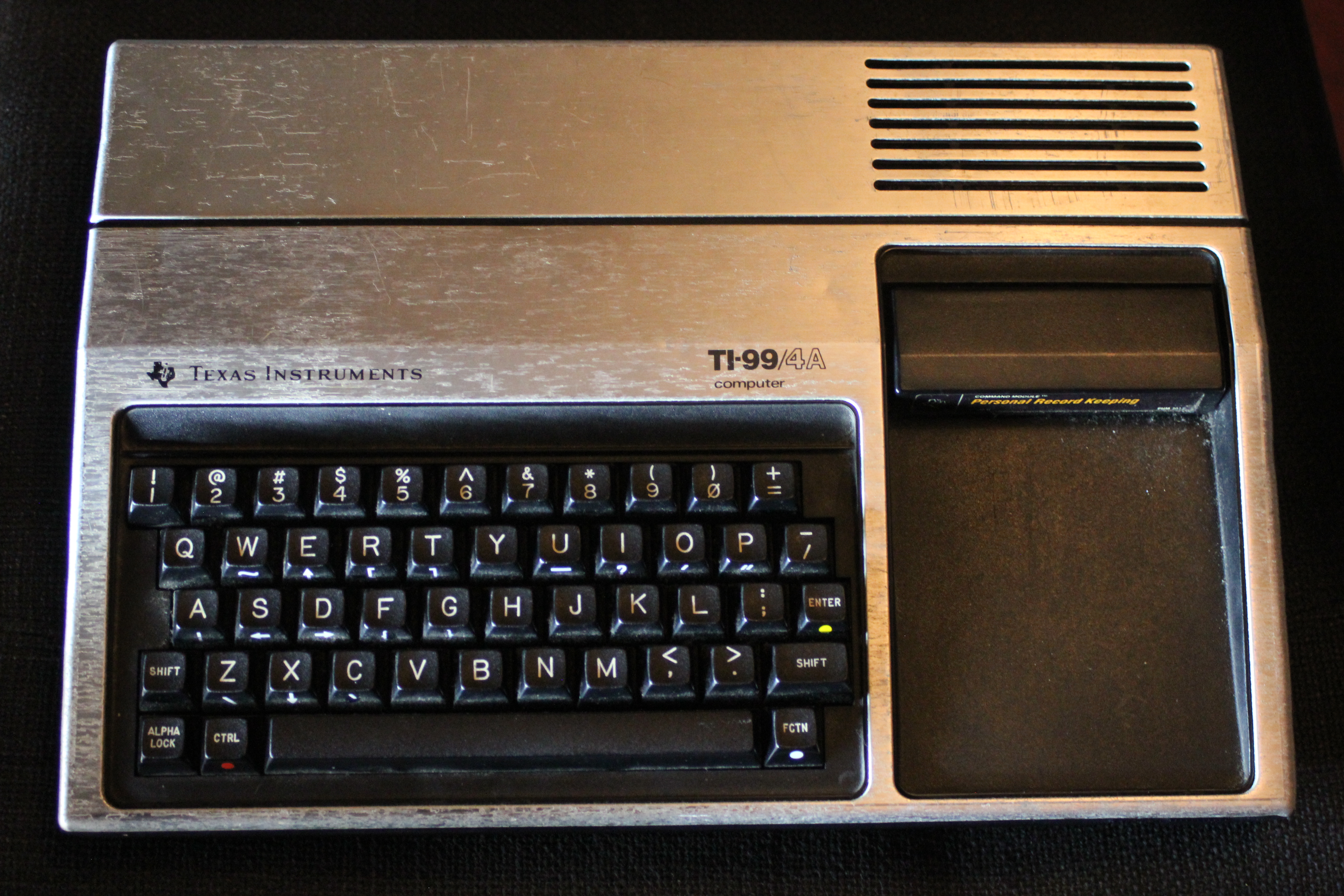

So, I've got this TI-99/4A:

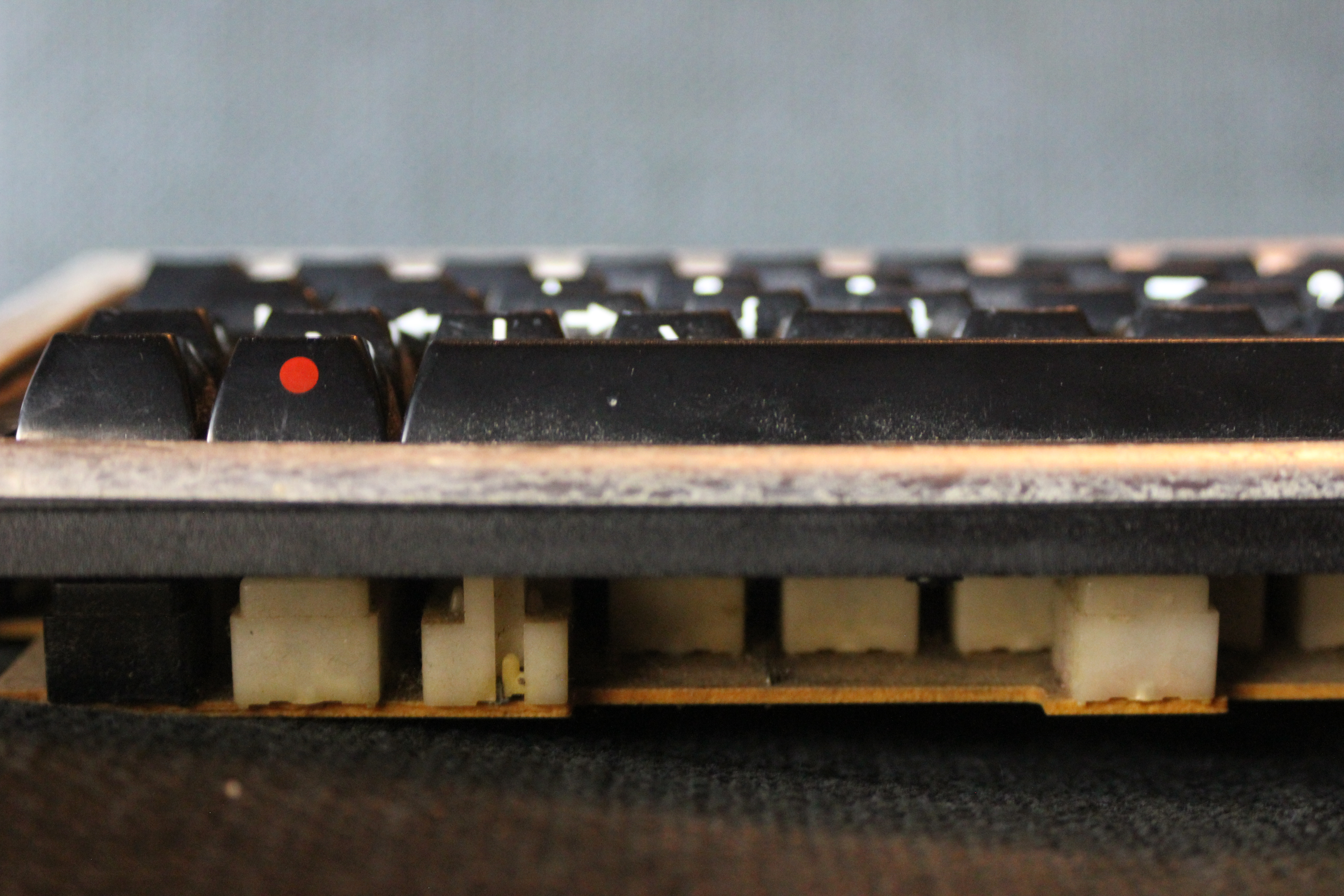

When I read that it can come with several different switches, I was curious which one mine had. I could see looking through the vents that it wasn't the Stackpole grid type, so I decided to open it up a bit to take a better look. (Sorry, this isn't a complete disassembly, that looked like it would be a serious job.).

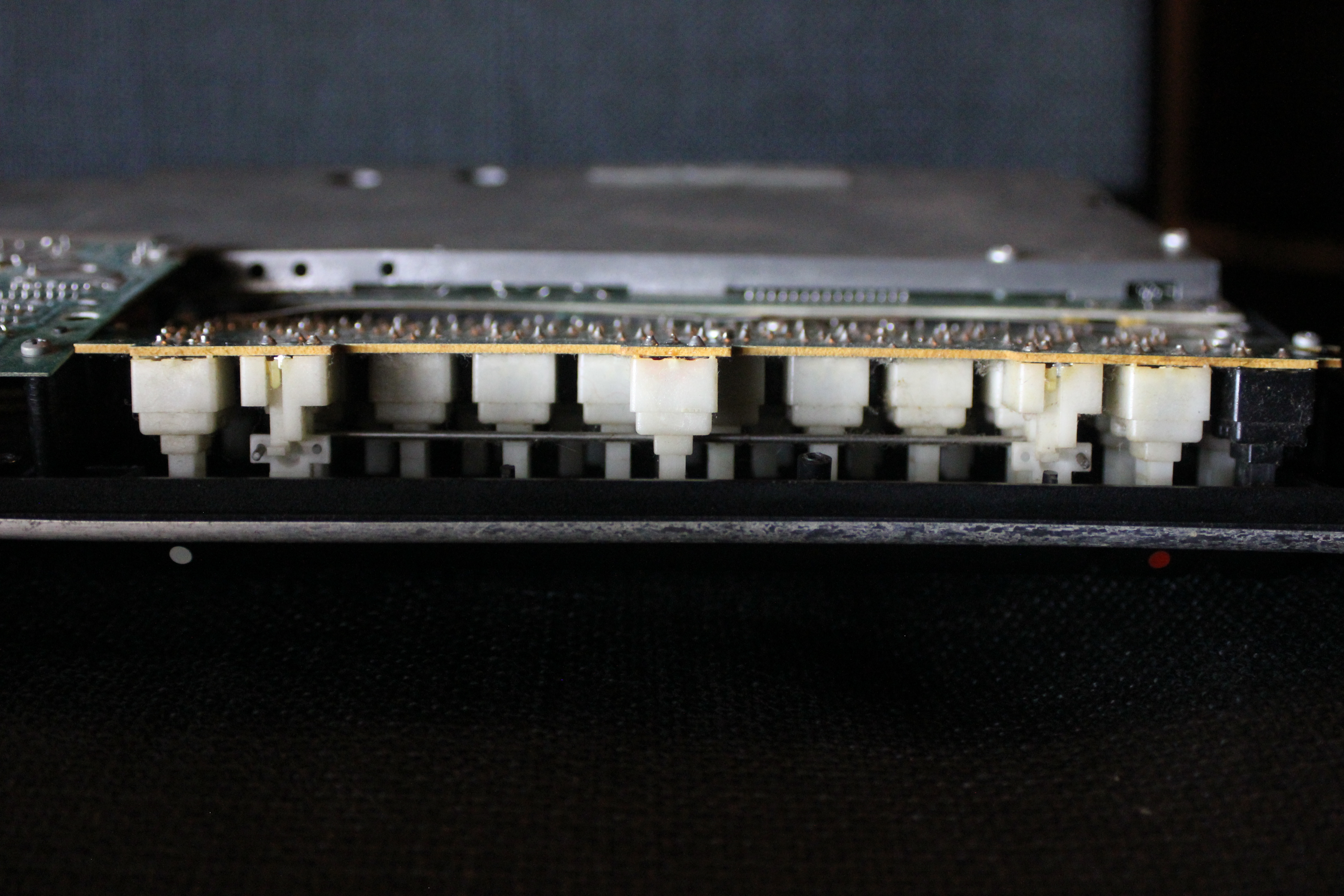

Now here's the interesting part. This one, as it turns out, uses Futaba sealed linear switches, which seem to have very little coverage here or anywhere else online.
The wiki only specifies that the 4A can come with Futaba MD, these switches' big brother. Looking at the references, I notice neither actually shows the bottom housing of the switches, so maybe that caused confusion? (Edit: Nope, the one on the Nightfall Crew site definitely has MD.)

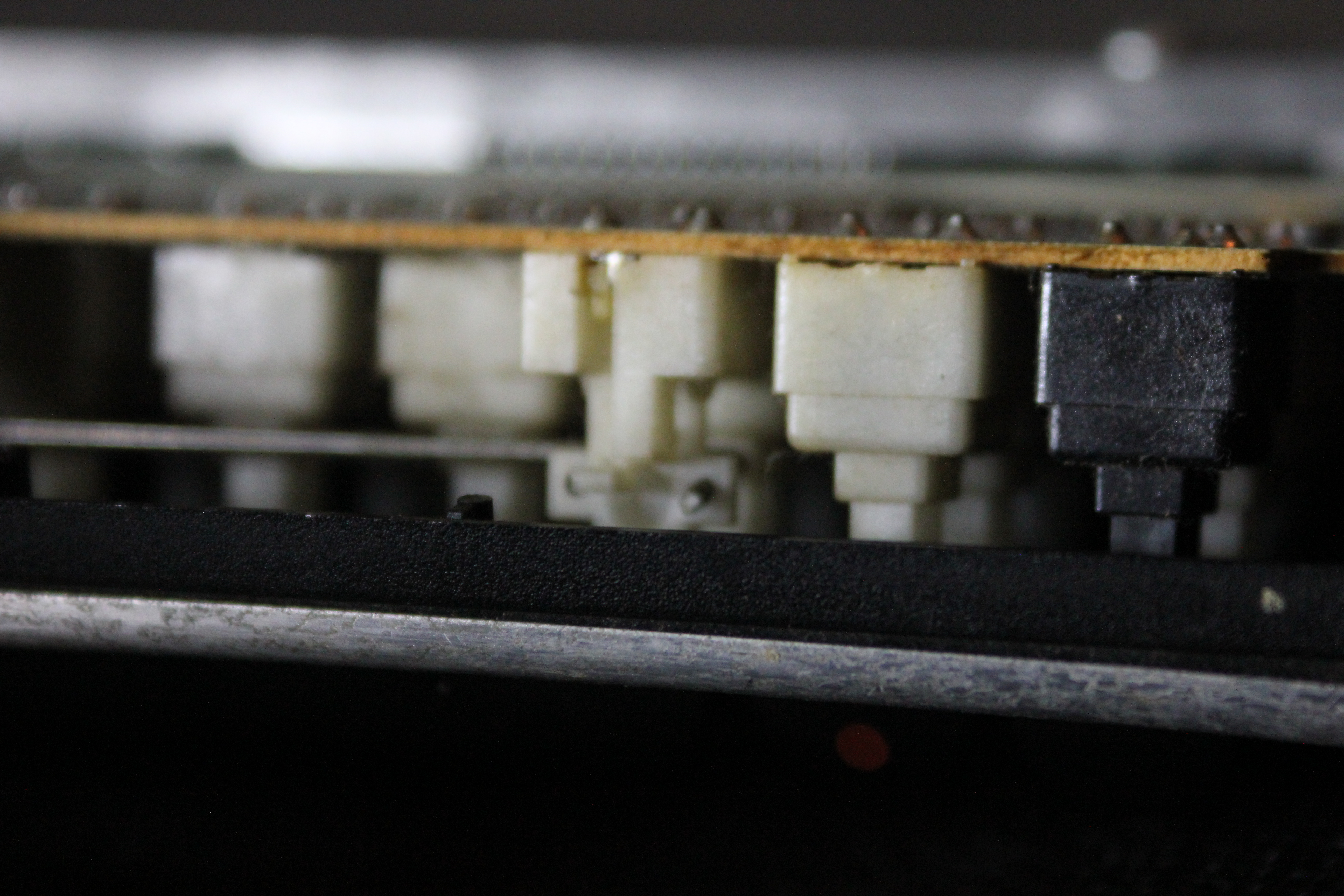

Anyway, time for a couple more pics, here's the latching Alpha Lock switch next to a normal one. It's black instead of the usual milky white.

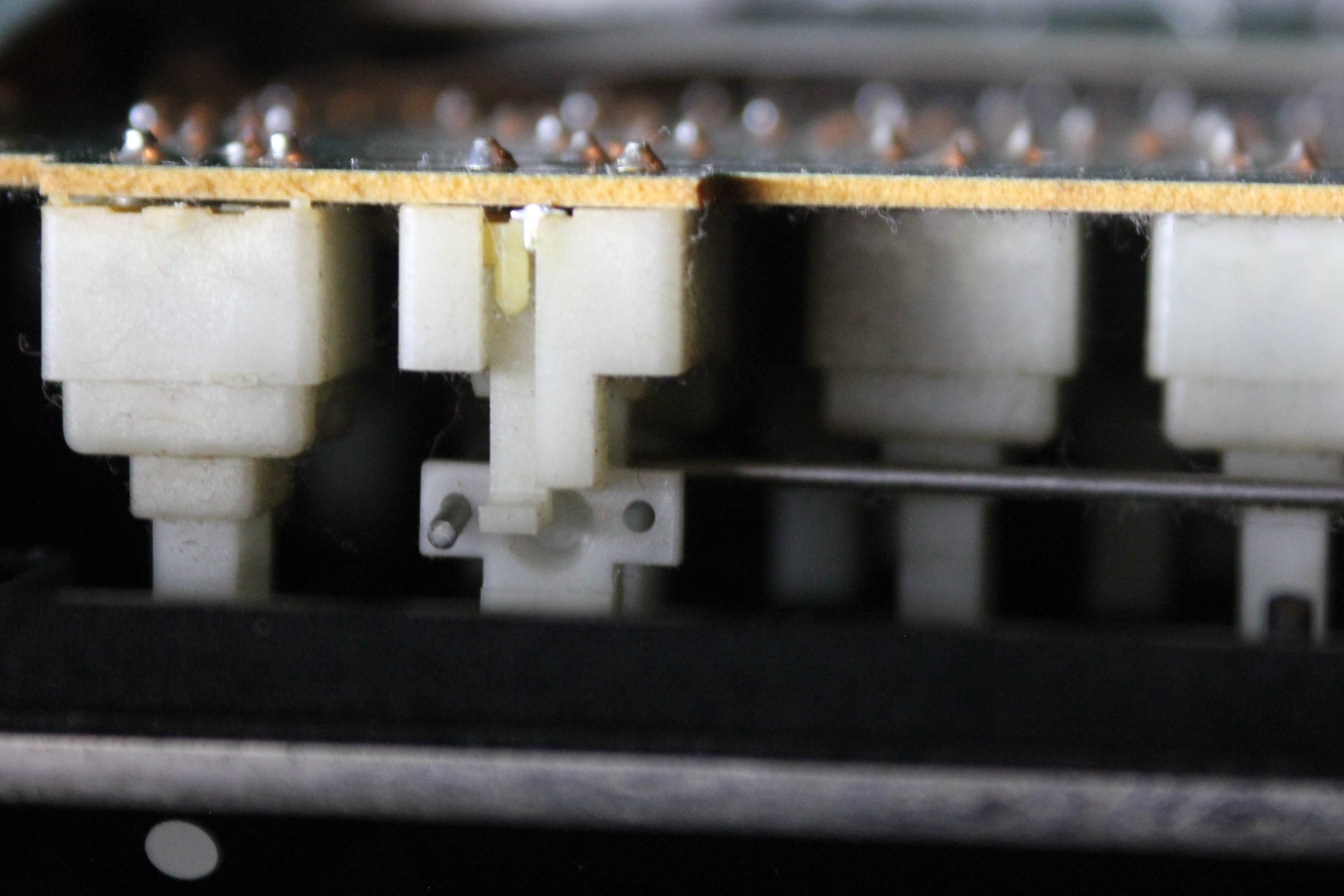

As you can see in the first picture of the switches, the spacebar is stabilised with a wire that hooks into two dummy switch housings at either end. Here's one of those.

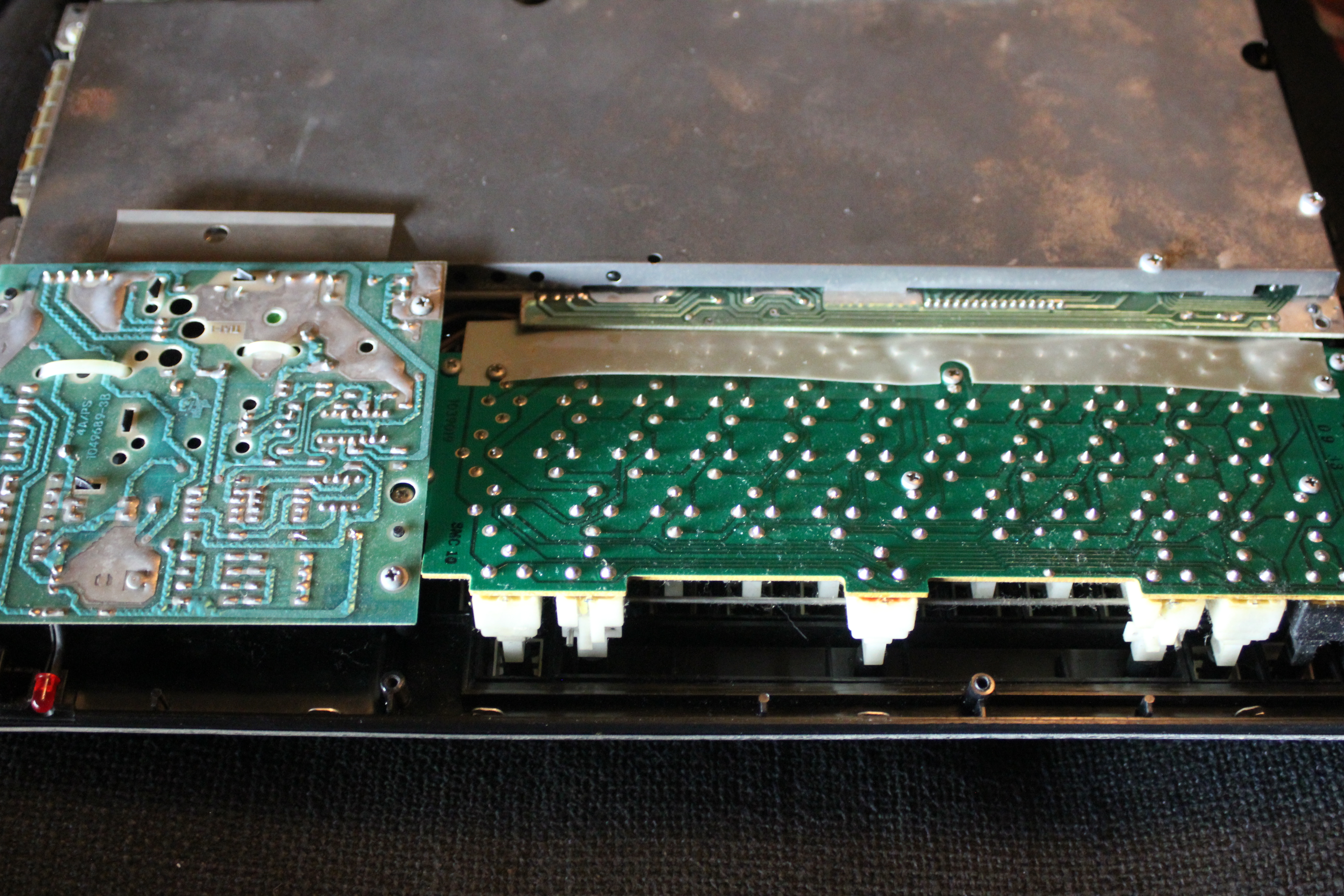

And here's the underside of the PCB. Notice that it's a slightly different design from the other Futaba TIs in the wiki sources. It lacks the Texas Instruments, Futaba and Sejin Electron logos.
An upright picture for good measure:
