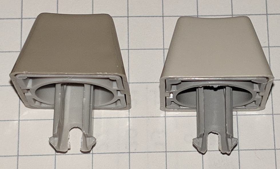

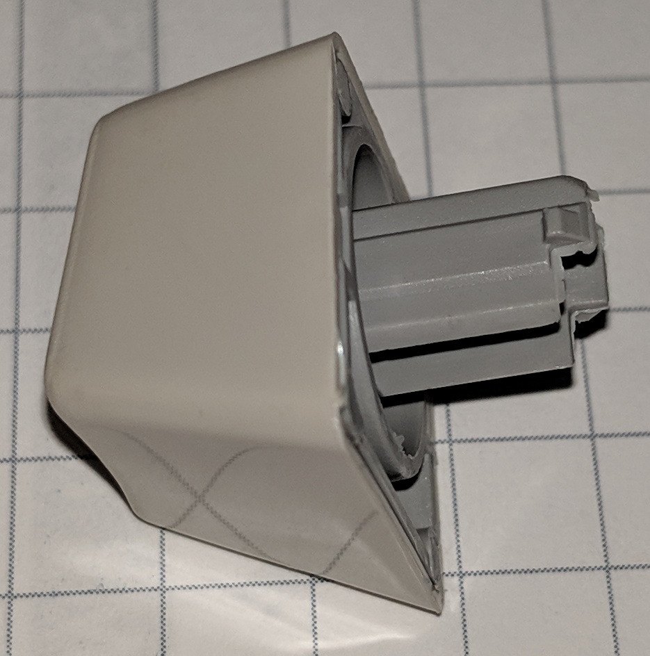

I checked my stash of extra Unicomp caps and it turns out a few still had the molding defects I have in mind (flashing). Some "witness marks" where the mold separates are completely normal and you'll see them on correct stems, this isn't:
In the notch
In the notch

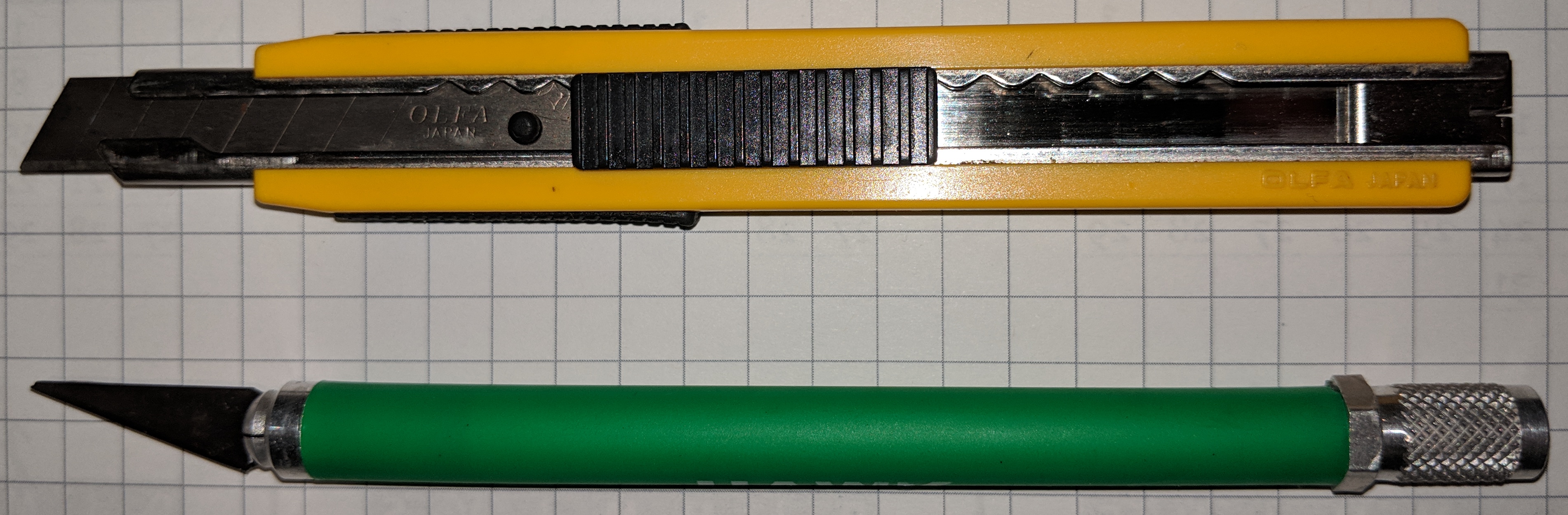

So the fix is simply to use one of these:
Caution: sharp!
Caution: sharp!
2019-01-21 01.37.00.jpg (1.41 MiB) Viewed 2607 times

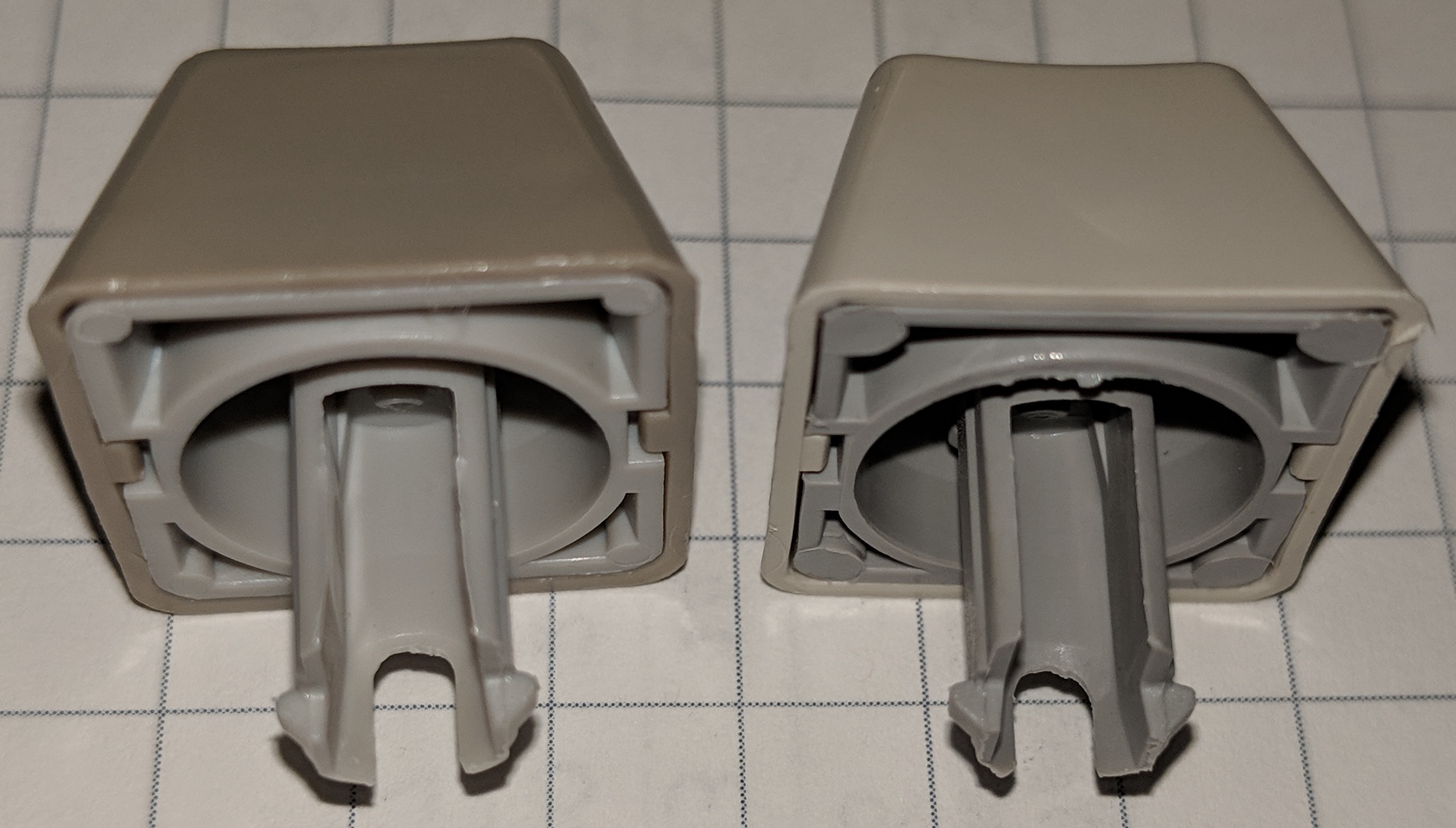

To carefully remove the excess material and end up with something like this:
All better now
All better now
2019-01-21 01.42.12.jpg (548.96 KiB) Viewed 2607 times
Give this a look and let us know.
