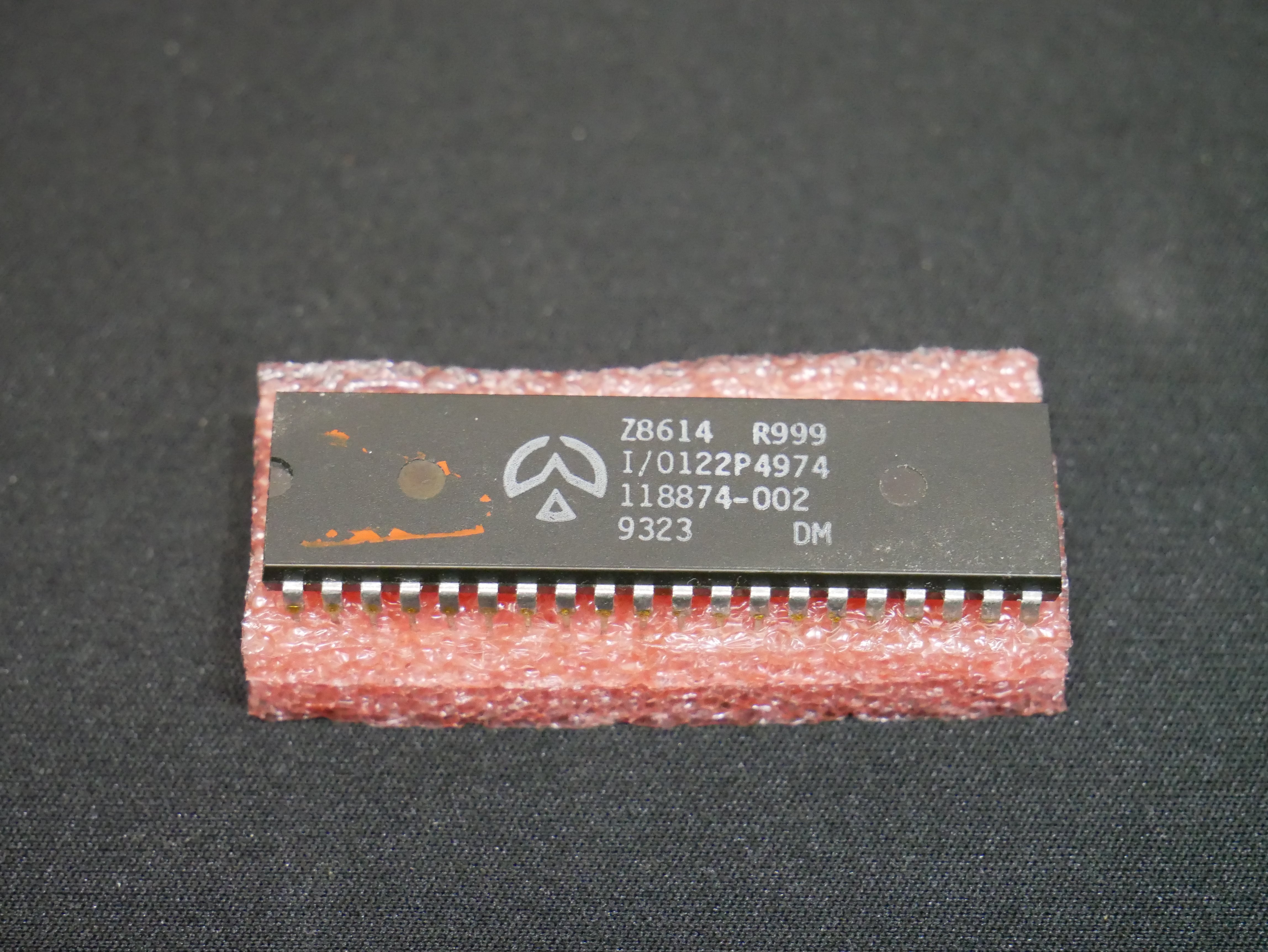

Original Zilog Controller in board

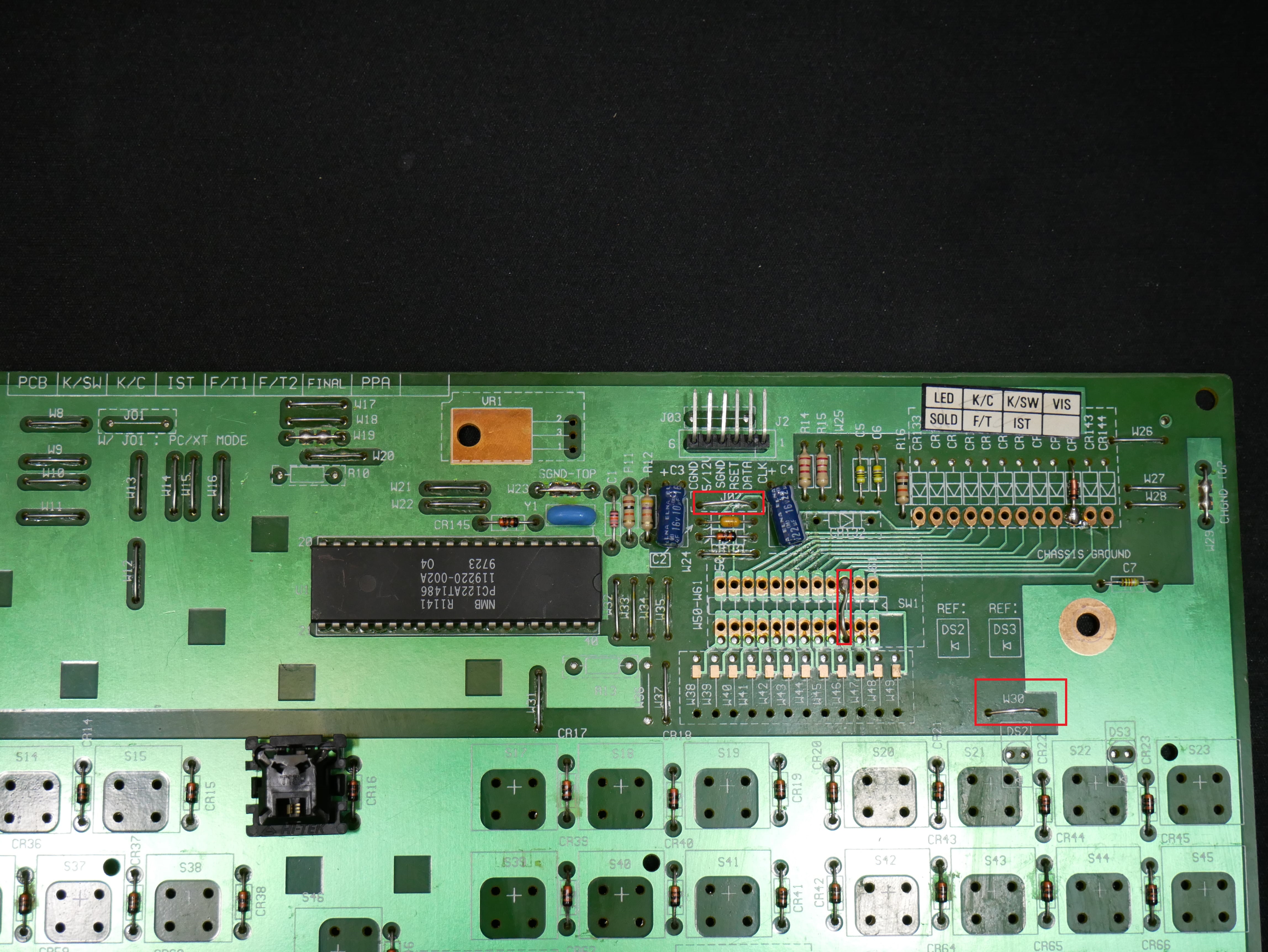

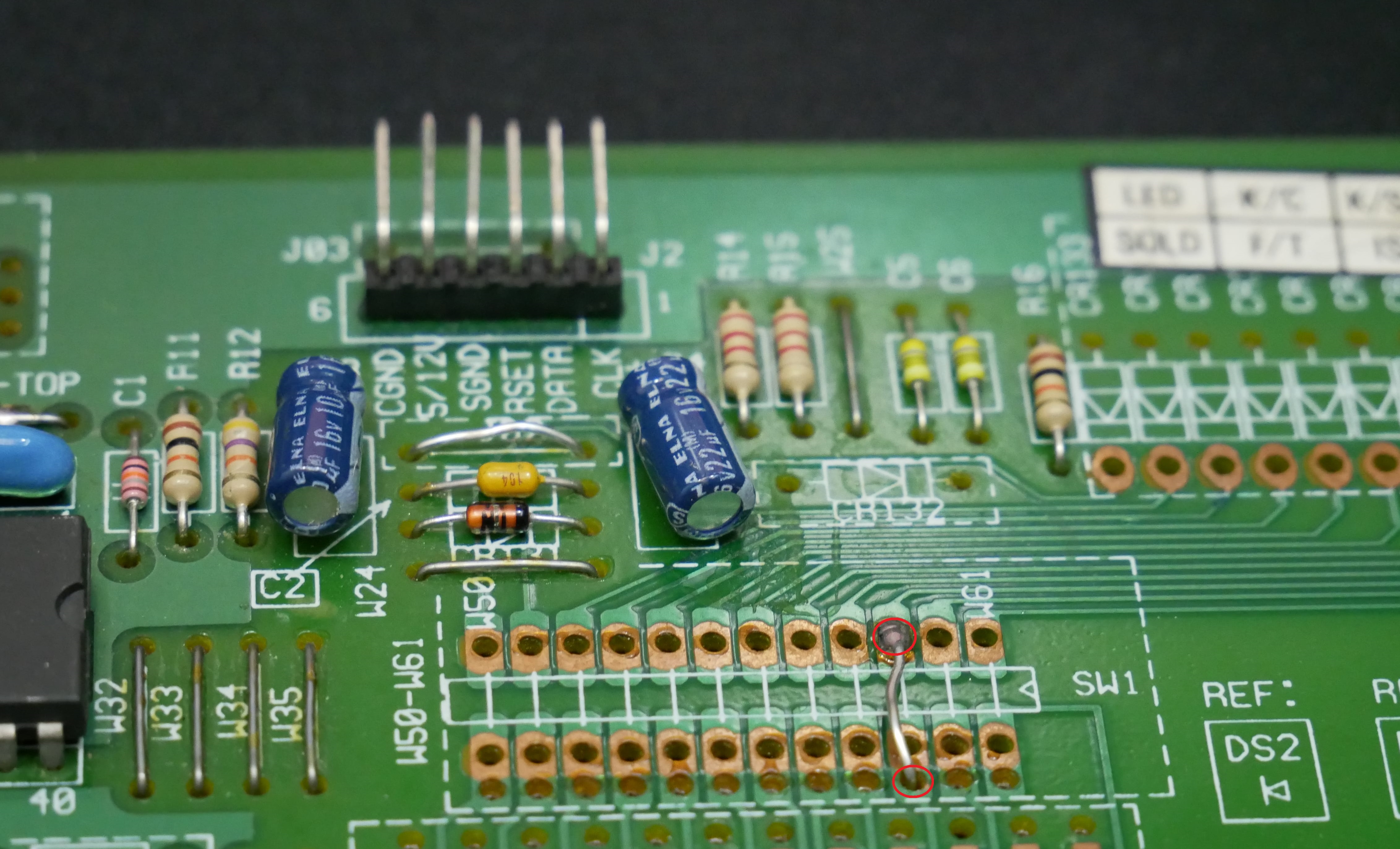

I studied the PS2 NMB PC122 board for a good amount of time before attempting the swap. I had to make sure that all of the jumpers that the PS2 PCB had were copied over to the old XT PCB.
Here is all of the jumpers that needed to be added:
Jumpers Needed
Jumpers Needed
Jumper Install Holes

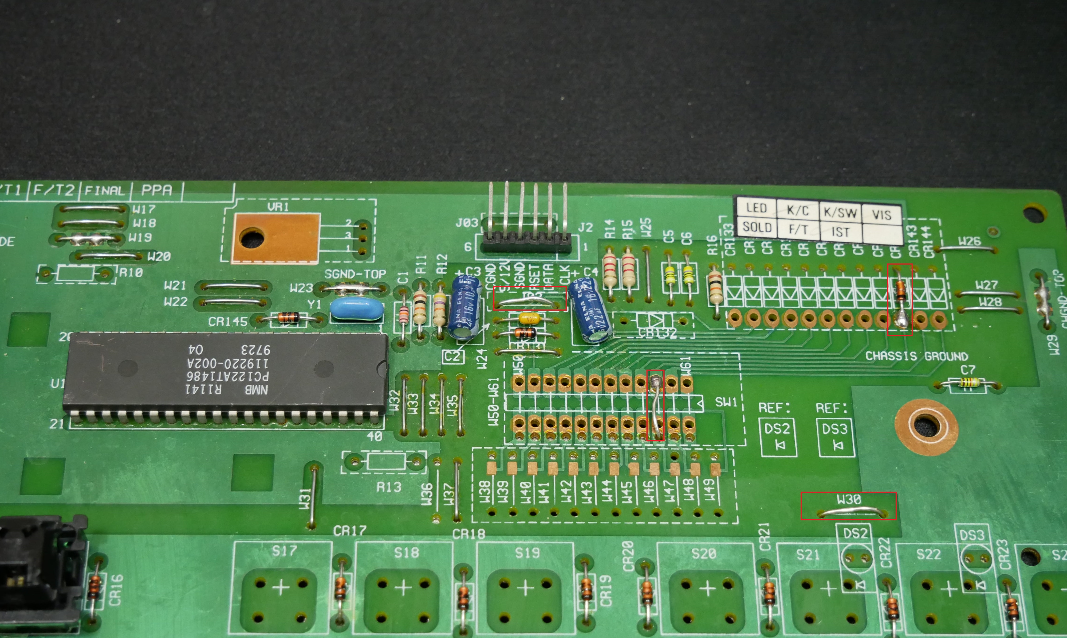

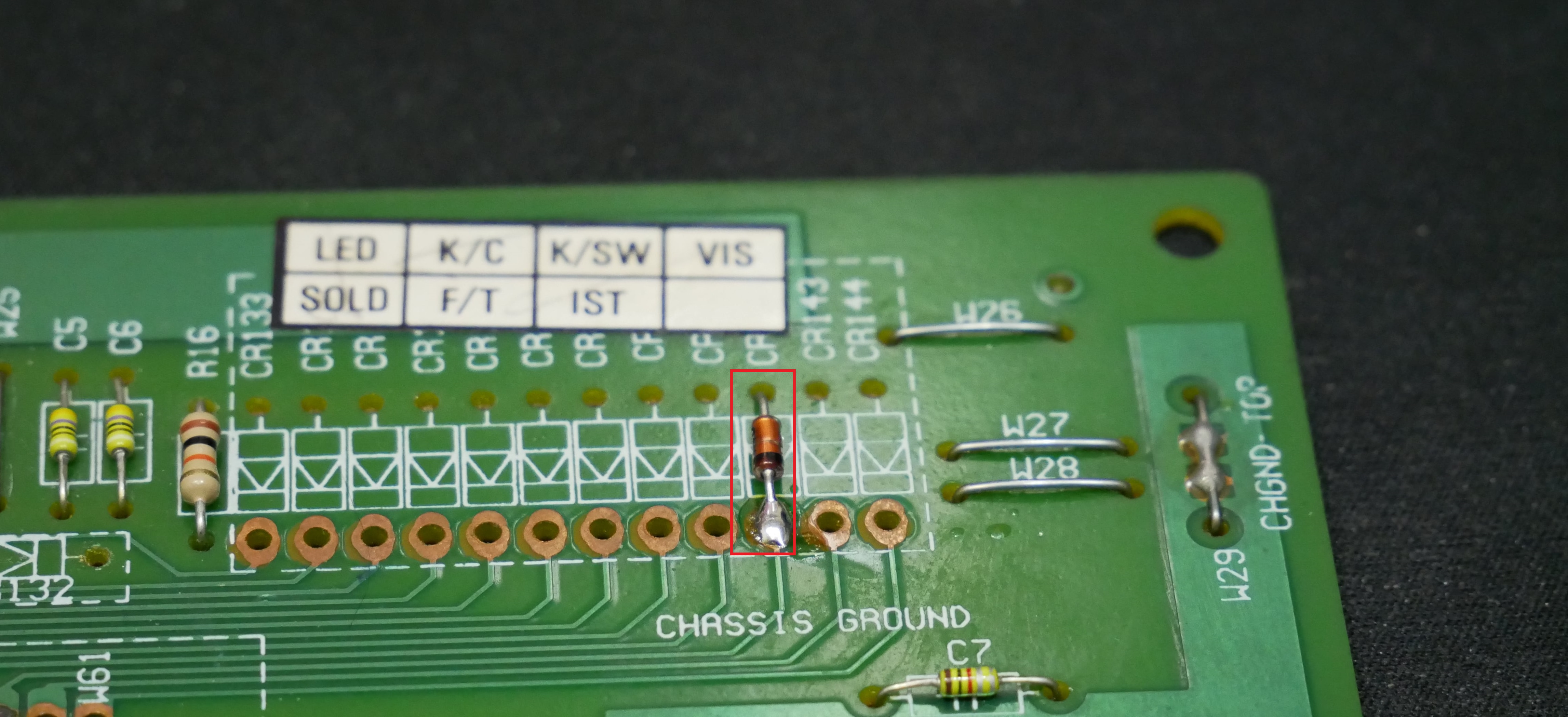

Afterwards came the installation of the diode and the main controller.
Jumpers Needed
Jumpers Needed
Diode
Diode

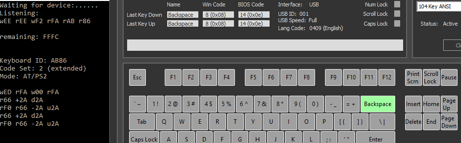

In order to test the swap I plugged the newly converted XT now AT board in with the other's cable into a Soarer's converter. Well who would have guess it showed up as AT/ps2.
Now that's a good sign and then wanted to do the ultimate test which is soldering a switch in the board and seeing if that works.
Working PC122
Working PC122
Working NMB PC122.png (26.92 KiB) Viewed 4183 times
Well looks like another success!
