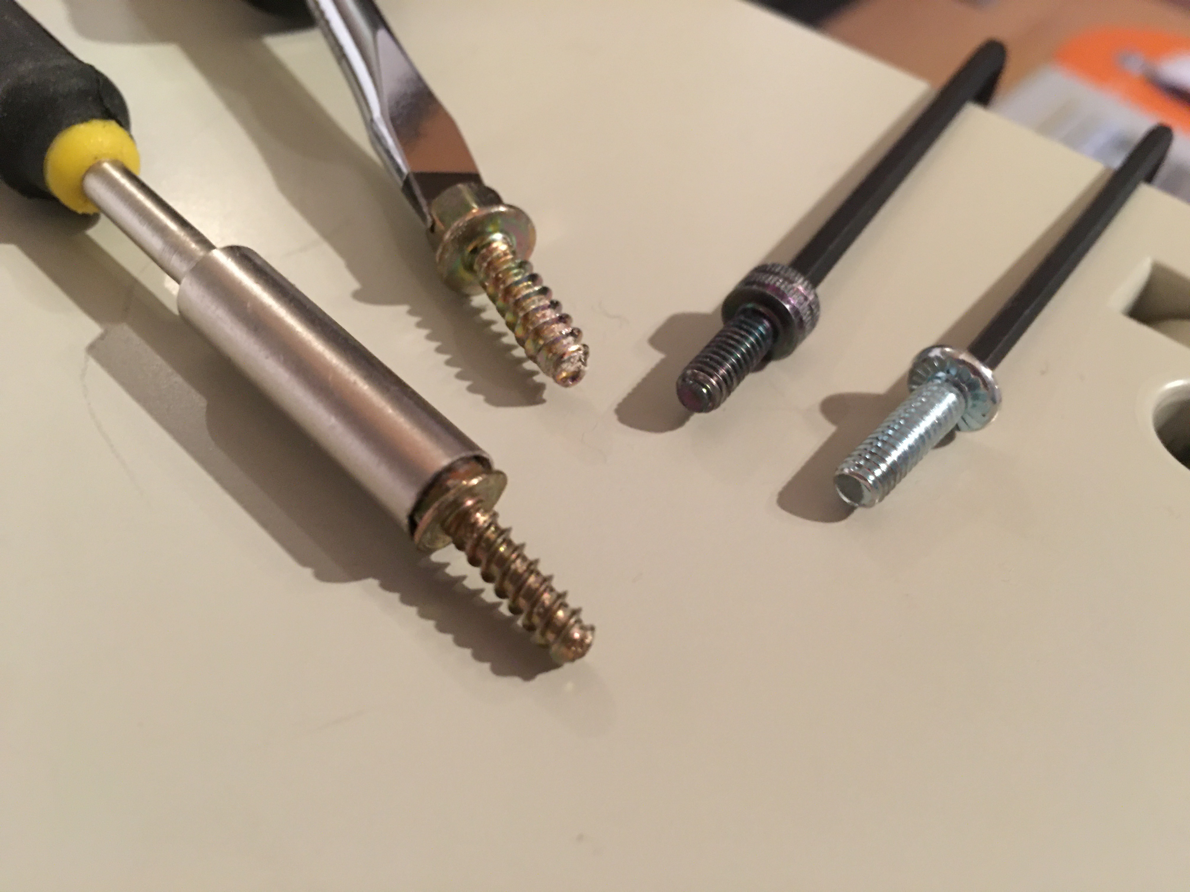

All right folks, Mu to the rescue!
IBM case bolts.jpg (1.28 MiB) Viewed 4534 times
Foreground: Model M SSK — gold coloured, recessed 5.5 mm hex headed bolt
Back left: XT — gold coloured, flush mounted large hex headed bot (>6 mm?) with handy flat screw cut
Middle back: Kishsaver — black, flush mounted circular headed 3 mm hex bolt
Right back: AT — silver, recessed, dome headed 2.5 mm hex bolt (3/32 inch also works)
The AT's bolts are recessed at least 1 cm from the case's outer surface. Just a smidge less deep than the SSK's.
Edit: Wait!? IBM really mixed and matched with the bots! That's your AT, right? Those bolts need a hex spinner, like a Model M. My kit of hex spinners maxes out at 5.5 mm…
Re: IBM Model F AT Bolt/Nut size?
Posted: 07 Dec 2019, 17:01
by anmq91
Muirium wrote: 07 Dec 2019, 16:45 All right folks, Mu to the rescue!
Thanks for the specs Mu! Yeah that's my F AT, and I guess they were mixing and matching. These seem to be the original bolts as well. The 5.5mm Hex spinner for my IBM model M is too small for it. So I'm still not sure which size driver I should order :/ Also considering that whatever I order had to be online, each one ends up being 14-20 usd so I can't just order many of them and hope on one of them to work :/

Yeah, looks like you need something very similar to, but larger than, your Model M hex spinner. Ordering a kit would tempt me, but then I'd just be taking up space with tools I don't need. Ordering individual drivers and returning all those that aren't a match may be a smart choice.
The upside is those AT holes can only take bolts up to a certain size. My pic is shot on the back of my AT, so there's a bolt hole just at the edge of frame, at the right. Can't be too much larger than the 5.5 mm spinner, I think.
For what it's worth, my XT's bolts are a touch too big for my biggest hex spinner. Hard to measure with a ruler (I don't have calipers) but I'd guess they're 6 mm.
