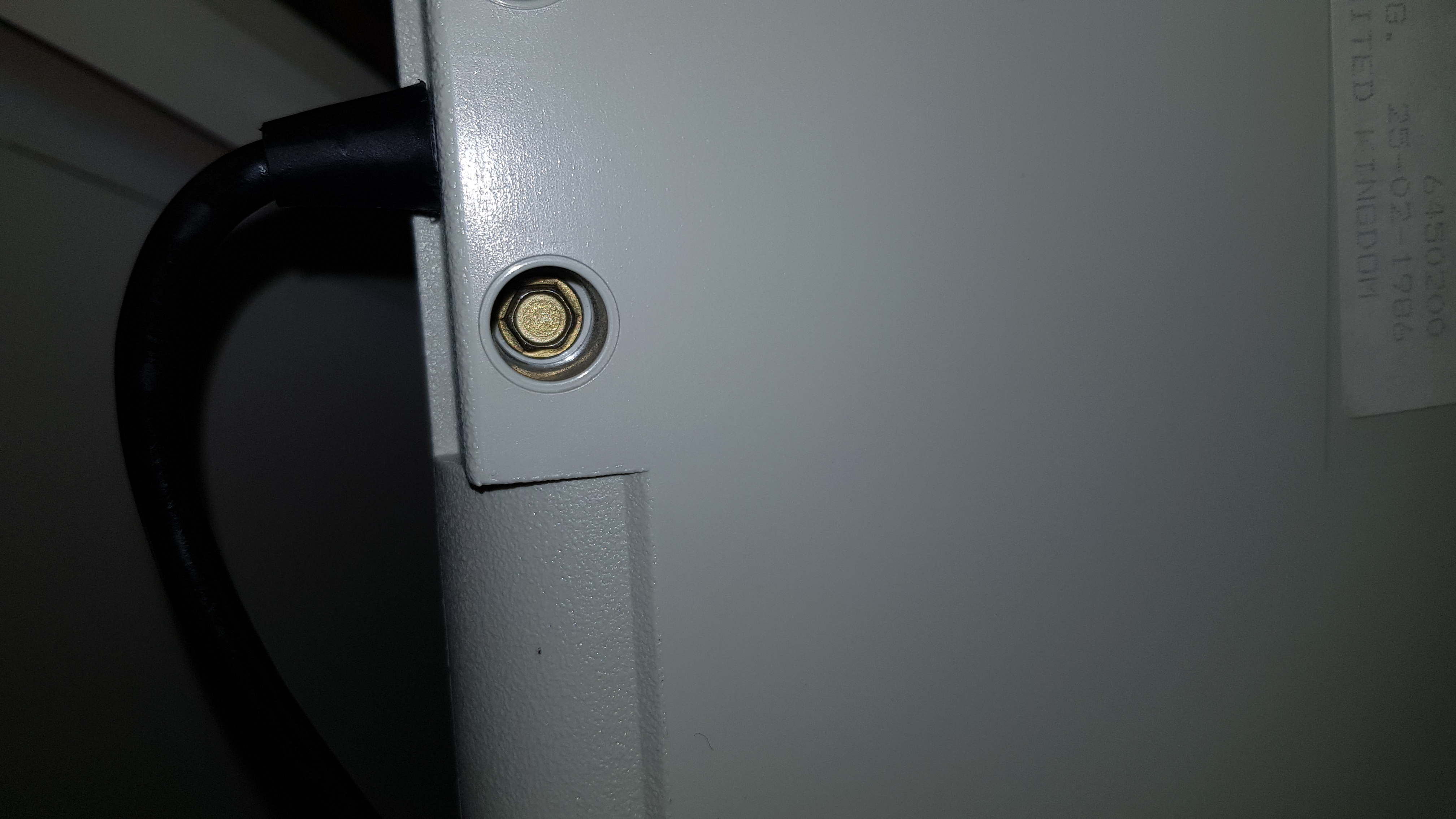

Hey guys,
My apologies if this thread has already been discussed, but my heavy-fisted google and DT searches yielded absolutely nothing. I've got an F AT that I am trying to open and cannot seem to find the correct driver size. I have the 5.5mm from my model M but that is too small. I read somewhere vaguely that it 'may' be 7.5mm (metric because I'm living in Germany). There seems to be not a single place where i can buy a 7.5mm driver (Can only find 7mm or 8mm) - let alone a slim fit one to fit into the recess. The closest I can find is purchasable online but it is 7.9mm and i do not know if it the head will fit in the recess.
Since many of you have done the AT restore/opening it up, would really appreciate it if someone could give me a correct size/sizes that would fit my AT screws. It's been days now that I've been trying to get it open and I have already spent north of 40 USD buying different drivers to no avail :(

What nut are you trying to remove? My F AT only has screws in them...
anmq91
07 Dec 2019, 16:13
Was trying to avoid lugging the board to the shop. Also, the shops here don't have much selection in this stuff. Most of this stuff has to be ordered online. @kmnov, my F AT has bolts like the Model M ones in the back, just bigger. I am not sure of the size in inches though, and cannot seem to find a 6.5mm bit.

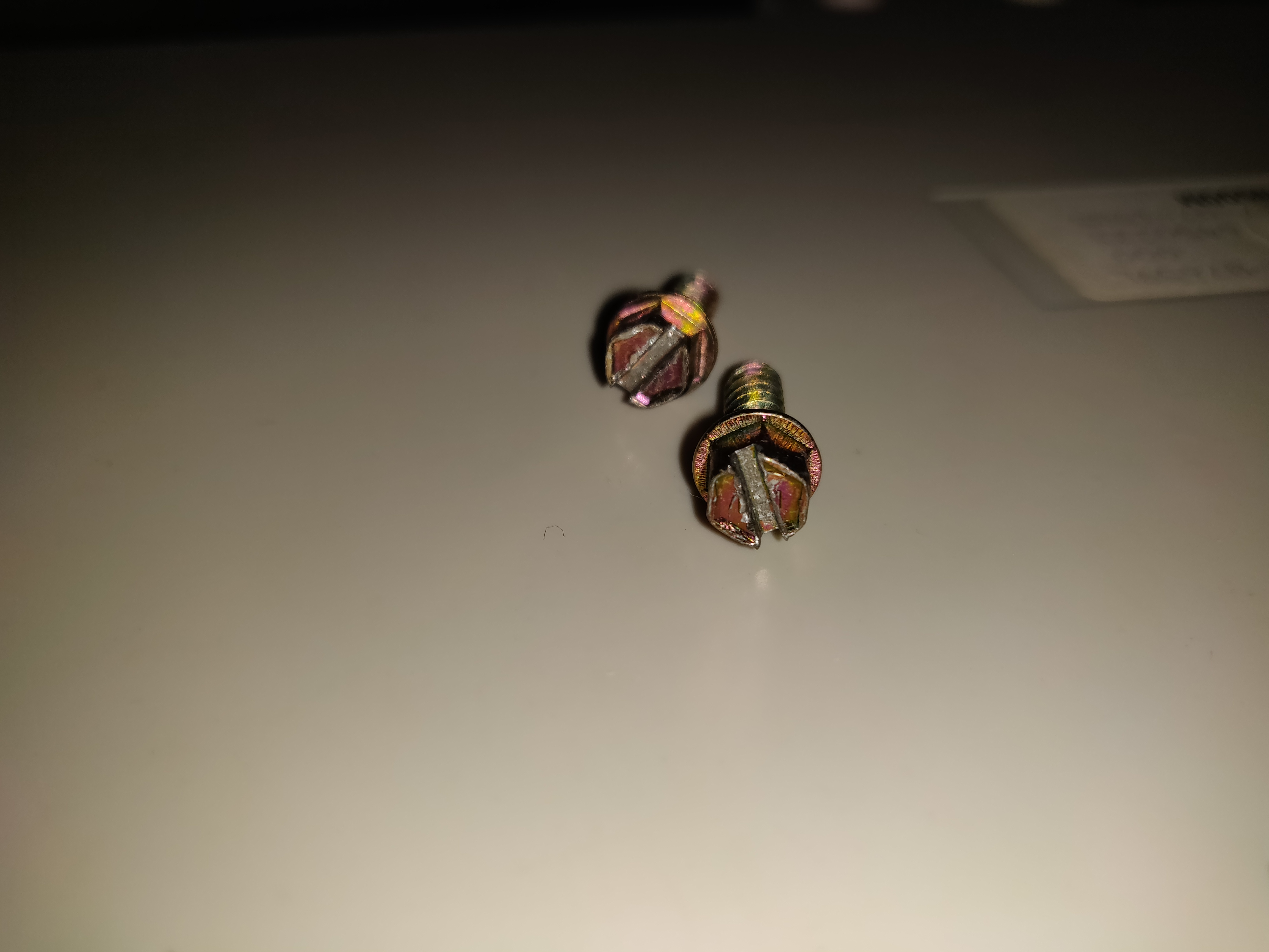

kmnov2017
07 Dec 2019, 16:16
Have a look at the pic I posted. Thats how my AT shipped with.
anmq91
07 Dec 2019, 16:38
kmnov2017 wrote: 07 Dec 2019, 16:16 Have a look at the pic I posted. Thats how my AT shipped with.
Thats really lucky and odd, mine are standard bolts -

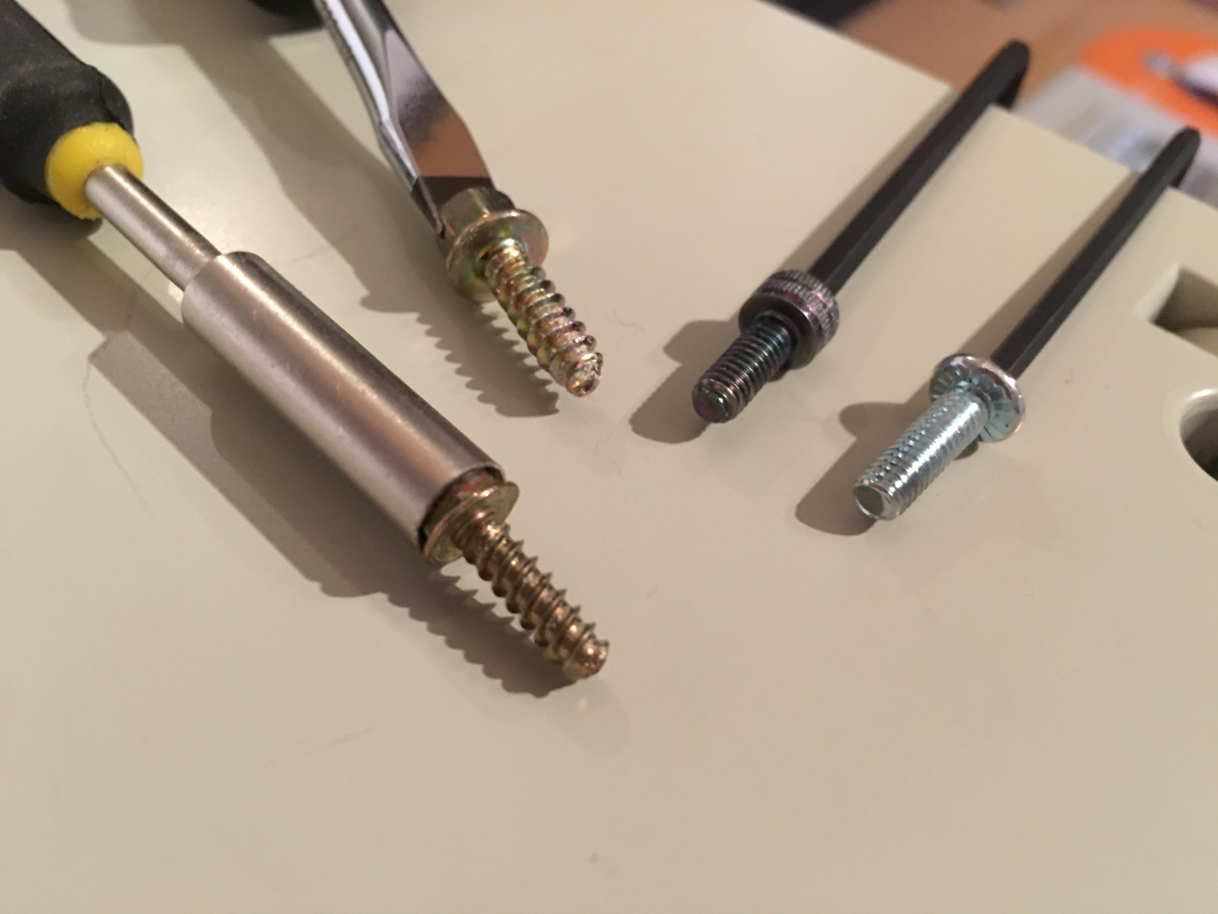

07 Dec 2019, 16:45
All right folks, Mu to the rescue!
IBM case bolts.jpg (1.28 MiB) Viewed 4519 times
Foreground: Model M SSK — gold coloured, recessed 5.5 mm hex headed bolt
Back left: XT — gold coloured, flush mounted large hex headed bot (>6 mm?) with handy flat screw cut
Middle back: Kishsaver — black, flush mounted circular headed 3 mm hex bolt
Right back: AT — silver, recessed, dome headed 2.5 mm hex bolt (3/32 inch also works)
The AT's bolts are recessed at least 1 cm from the case's outer surface. Just a smidge less deep than the SSK's.
Edit: Wait!? IBM really mixed and matched with the bots! That's your AT, right? Those bolts need a hex spinner, like a Model M. My kit of hex spinners maxes out at 5.5 mm…

Thanks for the specs Mu! Yeah that's my F AT, and I guess they were mixing and matching. These seem to be the original bolts as well. The 5.5mm Hex spinner for my IBM model M is too small for it. So I'm still not sure which size driver I should order :/ Also considering that whatever I order had to be online, each one ends up being 14-20 usd so I can't just order many of them and hope on one of them to work :/
07 Dec 2019, 17:03
Yeah, looks like you need something very similar to, but larger than, your Model M hex spinner. Ordering a kit would tempt me, but then I'd just be taking up space with tools I don't need. Ordering individual drivers and returning all those that aren't a match may be a smart choice.
The upside is those AT holes can only take bolts up to a certain size. My pic is shot on the back of my AT, so there's a bolt hole just at the edge of frame, at the right. Can't be too much larger than the 5.5 mm spinner, I think.
For what it's worth, my XT's bolts are a touch too big for my biggest hex spinner. Hard to measure with a ruler (I don't have calipers) but I'd guess they're 6 mm.
