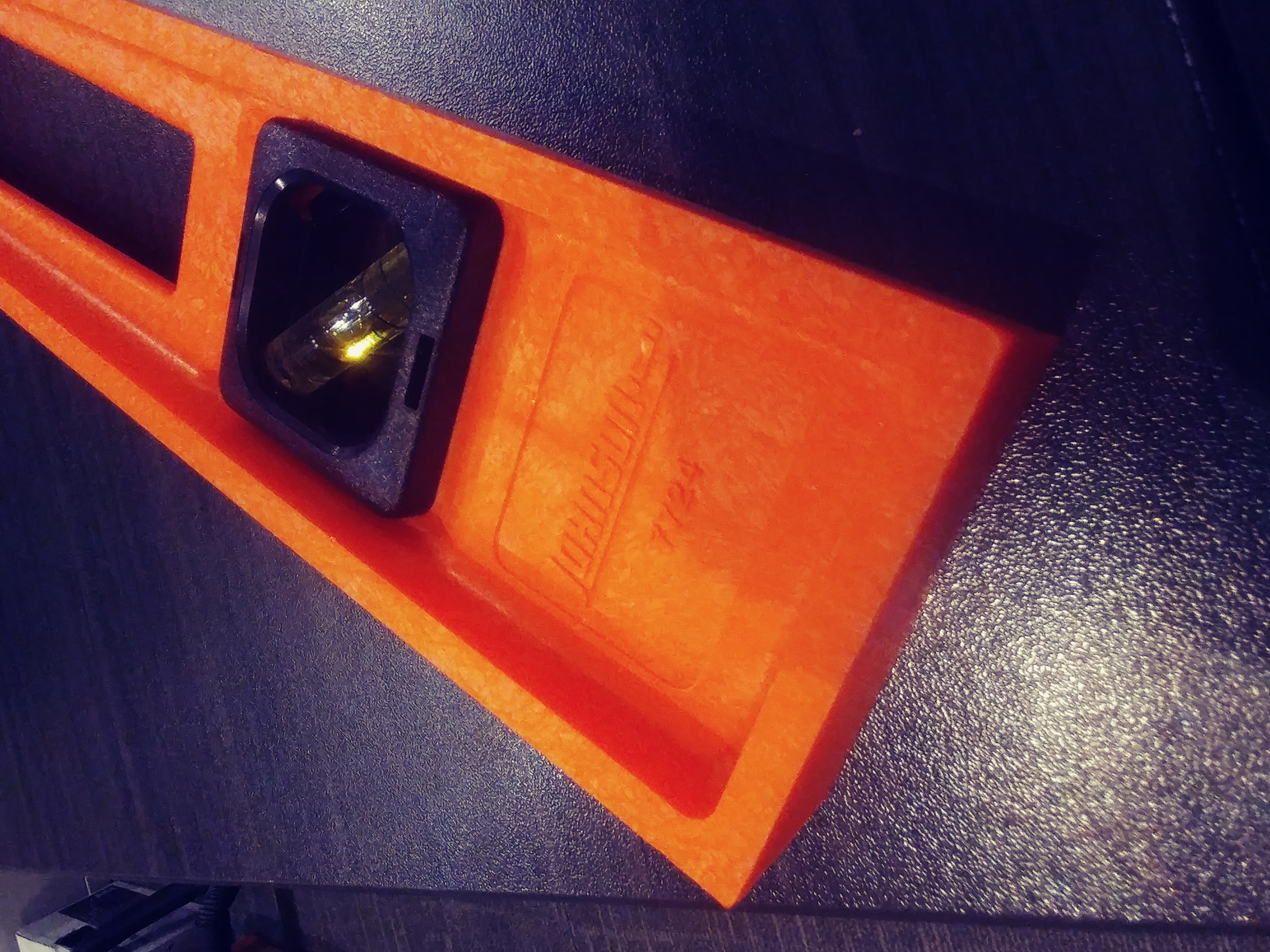

Hi, The wood finish plastic reminds me of injection-molded structural-foam plastic. This method makes a strong-lightweight plastic part for little material very inexpensively. The molds can be pre-painted or textured to apply numerous surface textures to parts. You can easily give the part a very strange almost woodgrain like finish. It is used on things like Spirit-levels where you do not want to scratch surfaces like on fine cabinets. As well obviously for large structural plastic parts
Using this level today reminded me of this post as it has a similar surface appearance.
This is the level http://www.johnsonlevel.com/P/1880/Stru ... orpedoLeve
spirit level.jpg (3.58 MiB) Viewed 7338 times

SneakyRobb wrote: 10 Jan 2020, 21:57 Hi, The wood finish plastic reminds me of injection-molded structural-foam plastic. This method makes a strong-lightweight plastic part for little material very inexpensively. The molds can be pre-painted or textured to apply numerous surface textures to parts. You can easily give the part a very strange almost woodgrain like finish. It is used on things like Spirit-levels where you do not want to scratch surfaces like on fine cabinets. As well obviously for large structural plastic parts
Thank you - I learned something today! I always thought that appearance indicated glass fiber reinforced plastic, but turns out that is something else (although it can also have a kind of 'fibrous' finish).
I remember brown colored structural foam used for a quasi-wood effect on some products from the 1970s and early 80s. I always thought it looked pretty awful in that context, but it's an interesting technique.

robo wrote: 28 Jan 2020, 19:03 Thank you - I learned something today! I always thought that appearance indicated glass fiber reinforced plastic, but turns out that is something else (although it can also have a kind of 'fibrous' finish).
Yeah right on. It is really a weird material to handle. It feels disturbingly light and something about the weight gives your brain a slight moment of confusion when it feels really hard but also light. Because it doesnt scratch wood finishes, its also somehow very soft, but hard. It is really strange.
