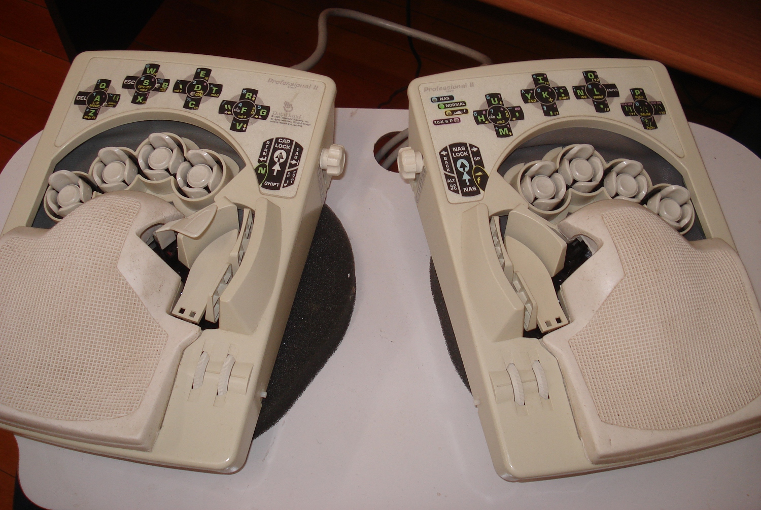

I am currently typing on this:
datahand
datahand
veeeerrrrrry slowly...

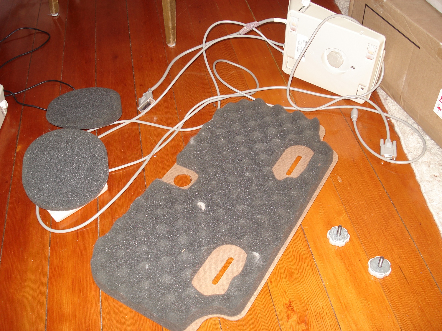

It's probably rude to make a picture thread and put only one picture in so here is a picture of the "leg mount kit". :)
It's just a piece of thin wood with some foam under it. Works very well and is easy to make, so if you want your own for a keyboard or laptop be inspired! :)
datahand leg mount kit
At the bottom right you see the bolts that are used to attach the unit to the plate, on the left two extra foam pieces that go on the top under the units to give them a little tilt and in the top right is the bottom of the right unit were you can see the hole for the screw. I know it's not terribly exciting but it's a Datahand and it's MINE. So pretty exciting for me. :D

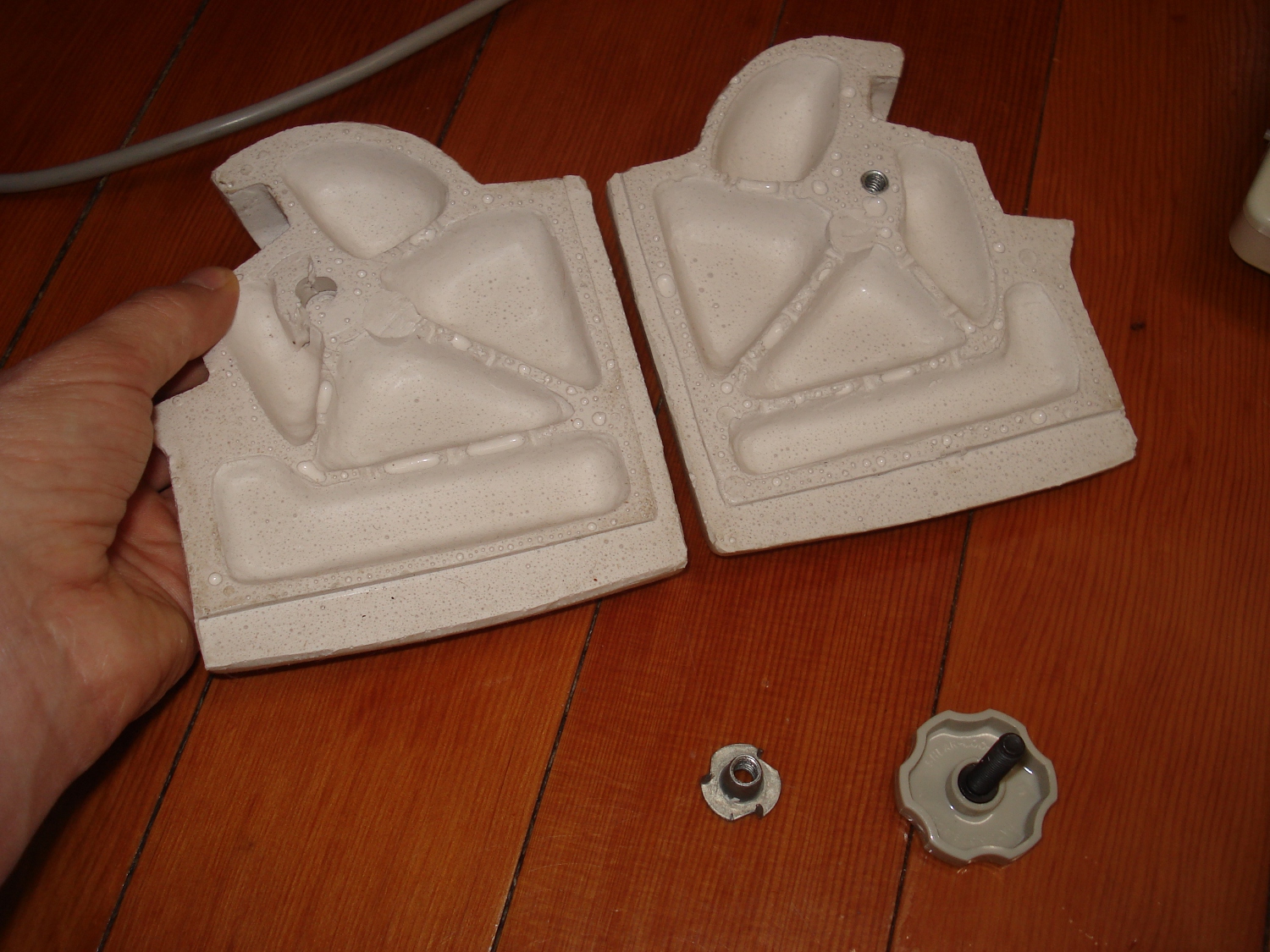

This is the under side of the hand rests.
hand pads
hand pads
As you can see the left hand one is broken. The metal piece that was inlayed is the piece at the bottom. It must have just ripped out. The material is very soft. To quote another thread "feels like dead octopus". The material is soft sticky plastic and pretty heavy though, so it's not a problem, even without the screws it doesn't really move at all.

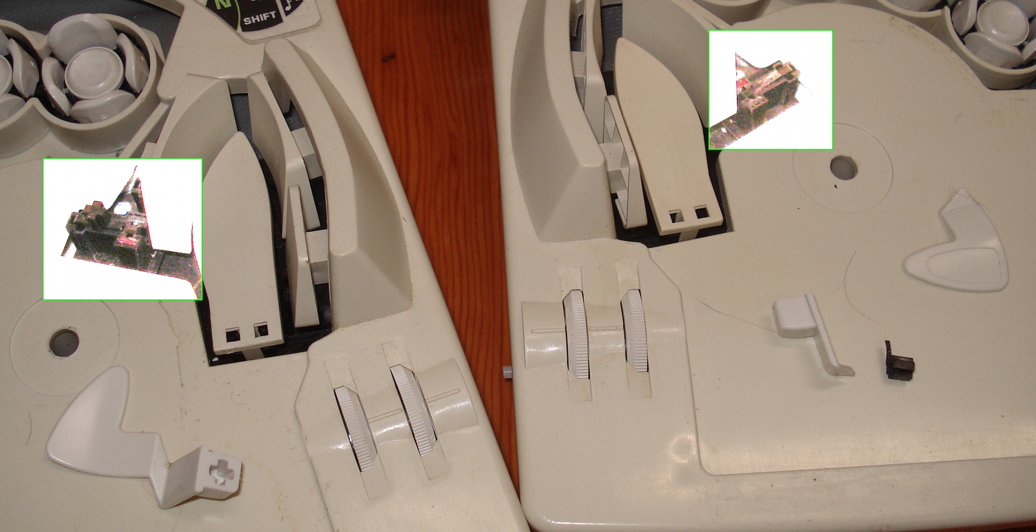

broken switch/key/lever/thingy
I've enhanced the image a little so you can see what the problem is. Looks like somebody accidentally leaned on it or something.
I'm fairly confident that either some fancy glue and a little added plastic or a replacement made from bent wire will be an easy fix. In this case it really works for me that the switches activate so easily because it means the parts have to withstand very little force.

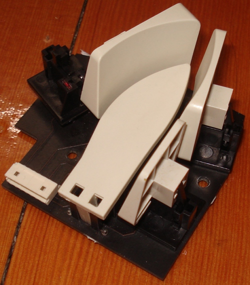

This is the thumb cluster.
thumb unit
thumb unit
Webwit, do you have any advice how to get the parts off for cleaning?
"Gentle force" alone doesn't seem to work. :?

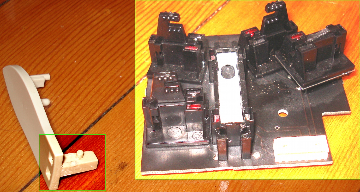

06 Apr 2012, 23:13
webwit wrote:I have some tips from Lynn for the other keycaps, but I think she told me not to mess with the thumb unit.
I wish I would grow up in the respect that I always have to try when somebody tells me I can't do something...
thumb unit disassembled
So as you can see I left some scratch marks but nothing that should be visible on an assembled unit and maybe after applying some very fine sandpaper.
The side switches are relatively easy. Just hold them with a pair of pliers and gently pull them off. As visible on the right, the pliers leave some bite marks, since this part of the unit is exposed that may bother some people.
The bottom switch is actually really hard to get of but there is no thinking involved. The plastic is thick and bends instead of breaking so the only thing needed is courage. I just eased a carpet knife in between the two pieces and then replaced it with a screw driver. If I had some sort of other plastic availabe I would have used that to avoid the marks but as I said I think it will be fine.
06 Apr 2012, 23:17
Nice! Good view here of the optical sensors.

webwit wrote:Nice! Good view here of the optical sensors.
And TIL(another thing) that the datahand actually uses optical sensors for (at least the thumb)switches)!
icarium wrote:I wish I would grow up in the respect that I always have to try when somebody tells me I can't do something...
And that I can relate to. Deeply.
Props for doing the wrecking though! GL cleaning and fingers crossed everything still works smoothly.
06 Apr 2012, 23:28
All switches use optical sensors. It's a magnetic/optical switch.
Consider the "south" key here. Bottom part where the screwdriver holds it is where the keycap is mounted. By pressing the key, you separate the two tiny magnets. They provide a light tactile feeling and a clicky sound when they snap together. At the sides, you see an optical sender and receiver. When you separate the keys, you provide a gap so the receiver gets a signal.
The sensors are the same as seen in ball mice from the nineties. The ball moved against rollers mounted on wires, the wires rotate, at the end of the wire there is a wheel, the wheel rotates. Optical transmitter/receiver at both sides of the wheel, the signal passes between the wheel's edges when it rotates, translating into mouse pointer movement.
