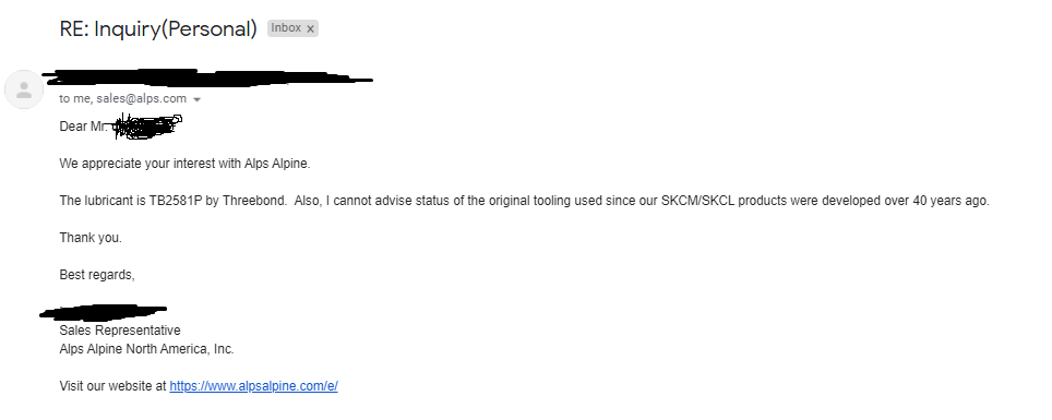

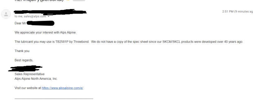

Earlier today, on the r/mk discord, someone posted a screenshot of an email from Alps. The email response ways that the lubricant used on the SKCM/SKCL was TB2581P, made by Threebond. I confirmed this by emailing them myself. While this lubricant is not listed on Threebond's website, I have contacted them try to find out where I can get some to compare with real lubed Alps. Proof of both email's have been attached below, even though they are identical. Please message either me or the original finder on Discord for further proof, or even email Alps themselves. I am headphone_jack#0001, the original finder is Jacobalbertus1
#5416.

- unknown (1).png (42.68 KiB) Viewed 83760 times
- alps.png (25.23 KiB) Viewed 83760 times
