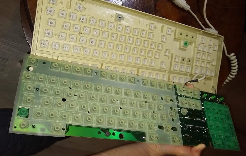

I can relate. I've bought a BTC 5149 and I came across the same problem.grodzio wrote: 11 Jul 2020, 16:20 I've bought a BTC 5140 recently and it's great so far, however the tactility is a bit inconsistent in some keys, for example, W is less tactile than T. Is this normal and is there a way to fix this?
I've tried cleaning it inside but the problem persists. (picture attached) Didn't try water over the rubber or lube for the sliders yet.
I have another BTC with sliders which I don't remember the model now and it feels better, probably because its newer (it has windows key)
