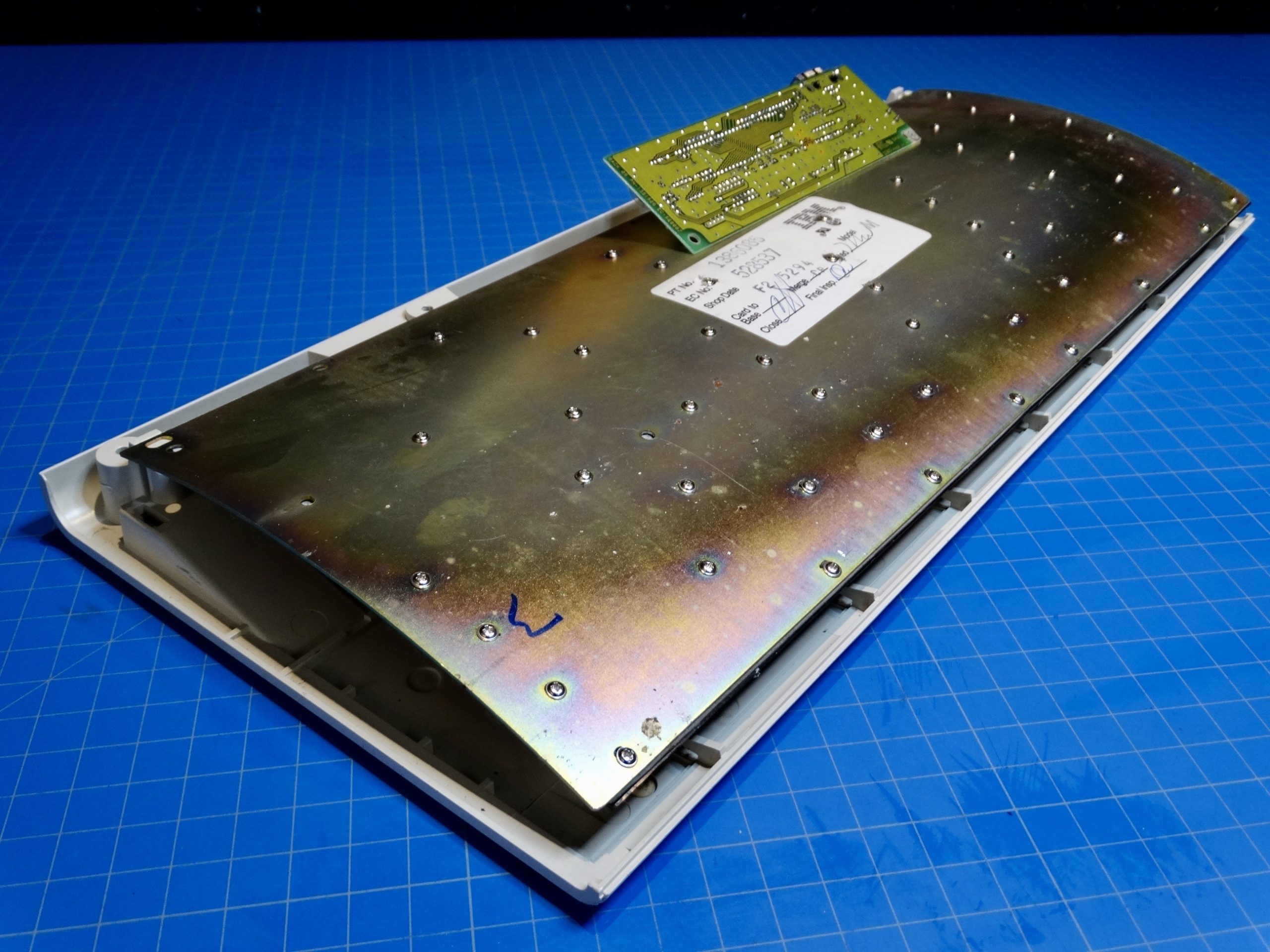

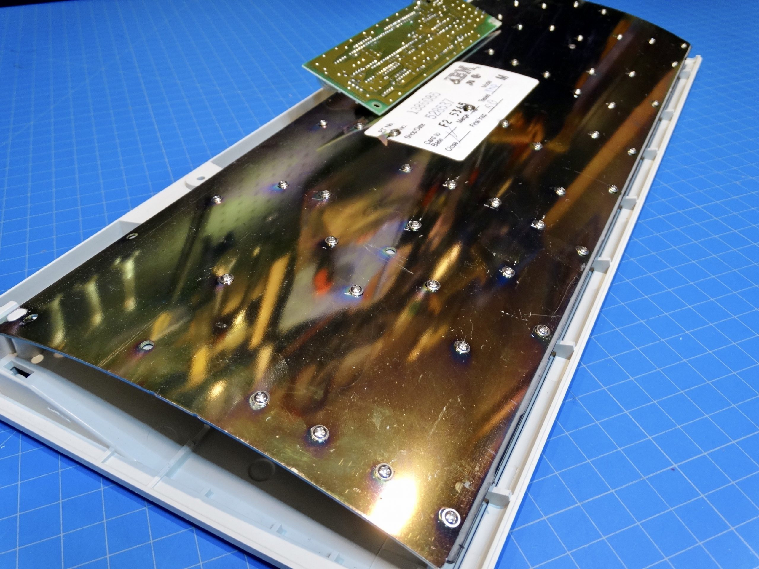

clickykeyboards
19 Jul 2020, 01:16
Some additional examples of model M keyboards with shiny, curved, steel backplates.
source: early 1986 IBM model M (1390120) Made by IBM 12 JUNE 86
https://clickykeyboards.com/product/ear ... 2-june-86/
source: early 1986 IBM model M (1390120) Made by IBM 11 MARCH 86 https://clickykeyboards.com/product/ear ... -march-86/
