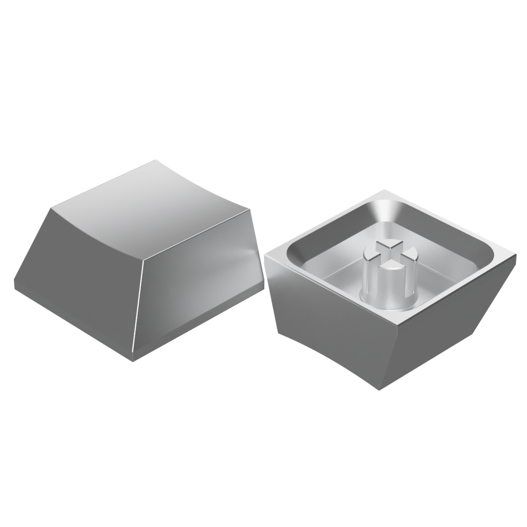

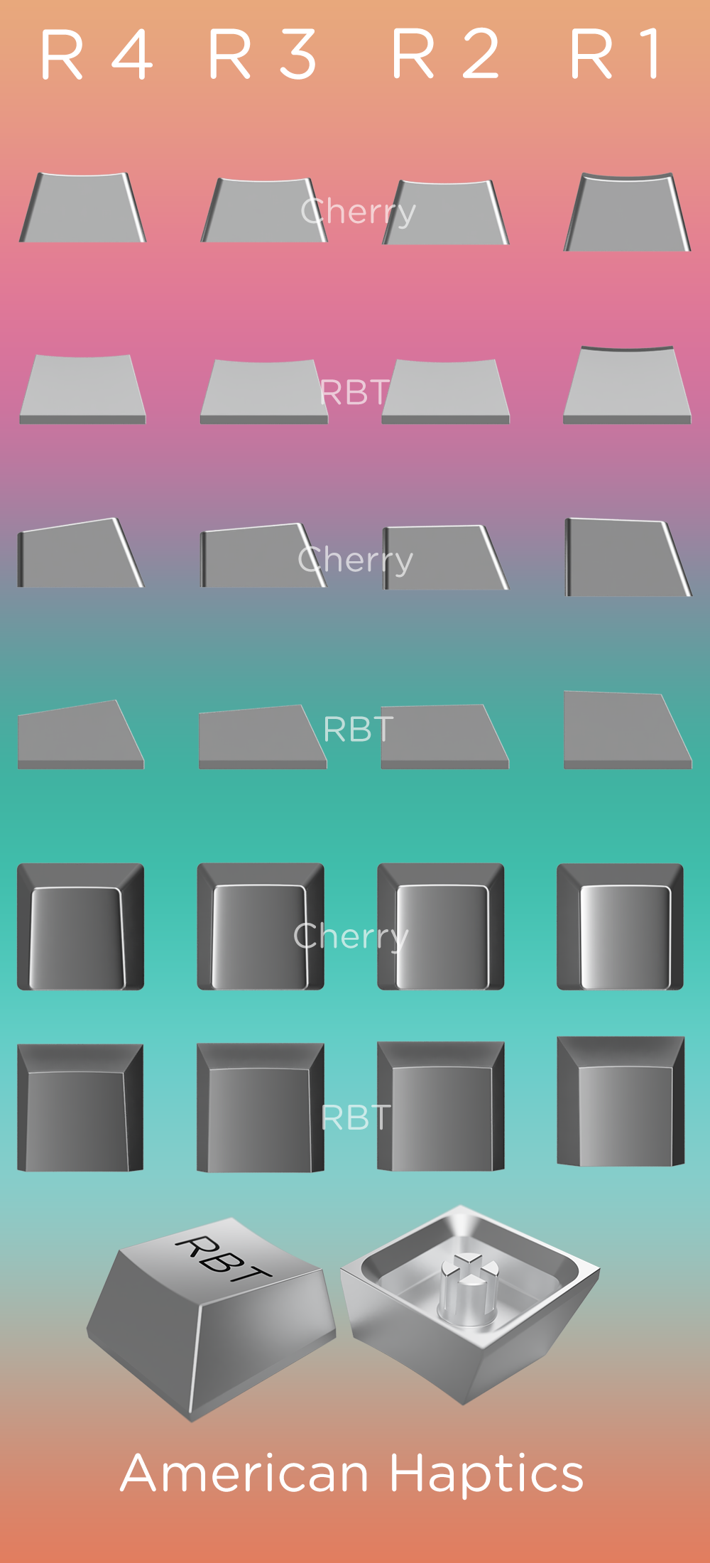

The RBT key cap profile is based on Cherry OEM, but optimized for machining. This gives us a more geometrically brutal appearance but retains the same ergonomic feel and location. We have been developing this product for about 6 months, and are about ready to launch. You can currently purchase unmarked key caps at our website.

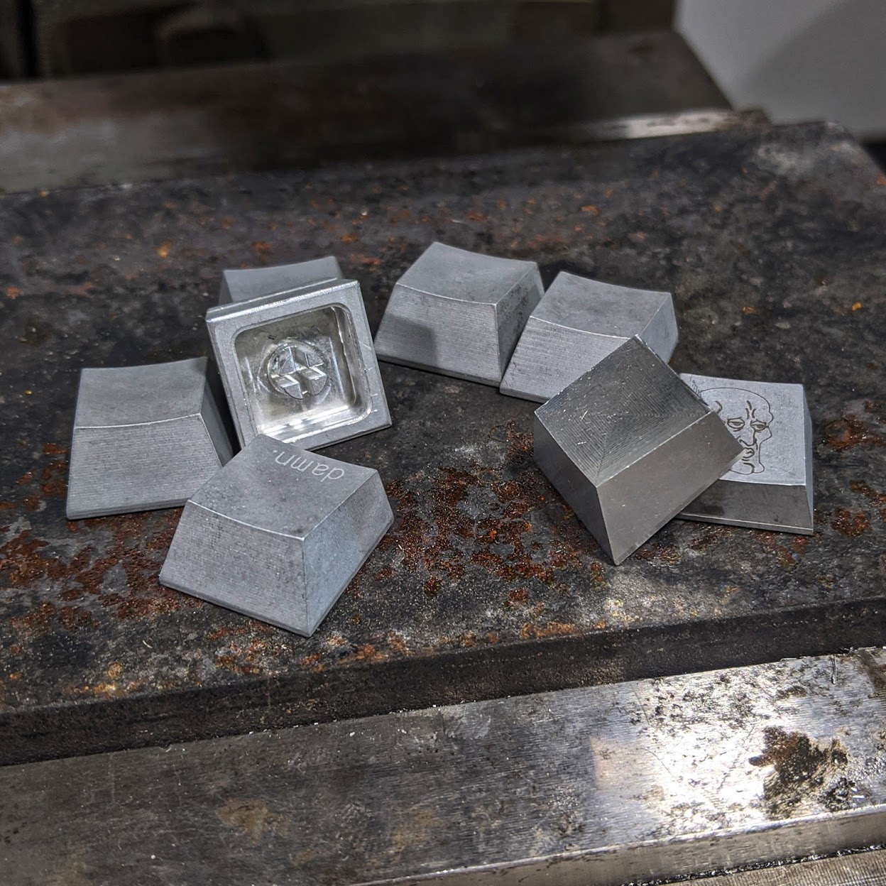

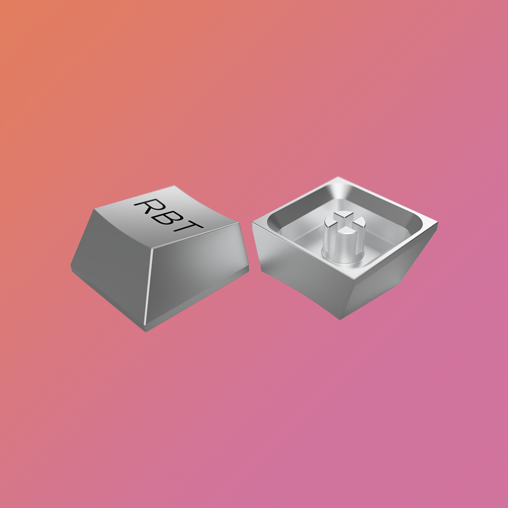

Pricing is projected to be $20 for unmarked, and $22 for custom legends once we get the laser set up and our process dialed in. The raw type can be seen in this photo on top of a laser marked handsome squidward. These are early prototypes from January when we had a few different laser demos from companies we were shopping. Since then we have changed some features of the switch mount side a few times to get it just right.

You should work on your models, they're ugly. And don't call that Cherry profile, it isn't.
I mean this in a critical way, I'm not trying to insult. I'm just getting tired of enterprising people coming along with half-baked ideas.

Also, the last photograph is from early prototypes with imperfect finishing and fixtures. Hang with us!

So, I slightly misunderstood your pitch. I thought you would be offering both RBT and Cherry profile. When I said "don't call that Cherry profile" I was referring to your "Cherry" models in the render. But now that I've realised you aren't offering those, that doesn't matter so much. To elaborate on what I said, despite its irrelevancy: those Cherry models don't seem to capture the correct Cherry top profile. R1 is most obvious: Cherry profile R1 doesn't slant that much. My other irk is that, even if you corrected the top profile, the shape of the caps wouldn't match any GMK or Cherry set. Most notably because of the constant radii along the four downwards corners. On GMK/Cherry they're a tapered radius. Even compared to "Cherry OEM" (I'm guessing you mean SP? which is not popular these days), the shape doesn't look quite right in a few ways. Also, if you're not referring to SP, and instead referring to "OEM" profile generally associated with Filco and other early OEM keyboards: that is not at all like Cherry profile, it's a totally different profile which is much higher.
Regarding RBT, your actual proposed product:
Some people might be fine with the extremely simplified shape. Hell, some people might even like it visually as a full set. But if you're aiming to primarily sell single custom keys, I think the mismatch will put a lot of people off. Those caps will look extremely out of place paired with any Cherry/SP set, and I say this as someone who made highly simplified metal keycaps years ago: that might not seem like a big deal when you're looking at the RBT keycaps on their own, but once you put them on a keyboard? It just won't look right. Sure, you might sell some, but I can't see this being a popular thing. I could be wrong though, who knows?
Regardless, at the absolute least you need to ensure you've accurately captured the top profile. I'd be curious to know which keycaps you've been taking measurements from.
P.S. The thing that really irked me, and made me want to comment, is your lack of clarity around "Cherry" and "Cherry OEM" profile. Like I touched on before, "Cherry OEM" isn't really a thing. It seems like you haven't really done the basic research into profiles that you should've done. If you've modelled these on "OEM", it's only gonna match up with a select few sets of low quality keycaps found on certain OEM boards.
