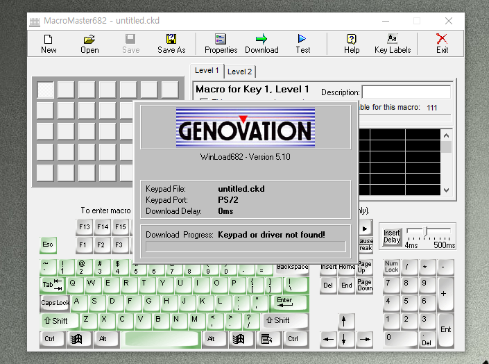

So I bought orihalcon's soarer's converter off ebay. To use it for my Genovation 682 macropad.
The board uses Alps White switches, it was old new stock. It uses DIN connector so I got the converter for it at tried to use manufacturer's program. But it won't identify the keyboard.
I thought maybe software is too new for this one and try the soarer's converter.

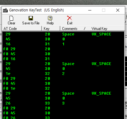

And if anyone likes to know, that Genovation keytest works with other keyboards :D
If you don't feel like reading and converting HID codes, try it!

It's not going to work. Since you're converting between one protocol and another, you lose direct hardware access. So no, that program will not talk to the keyboard through a Soarers converter.
For example, I'm typing on a Model F XT, but Windows sees this:
That's not a converter issue, since that's how converters have to work.
Since it works with other keyboards, it likely talks to the keyboard differently than this specific one.
Coeus
24 Aug 2020, 00:15
The program from Genovation seems to think it is talking to the keyboard via the PS/2 port. If so, and it allows you to program the keyboard then presumably they have extended the AT & PS/2 protocol to send more data to the keyboard (more than the LEDs, that is).
For that to work via Soarer's converter would require that the program know to send via USB instead, possibly and another USB endpoint, and then Soarer's converter to convent that to the proprietary extension to the PS/2 protocol.
If you have a real PS/2 port you could connect via that. Failing that you'd need to use the key remapping/macro functions of the converter rather than the keyboard.

I can reprogramme the keyboard through PS/2 port on another PC via Genovation's programme because it will allow direct control.
And just use it through stock soarer's converter because it does seems to convert the keys properly! Thanks for the tip!
