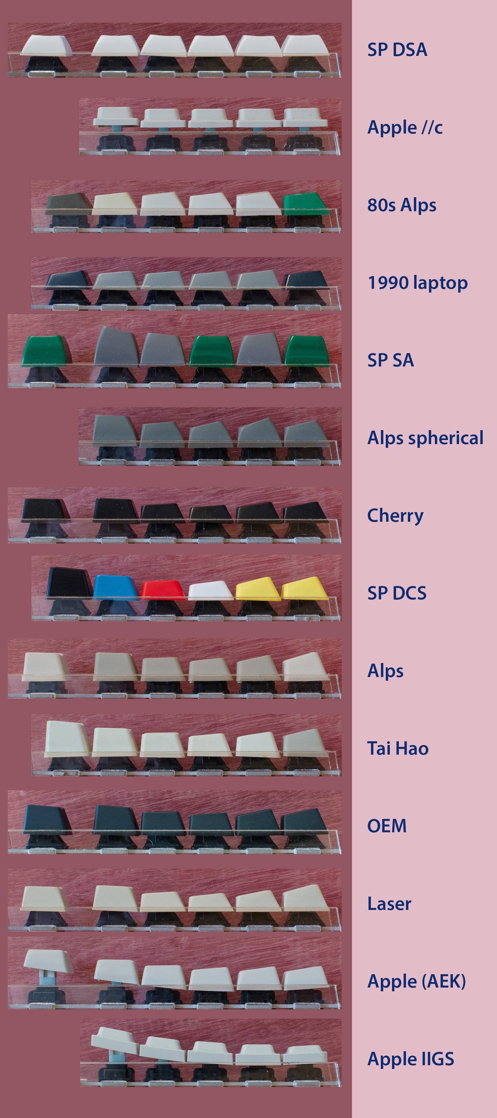

While a keycap with an Alps stem will physically fit any other Alps mount (talking SKCM and no modifier keys or spacebar, of course), however, you should watch out for the keyboard profile: keys on one row can be taller than those on other rows. See the SPOILER at the bottom of this post.

I did try to move around the letters, like I have done with all the laptops and keyboards I have had, but of course as you say the key profile is quite different so back they went.
I was just wondering what my options were to replace the keys aside from finding a FK-5001 donor QWERTY board.
It looks like the profile matches the Tai Hao do you agree? I can't understand though if the profile is always related to the keycap mount.

It looks closest to Tai-Hao to me, too.
