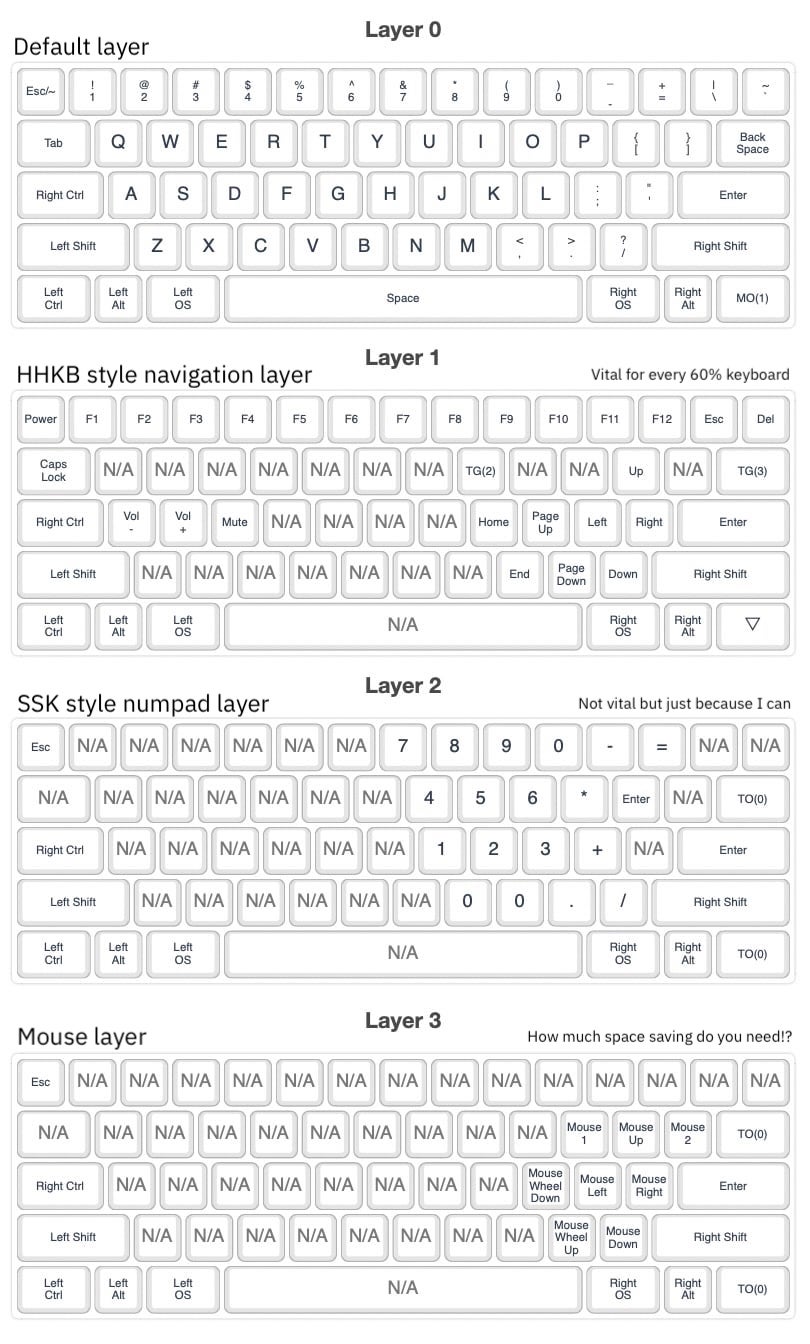

Speaking of which, here's my current magicks on the Kishsaver:
Screenshot 2021-03-31 at 9.50.49 am.jpg (154.13 KiB) Viewed 12584 times
Layers, my friend. That's how you make compact keyboards sing. Forget all about cramming keys in strange places. Put them right where they should be, when pressing something else.

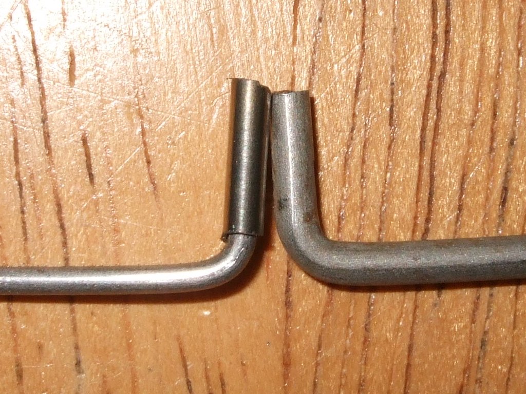

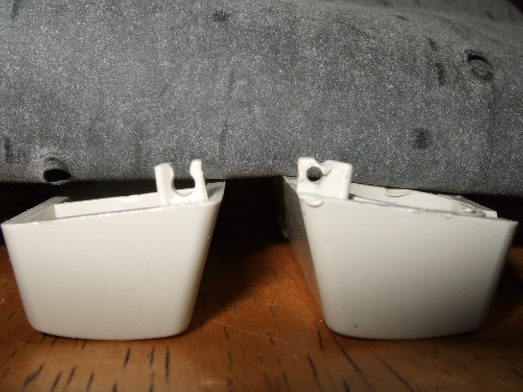

I say again: there is a mod that allows a Model M space bars to work nicely on a Model F keyboard. The "wcass stabilizer" dates back to 2013.
https://geekhack.org/index.php?topic=48 ... msg1047062
Model M space bar on left, Model F space bar on right.
wcass stabilizer left, Model M stabilizer right.
wcass described this in great detail in the video I linked earlier.

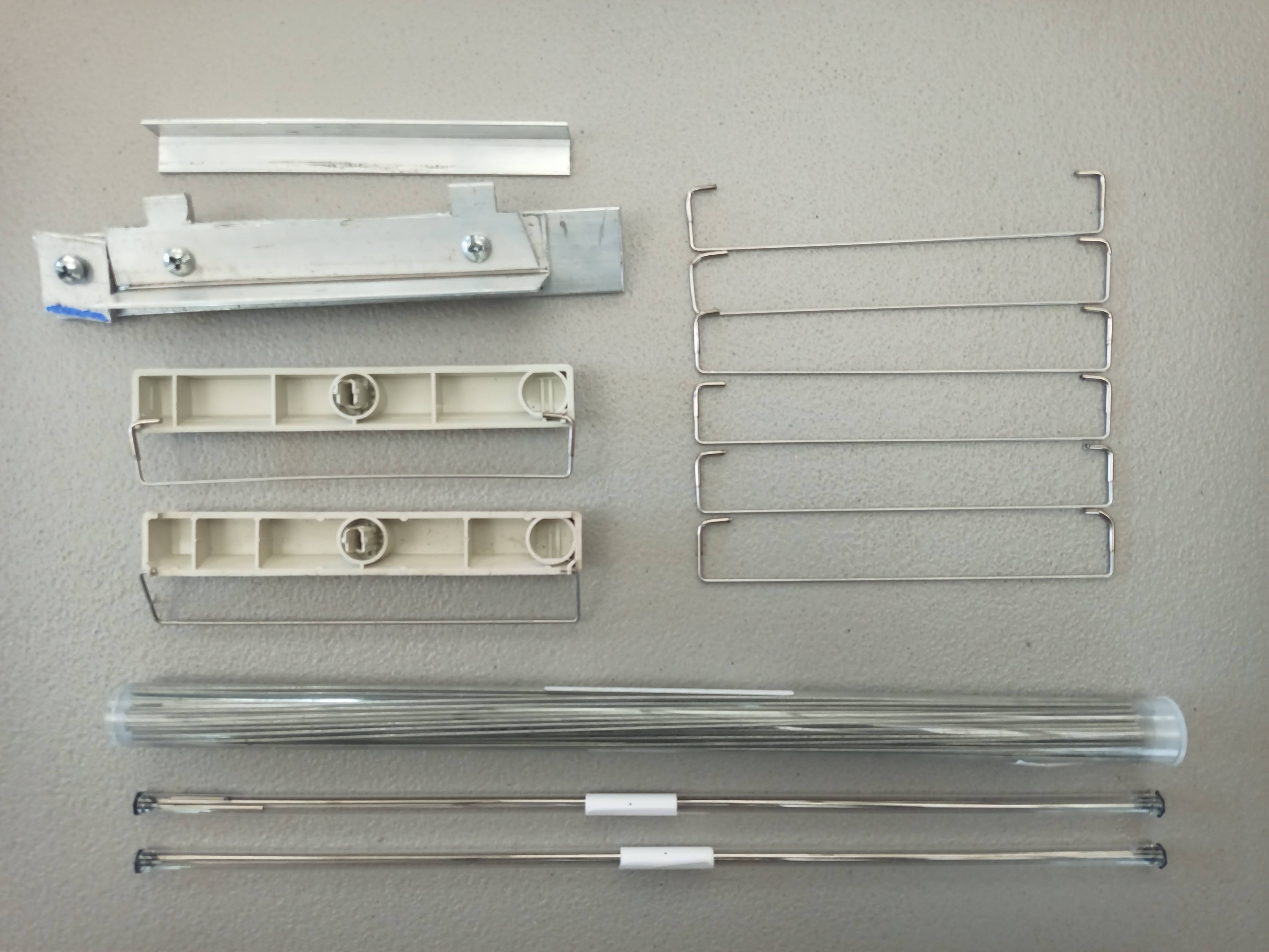

I stress this because, since wcass is no longer able to manufacture these, he and I have agreed that I would pick up where he left off. Here you can see, clockwise from top left: wcass's stabilizer wire jig, some wcass stabilizers that are nearly done (some final tweaking required), the wire and tubing required to make them, a Model F stabilizer with thin wire, and a Model M stabilizer with wcass wire.
wcass stabilizer jig and supplies.
