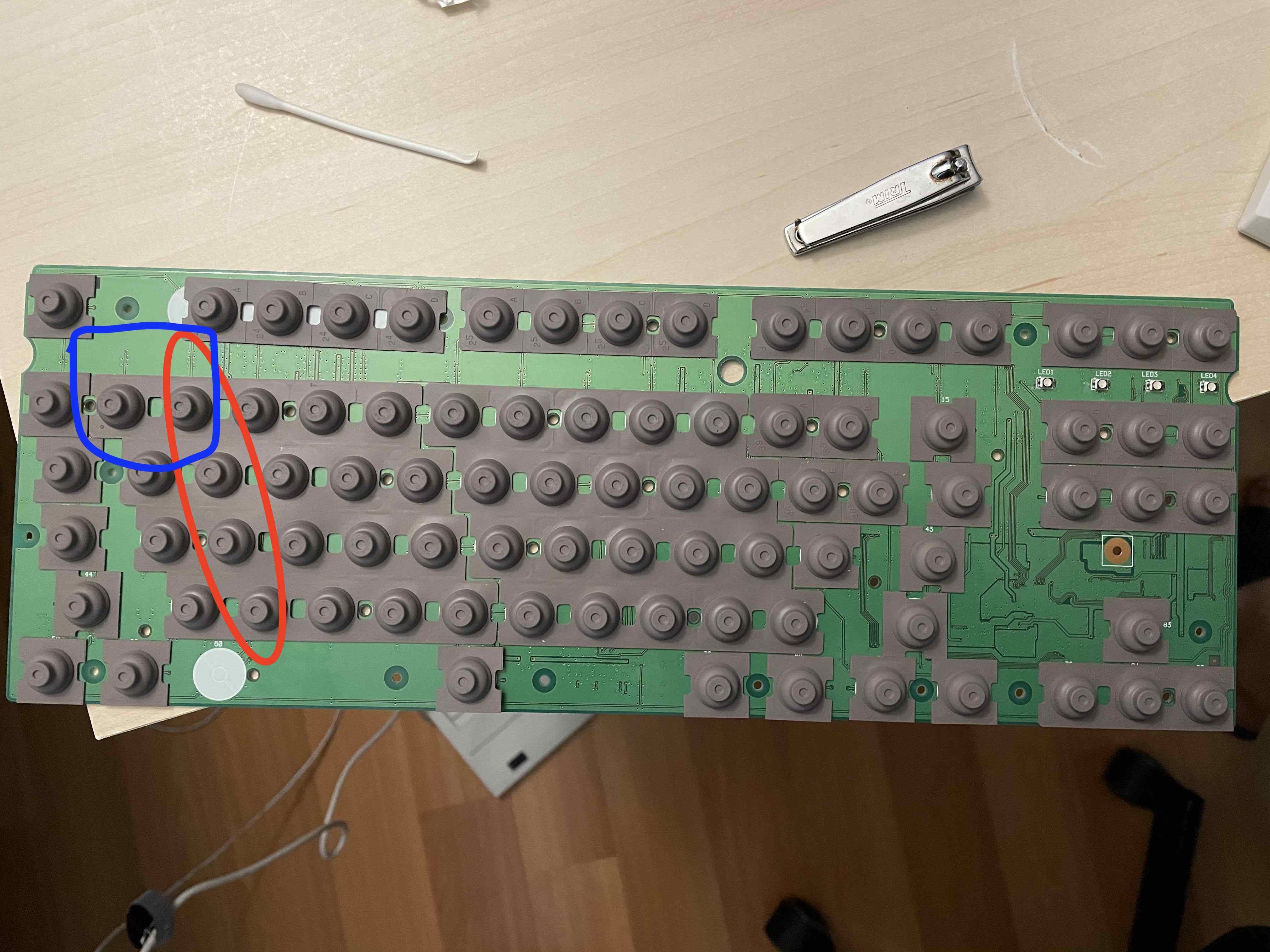

Bought a Realforce R2 (PFU Limited) from The Fujitsu Scanner Store over a month ago. I spilled a bit of water on the top-left part of the keyboard (the blue region). Unfortunately, now the keys located in the red region do not work anymore. All the other keys work fine.
I unplugged the keyboard and let it dry for a few days, and I've also tried cleaning the PCB with isopropyl alcohol. Both don't seem to have helped.

Can you share a photo of the PCB under the domes/springs (and the springs/dome interior)? Usually cleaning all 3 components will fix such an issue.
Go-Kart
07 Jul 2021, 18:23
Evilcamels wrote: 07 Jul 2021, 18:19 Can you share a photo of the PCB under the domes/springs (and the springs/dome interior)? Usually cleaning all 3 components will fix such an issue.
Whilst I haven't had to deal with such an issue myself, I have been inside enough Topre boards and have a good enough appreciation of how they work to say that the above suggestion should remedy the problem.
