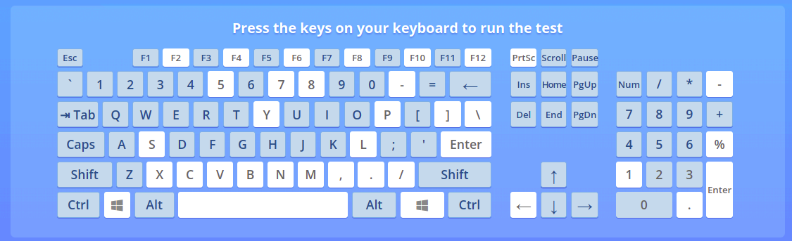

I own a Unicomp Model M build around 2012. It was stored away for quite a long time and I took it out of its storage these days for use. Unfortunately I realized that a lot of keys do not register anymore. :(
Through its live the keyboard lost some rivets, but not so much that this could be an issue imho. Does anyone recognize an pattern in the non working keys? Could it be the membrane?
I re-seated some of the non-working key stems but it did not help.

Which keys are and aren't working? Either way, that's a horrible sight!
As for the membrane matrix: I believe Unicomp still uses the same matrix as IBM. (Excepting the new Mini obviously.)

The white keys do not register.
