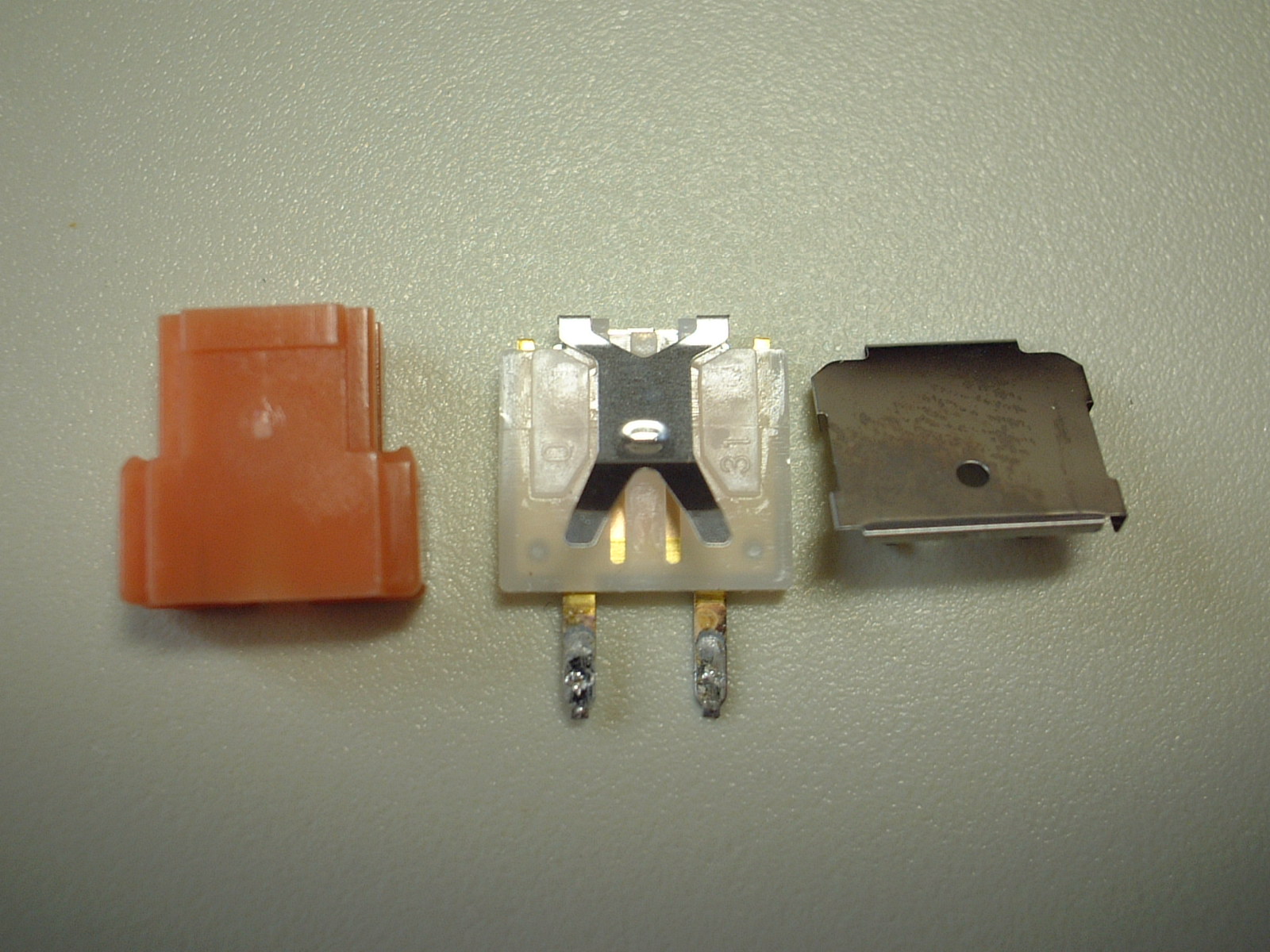

I've got a loose orange Alps switch on my desk (doesn't everyone?). Used. While my opinion would be to use a socket that fits used switches, I think you'd have different widths on each switch.
Anyhow, if you consider north and south as the switch normally mounted, I'm taking an east-west measurement. The width of the first pin is .2mm at the base (i.e., the not soldered part) and .4 / .5mm at the tip (i.e., the soldered part). The other pin is .2mm at the base and at the tip. Mind you, I have a brand Z digital caliper and I might not have a clue about what I'm doing.

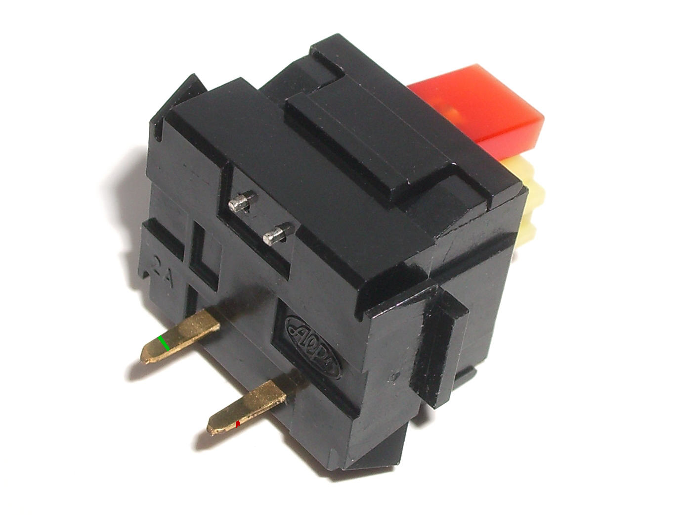

Just as a suggestion, post a pic and label what you want measured. You could probably steal the one from the Wiki and mark it up in MS Paint or Gimp. I'm not terribly good at taking pictures of something as small as a keyboard switch and I didn't have time to label ...
Here is what I need measured marked with red and with green. Red is the thickness of the legs, Green is the width of the legs.
While I mostly need that measured on Alps switches where the solder residue hasn't been cleaned, measuring it on all sorts of Alps switches (with and without residue, Alps clones/Alps compatible switches, etc) would also be helpful.
