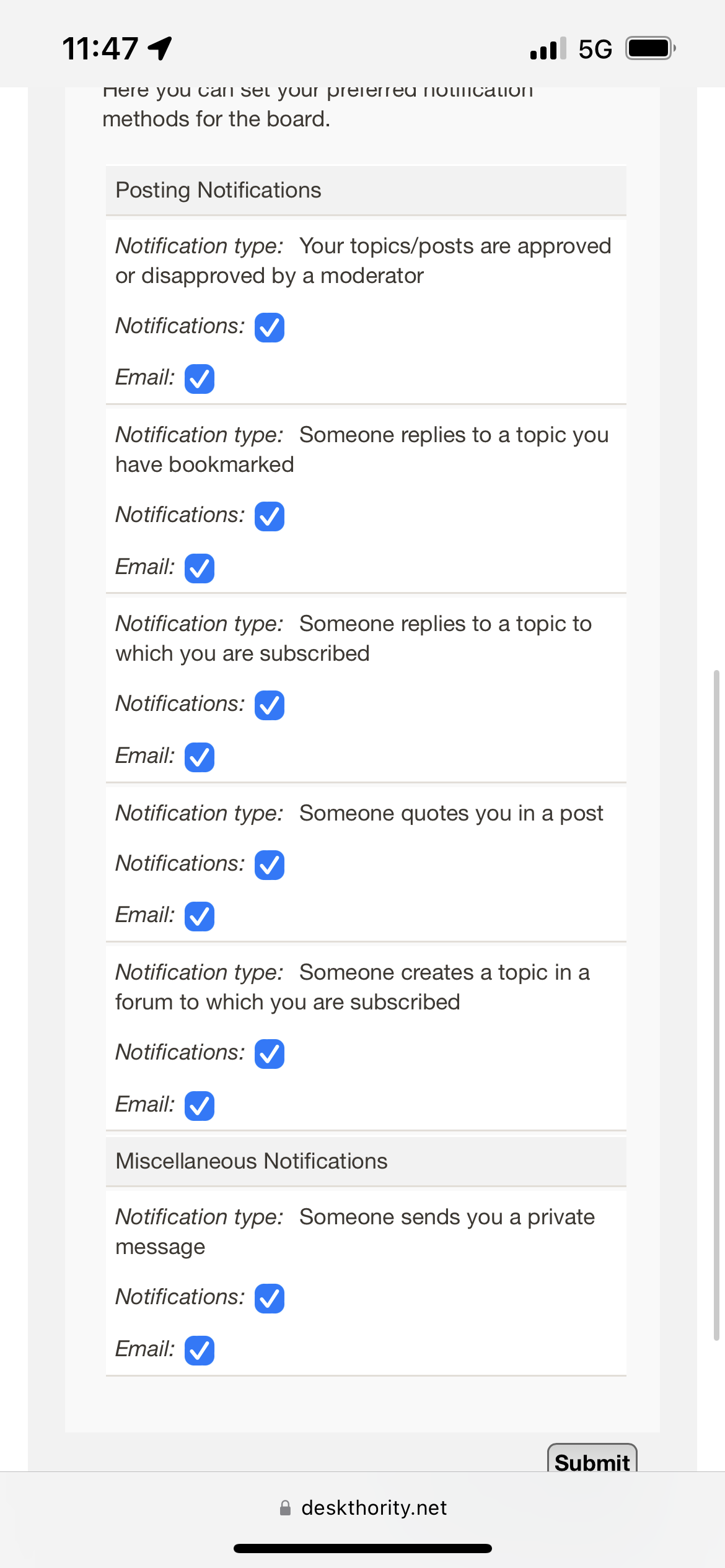

User control panel > Board preferences > Edit notification options

Thanks I checked those settings and everything is enabled and has been since I created my account. Below is a screen shot.
