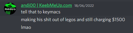

peter_pane
22 Jun 2022, 20:09
Insane work! I really respect every step you make. Insane craftmanship and I hope to hold one of your works in my hands someday. Thanks for your partaking in the community and beyond.
Sadly not everyone is as happy, so I'll just leave this here.
KeebMeUp
22 Jun 2022, 20:36
peter_pane wrote: 22 Jun 2022, 20:09 Sadly not everyone is as happy, so I'll just leave this here.
lol, cute you felt the need to create a new account just to bring my name up.
also, thanks for including the context of that conversation
ill just leave this here
v.equals.c.rhino
22 Jun 2022, 20:42
bruh idea23 made a handful of these sets and then took on hundreds more in orders and disappeared from the internet. maybe not the best comparison...
KeebMeUp
22 Jun 2022, 20:43
v.equals.c.rhino wrote: 22 Jun 2022, 20:42 bruh idea23 made a handful of these sets and then took on hundreds more in orders and disappeared from the internet. maybe not the best comparison...
bruh...
