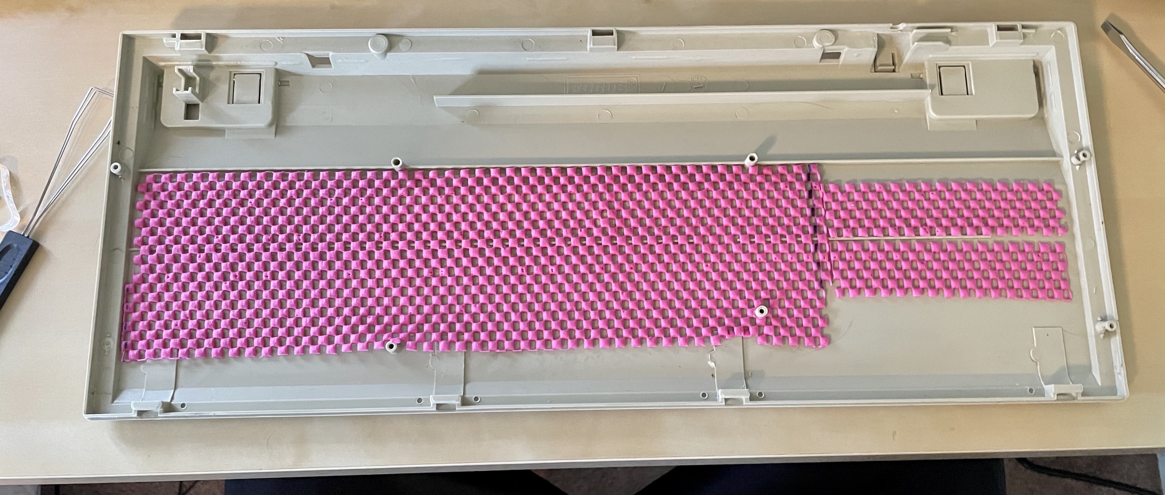

- thefarside
I’ve also noticed this and I think it has to do with the vibration of the plate and PCB. On Focus keyboards putting a non conductive pad under the PCB helps and tightening up the case. I’ve never tried on an M0116 but it couldn’t hurt to try. Below is a pic of a foam pad used on my Focus keyboard. It presses against the PCB and eliminates almost all of the reverberation.

Interesting. I'll definitely try that and see what the result looks like.thefarside wrote: 31 Aug 2022, 16:23 I’ve also noticed this and I think it has to do with the vibration of the plate and PCB. On Focus keyboards putting a non conductive pad under the PCB helps and tightening up the case. I’ve never tried on an M0116 but it couldn’t hurt to try. Below is a pic of a foam pad used on my Focus keyboard. It presses against the PCB and eliminates almost all of the reverberation.

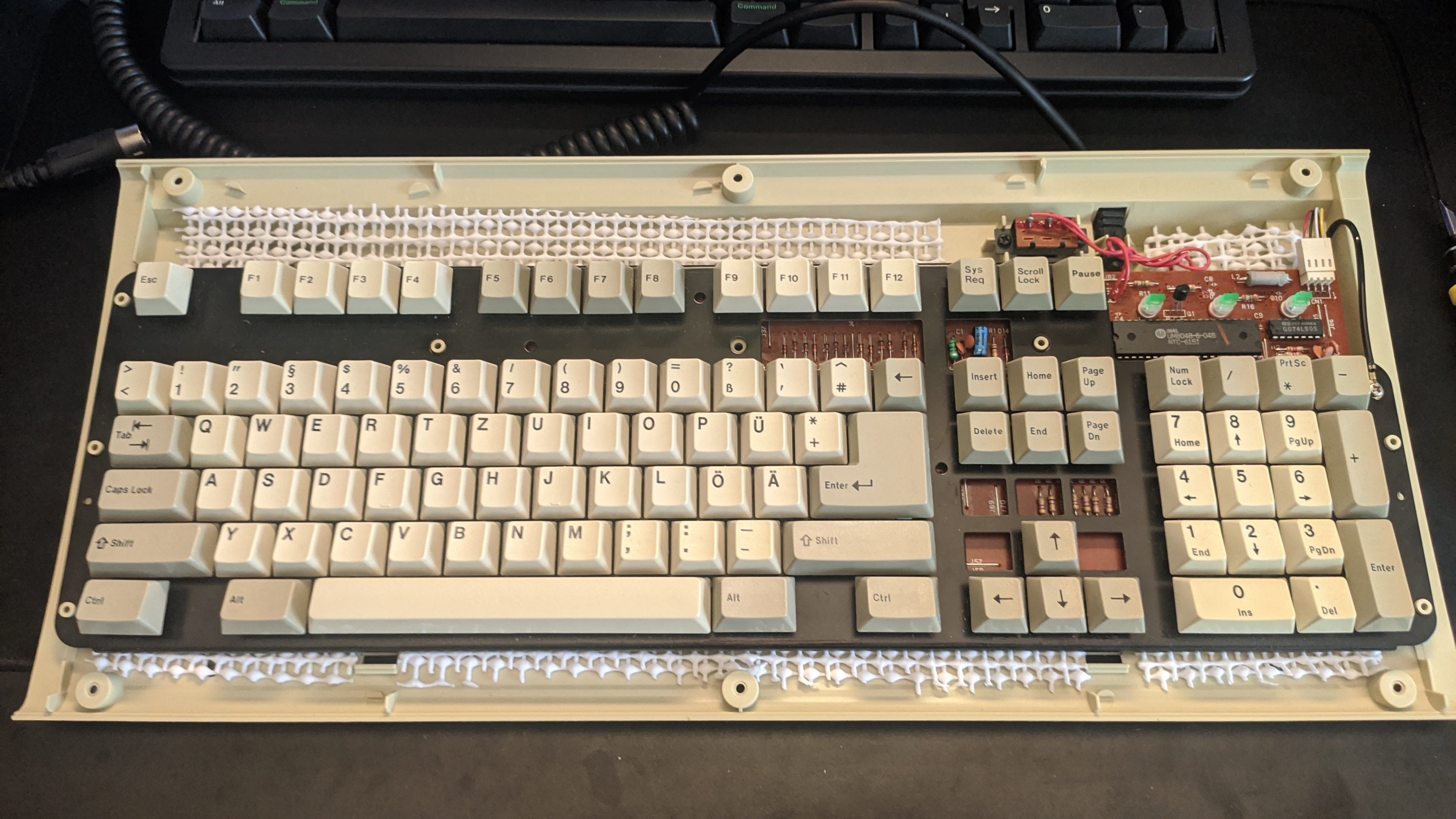

- doomsday_device
yep, that works especially well with roomy boards. i tried with m0116 too but it didnt had such impact as the case is pretty dense already and there is not so much space. worth a try anyway.thefarside wrote: 31 Aug 2022, 16:23 I’ve also noticed this and I think it has to do with the vibration of the plate and PCB. On Focus keyboards putting a non conductive pad under the PCB helps and tightening up the case. I’ve never tried on an M0116 but it couldn’t hurt to try. Below is a pic of a foam pad used on my Focus keyboard. It presses against the PCB and eliminates almost all of the reverberation.
