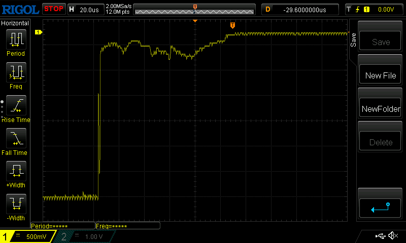

Do a simple continuity test with ohm-meter first. If it is OK then continue with oscilloscope:
  • Connect the switch in series with about 5k to10k resistor to a battery (1.5 - 10 V).
  • Connect scope probe on the switch.
  • Set up one-shot trigger on the falling edge on the scope and press the switch.
  • Check out the results on the scope.
  • Press the switch, set up one-shot trigger on the rising edge on the scope and release the switch.
Switch voltage should stabilize to a new level in about 5 ms. Otherwise it is faulty.

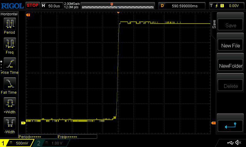

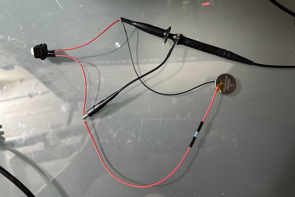

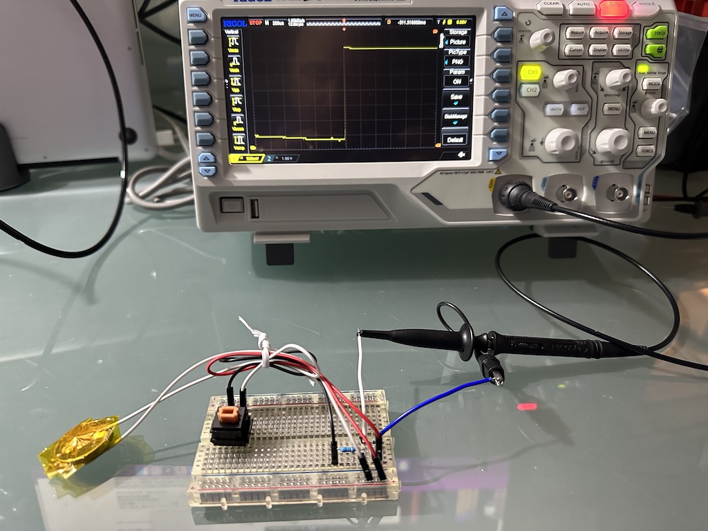

My setup was a quick hack with a 4.7kOhm resistor in series with the switch. I drove it with a coin cell at 3.6V.
The results have been different to what I have seen on your screenshots:
200µs
In my case the switch press looks actually too smooth in my eyes ...

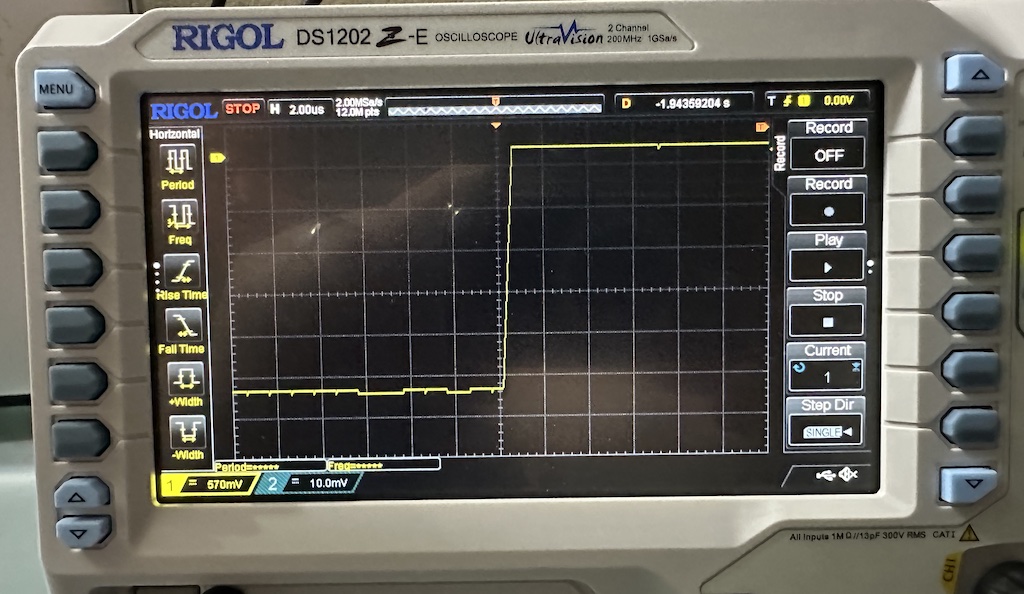

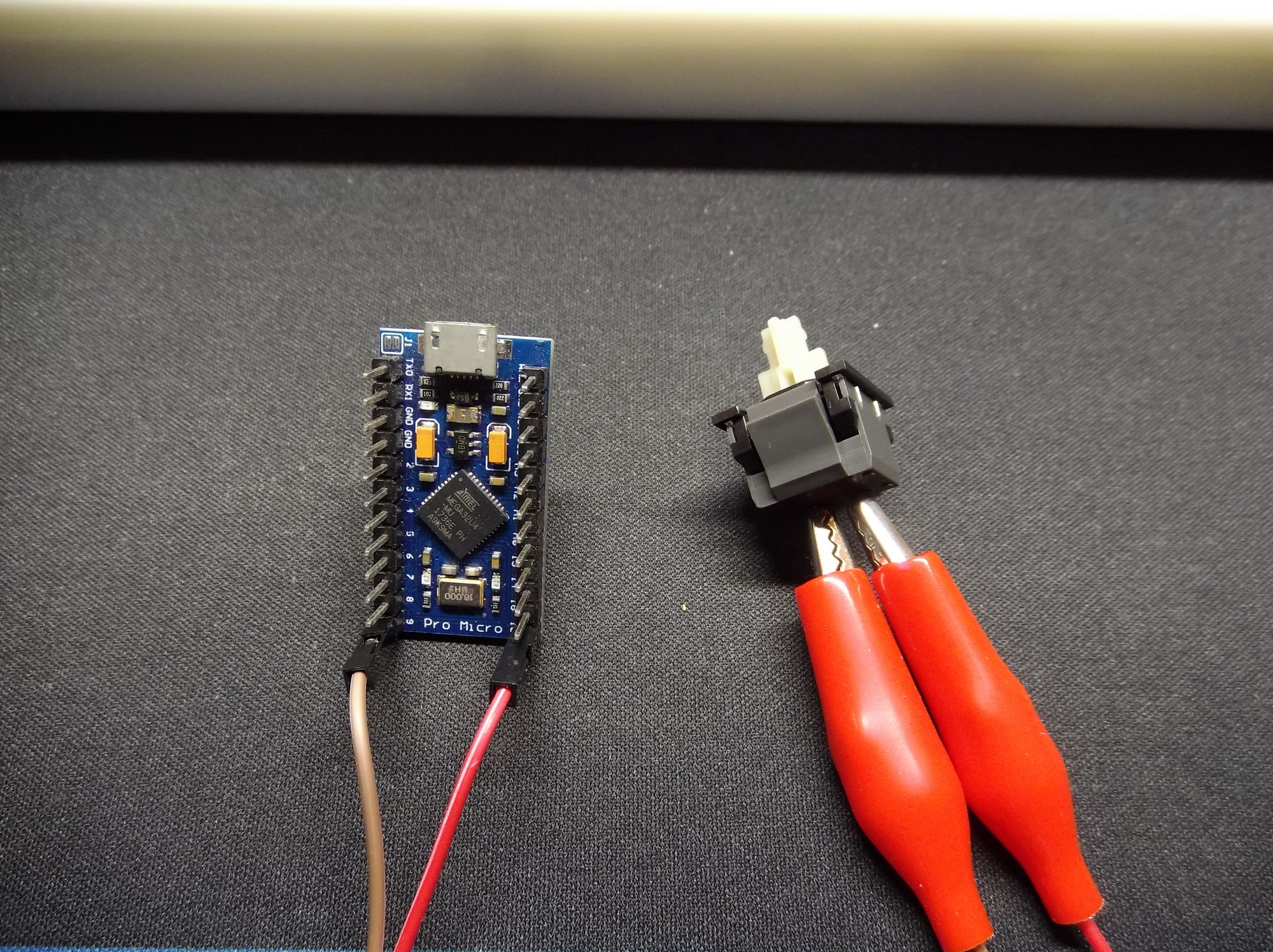

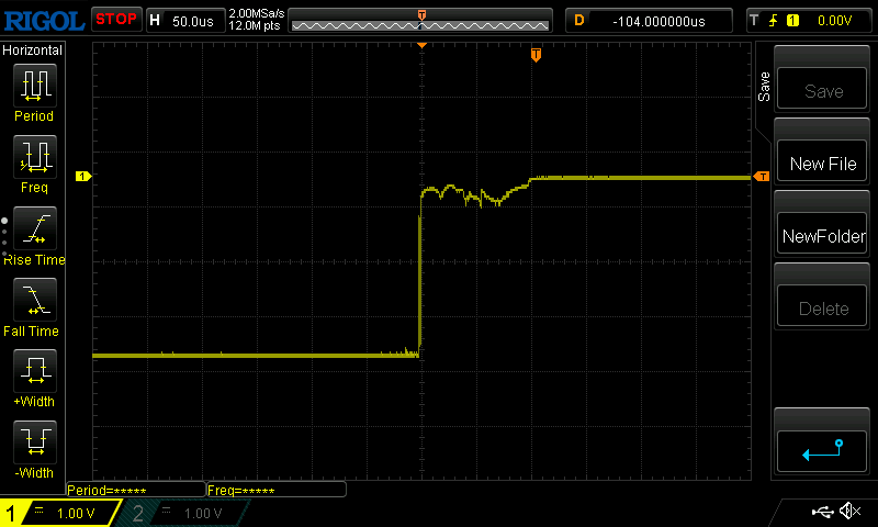

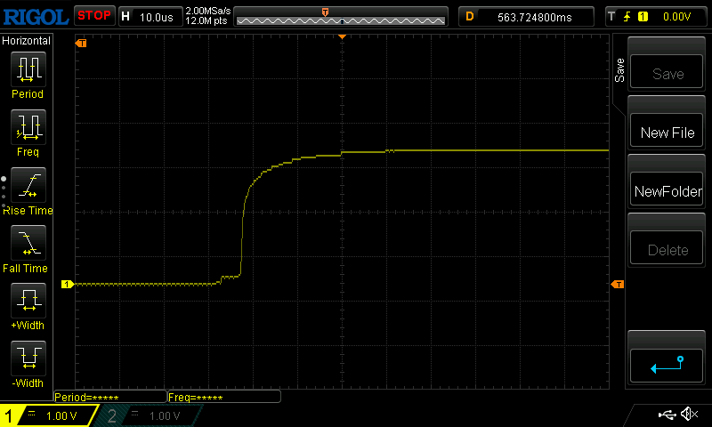

Yeah, I am definitely doing something wrong. I checked all smoothing settings in the OSC and there is nothing. To be sure, I also tested a few other switches.
Alps Blue - 10µs:
Cherry MX Green - 50µs:
The breadboard hack is likely the root cause. I am going to change this to measure directly on the switch and clip things together directly next. More to come ;)

4k7 resistor is ok as well. You only want any low voltage setup which leads to currents of around 0.1 - 1 mA. Not too high voltage, not too high current since keyboard switches are low voltage and low current. If your probes have switchable attenuation then set it to 10x. It has higher bandwidth than 1x.
Maybe it is possible. It would mean that your switch is pretty much perfect. The other option is that there is some capacitance parallel to the measurement probe. The probe itself should have around 15 - 20 pF. But that is not enough to smooth it as much.
Is the probe properly compensated?
https://www.youtube.com/watch?v=gSa_1Rs4qbQ
Is the battery good (i.e. it does not have too big internal resistance)?
You can check by connecting the probe to the resistor instead of the switch. When switch is pressed, you still should get full 3 V on the resistor (i.e the same voltage as when the battery is not connected).

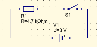

It is hard to decipher the pictures of your setup. The schematic should be something like this:
Connect the probe either across the switch or across the resistor. It does not really matter.
Keep the wires short to avoid parasitic inductance & capacitance.
If you are still getting the same results then I guess that your switches are pretty much perfect.
Do official specifications for your Alps switches define debounce time in the range of 20 us only? I.e. does the manufacturer say that the switches should actually be pretty much perfect?
Cherry MX switches (and their clones) have typical debounce time around 4 ms. This is caused by the leaf spring in the switch bouncing a few times from the contact when the switch is connected. May be some "micro-arcing" as well.

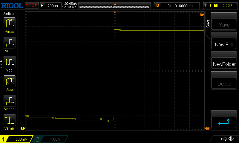

Thanks a ton for all the tips - I still have way too good results (IMHO), but they look a bit more convincing. I have set my probes to 10x btw. With further tests not shown below, I could see that in most cases I can confirm it is 4 to 5ms until the active state is reached. I am building something more reproducible, so I can quickly get my switches tested. For now I show the pictures below of my latests records, but I will post something at a later stage, when I have the configuration locked in ;)
Huge thanks - this really helps!
Cherry Green 20µs:
Alps Blue 20µs:
Alps Blue 50µs:
vvp
23 Oct 2022, 13:50
That cherry green scope output looks OK. The blue alps scope output may be OK.

Here's an Alps Green Linear switch - roughly 1 second until it normalizes: Still, it doesn't look like bouncing:
I have tested a not so great White Alps Clicky and it just can't be a proper measurement:

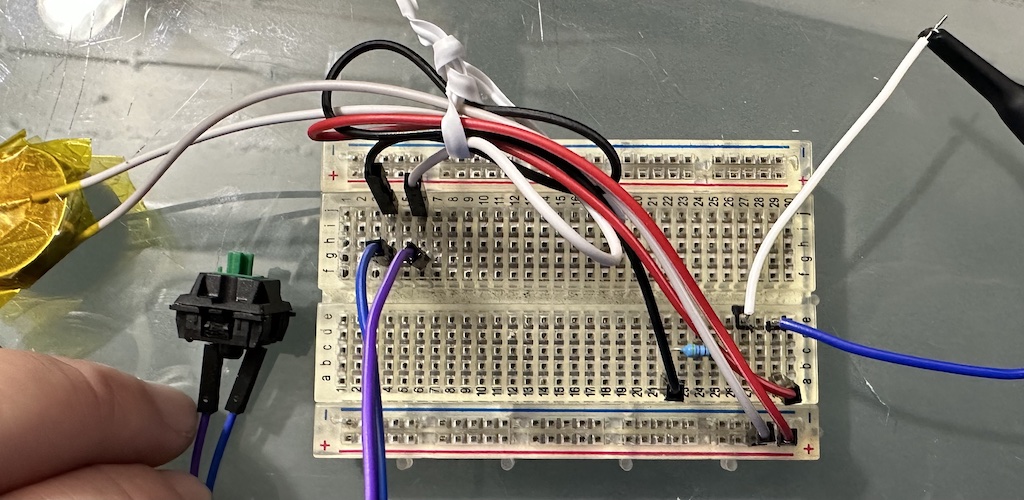

My wiring of the above:
vvp
23 Oct 2022, 19:17
The HW test setup looks OK.

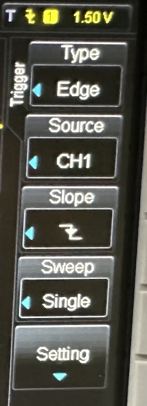

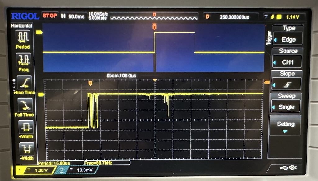

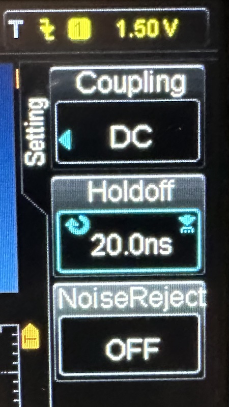

Here are my settings for the trigger:
  • Type: Edge
  • Slope is falling
  • Sweep is Single (One Shot)
  • At 1.50V (and later to 1.14V for rising slope)
Additionally, I've set the NoiseReject to Off:

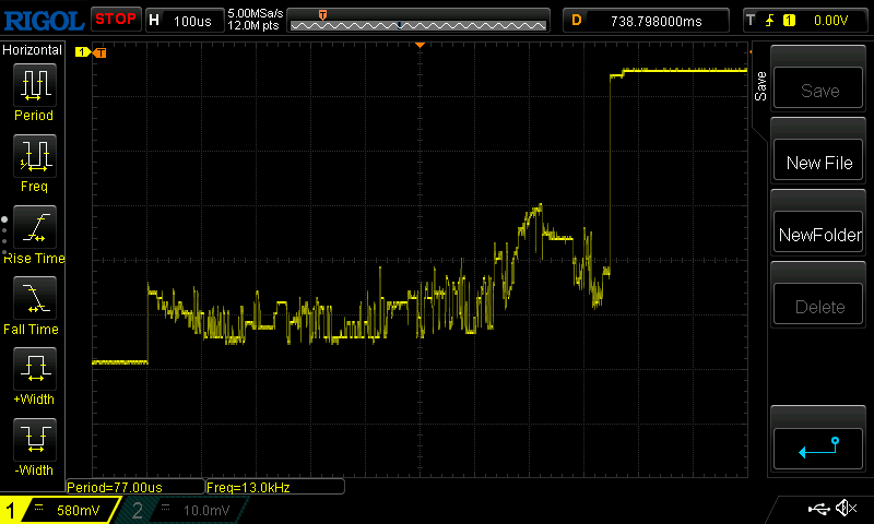

Green Cherry, rising slope, 1.14V trigger:

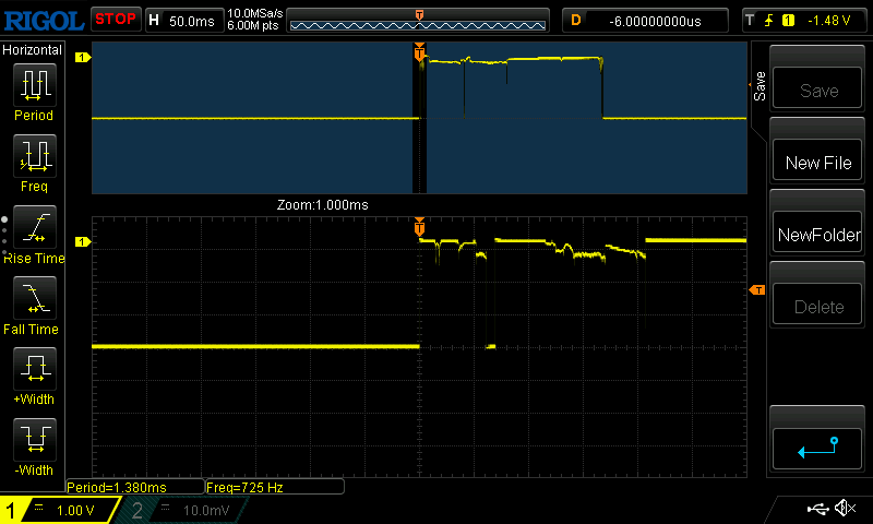

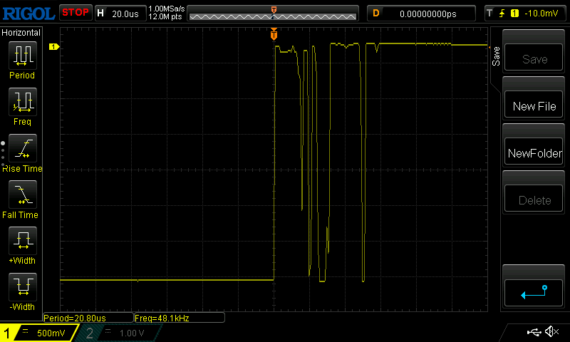

After 11 switches I found a faulty one (in my eyes):
vvp
23 Oct 2022, 22:42
Your trigger setup you have shown is correct now.
Yes, the last switch has issues. It may not be critical. Valid CMOS levels are 1/3 of the Vdd. If the signals do not drop by more than 1/3 then it will not glitch yet. Anyway, I would replace the switch. It will likely get only worse as the switch is used.

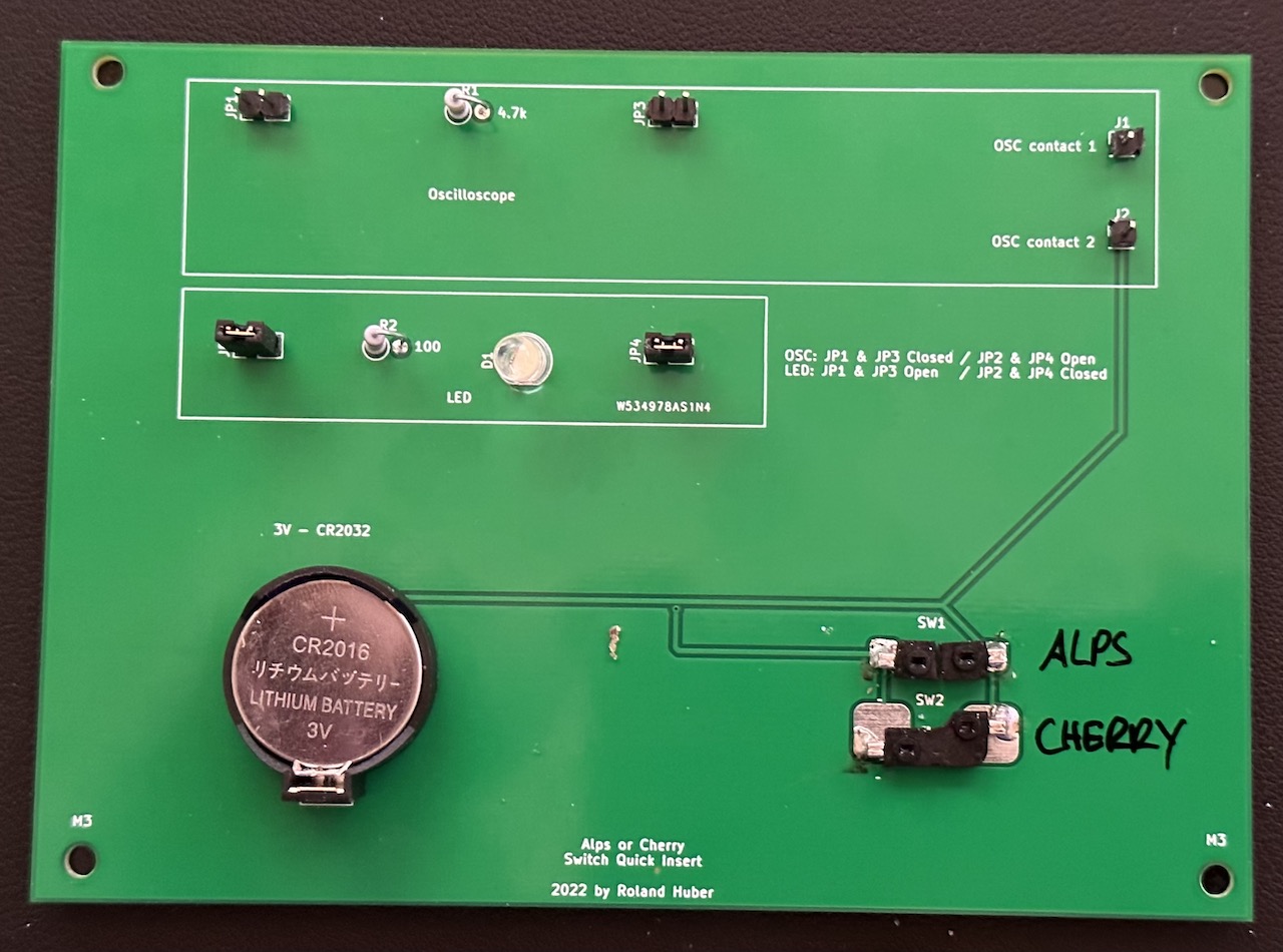

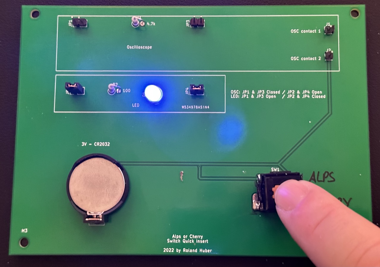

Thanks again for the tips, I want to circle back as I built (a quick hacked together) switch tester with quick inserts for Alps and Cherry switches. It can either do a simple continuity test with LED indication or more advanced Oscilloscope tests with probes. It is basically the earlier shown cable mess compressed into a PCB with an easier insert mechanism to check bulk of switches.
