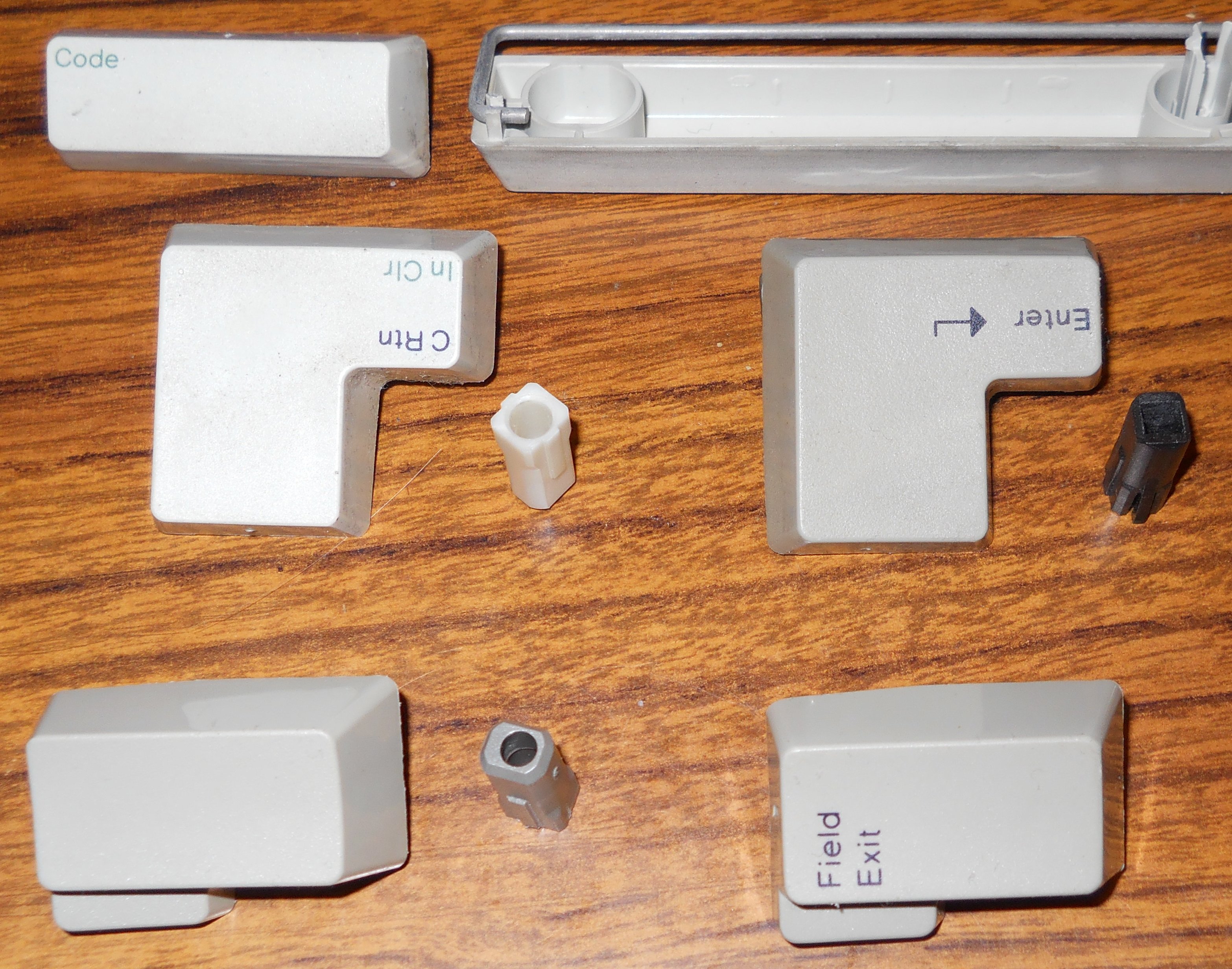

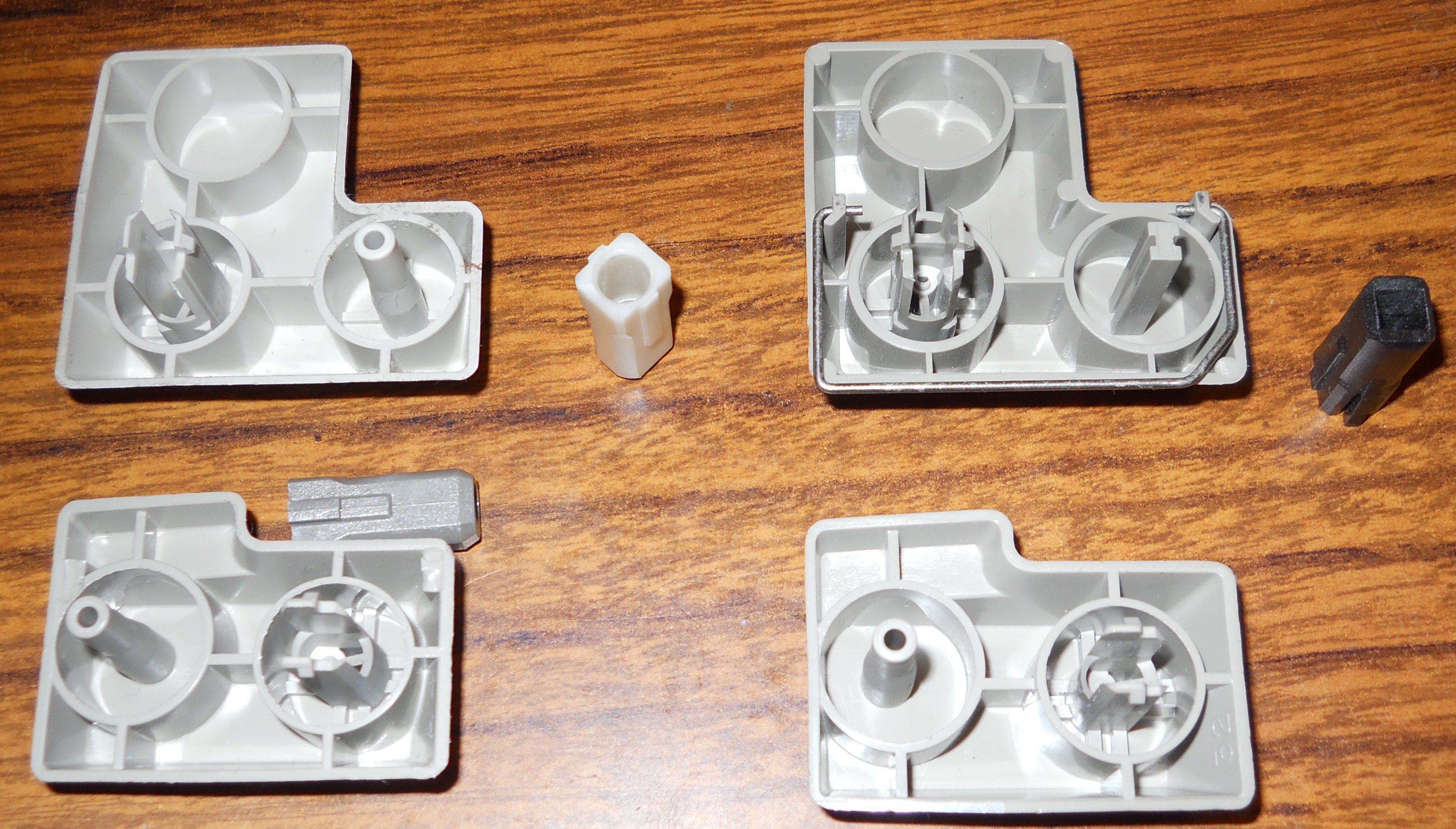

The original, left-side BAE sleeve was white and centered; I moved it to the top position for the ISO key. I had a black stabilizer handy; it wouldn't work any way I clocked it.
I just looked at the parts again, and the white stabilizer has a round hole, but the BAE has a rectangular peg. The ISO has a round peg, small diameter at the bottom, then stepping up to a larger diameter at the top.
Hmm.
I dig out one of the Model Ms and popped the keypad Enter key off. Wire stabilizer. Tried another. Ah, it has a peg! And it has a *gray* sleeve! I pulled the sleeve and tried putting it into my working F/AT. It wouldn't go. After a bit of fiddling I found it clocks with the hole offset to the left, not top/bottom. I popped the ISO Enter back on and voila! Much less wobbly, and it doesn't stick.
Dropping the white and black sleeves onto the pegs of the two ISO keys, I found the peg on the "Field Exit" marked key was slightly larger in diameter than the blank one. That key is noticeably more stable.

Okay, some pictures:

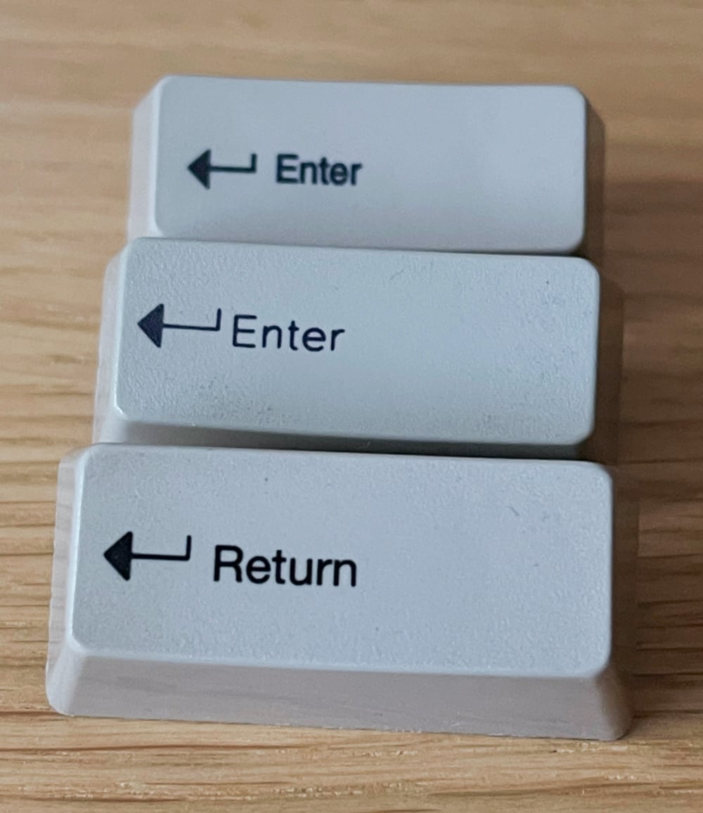

Yeah, the thread I linked discussed that. The pic has 3 caps for that reason: OG IBM plus the two different ages of Unicomp. I suspect the same guy there who pushed the Unicomp SSK project was also responsible for the legend refresh. He could have done better, but it’s most of the way there. What they were shipping in 2015 was atrocious.
