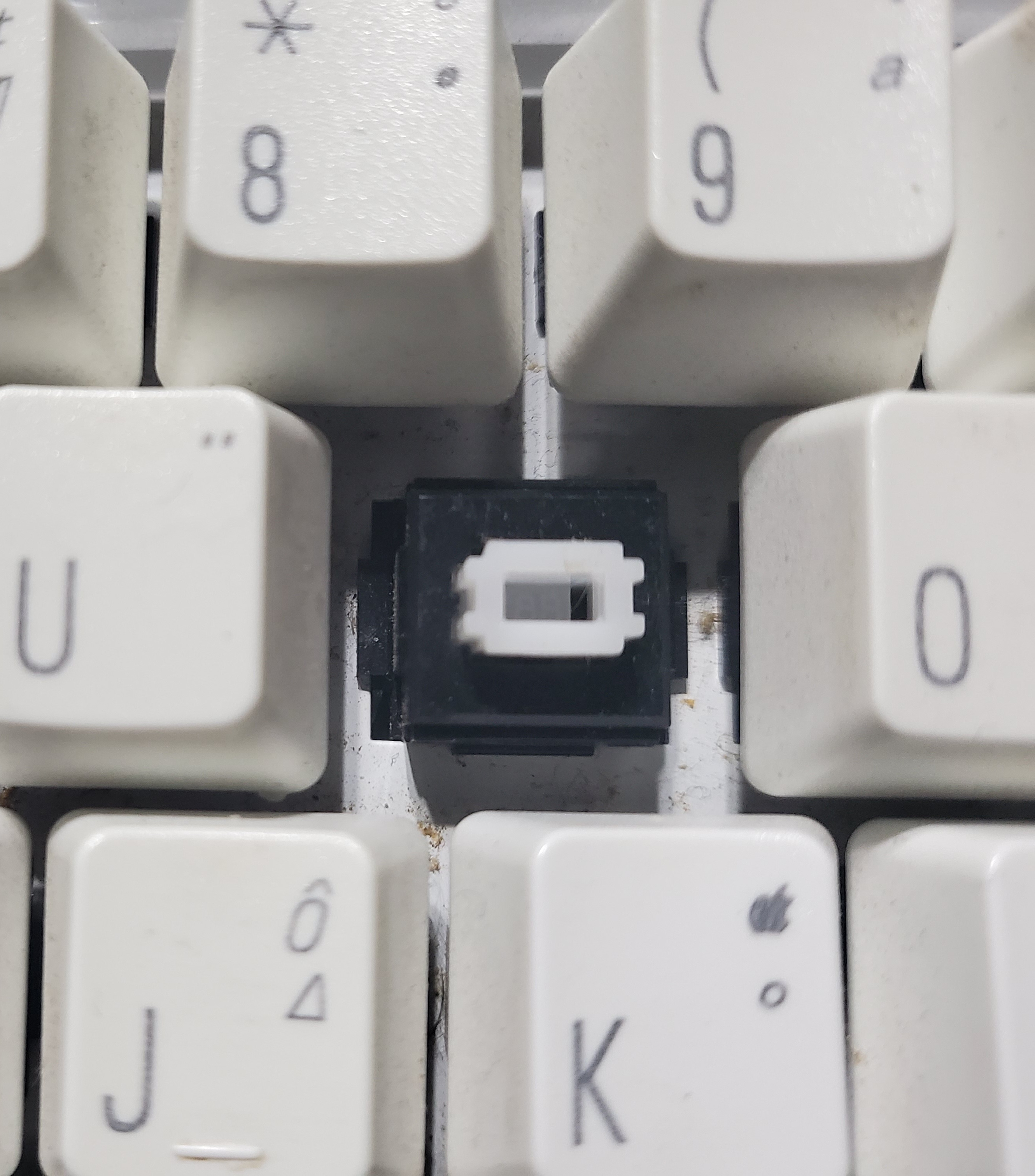

Now, right off of the bat, we can eliminate excess lube as a (primary) cause for chatter. I opened one of the switches to verify that it was bone dry inside, just in case the board had been modified. What of the other popular myths?

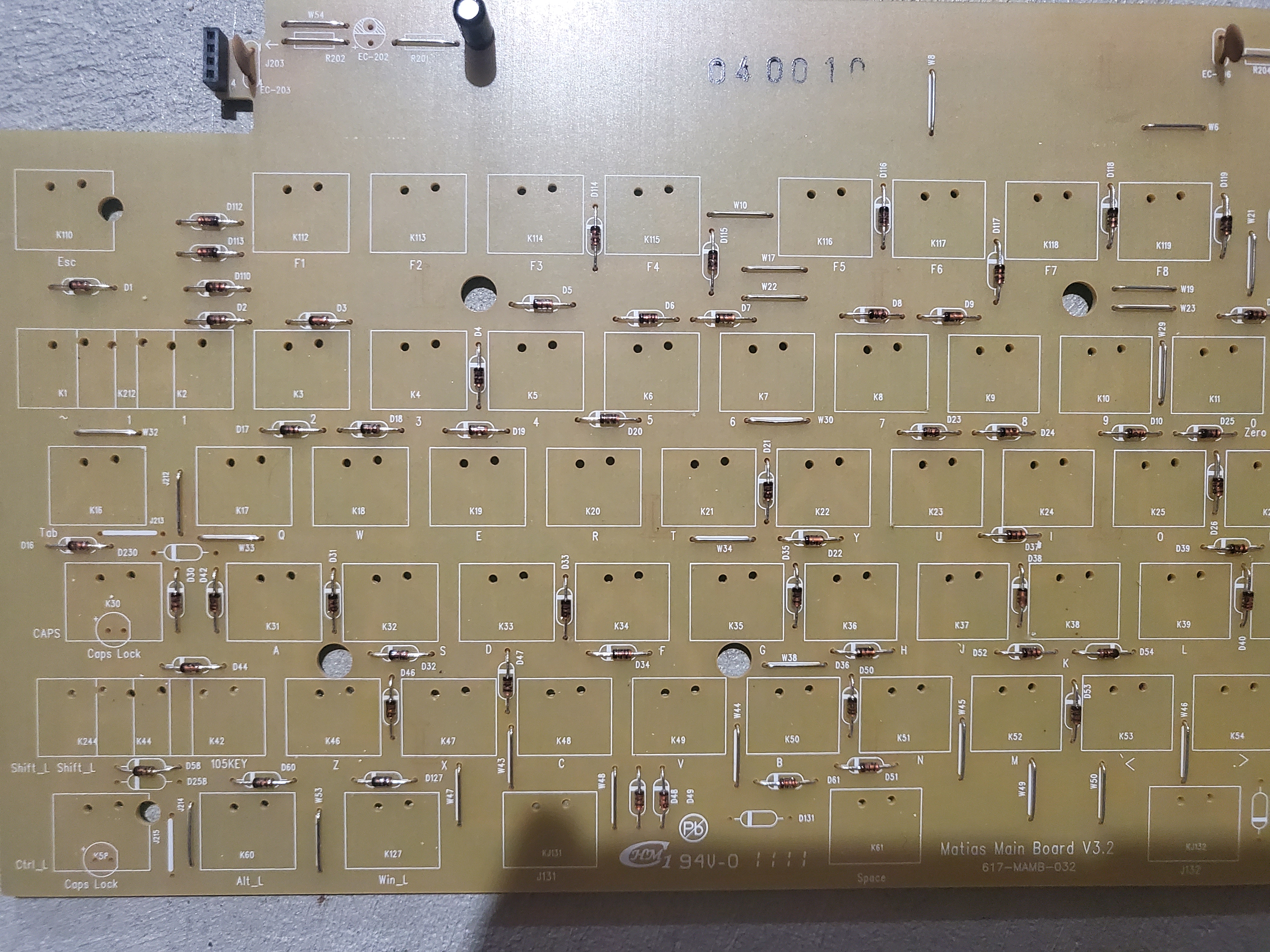

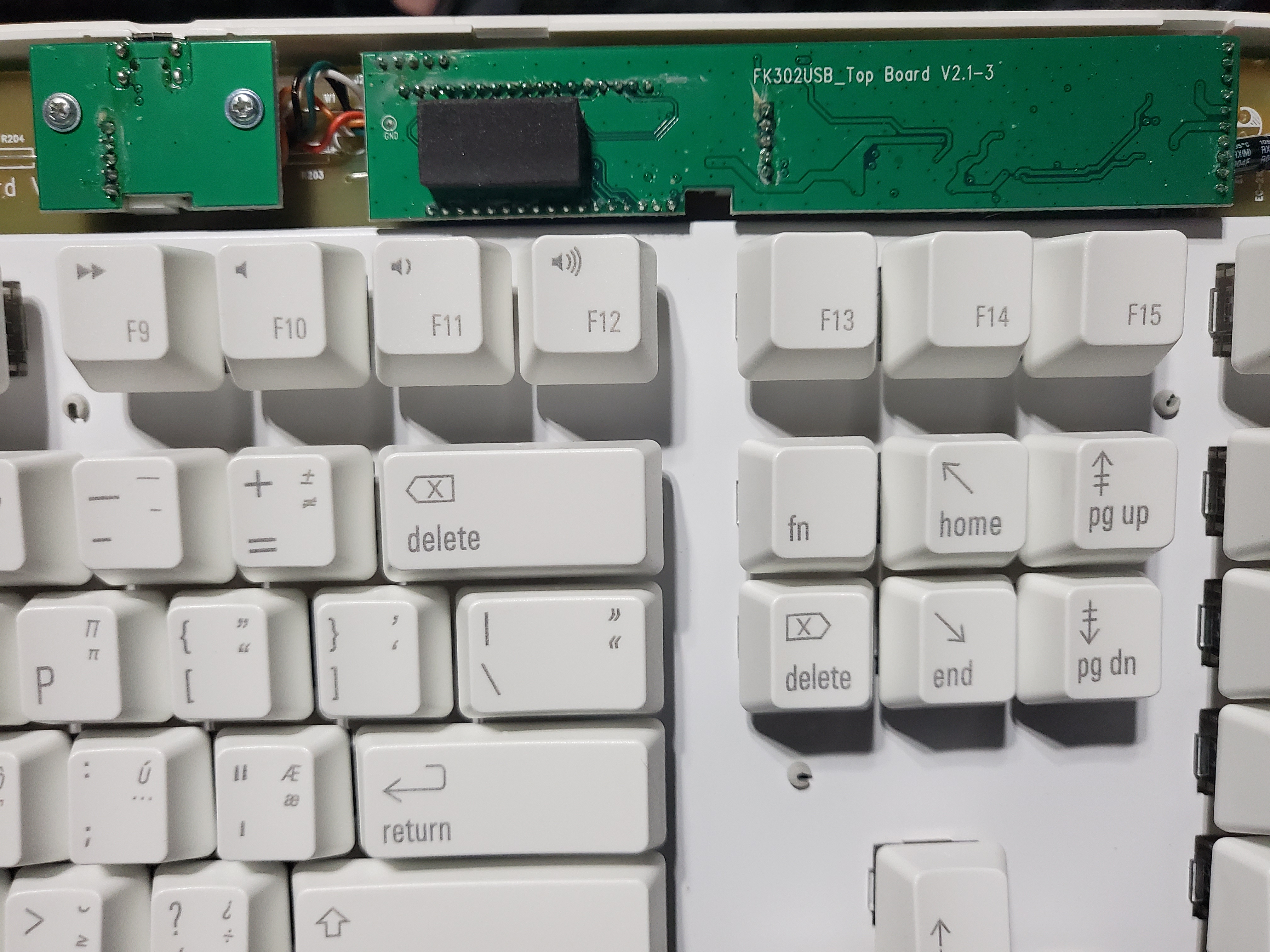

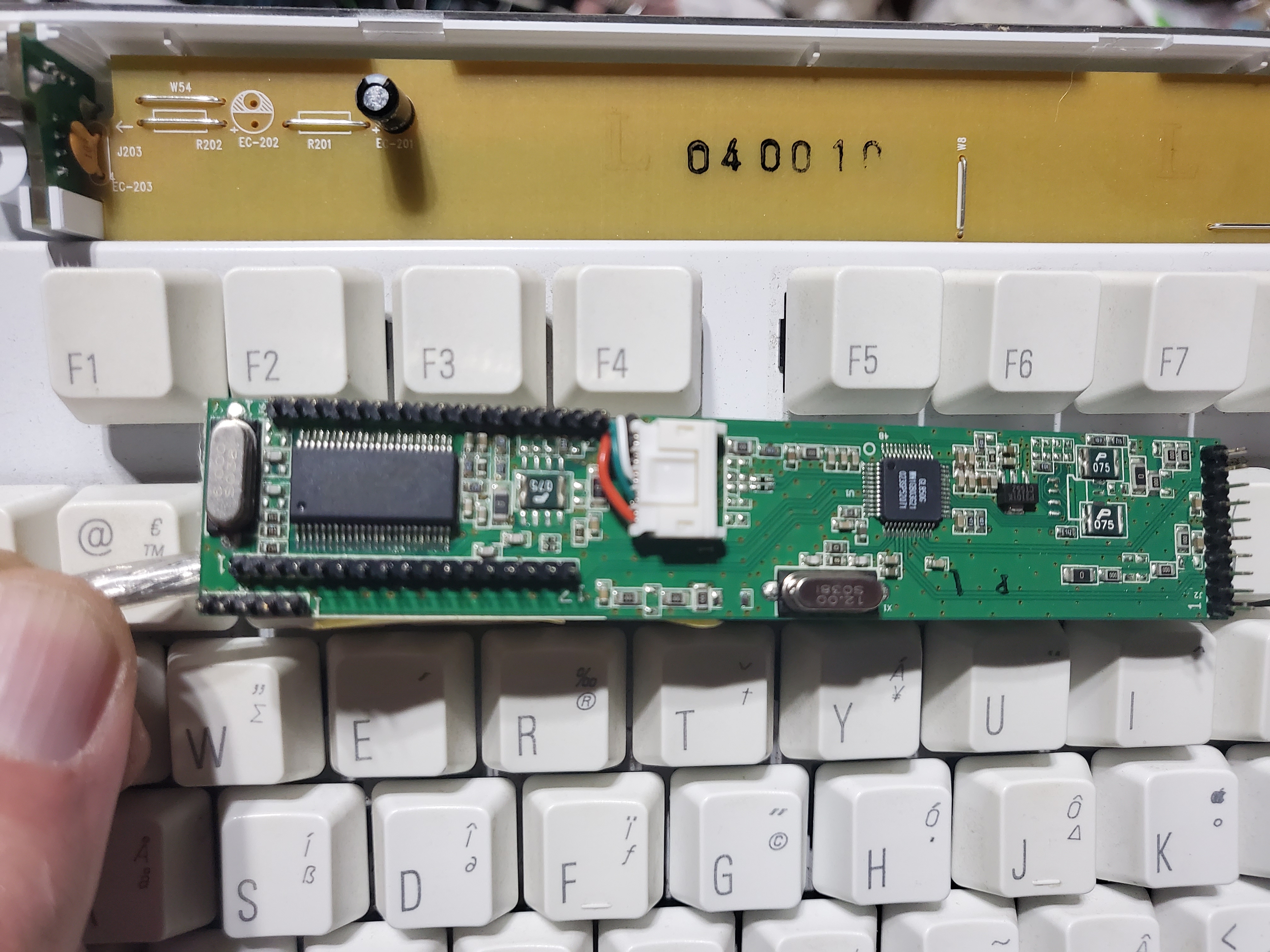

I took the board apart and found that the controllers in even the oldest Tactile Pros are easily replaceable like the mini variants, although these ones do not have a helpful table printed on them to show you pads to solder resistors to to change the mapping based on location and/or operating system:
OG board and controler 1.jpg (2.75 MiB) Viewed 2070 times
OG board and controller 2.jpg (2.83 MiB) Viewed 2070 times

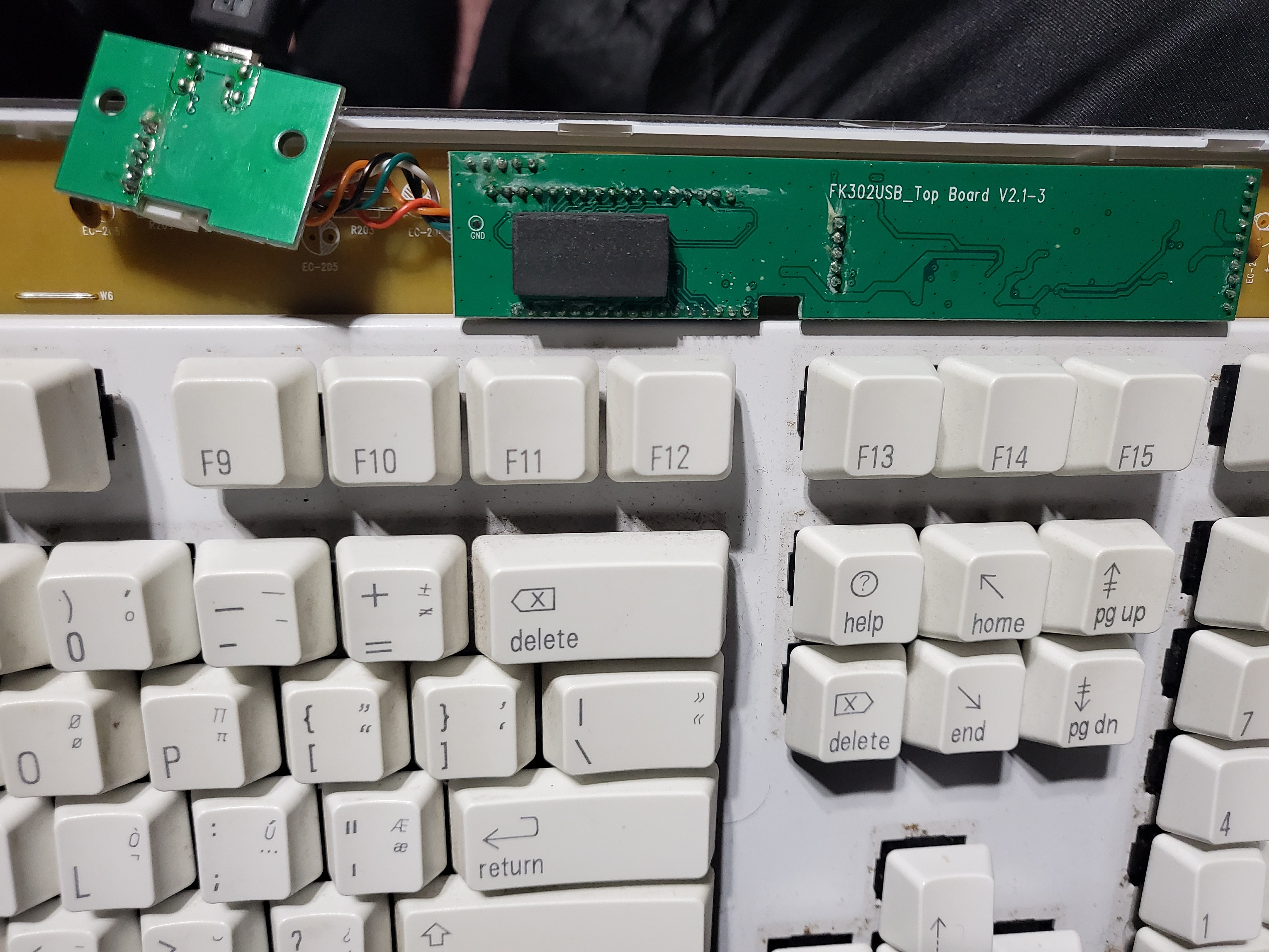

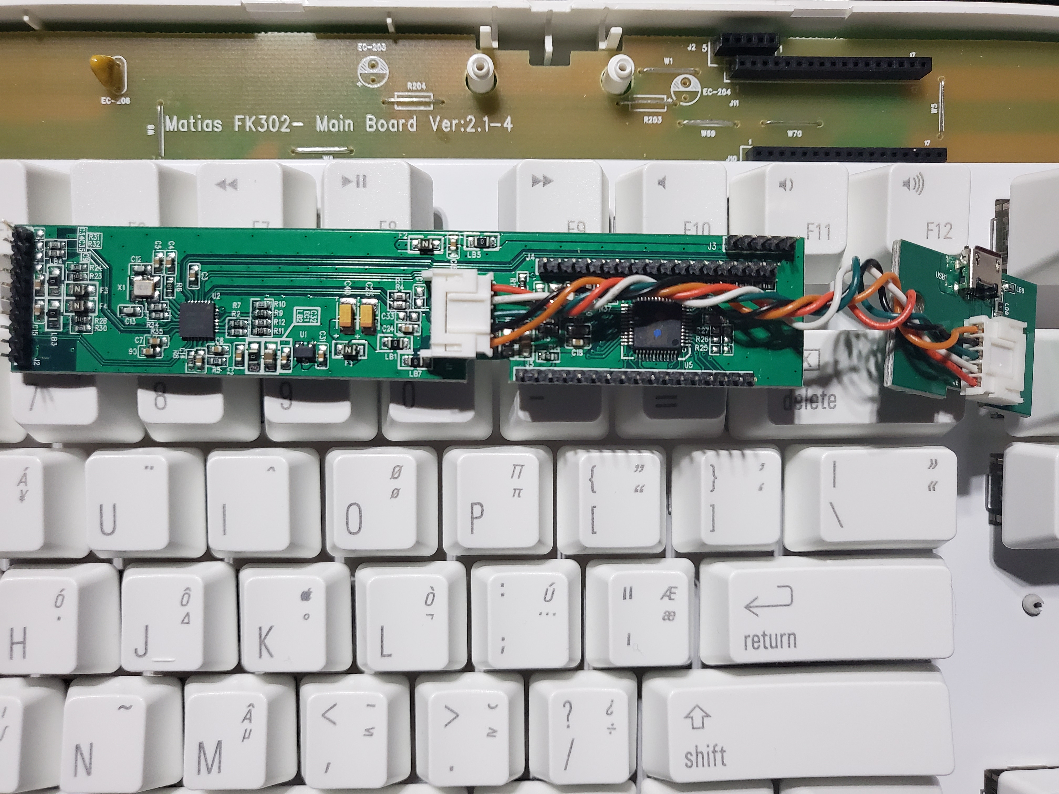

I also picked up, at some point, a used Tactile Pro 4. I have no idea how much use the board has, but the caps look pretty much new. These boards have controllers with small daughter boards for their micro USB connectors, but the pin layout for the controller matches:
New board and controller 1.jpg (3 MiB) Viewed 2070 times
New board and controller 2.jpg (2.7 MiB) Viewed 2070 times
Note that, at least in this example, there's no strap (in Matias' case a big hunk of plastic) to reinforce the connector. I have no idea if this has been amended since whenever this Tactile Pro 4 was made, but if not this is another point in favor of the newer mini variants of these boards, besides being able to easily change the mapping with resistors.

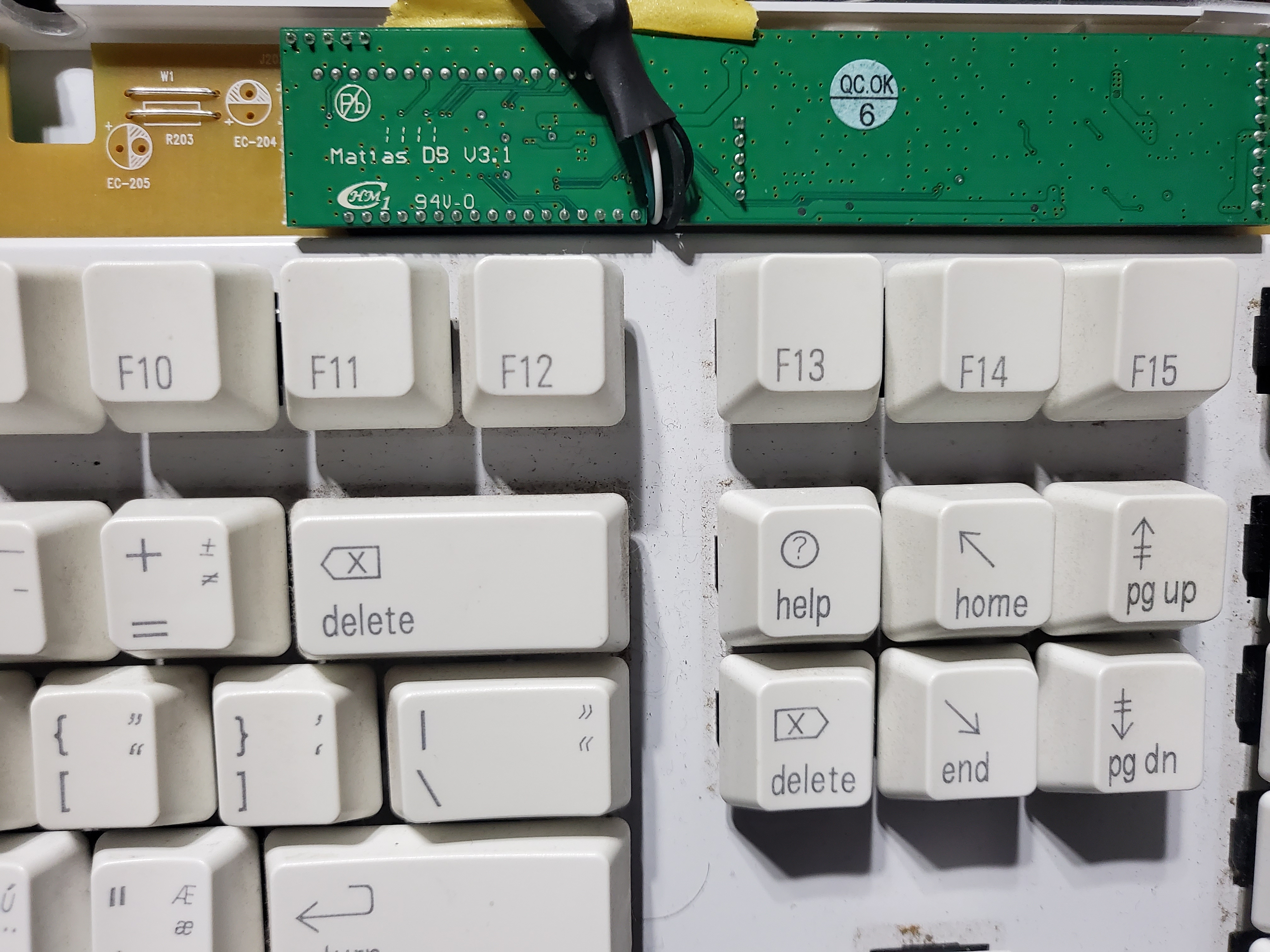

Now, are these controllers 100% electrically compatible? I have no idea. I swapped them in the name of science anyway, as that means I could potentially test and see if the newer firmware helped with chatter on the otherwise totally original board:
New controller in old keyboard.jpg (2.8 MiB) Viewed 2070 times
What I found was interesting. With the newer controller, chatter was instantly greatly reduced and as I repeatedly pressed each key, it was slowly eliminated entirely for that key. The letter n, in particular, would not register at all for the first 10 or so presses. Then it began to chatter, gradually the chatter was eliminated entirely as I continued to press it. Now, it is at the point where I am typing this entire post with that same keyboard that was totally unusable with the original controller.
Before anyone with a relic like this gets the idea that they can just swap a newer controller into their board and all of their problems are solved, the matrix in this board isn't exactly the same as the very latest boards. A few of the modifiers in the lower right, the media control keys and I believe a few in the num pad and nav cluster are not as they should be.
This is enough to demonstrate that the firmware has vastly improved since these boards first came out, probably adjusting debounce on the fly, but what about the newer switches? Will they perform well even with the original controller?
As it turns out, at least with the Tactile Pro 4 I have, yes. I tested every switch on the new board again, with the old controller installed. I could not get a single key to chatter. I swapped that same controller back to the original board and the endless chatter returned like a cascade.
What does that tell us? That either QC/tolerances in design of the plates and pcbs and/or Matias' hands-on alterations culminating in modern Matias switches are most likely a factor and that firmware improvements most definitely are another.
I think this further proves how bulletproof Matias boards and switches have actually become. Even if your switches become prone to chatter (which now seems very unlikely), the newer controllers should be able to compensate for that automatically anyway.

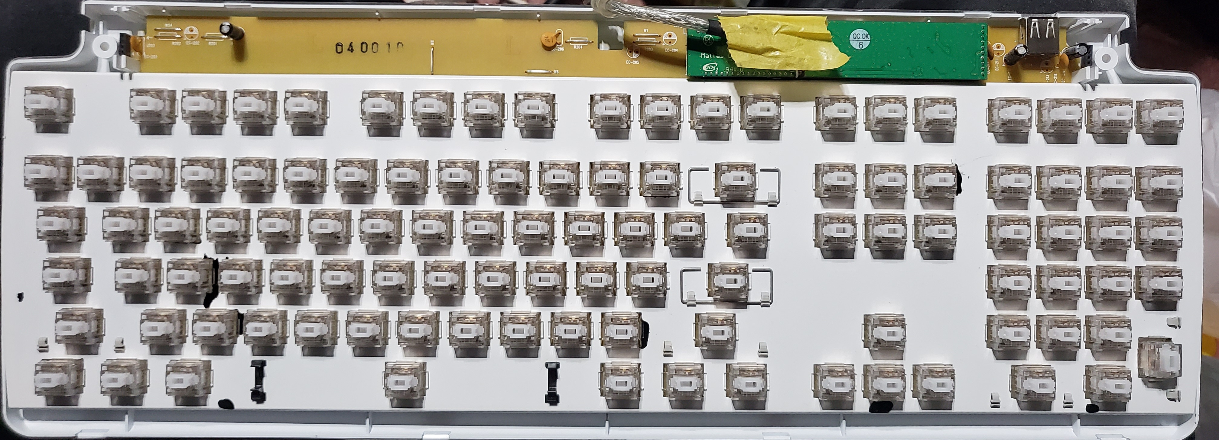

I have swapped all of the old Forward switches in the older board with new production Matias switches. The black spots are just where I've scraped off rust and protected with Rust-Oleum appliance Epoxy.
Everything is working 100% again with the ancient controller so time will tell with heavy usage whether the modern switches can hold up without the help of better firmware.

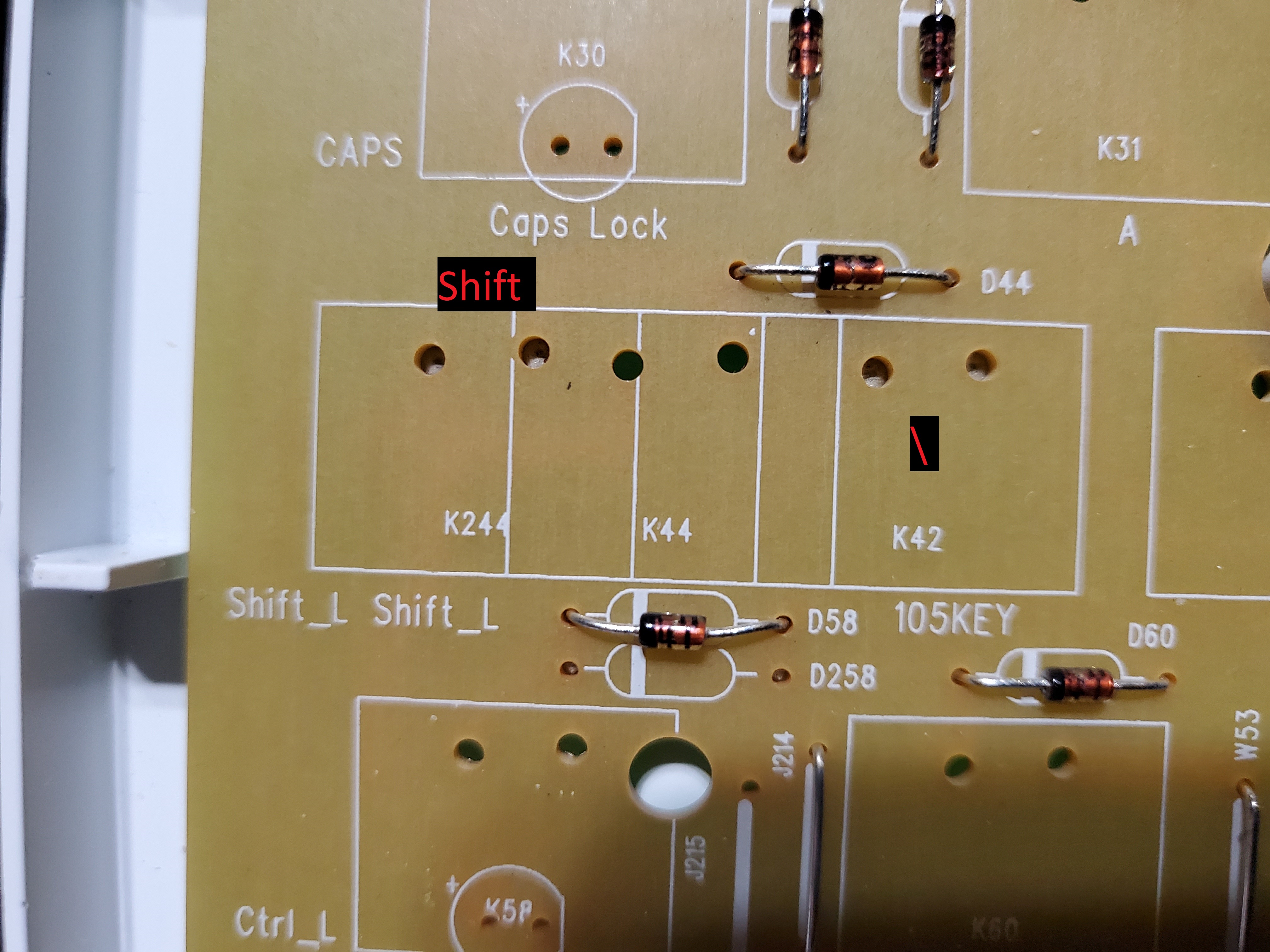

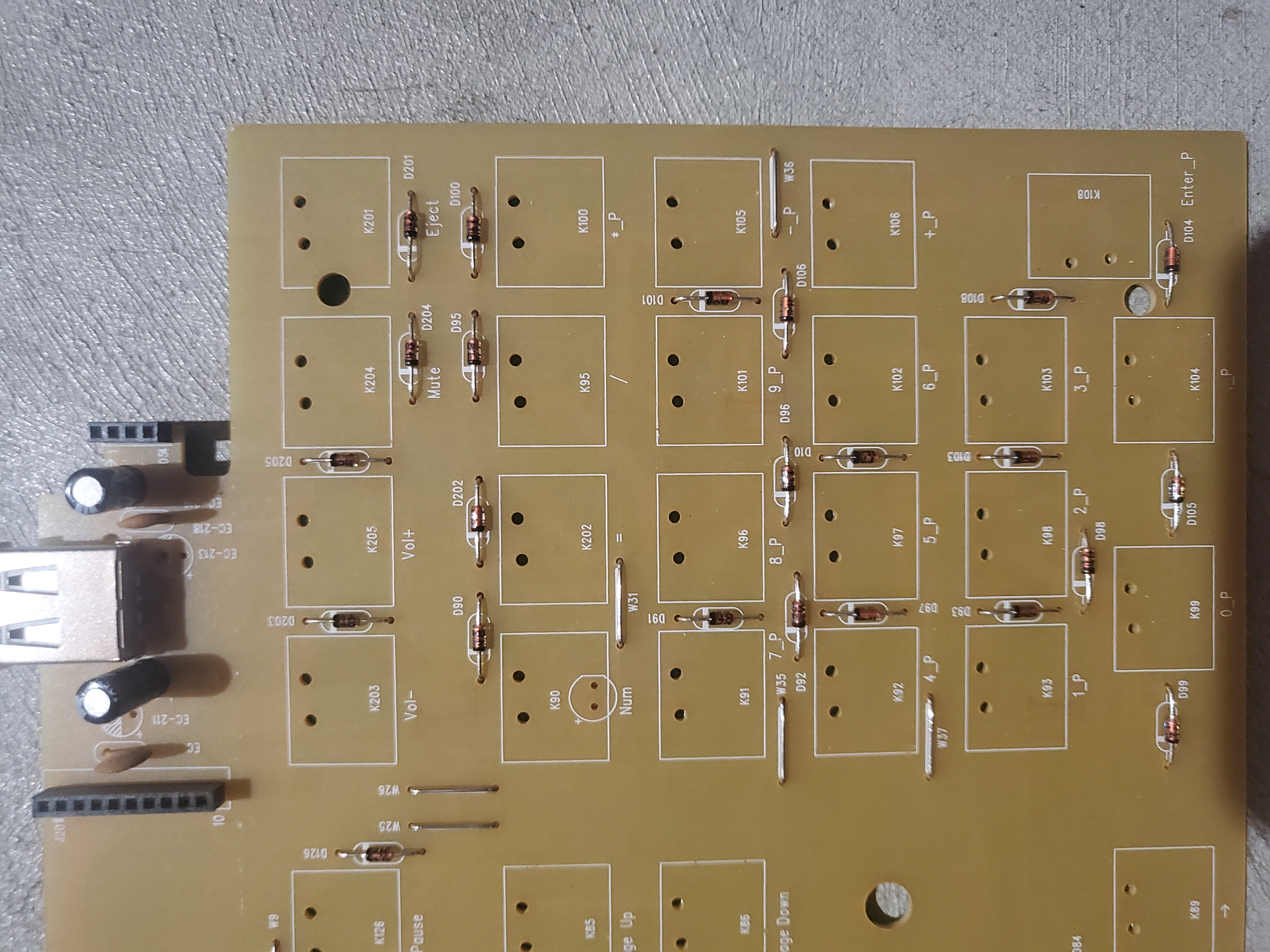

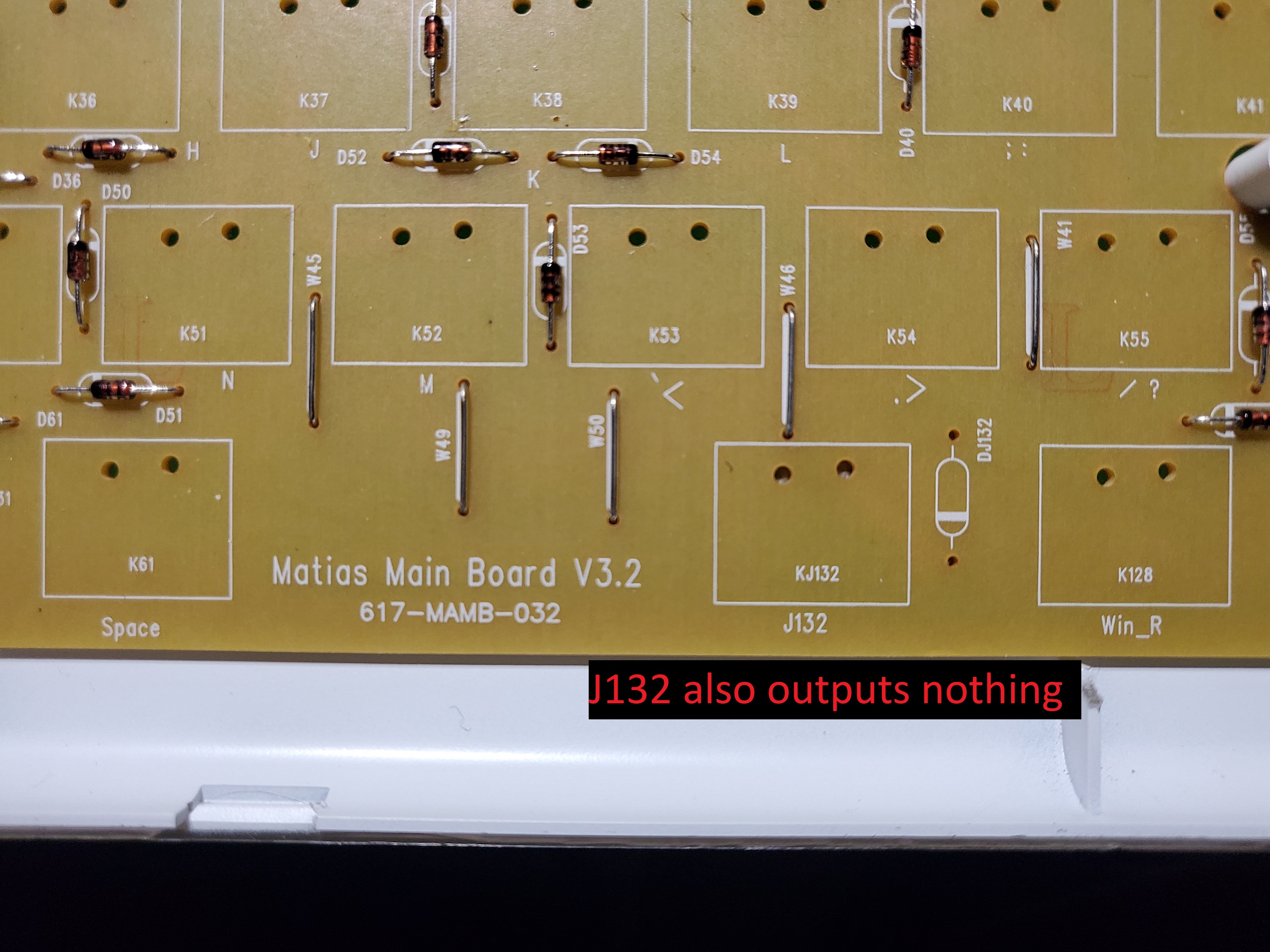

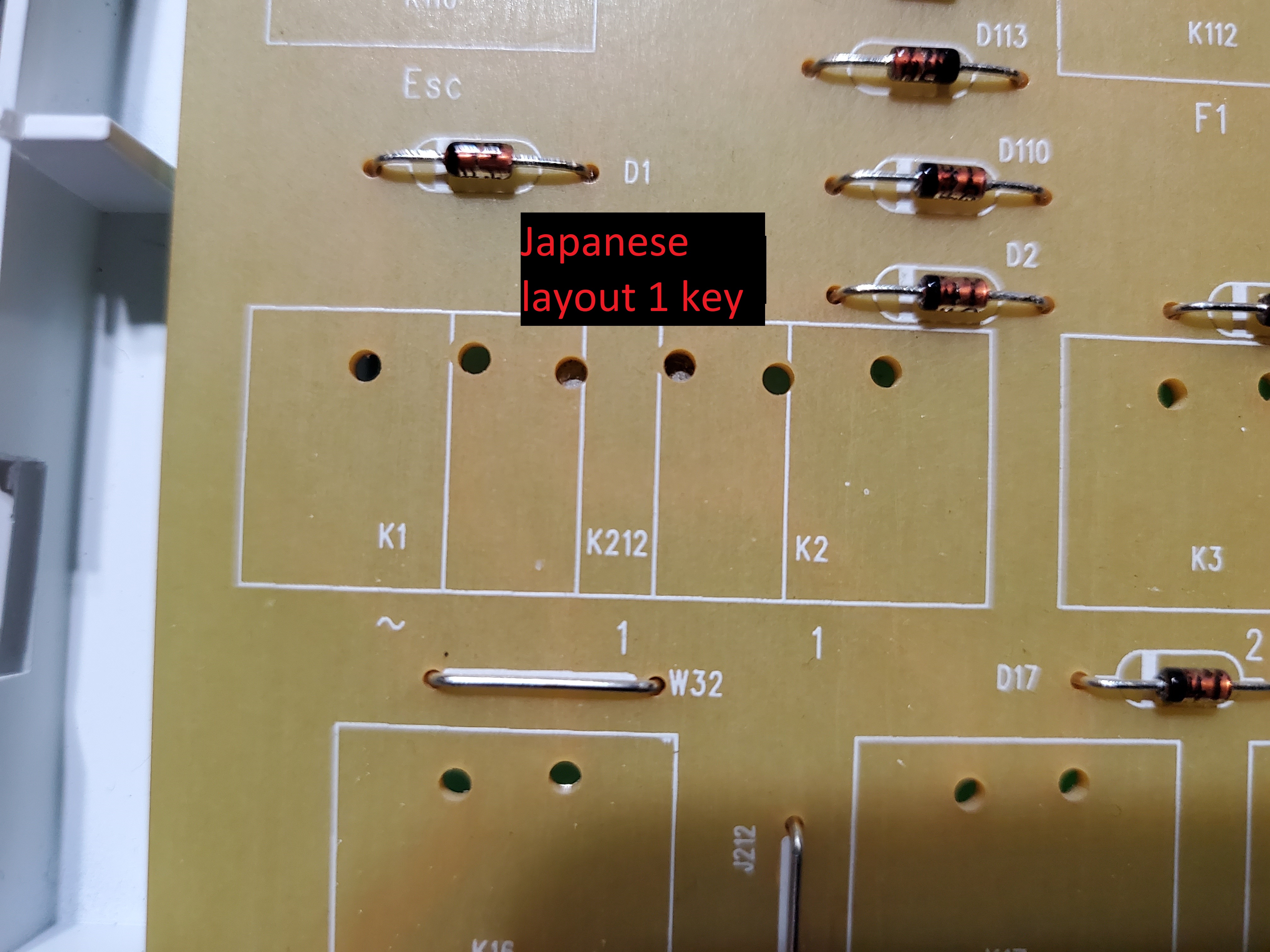

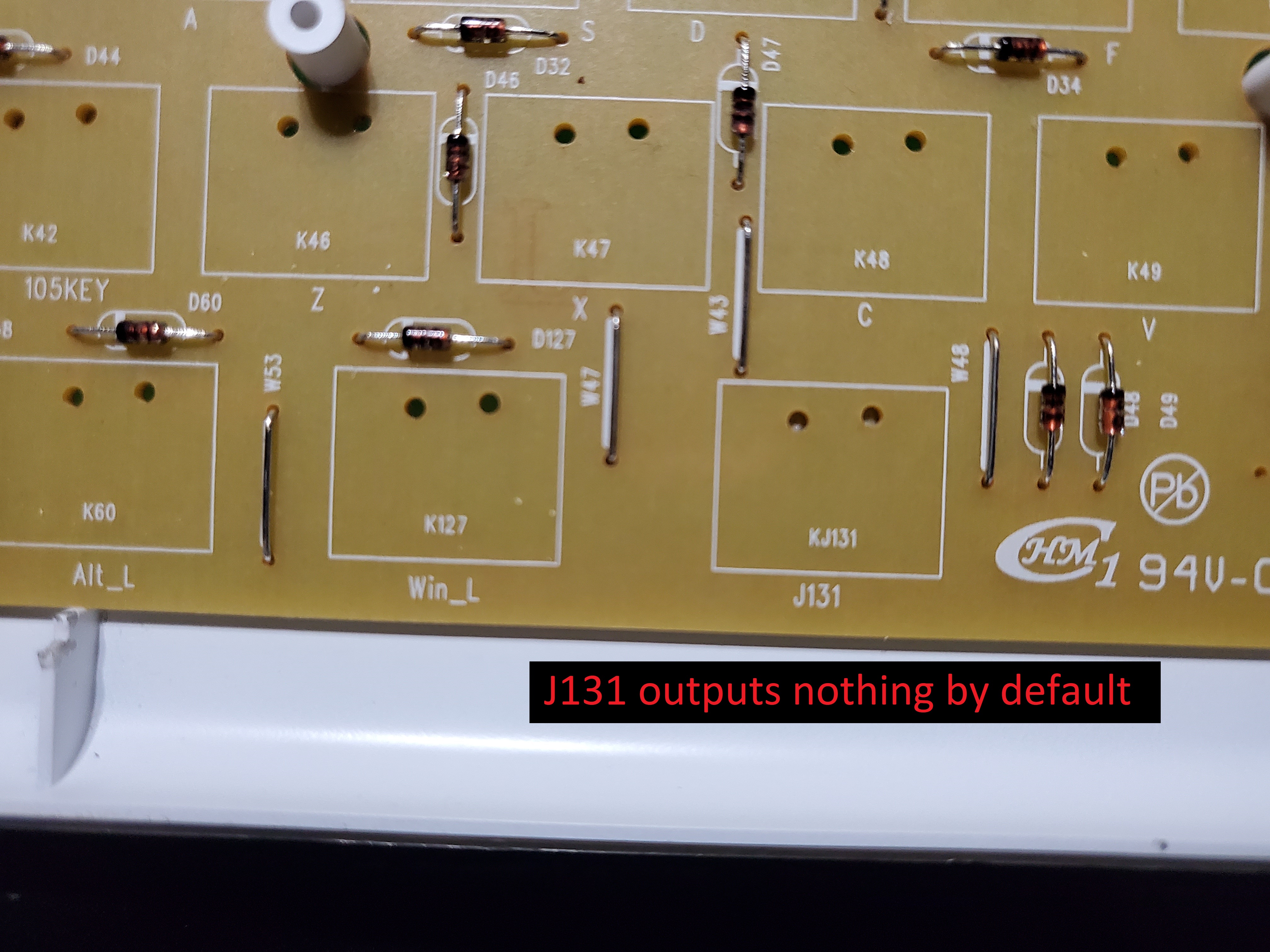

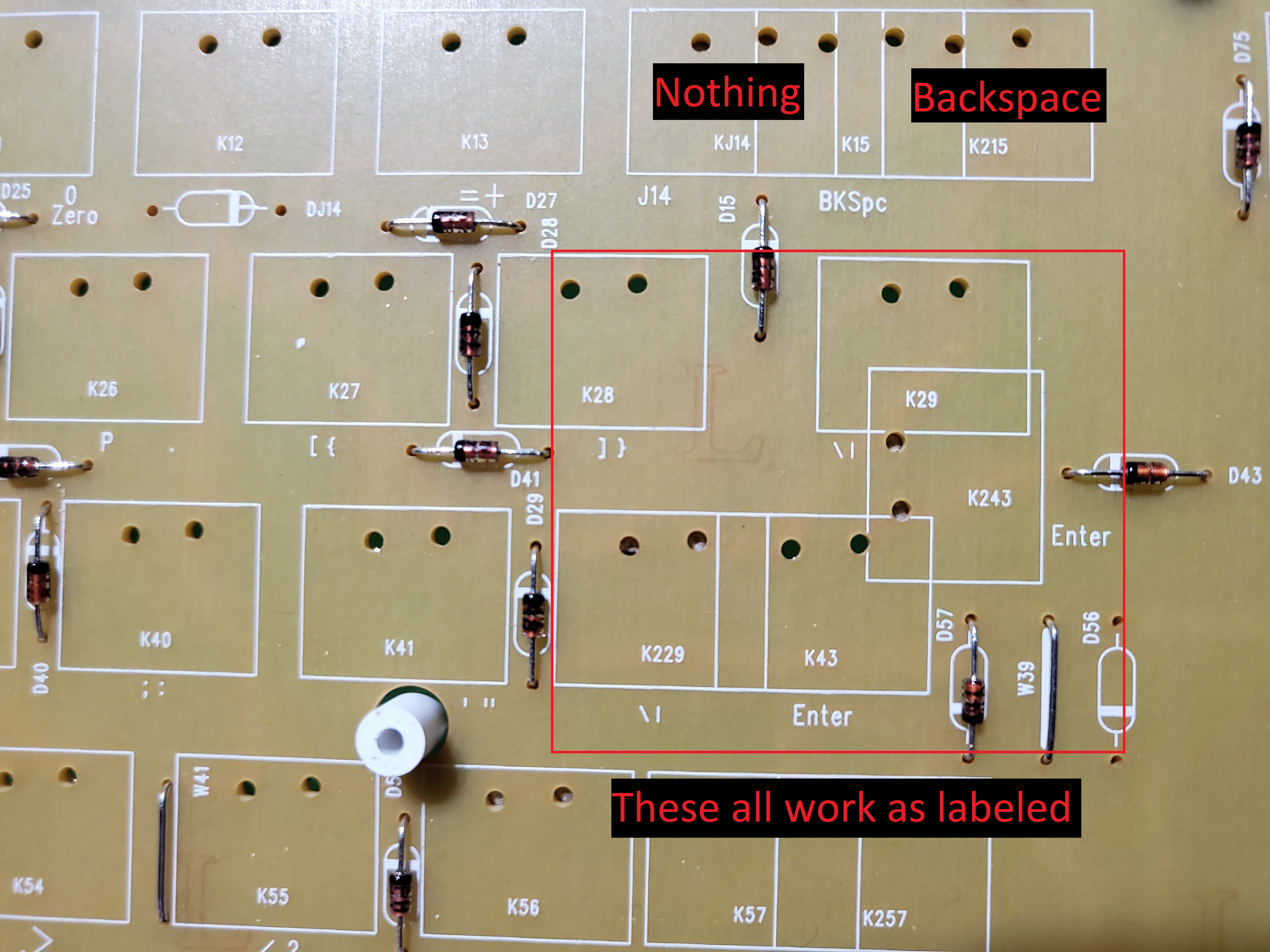

The PCB's printing and pads for LEDs suggest that the same board was probably used for Windows, Mac, ISO and even Japanese layouts and mappings, with extra unused spots for switches marked KJ instead of just K+number. ISO doesn't even appear to require any software changes, but the plate isn't compatible anyway. There also appears to be some way to switch ctrl and caps lock as well, even on these early boards.

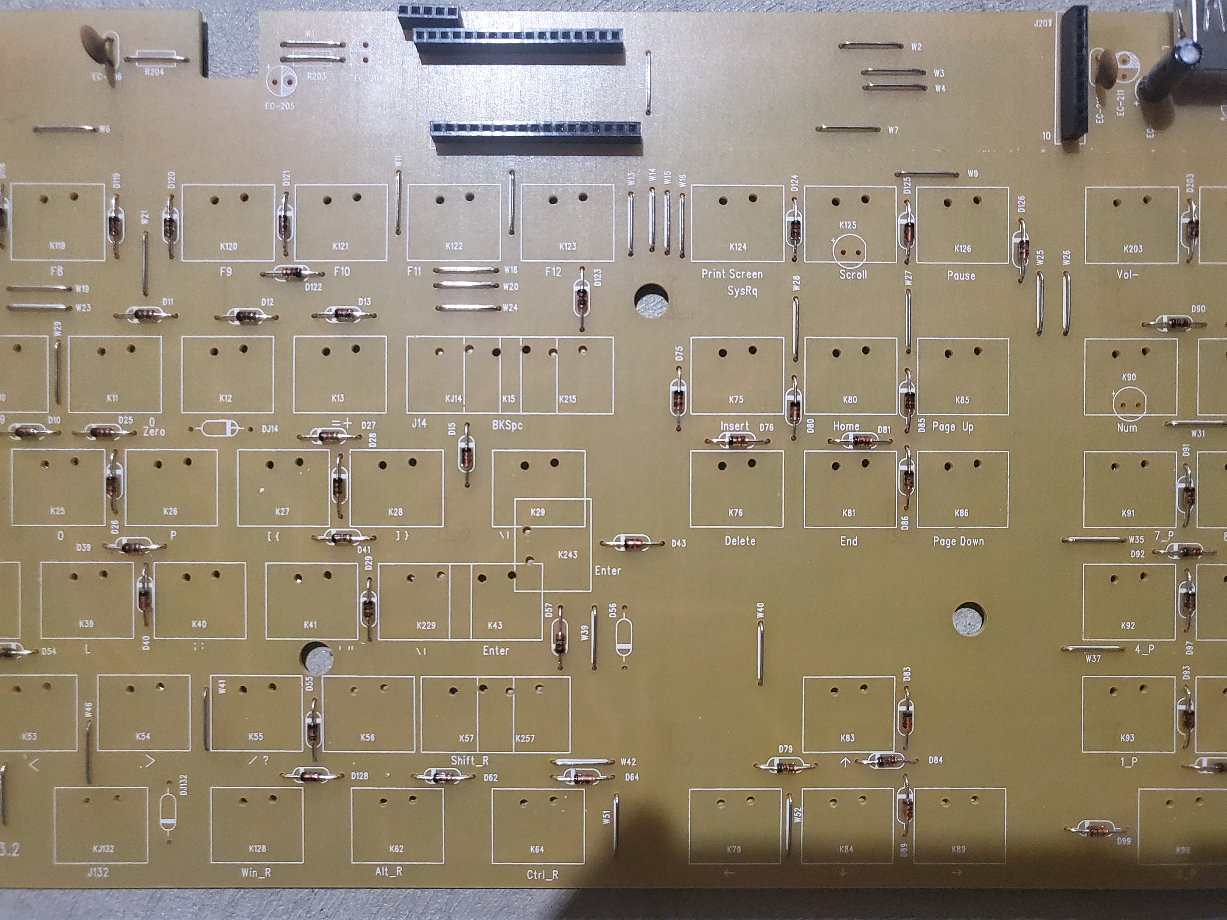

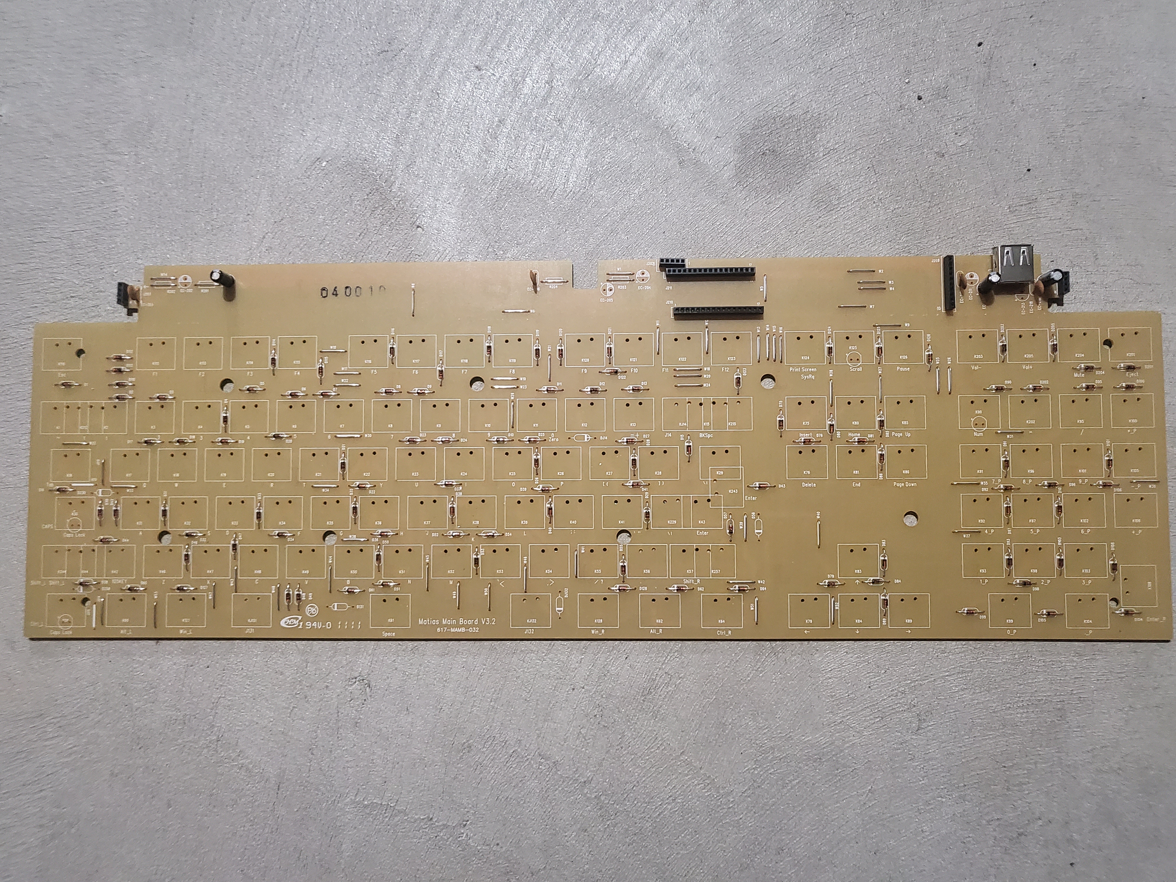

I took a lot of pictures as I don't know how many, if any, other people have been crazy enough to bother stripping and rebuilding one of these boards. The traces are clear enough to probably figure out the whole matrix without too much trouble. I don't think there's a single surface-mount component on it.
Top of the PCB:
Layout/mapping compatibility:
